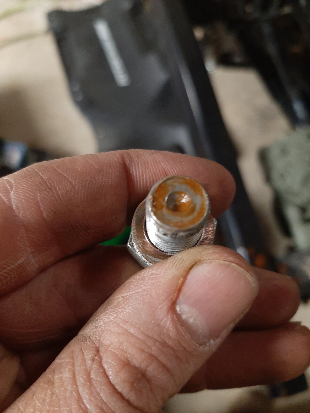

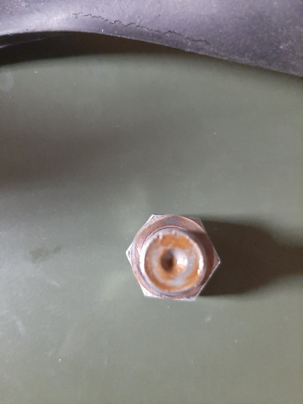

No idea what the factory fill was. In my research on the coolant specs I found that the same specs were from an OAT and HOAT I believe. The problem was the two weren’t compatible. i asked Kyle maki what the factory used and never got a straight answer regarding brand other than the specs listed in the book. So I just drained it all and flushed with distilled water and put in some peak fleet charge. It’s a red coolant used in semis and good for 500,000 miles. It has the additive to prevent electrolysis which is what pits the liners in class 8 truck engines And also what they‘re trying to stop in the power strokes. So now I have peace of mind of what coolant I have as well as it’s protection abilities. I also remember dexcool having a sediment. I wonder if the factory antifreeze is prone to having a sediment dropout.

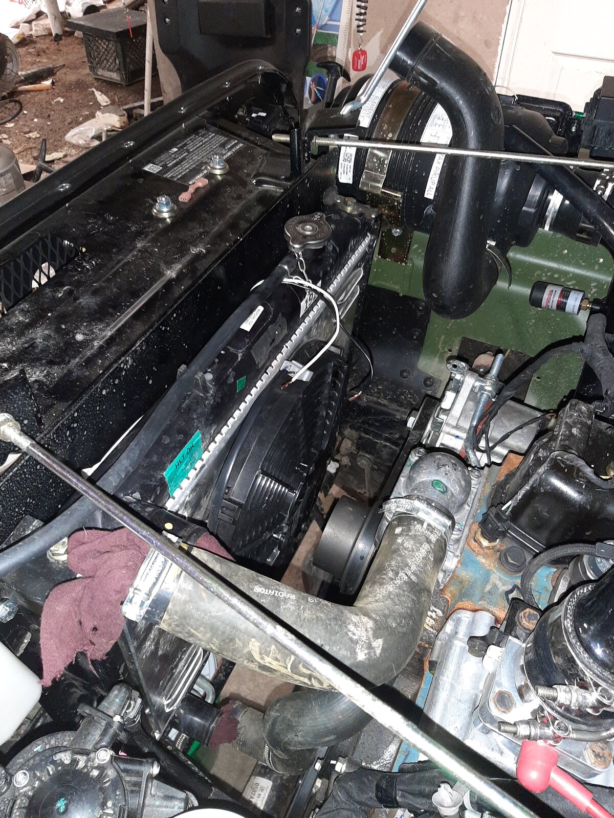

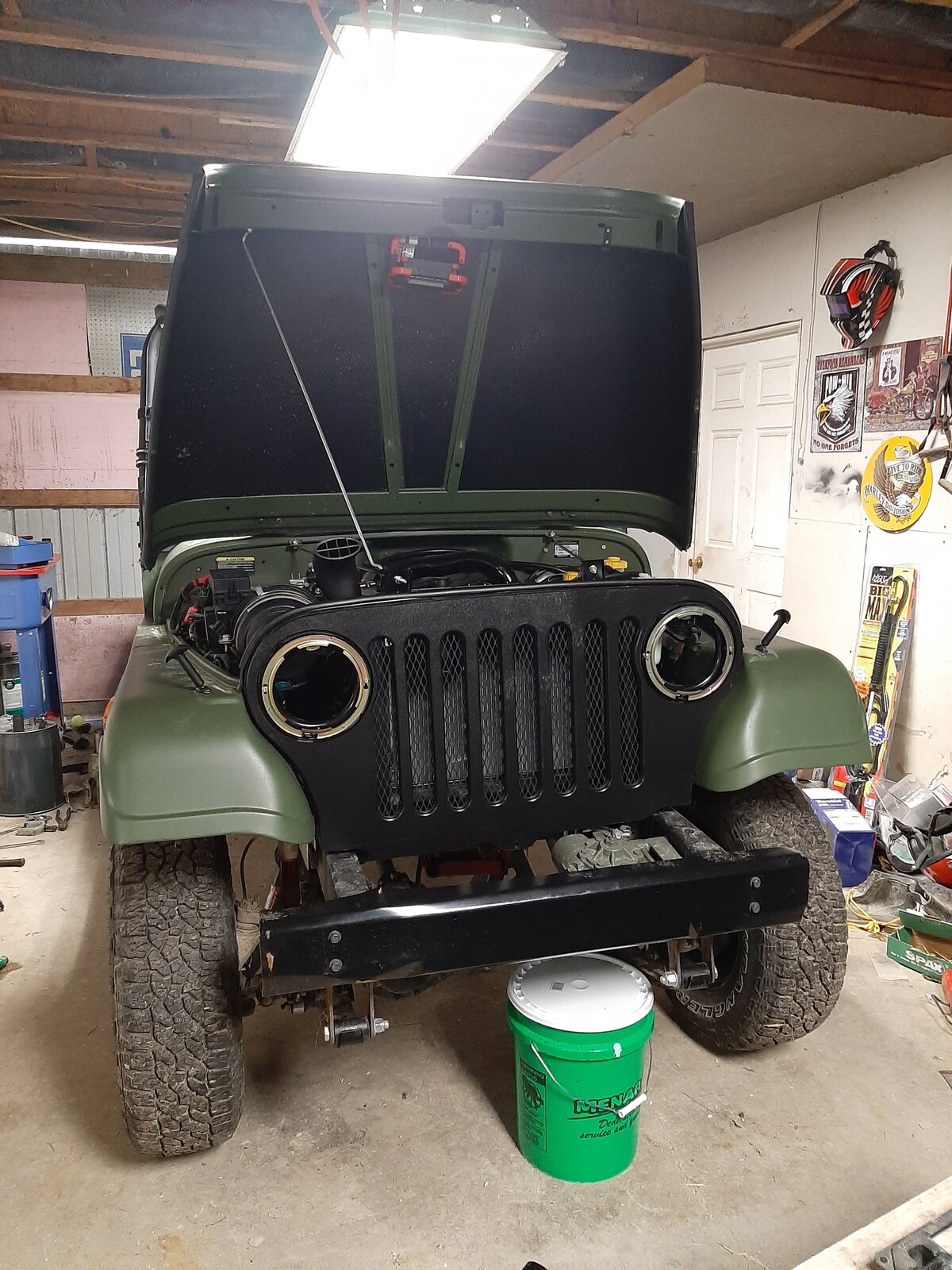

The lighting is pretty bad in my shop but here's a pic of the fan and shroud installed.

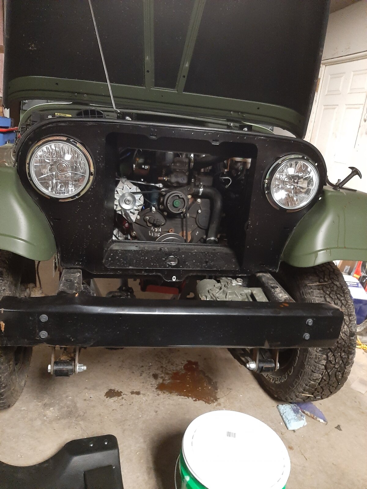

Now that I've done it, the quick instructions from diesel freak makes more sense. They said they put self tapping screws into the radiator flange. Turns out, the radiator flange is a piece of aluminum C-channel that is a good distance away from any plumbing.
I opted to drill holes for 3/16" machine screws with nuts and fender washers to secure it in place. Turned out pretty well. I also used permatex ultra black for, hopefully, some anti vibration effect

Based on the fact that we don't know what the original is: I'm flushing mine and refilling with a known substance. Add in the fact that mine is loaded with sediment and it's a no brainier. I've already drained mine so some distilled water and I guess a good HOAT coolant and I should be good.

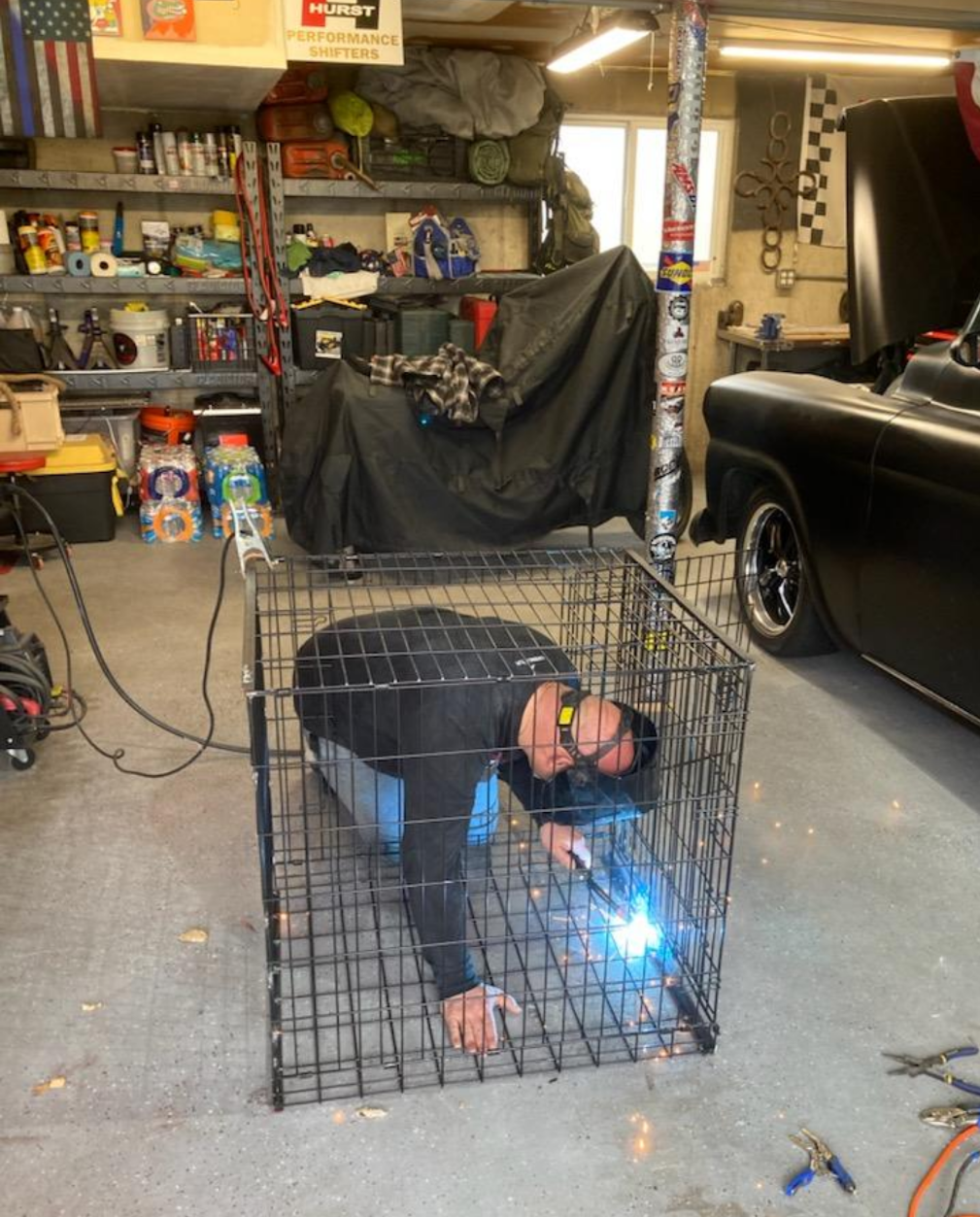

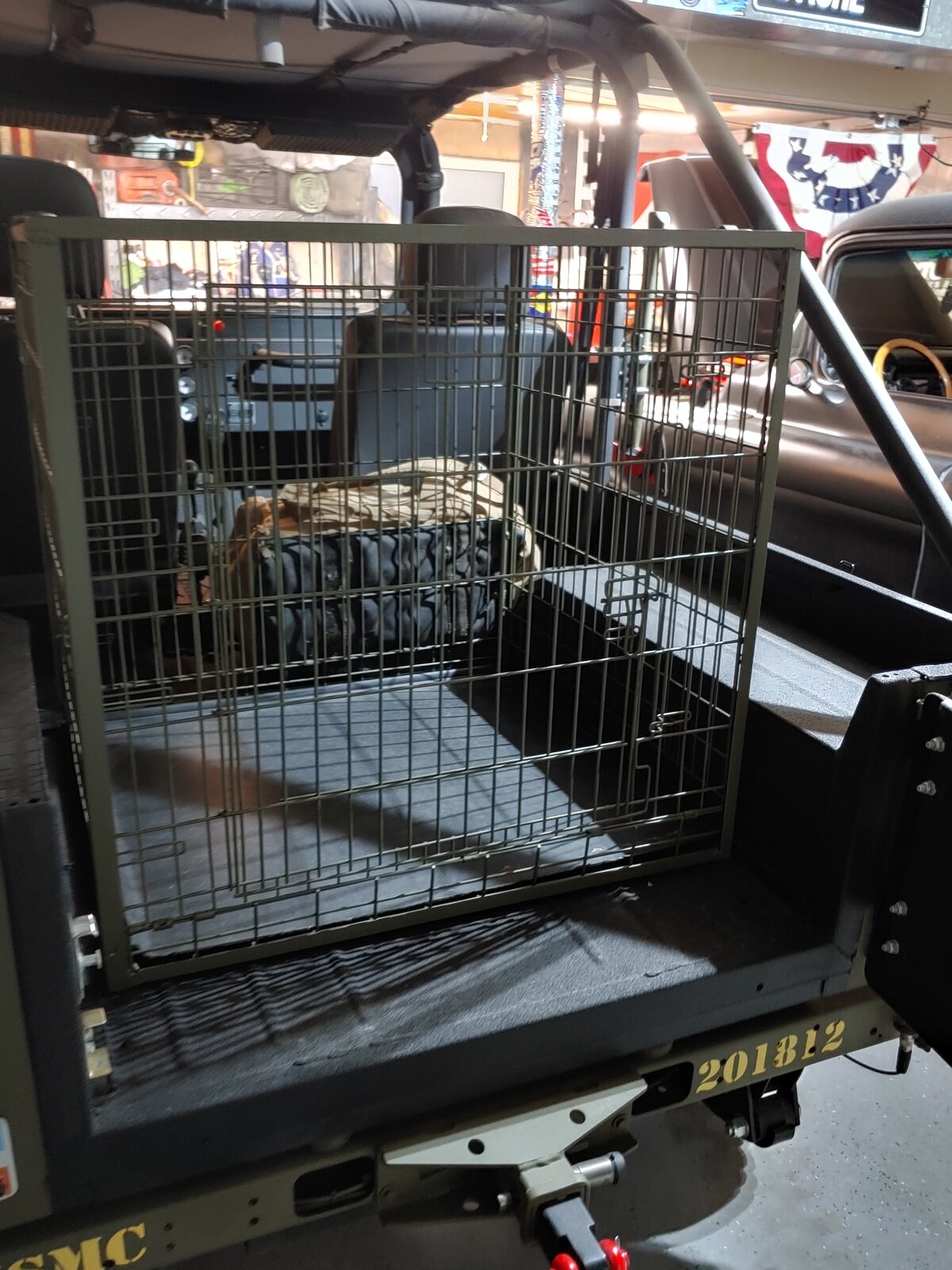

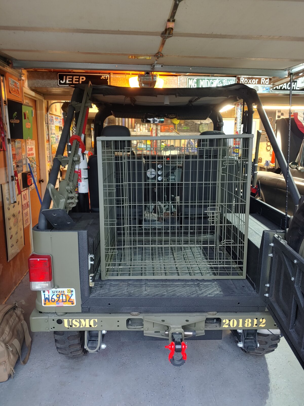

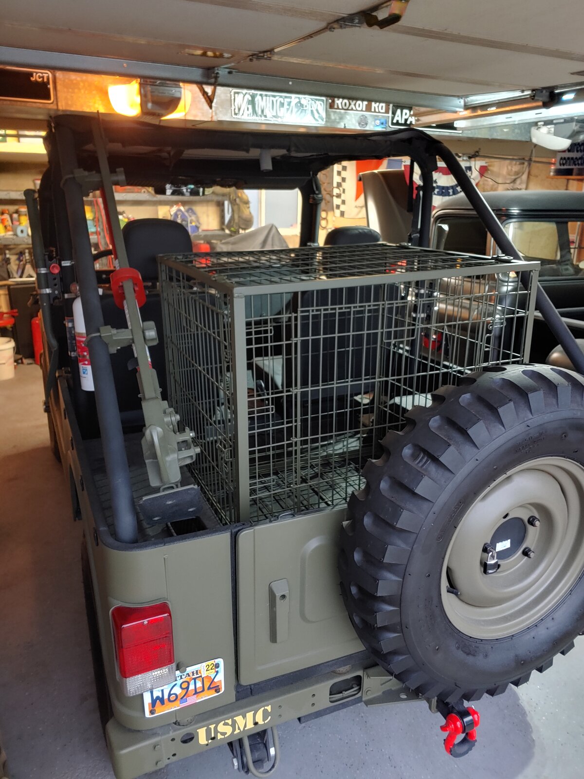

I built a kennel for my little Belgium Malinois puppy (Bear)15 wks old, now he can learn the trails with me in Moab at the end of the month, for Easter Jeep Safari.
View attachment 8765 View attachment 8766 View attachment 8767 View attachment 8768 View attachment 8769 View attachment 8771
Put the finishing touches on Bear's kennel, Roxor should make these as an accessory, lol
Cleaned up the wiring on the e-fan install now that I confirmed it's all correct. Spal sure does give you enough wire to get the job done.
I used a military splice on the power point hot wire (purple with yellow stripe) for the relay signal. If you've never heard of a military splice look it up, they're pretty neat, I'll solder it later. There's a bunch of extra wire here because I'm going to hunt for an inexpensive relay controlled fuse panel for interior accessory power. I'll then use the existing keyed power splice shown below to signal the fuse panel relay. Once that is installed I'll switch the fan relay signal to that board and all will be well and good with little back and forth through the dash grommets.
Used this location for the e-fan relay. After removing all the useless vacuum lines and accompanying junk there was a lot more space to mount things!
Pictured above is an allen wrench plugging the vacuum line that comes off the alternator, still need to find a cap for it...
