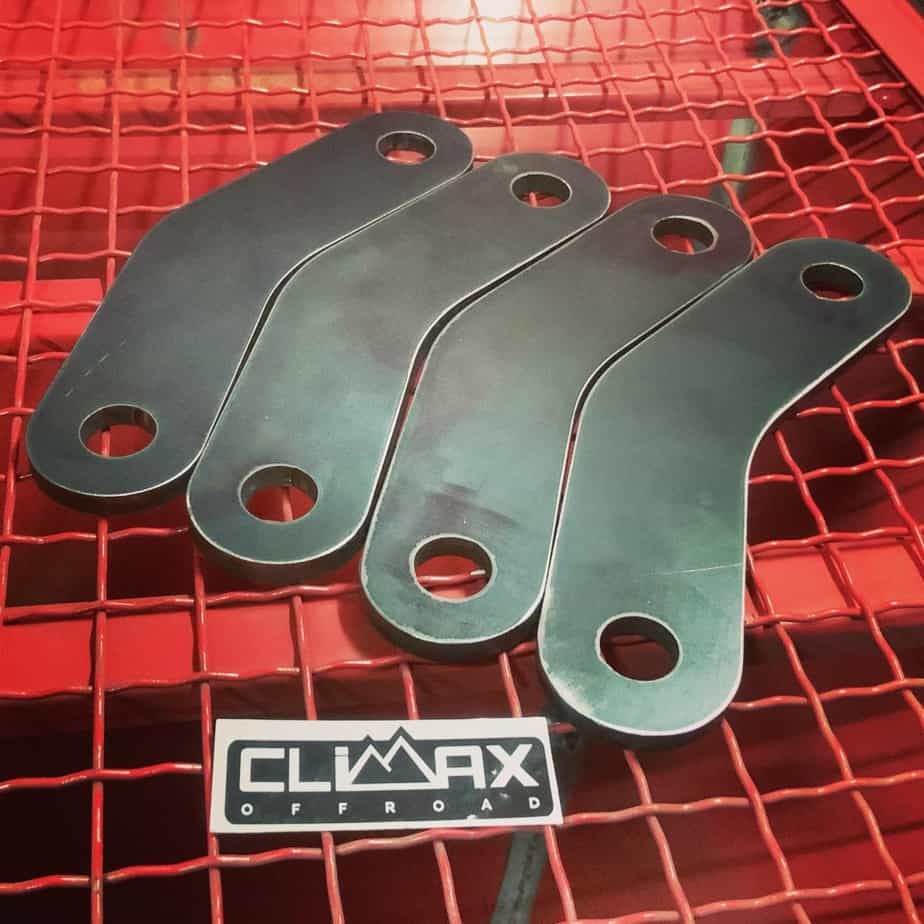

I also want to know if it’s normal for these shackles to be so low to get the lift required to handle these tires? The tires are 265/75r16. Is there another option or is this just normal?
1,305
When you lift via shackle only the formula is for every inch longer than stock you only get 1/2” of lift. So for a 1.5” of lift your shackles will be 3” longer.
It might just be my neurosis but I’m not crazy about the look, is there another option out there?

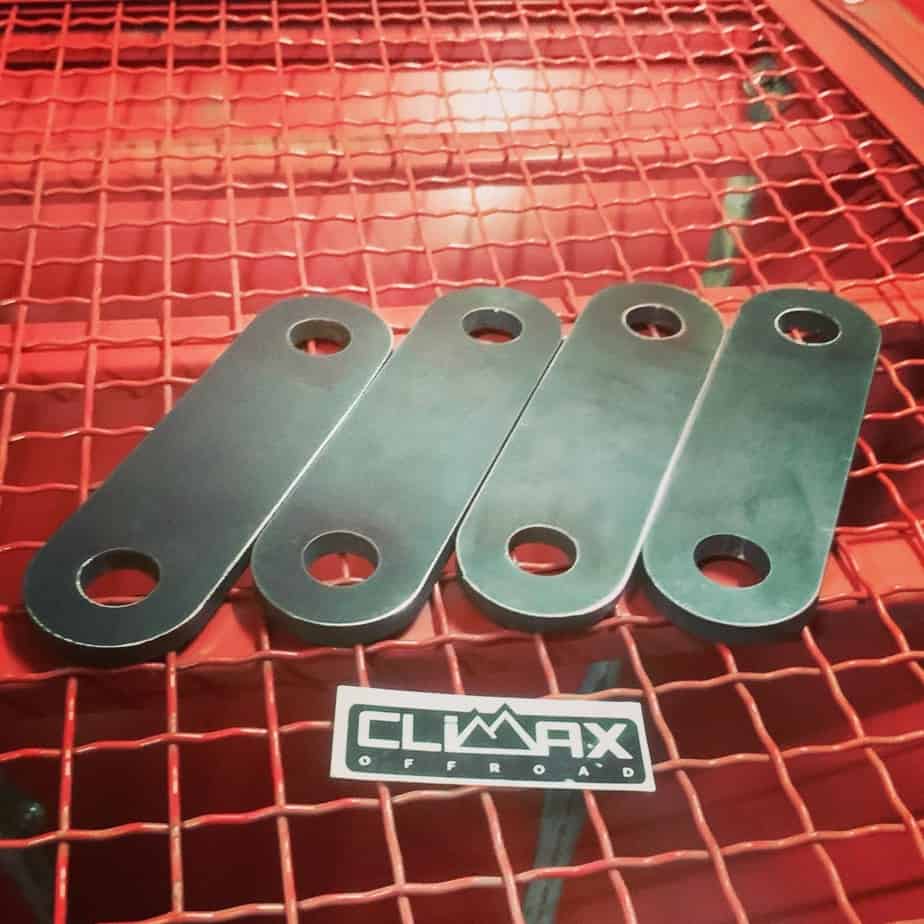

those shackles are an eye sore, looks like twigs lol. Id invest in a OBD2 reader, they are exceptionally underated, came in handy numerous times for me. Check these shackles out, one set for the front, and one set for the rear
Yeah they are pretty ugly!

I installed the shackles you recommended. Way better!
