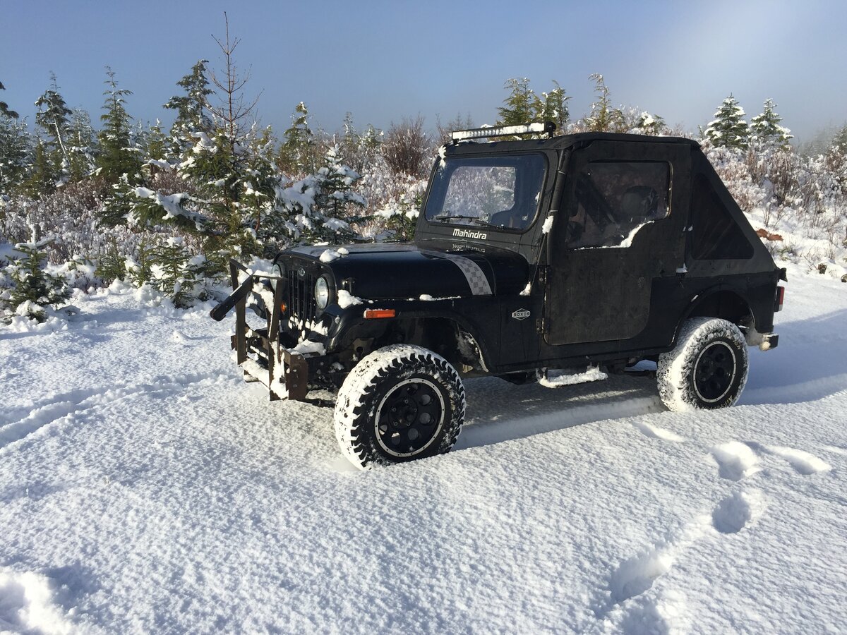

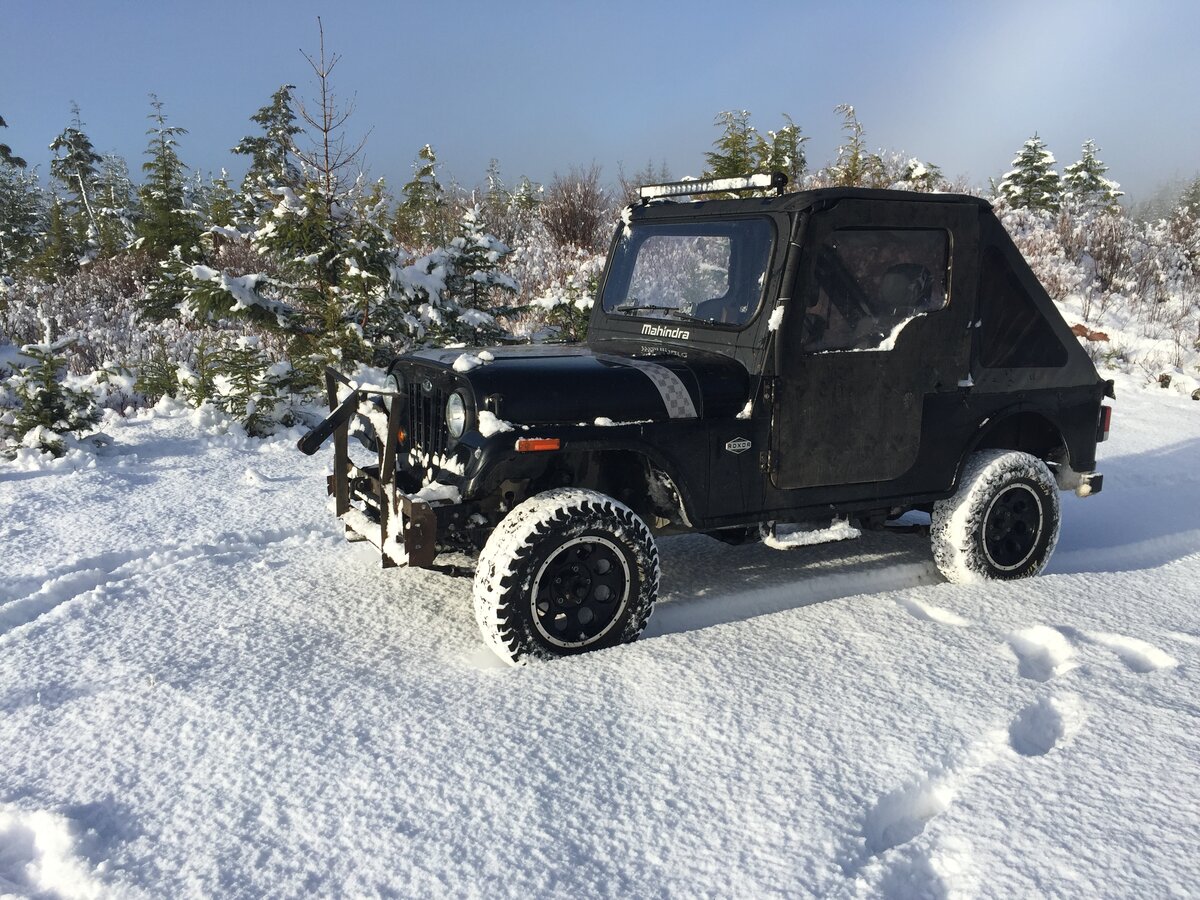

Did they give you a timeframe on it? I ordered 2 from Sherwood on 10/22 and had one about a week later and then the second one arrived a week or so after the first which Was no big deal as the second is my backup one. Once you see how it connects you understand how weak they are. Just a thin piece of pot metal holding the cable to the lever.
