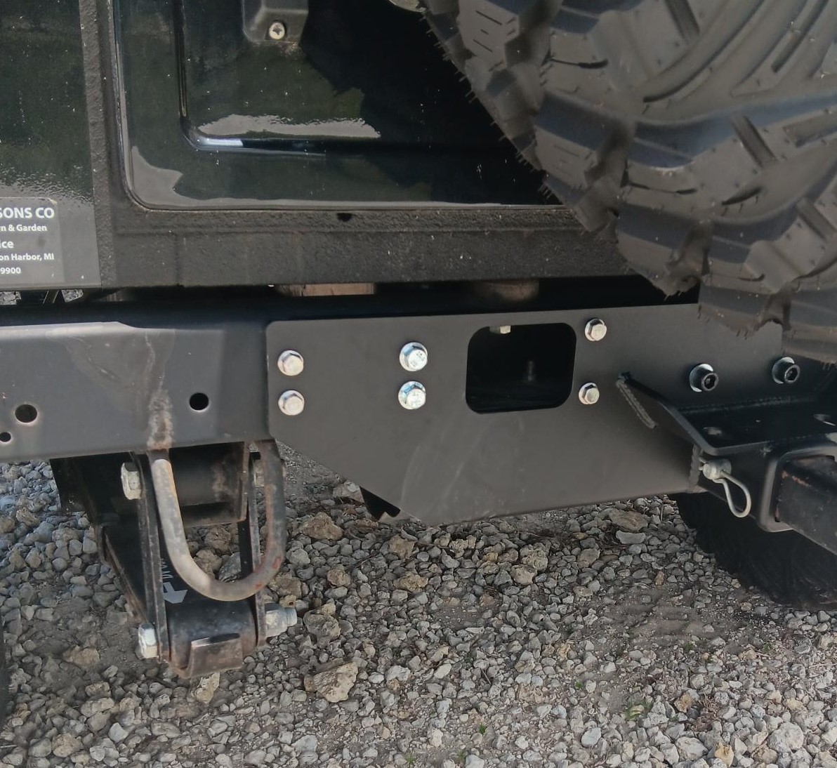

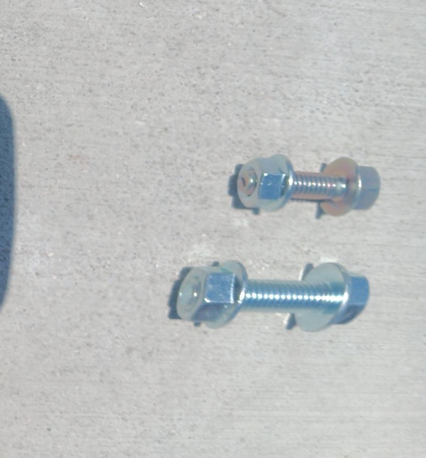

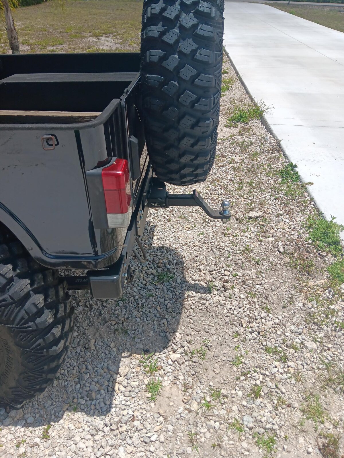

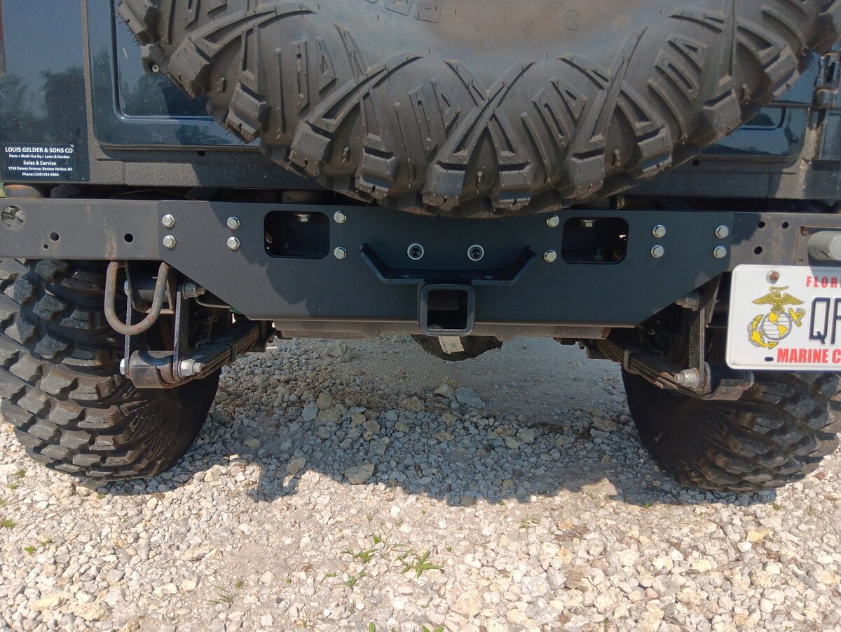

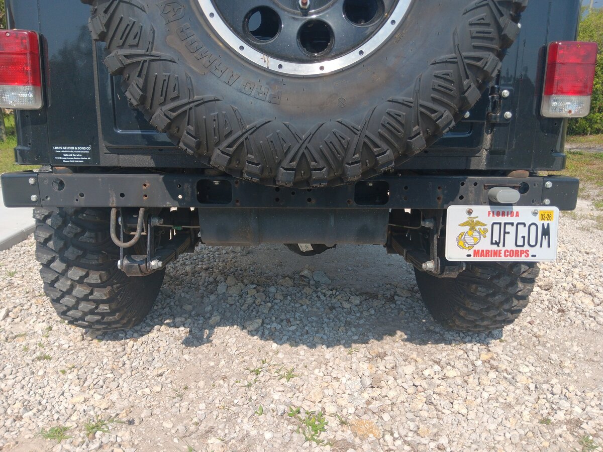

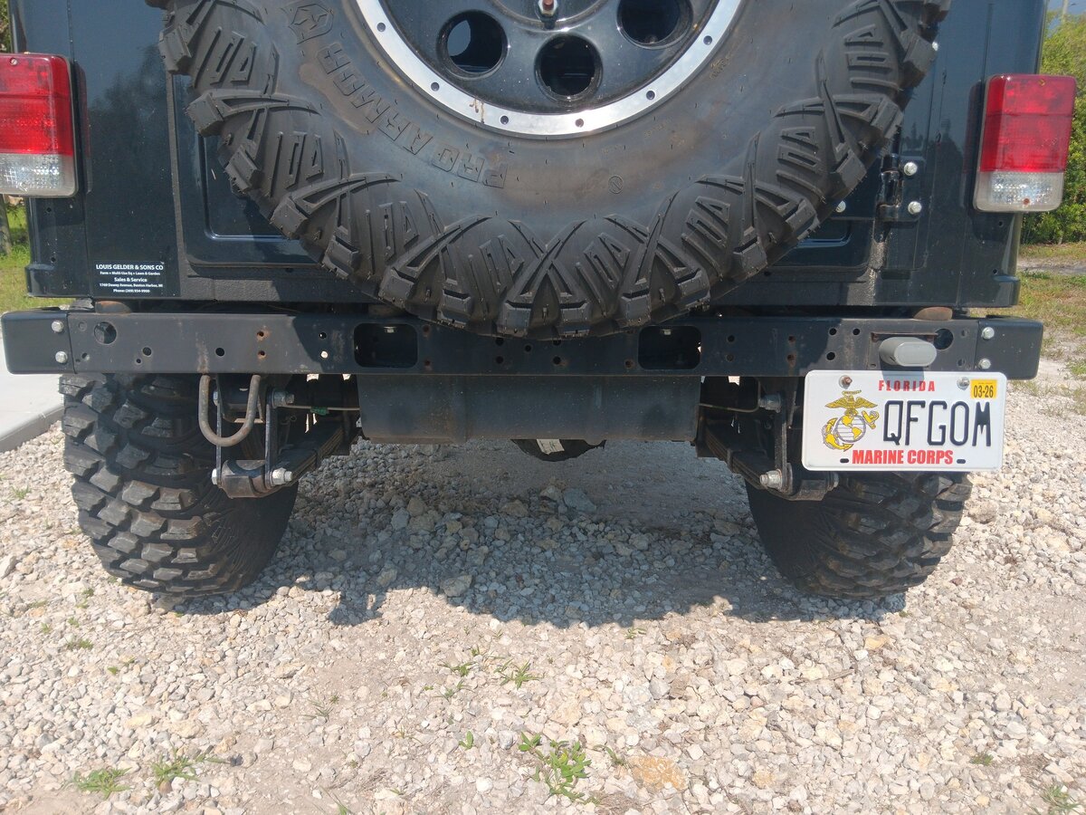

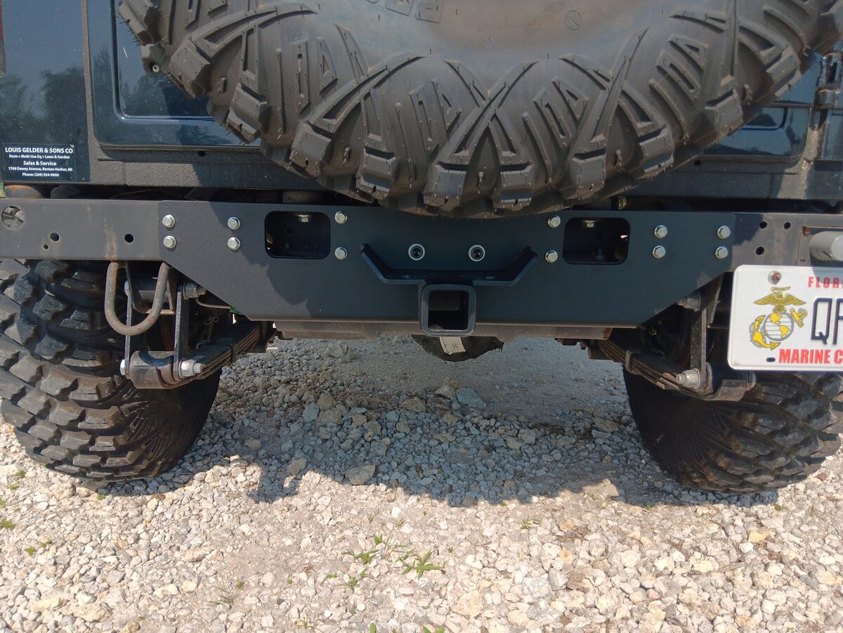

Ok, I just finished upgrading the four bolts, tightening the receiver hitch, and then putting the trailer hitch on. Almost a perfect fit.
The # 10 bolts went in fine on the left. On the right side (passengers) I had to drill the frame holes out slightly. Anyway, the hitch receiver is fully tightened, and the trailer hitch is on, and it looks fine with my extended spare tire carrier.

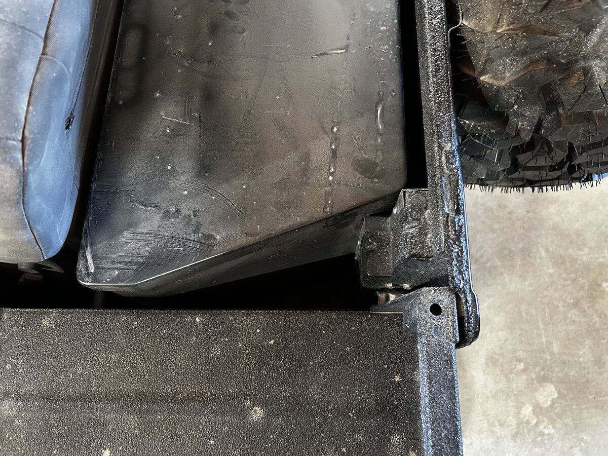

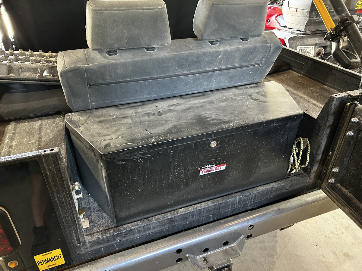

I didn’t do this today but thought I’d still share. Bought this trailer box from Harbor Freight for $120 I believe and bolted it to the bed behind the rear seat. Fits perfectly and allows the gate latch on the rear door to close. Couldn’t have fit any more perfectly.

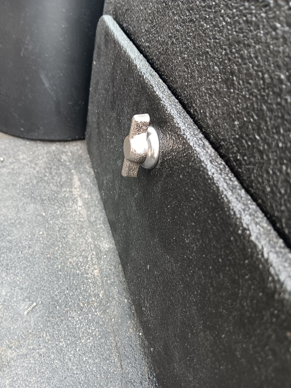

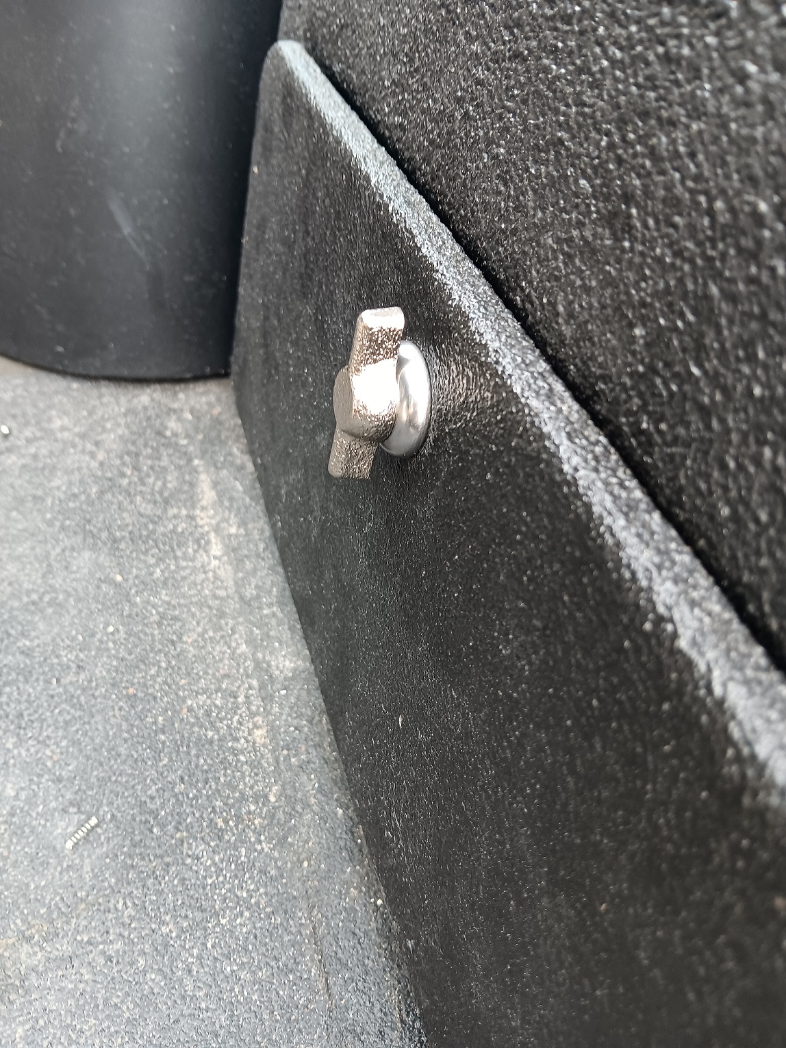

New Non-Locking latch for the driver's seat box and the new bolt on receiver hitch.
For a while these receiver hitches were not available, and I was going to fabricate my own. I like this receiver because it is rated for the advertised tongue weight of 349 lbs., and the towing capacity of 3490 lbs. These are the max capacities for the Roxor per Mahindra. I have seen other receivers but at lower capacities.
I need to tighten all the bolts yet. Anyway, On The Rox provided 4 extra larger diameter bolts. I will go get the proper flange nuts and swap out 4 of the smaller bolts for these larger diameter bolts.
View attachment 14822 View attachment 14823 View attachment 14824
I need to remove those darn locks too.
