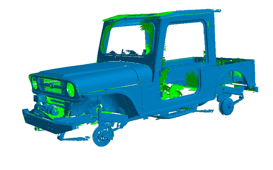

I'm an engineer by trade and my buddy just got a new Roxor and is asking me to make some stuff for it. So we scanned it and are getting ready to make some parts.
Wondering what you all would like to see made for it. Sky is the limit.

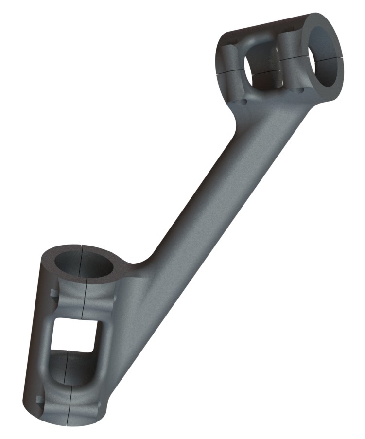

First thing I'm doing is some handles to get in and out of the little beast. My buddy is in his 60s and finds getting in and out to be difficult to say the least.
I'll 3d print them from carbon fiber reinforced nylon and will maybe make some billet aluminum ones too. Prototype is on the printer now...
Sounds like fender flairs should be the next item on the list, I'll see what I can do.
A jerry can mount, great idea.
LED light bar mounts too. Another good one.
Keep them coming guys, I'm seeing a ton of stuff we can make for the Roxor.

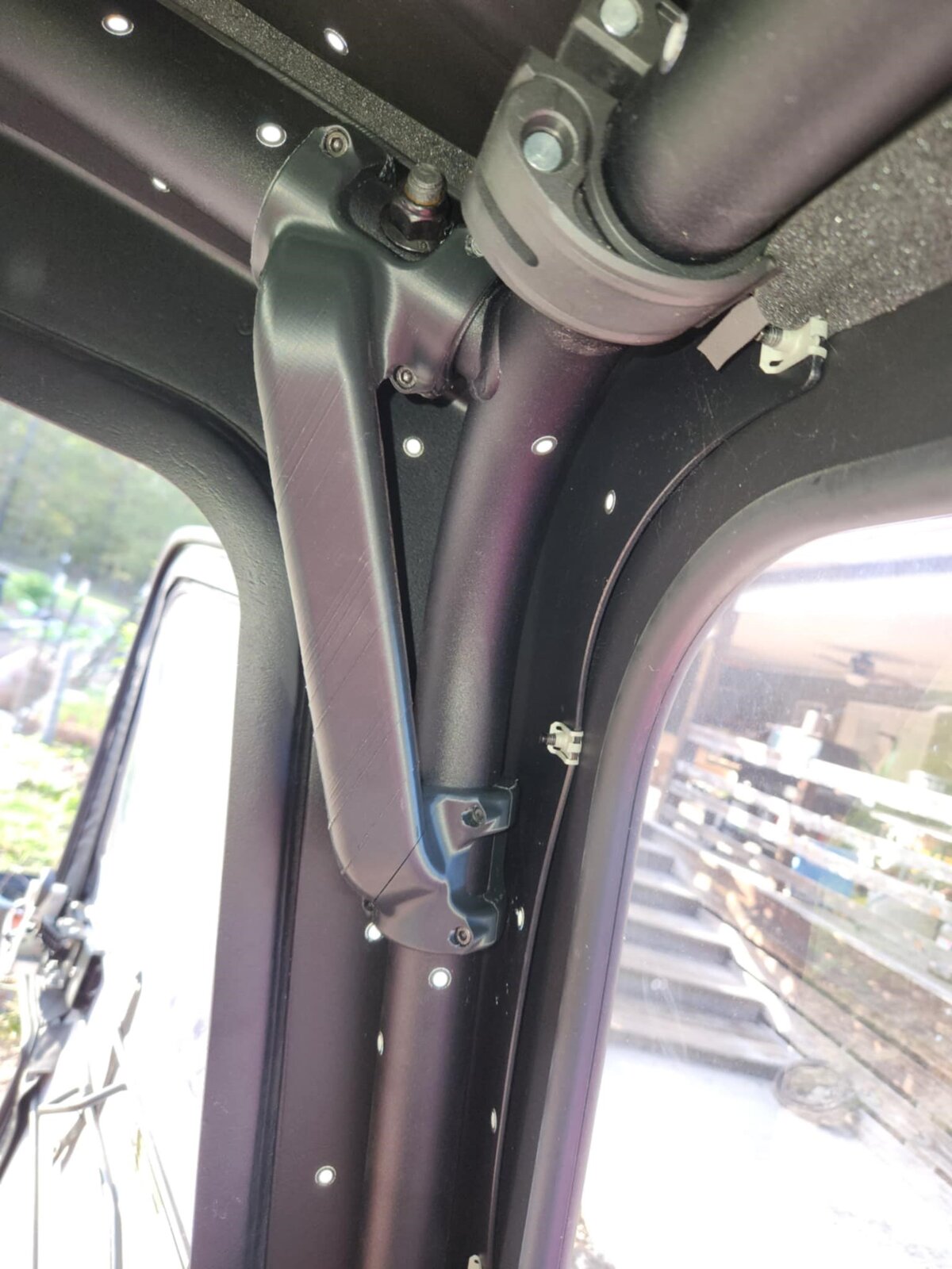

Getting closer with the handle. My buddy who owns the Roxor is 3hrs from me and he's been MIA.
This is Gen2 and I just finished some protos of Gen3. What we found is there's a large discrepancy side to side and we are concerned that there's going to be a lot of variation in the field. So Gen3 will have some misalignment capability. I like the look of the one-piece better but am worried that there will be fitment problems with variations in the field.
Question: Once I get these ready, am I allowed to post a link to them here or is that a no-no?
