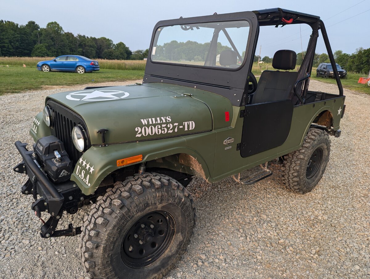

Installed glass in the on the rox windshield frame. Lasted 5 minutes until it popped out in my lap at 40mph. Is there a top speed with CJ Glass in the kit?
On the rox windshield frame is not compatible with on the rox roof. Had to modify it a bit. Will retry the install tomorrow with rope and soapy water. The gasket stayed in the frame but the glass just came right out.
USMC
Jul 1, 2024
399
Naples Florida
09848
Cloud, that is interesting. I have the 2022 cab model, and I just had a local glass company install DOT approved glass. I have one issue though, the frame pulses while I am driving 50 - 60 mph. So, I will install two stops at the base of my windshield.
1,329
I recall someone else having issues with the folding windshield and top. Evidently they don’t play well together. The locking of it in the upright position and the top don’t mesh well. I have the OTR solid windshield frame and top and no issues. As for the glass. I’ve had mine on the trailer upwards of 80 plus and no issues. I’m betting you have the glass cut slightly too narrow allowing just enough play for it to pop out at speed. You said CJ glass. Did you just try and put a precut CJ glass in the OTR frame? If so I bet that’s your problem. Every time I’ve had glass put in mine the glass company custom cut mine to fit.
Cloud
Oct 25, 2020
246
Freedomland
6527
I used the CJ Glass from quadratec that otr days to use.
I may have installed the gasket backwards according to the diesel freak video (better instructions than otr for the glass)
For compatibility I had to put spacers between the windshield clamp and the frame. Otherwise the frame deflected so much that it was nowhere close to straight. If I followed the install instructions the windshield frame was about .75" away from meeting the roll cage. I used the spacers from the back rops clamps and got longer screws. I pushed the roof back as far as possible. The rear rops clamps are at a very extreme angle. I'll need to drill new holes one day.
@USMC what do you mean by two stops? Got any pictures of this idea?

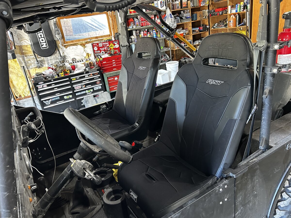

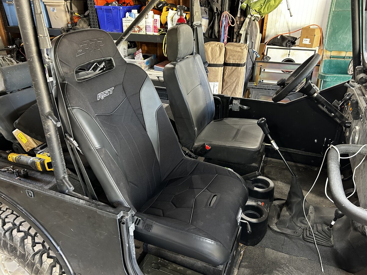

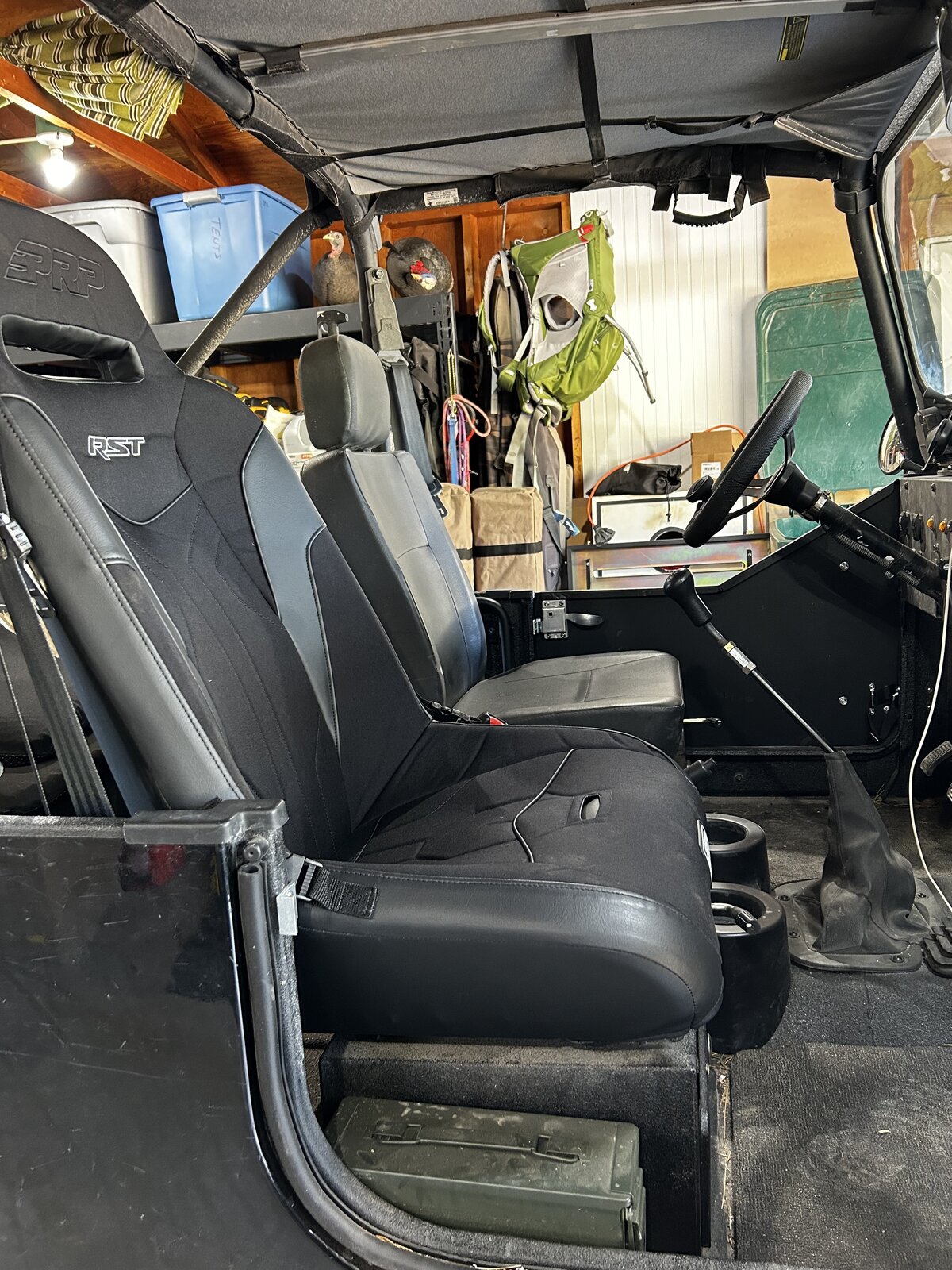

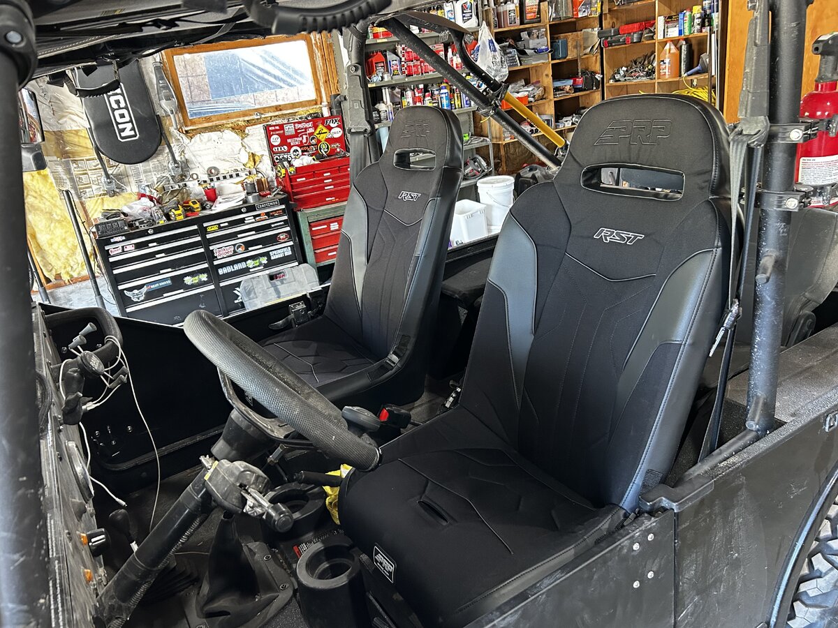

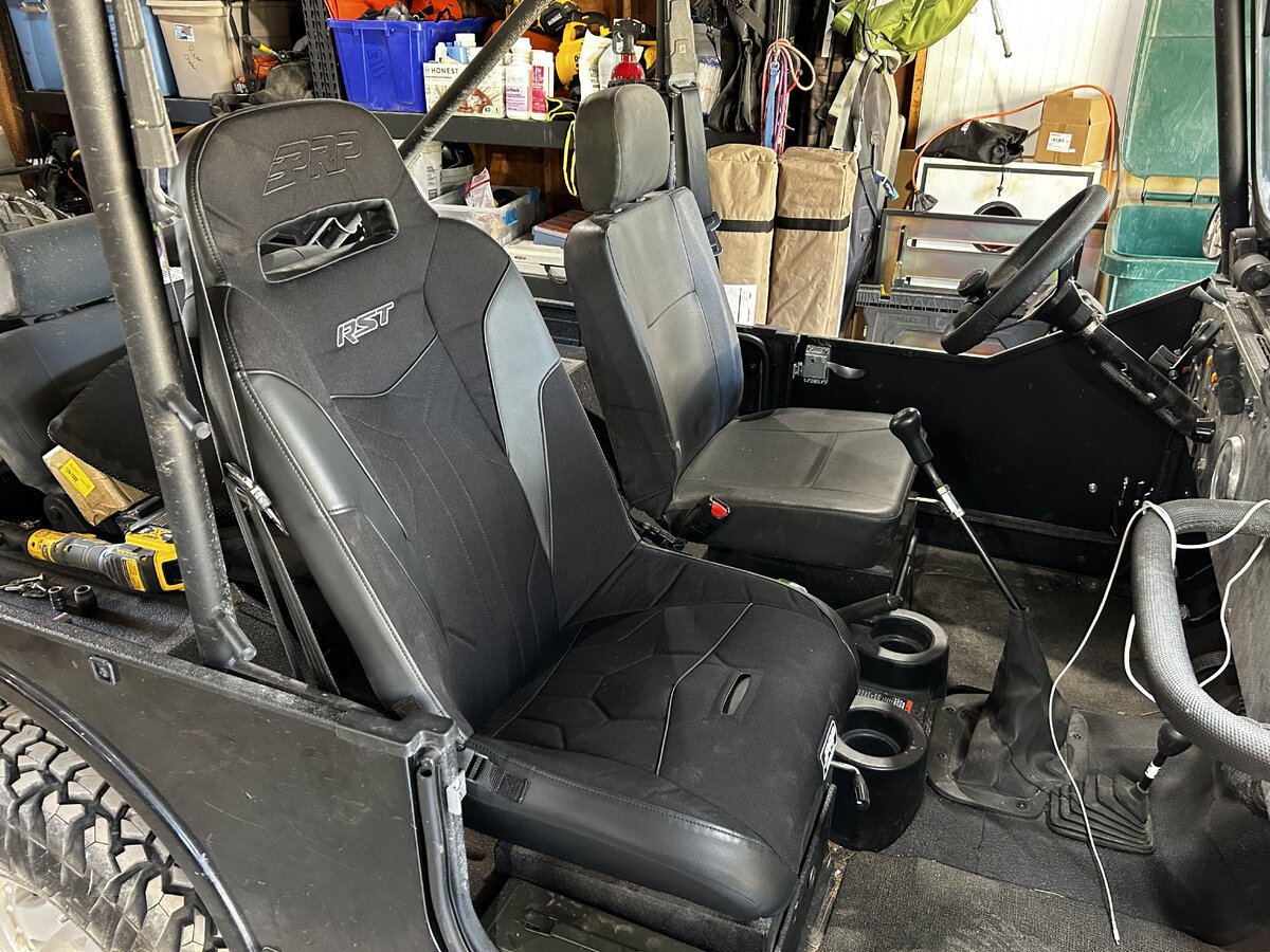

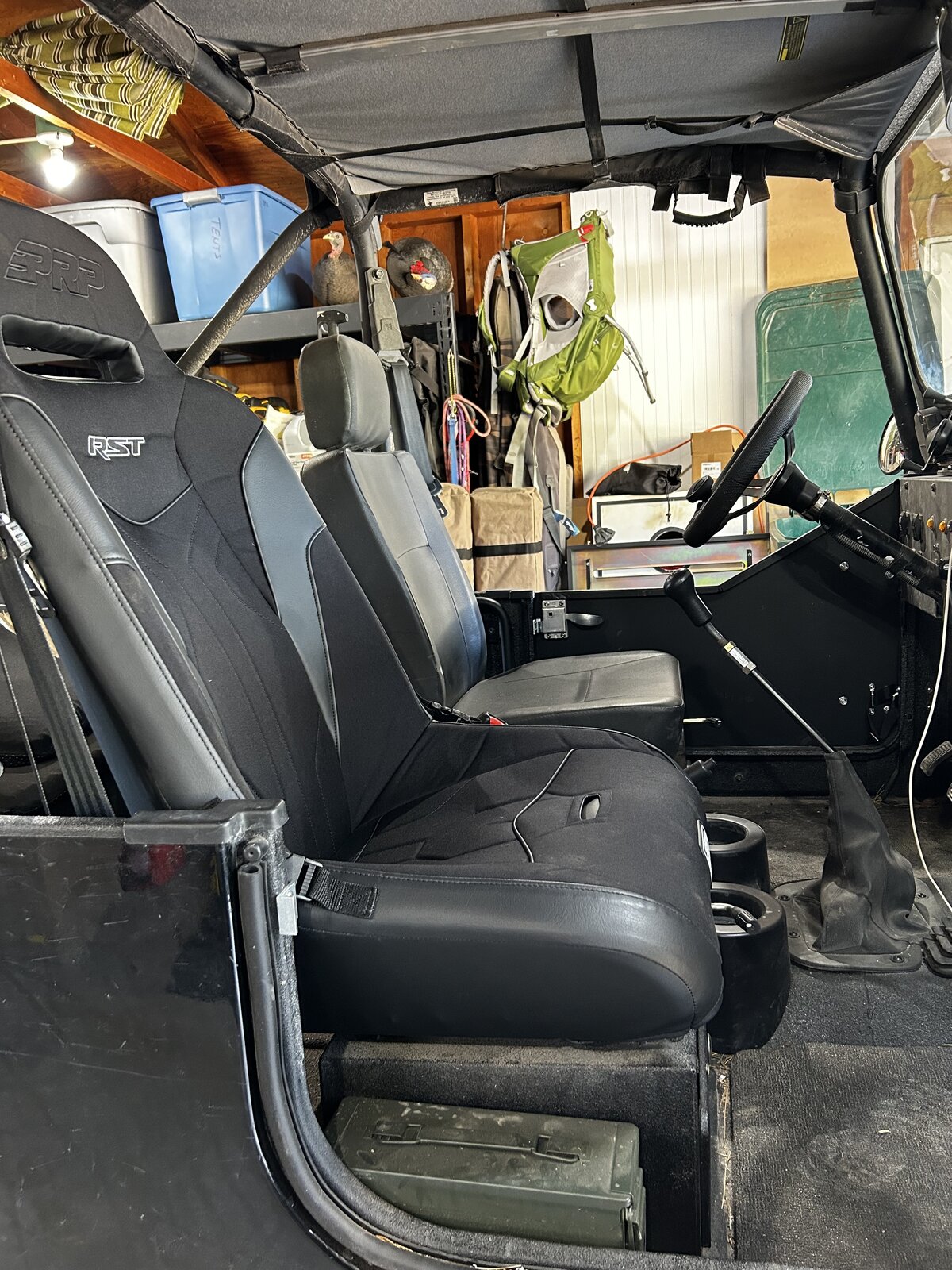

If you order the seats with a Polaris RZR base. All you will have to do is enlarge the 4 hole from the slider to the seat base and get bolt with nuts to mount them. No additional mounts necessary. At least this was the case with my 2022. YMMV.
See this string. PRP Seats
