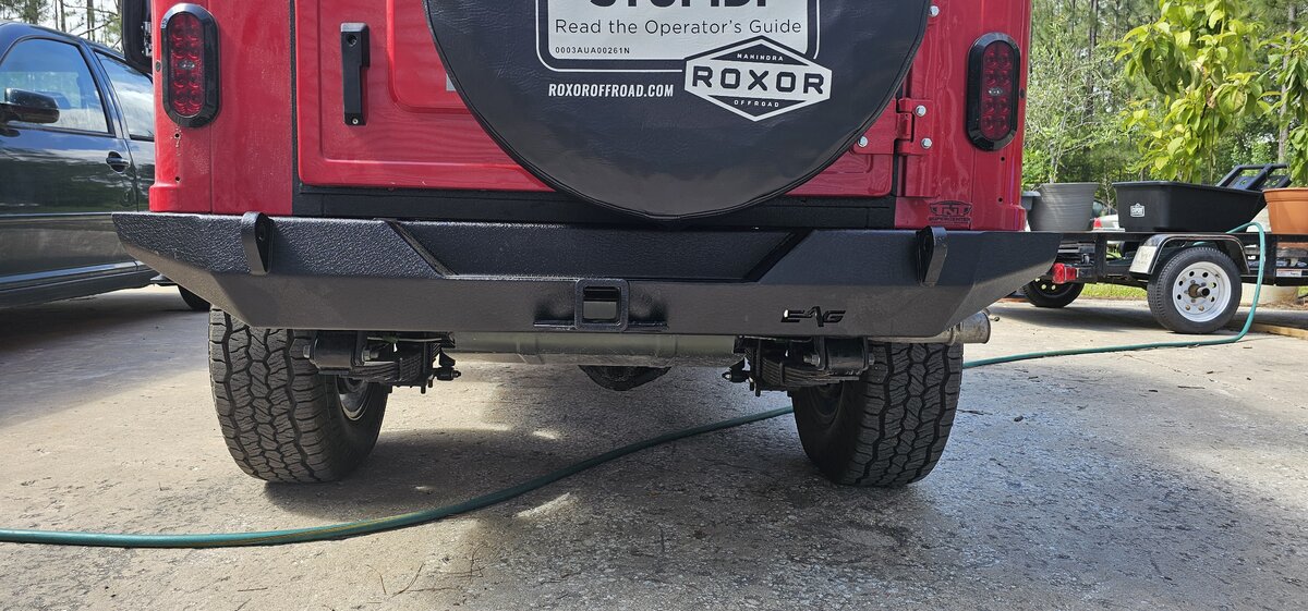

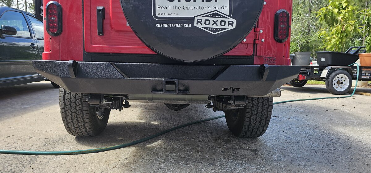

I started my bumper install. I took a 4 inch channel and welded two plates on it to match the TJ bumper I had bought. I picked up 16 holes from the rear frame of the Roxor on the channel. Tomorrow I will clean it up and paint the adapter.

I wish I could weld. All I did was weld up an adapter for the store bought EAG bumper.
1,304

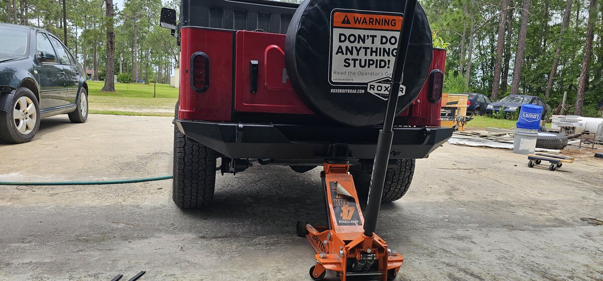

Finished installing the new rear bumper. Had to short stroke the wrench a bit in that tight place. The weak link will be my weld or the rear frame member of the Roxor.
Locking hubs or rear locker is next on the list.
Hate to be bearer of bad news but the weak link is most likely the bumper itself. Those EAG’s are known to fail. Most find the failures when trying to use the D ring mounts for a recovery. The metal will actually tear. Just keep that in mind when actually using it.
My plan for this bumper is to tow around a small trailer. I wouldn't do a recovery from that point anyhow. I have only used recovery hooks bolted to a frame. I have seen recovery hooks on Jeeps break off.
Thanks for the tip on the possible quality issue.

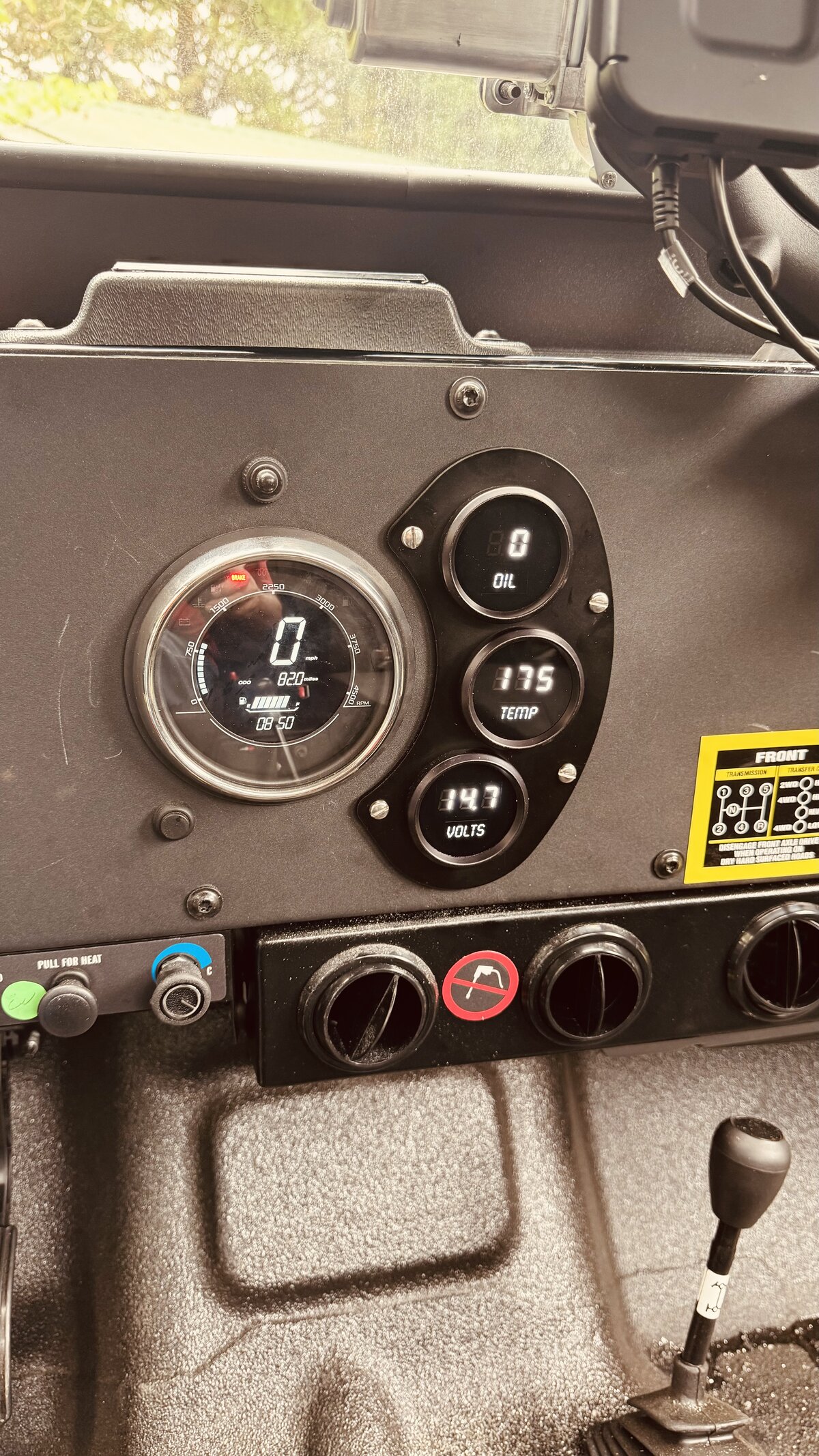

Installed the new rear wiring harness from XTC for my turn signal kit (the kit I purchased was old and had a rear harness that did not work correctly with the 24 models). Installed Intellitronix digital gauges using a Diesel Freak panel. I prefer traditional pointer style gauges but with the all digital cluster I chose to go digital. I have a love / hate relationship with building wiring harnesses - hate doing it but love the end results. Harness uses weatherpak connectors so they can be easily replaced if needed. The sharp of eye will notice 0 oil pressure at idle … the sender with this kit is too large so I will have to remote mount it when the tubing kit gets to me.

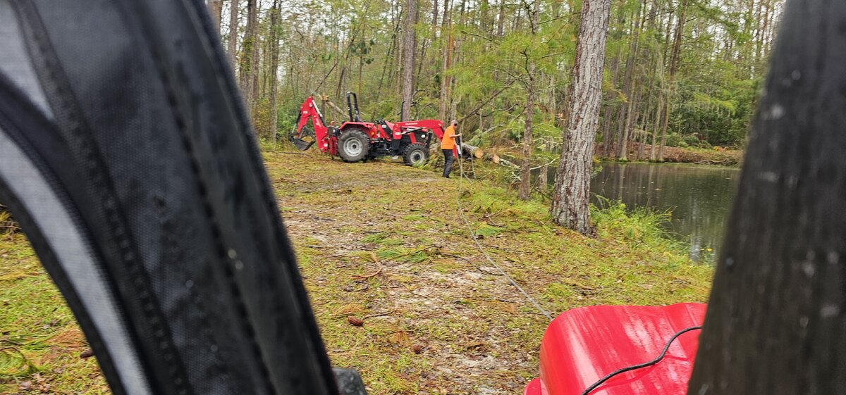

I am truly privilege to have my Roxor and my Mahindra tractor to clean up after Helena. We got hit hard here in South Georgia.
