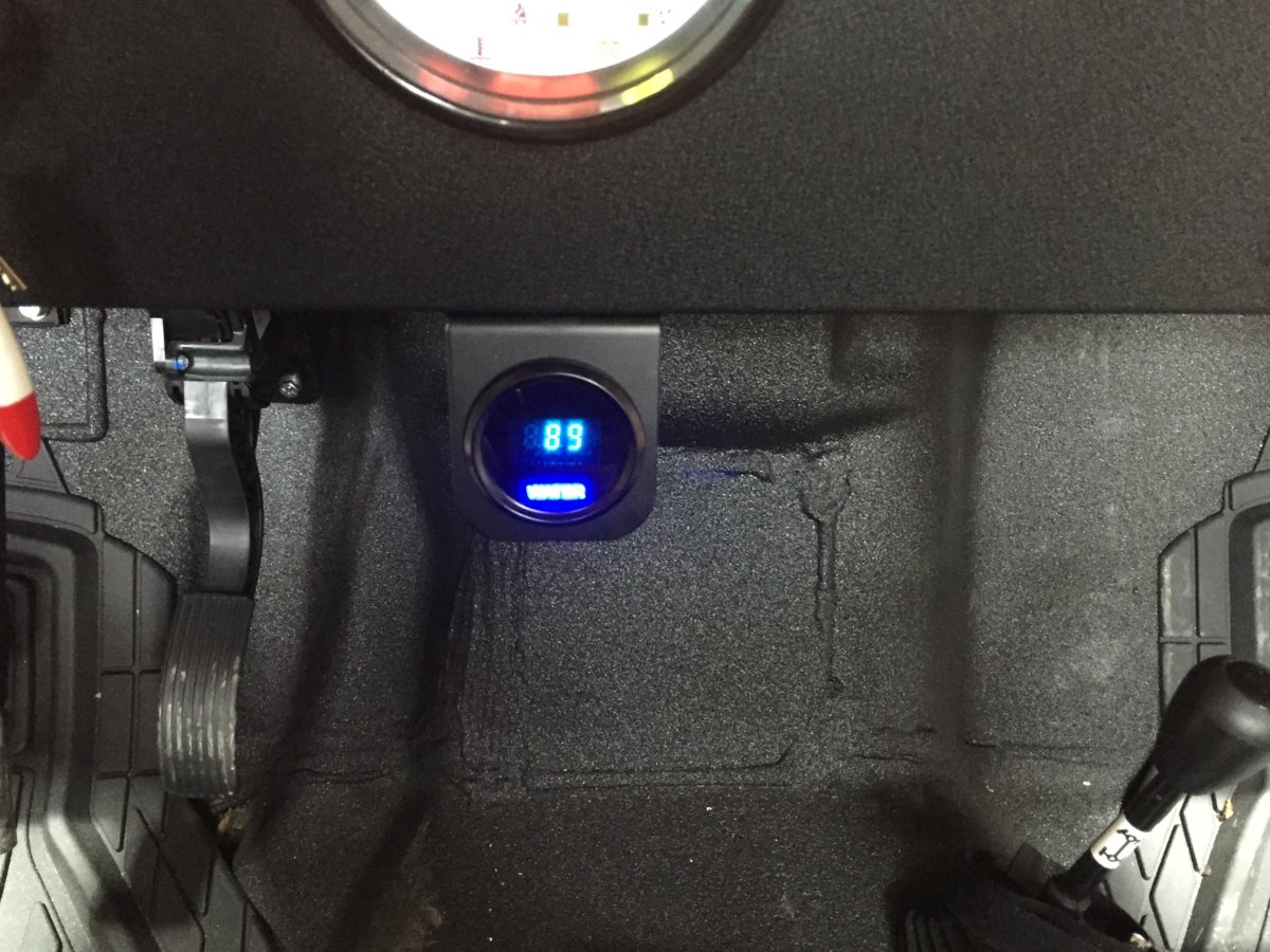

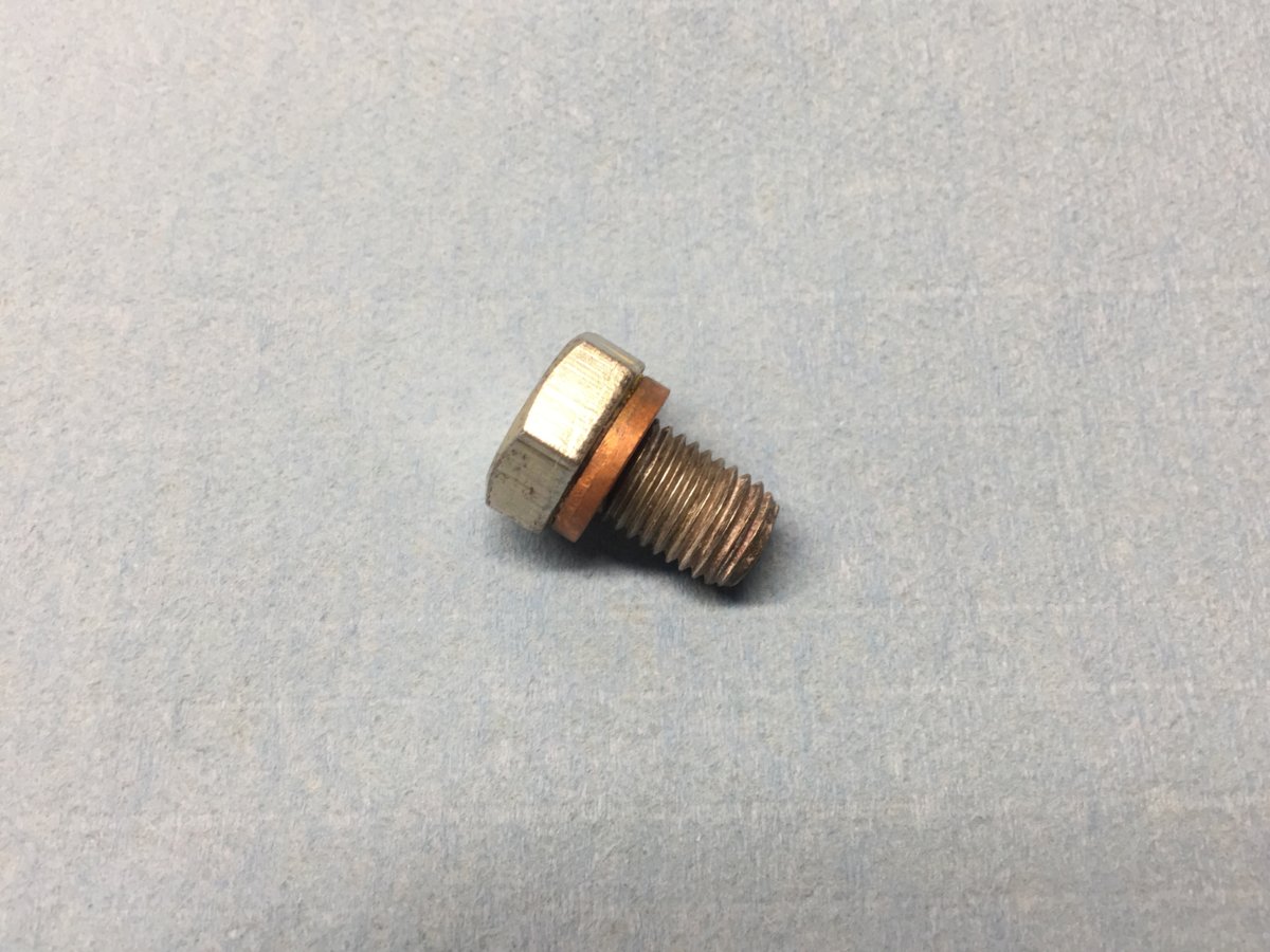

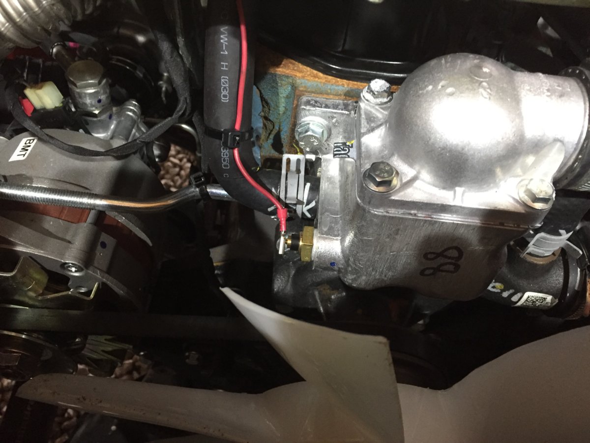

I recently added a temp gauge just to try and catch any heating issues with the non-shrouded fan design. I planned to use a mechanical and tap into the T-Stat housing but unfortunately found the port too small so I went electric. For those who might consider this little add-on the port is M12 x 1.5. I've attached pic of the plug and the installed SU. Incidentally I went with a "Dakota Digital" digital readout gauge and their SU.

Nice, that seems simple. How did you mount the meter?

Mounted to bottom rolled edge of dash plate with single gauge mount, don't plan on any others so that worked for me. I did shim the gauge mount a bit so as to angle the lower edge upward for better view angle. A poor quality pic is attached, doesn't really reflect the angle but it is easily viewable. There is so much room on the dash plate multiple gauges could be easily flush mounted in the plate, I just didn't want to take a hole saw to it for one temp gauge.

Nice setup. I can see fuel pressure, boost, egt and temp.

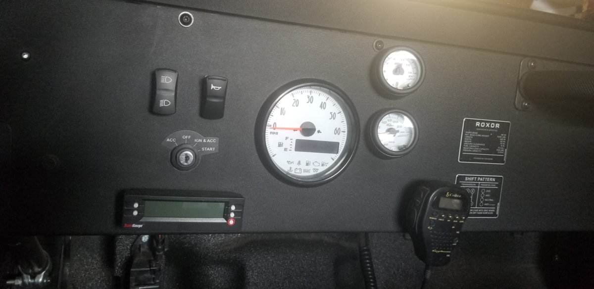

I had a used and dated ScanGaugeII in the shop and installed it this week, works great. Got my OBD adapter from OBD Diagnostics in CA. There's a forum member JMB3 that has a link on here for a great write up with all the details on moving the required OBD adapter pins, super simple.
