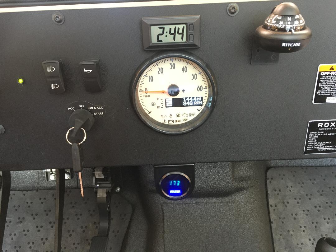

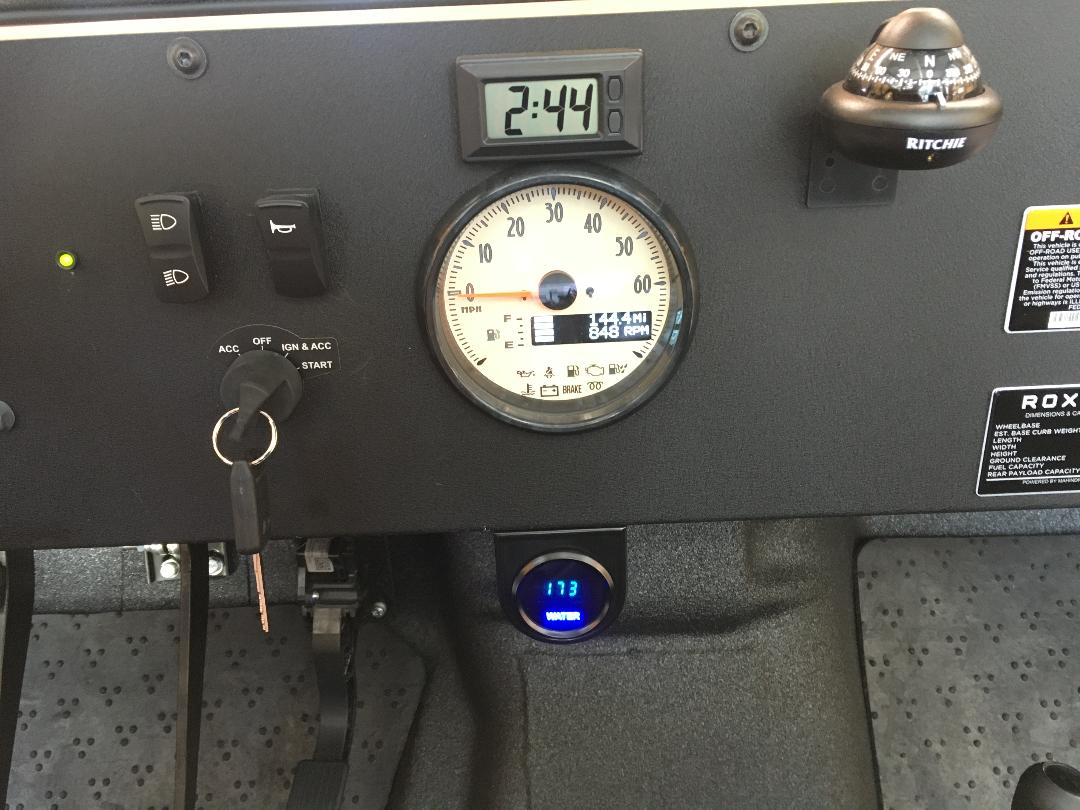

I followed what others above did (WoodLot, Roxasuras) and stalled the temp gauge. So far I've never found any indications of high temp so not sure why I would need the shroud.
You probably don’t.
I just added it because it was cheap and easy. I sorta feel it will be better for my engine in the long run. It gets hot down here in mid summer. I’m pretty sure my engine is running a bit cooler in all this heat.
Im no mechanic so who knows.

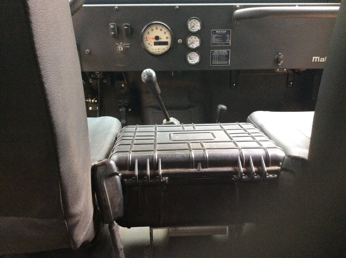

I used the diesel freaks gauge set. Needed to know oil psi and eng temp. Very happy with the gauge set.
Nice install. Made center console harbor freight Pictor gun case fits perfect between the seats.
