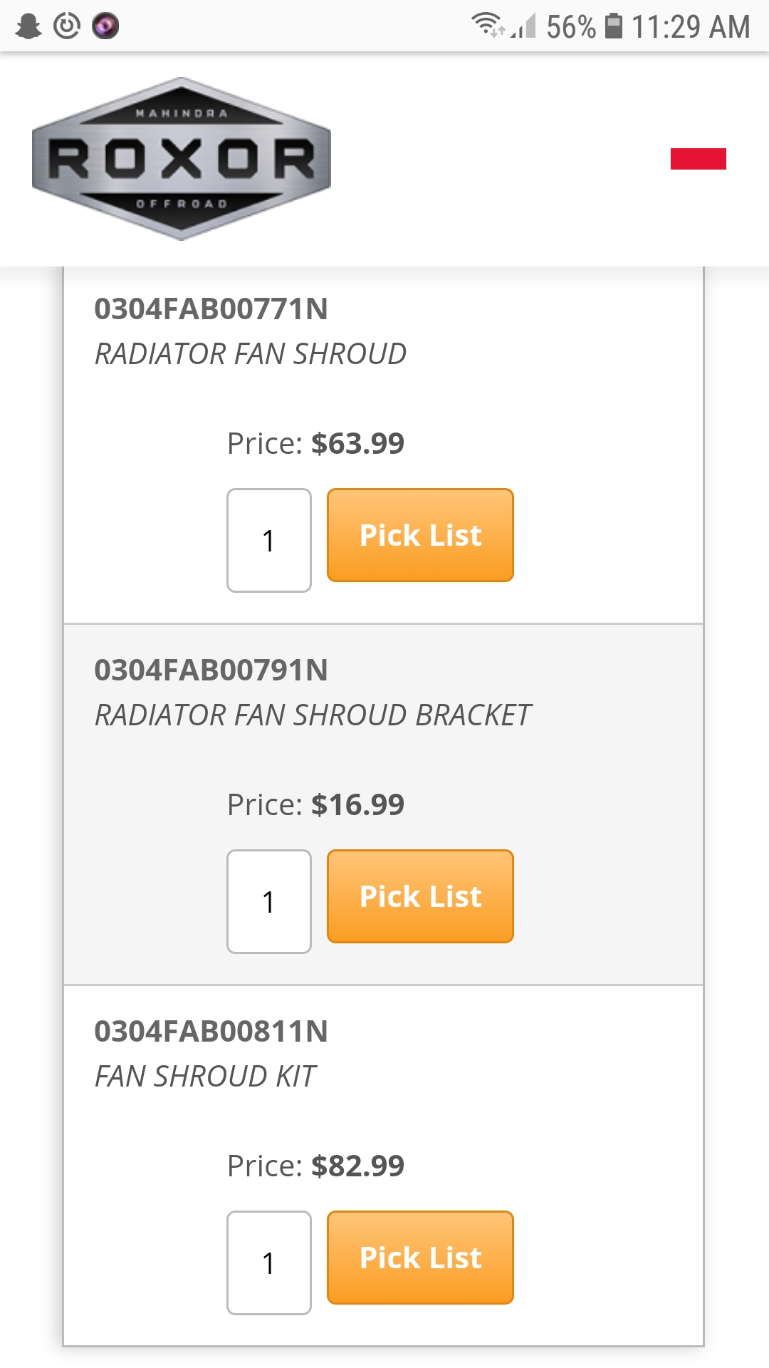

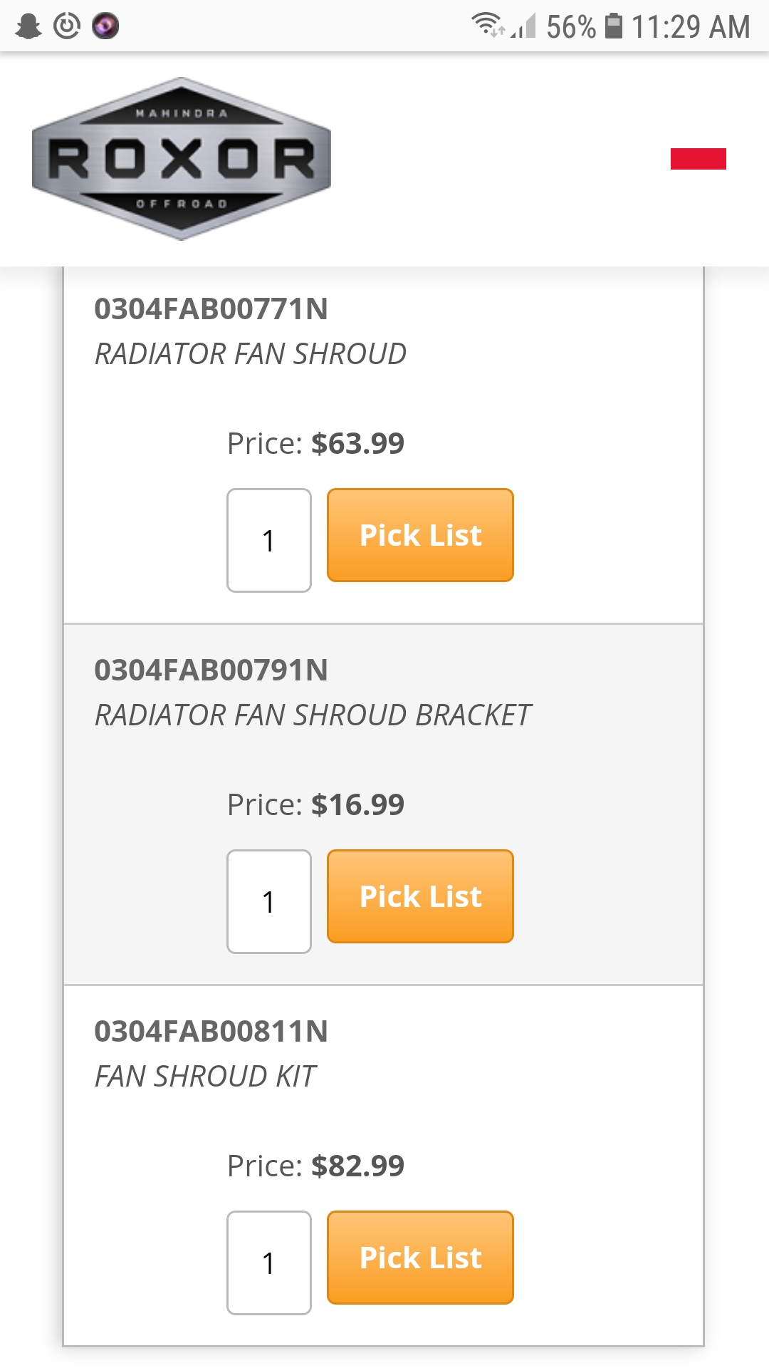

You can get a fan shroud as an accessory from Mahindra for these. The shroud only comes standard if the Roxor has an automatic transmission or air conditioning.

I definitely want to get that shroud ordered. Not for cooling, but to protect the radiator. I can't be the only one that is having problems with large weed stems finding their way into the engine compartment between the fan and radiator then beating the crap out of the fins. It should be standard on all of them!

Can anyone confirm this is the correct part number?

This is the link. It's through roxor, but you order it to your dealer I guess? I have not tried this yet, so maybe the dealer will still want to put on their mark up. But knowing cost could still be a chip to have them give me a deal. Say $110 instead of 130 maybe
I just followed the link and it shows $132.00!?

I just put the new shroud on my Roxor. It was pretty simple to do.
I received my shroud to day. Took about an hour. I feel better about this “accessory “ than anything else I’ve done. It is difficult for me to understand why this isn’t standard equipment.
My diesel tractor doesn’t have a shroud and you have to watch it constantly for over heating.

I received my shroud to day. Took about an hour. I feel better about this “accessor“ than anything else I’ve done. It is difficult for me to understand why this isn’t standard equipment.

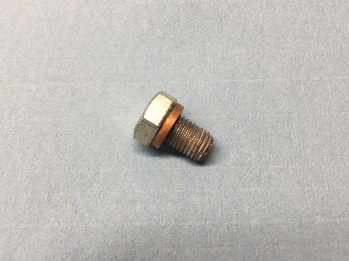

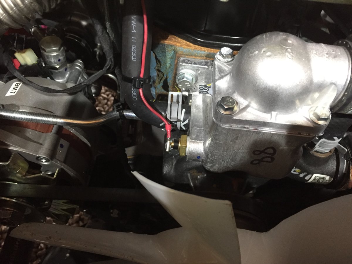

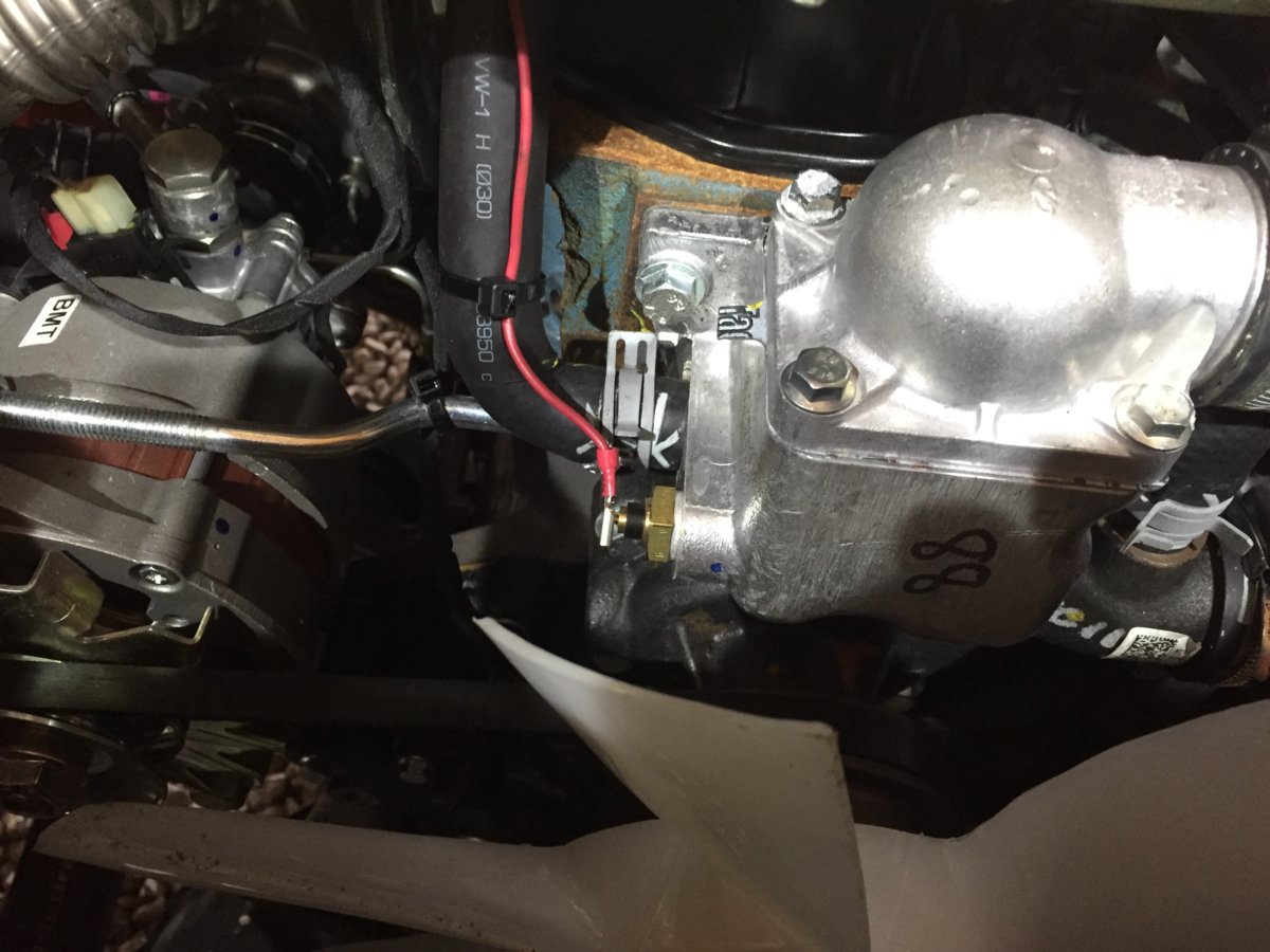

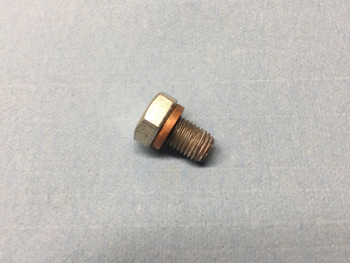

I recently added a temp gauge just to try and catch any heating issues with the non-shrouded fan design. I planned to use a mechanical and tap into the T-Stat housing but unfortunately found the port too small so I went electric. For those who might consider this little add-on the port is M12 x 1.5. I've attached pic of the plug and the installed SU. Incidentally I went with a "Dakota Digital" digital readout gauge and their SU.
View attachment 710View attachment 711
For the mechanically challenged- like me - what kind of adapter do I need to install the Dakota sending unit in the M12x1.5 port?
