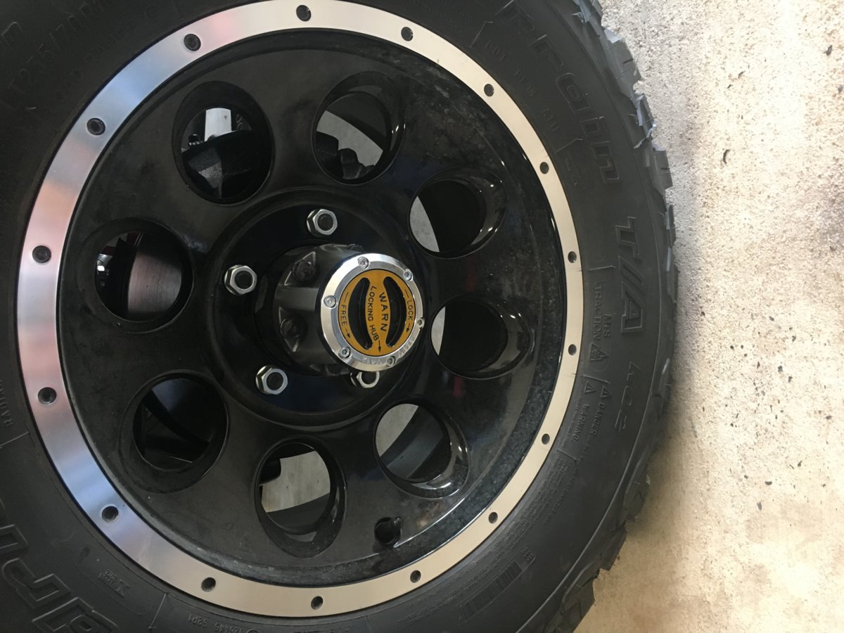

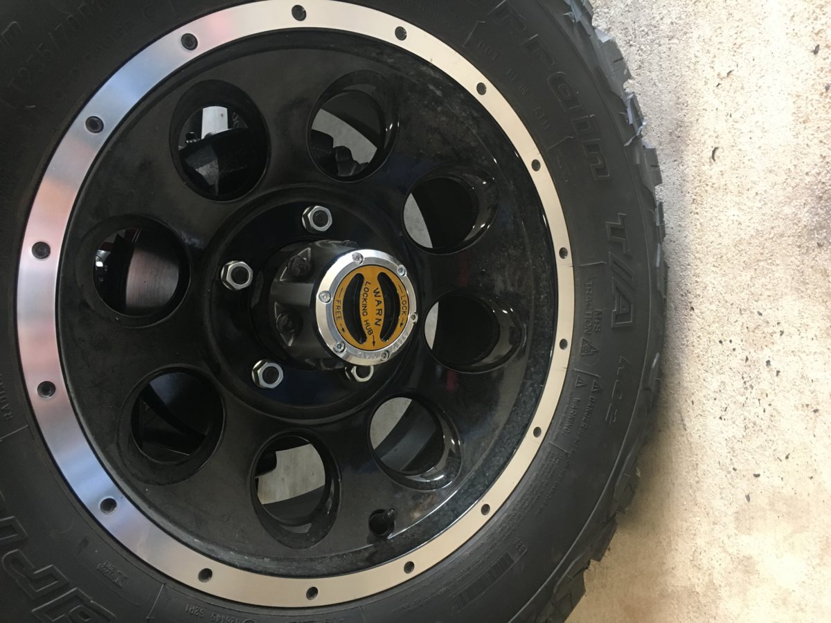

I finally had some time to install the Warn locking hubs, the install was super simple and took 30 minutes start to finish. Both of mine were difficult to put in four wheel drive much less trying to get them in 4 low, I thought maybe things were just tight from being new. After the hubs the transfer case moves easily in any selection. I wanted to be able to drive in 4 low with the front end unlocked in the pasture when it was dry because of the difficulty turning with front end in a bind, the ease in shifting the transfer case was just a major bonus!

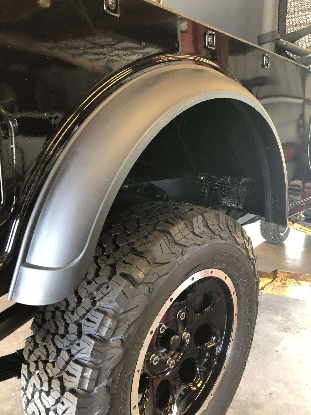

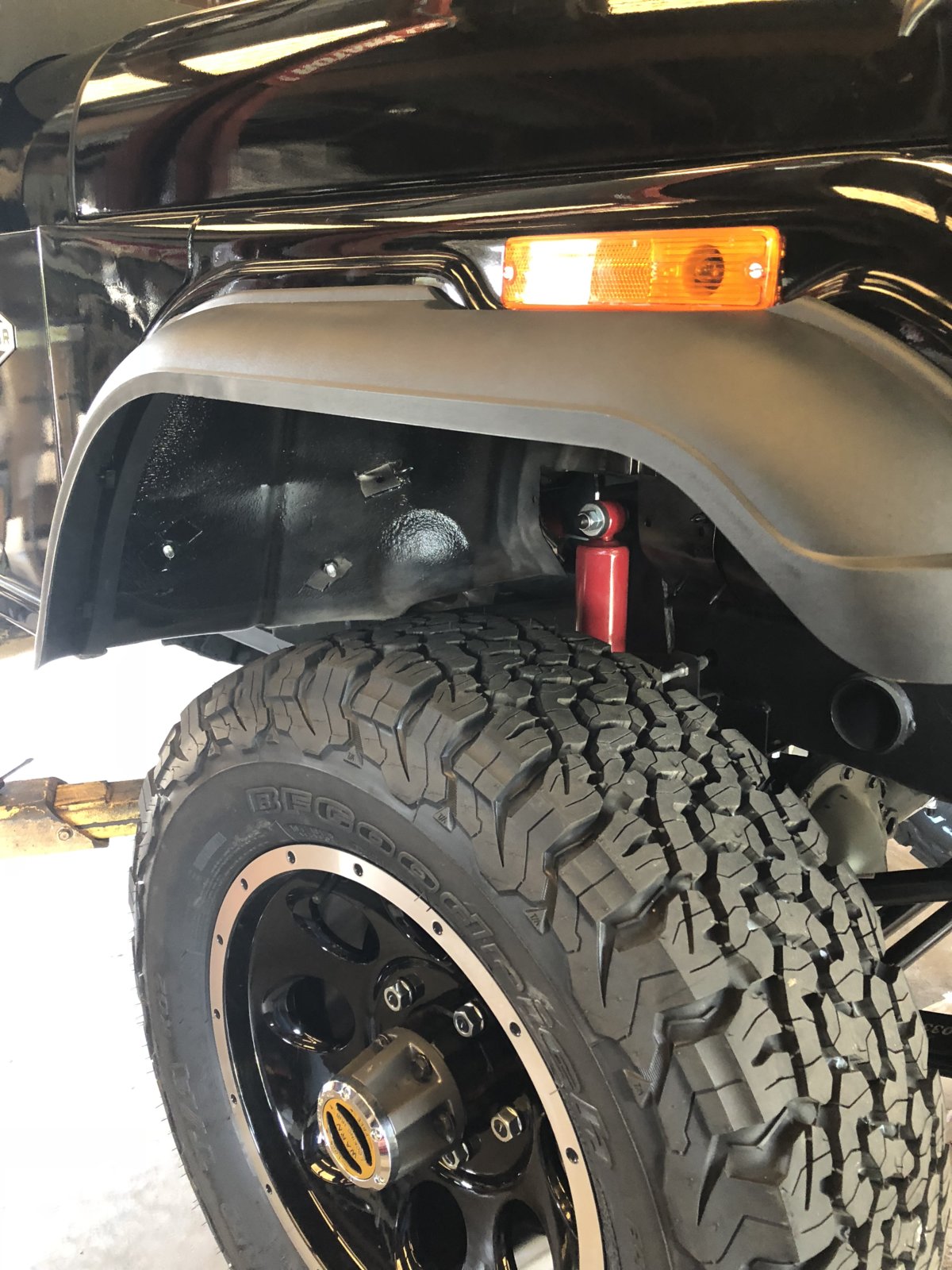

Also for anyone looking for flares, this kit from crown automotive part # J8997109 is an oe style flare for 55-86 Jeep cj fits great. Only big downside is you have drill holes.

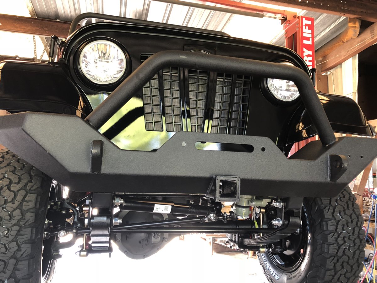

An aftermarket TJ bumper will fit but only came with some u bolt mounts to secure it. It’s a winch mount bumper but I wouldn’t feel comfortable mounting one to it and using it. There are a lot of TJ options that aren’t a winch mount that would probably be fine. I’ll update tomorrow on the vivid racing tune I received today but first thoughts are a night and day difference.

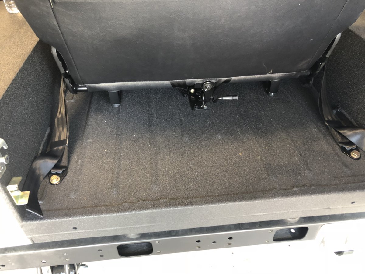

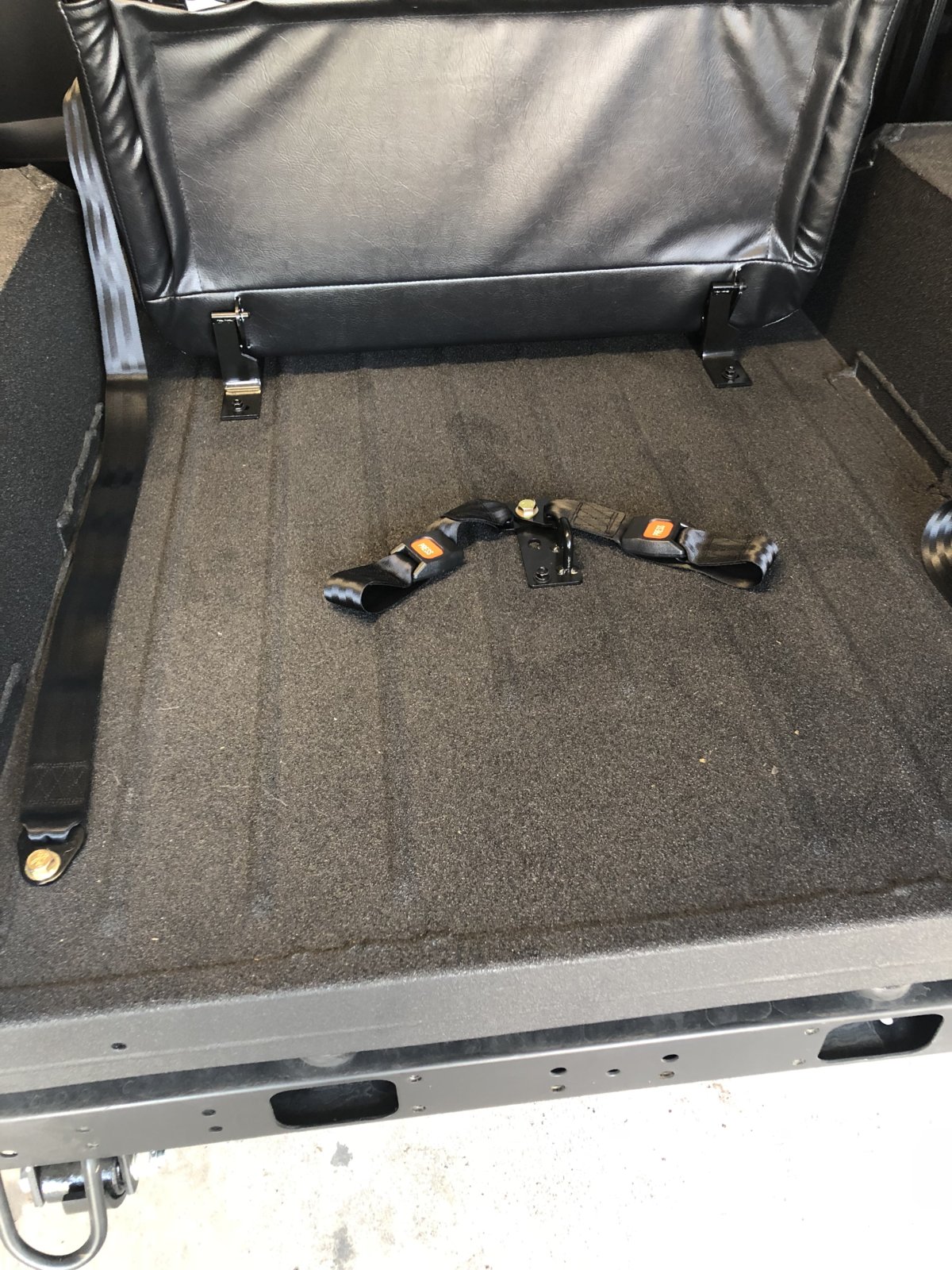

I also forgot to post the seatbelts I used for the rear seat so here they are.
My Roxor sourced Warn hubs just came in with the install and general operating instructions with them. Under operating instructions: " Do not drive with the hubs in FREE and the transfer case in 4 low. This will place excessive strain on the rear drive train." I am not sure what "excessive strain" is and how driving in this fashion can cause this. However, I plan on testing this and also plan on more excessive strain when I get a stage 1 tune.
Many of us just leave the transfer case in 4 low all the time ( except on open highway travel ) . With the tune it’s even more needed.
That is translated into: don't be an idiot with 2LO. 2LO is used for all sorts of stuff in the 4WD world. Just remember to be VERY light on the skinny pedal.
