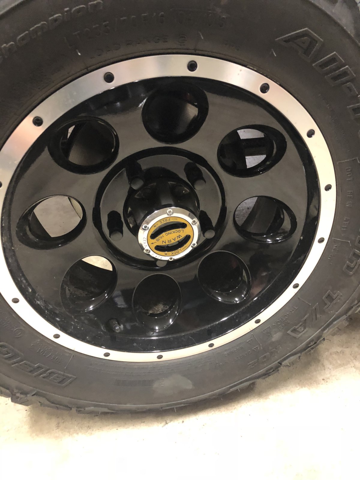

OK I put the hubs on this morning with the following: it took me 30 min to jack up the Roxor and pull the dust covers off (PITA) Conclusion: if I were a flat rate mechanic, I would starve. But, the hubs were well worth the money and effort. I had no problems at all running 4 lo with hubs unlocked. My take away; pull the wheels, remove the hub bolts, and use a sturdy flat bar to access the flange, use whatever combination of bad words that seems appropriate, and the second hub is easier than the first.
876
You don't have to jack it up or pull the wheels to do Warns (note: I've done these twice before on Willys, so I had XP going in). The dust cover pries off. Just gently work your way around it with a pry bar. After the flange is off and the new hub is on, but coverless and not clipped in, reach around and take all the 'play' out of the axle shaft. This will expose enough to get the clip in. Clip it, toss the cover on, and bolt 'er down.

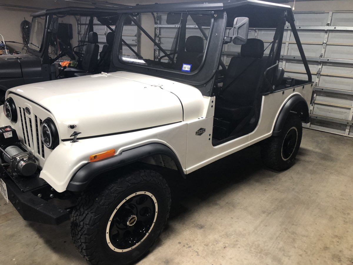

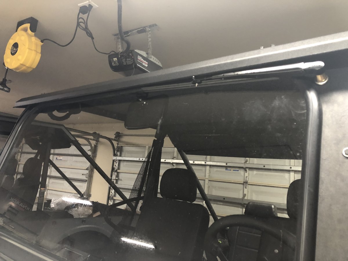

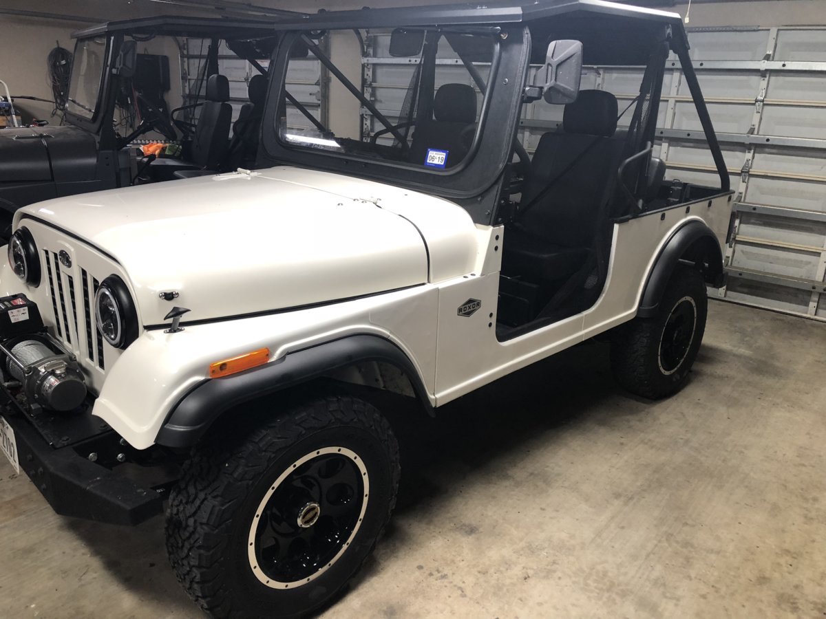

My fortress windshields and tops came in this week and I finally had some time to install them. I would say fit an finish are good not great but overall I was pleased with them. As for the install, you will definitely need an extra person. Roof install was the easiest, but the windshield and wiper kit not so much. Either you have to have tiny fingers or an array of swivel sockets and extensions to get the 4 upper bolts installed. Bottom mounts are strong and use existing bolt holes. The wiper kit is where my expectations fell a little short, it’s a fairly large assembly for just a single wiper. After getting the spacing correct from the windshield frame and wiring it up per the instructions and running a full sweep to oriantate the wiper arm correctly, something didn’t seem right. The wiper arm was way to long and would hit the hood if you used it. Nothing in the instructions to help here but the wiper arm is adjustable in length and if you remove it from the housing and cut about 2” off of the end of it problem solved. For the price of the wiper kit, I would have have expected much better. Overall I am happy with the quality of the windshield and top, much better than the factory windshield and top.

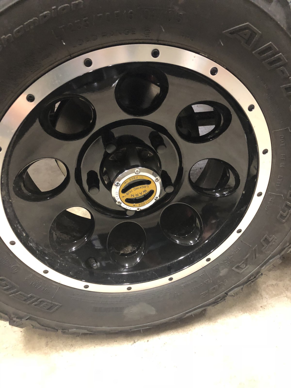

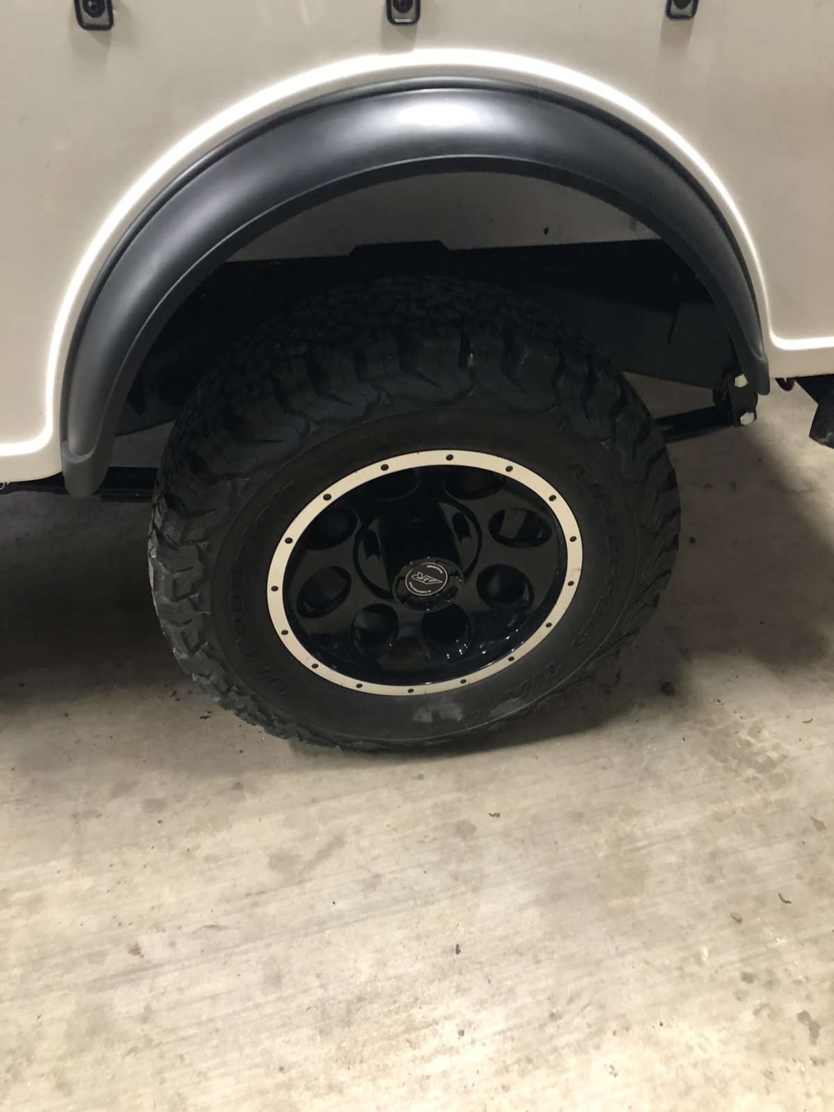

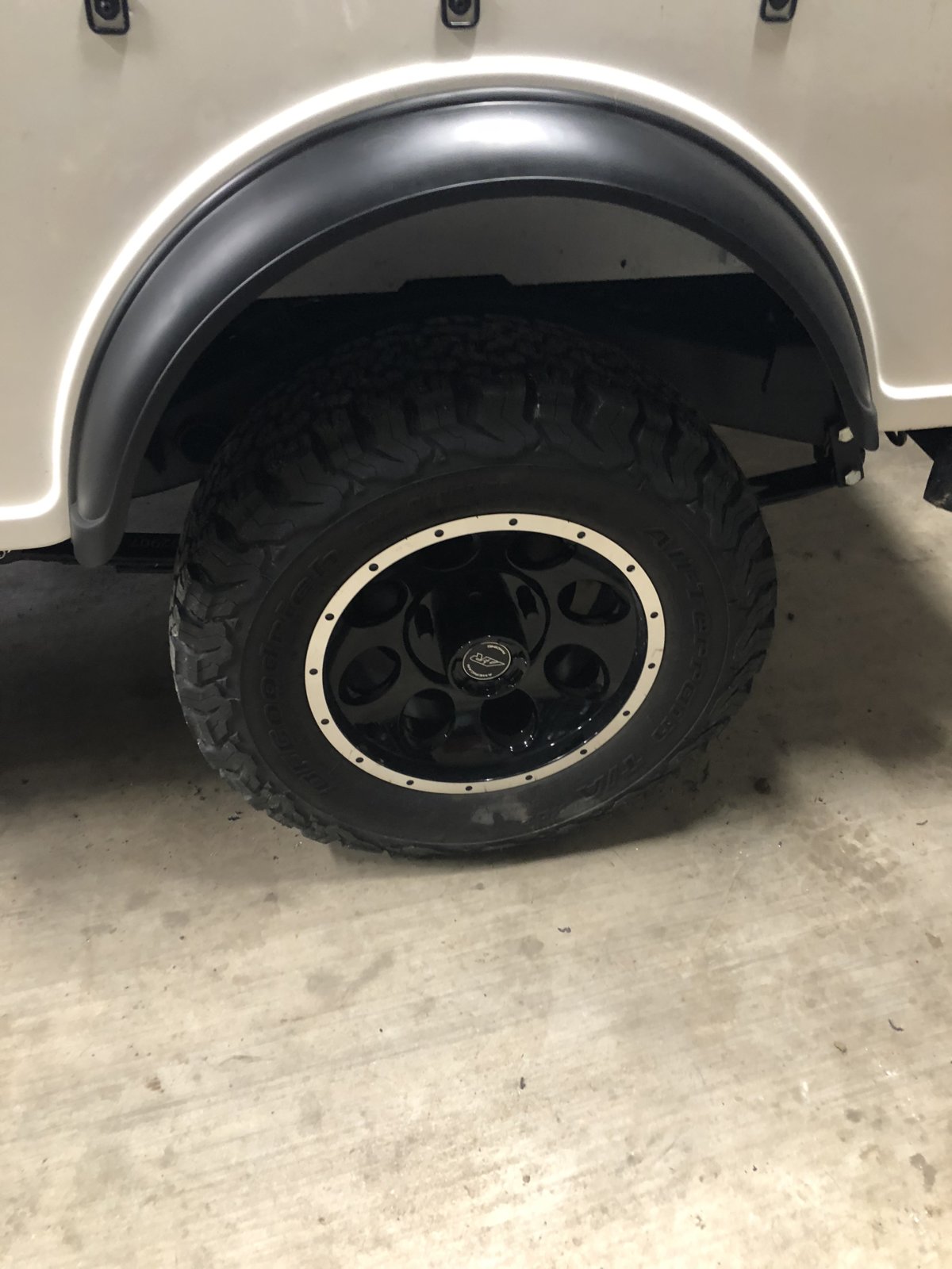

I also got another set of OE flares installed along with 1 1/2” wheels spacers, some rear center caps I found that were gloss black to match the wheels, and some black acorn closed end lug nuts. For any of you wanting to know, the thread pitch for the factory studs is 1/2 x 20.

Looks awesome brother! I just got my top and windshield installed. Saved the wipers for tomorrow.

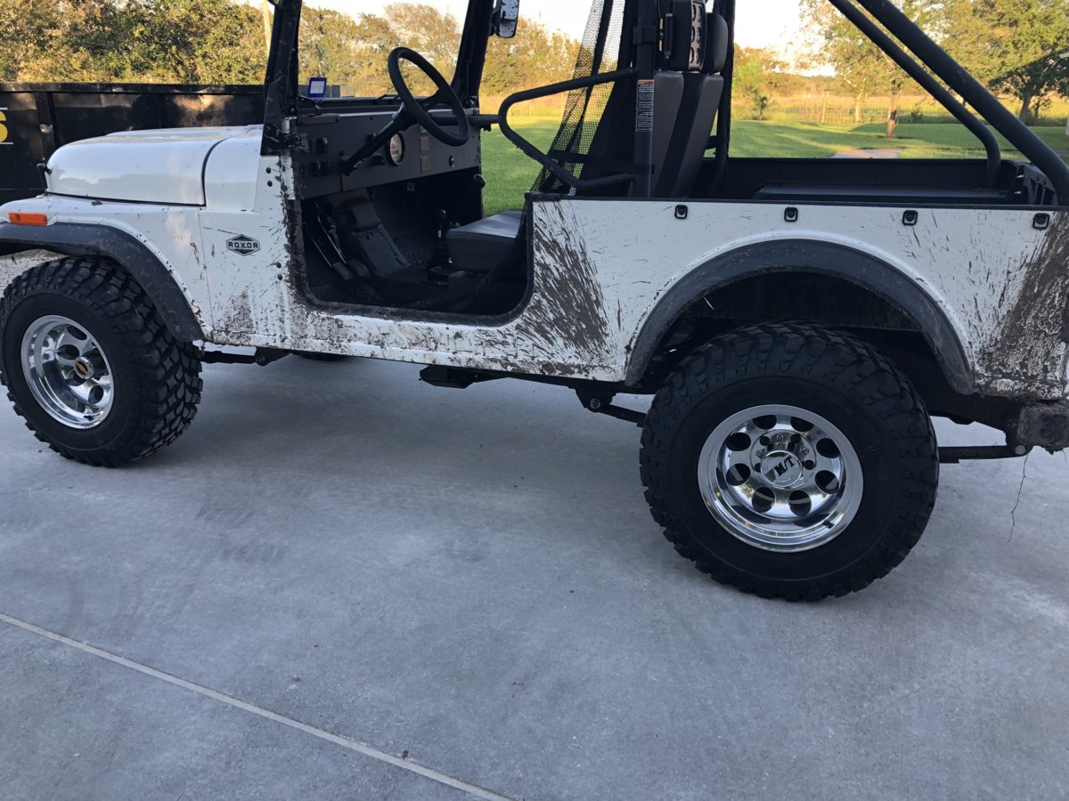

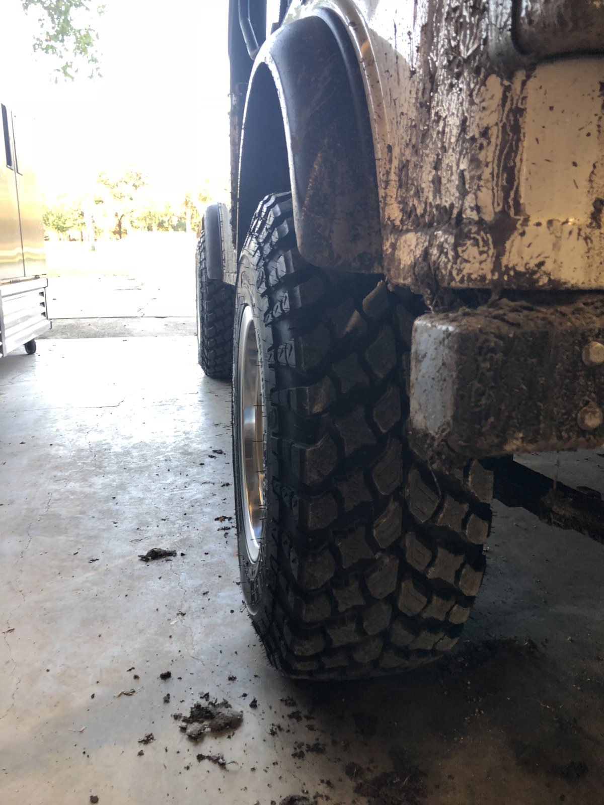

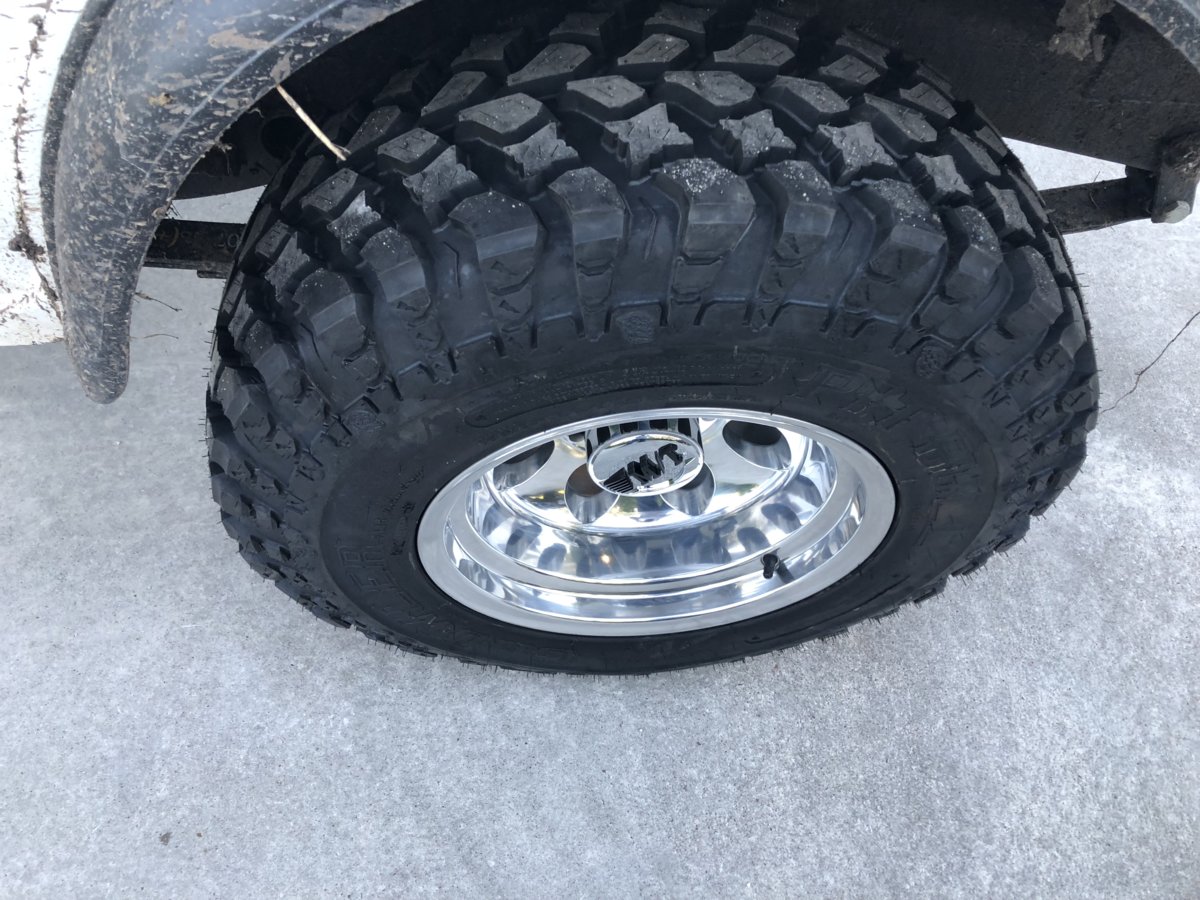

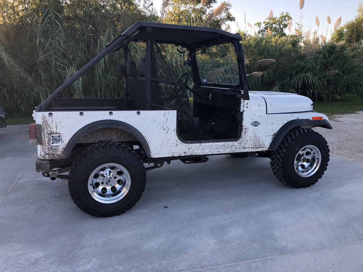

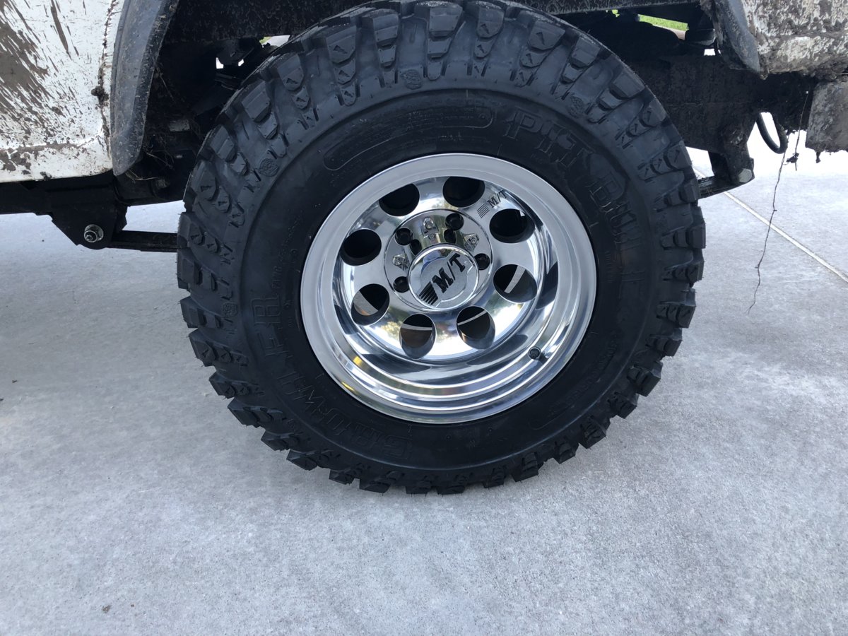

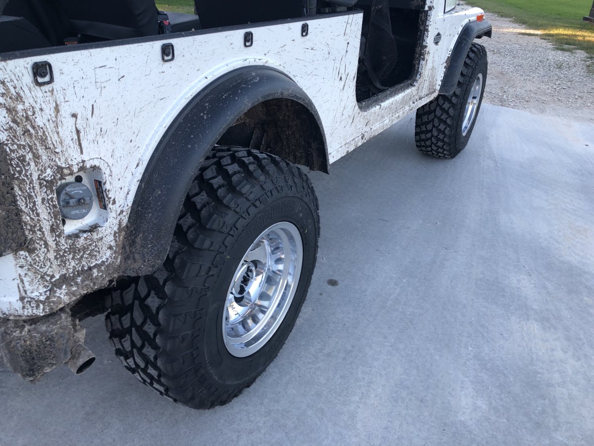

Even though the white one is sold, I thought I’d post a few pictures of the wheel and tire change I made for the customer. He wanted something that wasn’t much taller but much wider. That was the only info I got from him so here is what I ordered. Wheels are 15x10 Mickey Thompson classic 3’s and tires are pitbull growlers that are dot legal, size 30x10x15. An 8” wheel would have been much better but he was after the flotation tire look from his cj’s years ago. Getting a 10” tire mounted on a 10” wheel isn’t fun but the results were worth it. Enough rambling, here are the pics. By the way, it cleared the front bumper but was very close. I removed the bumper to modify it and will post pictures when done but this is a lot of tire with no lift. The wheels are light and the shorter tire did not effect performance at all.

Great Build! Where did you get the spacers and what model no. is it?
Thanks, I got one set from rugged ridge part # 15201.09. That is for a pair of them not all 4. I ordered another set off of eBay, they were half the price and worked just as well.

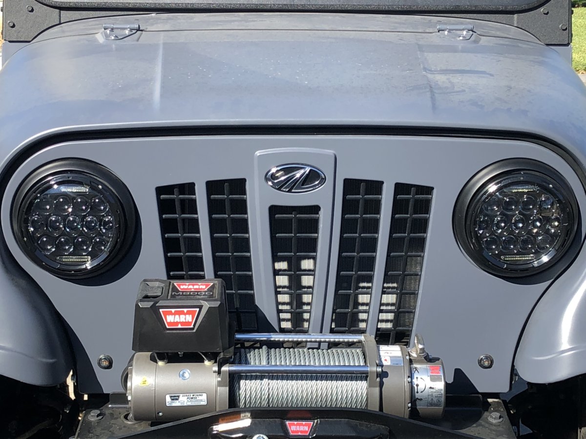

I got another new set of headlights today. They are cheap eBay lights but a huge improvement over stock. They are led with a H4 connector, plug and play. As with the last ones, you have to trim the headlight buckets in 2 spots but this a 5 minute job with a dremel.

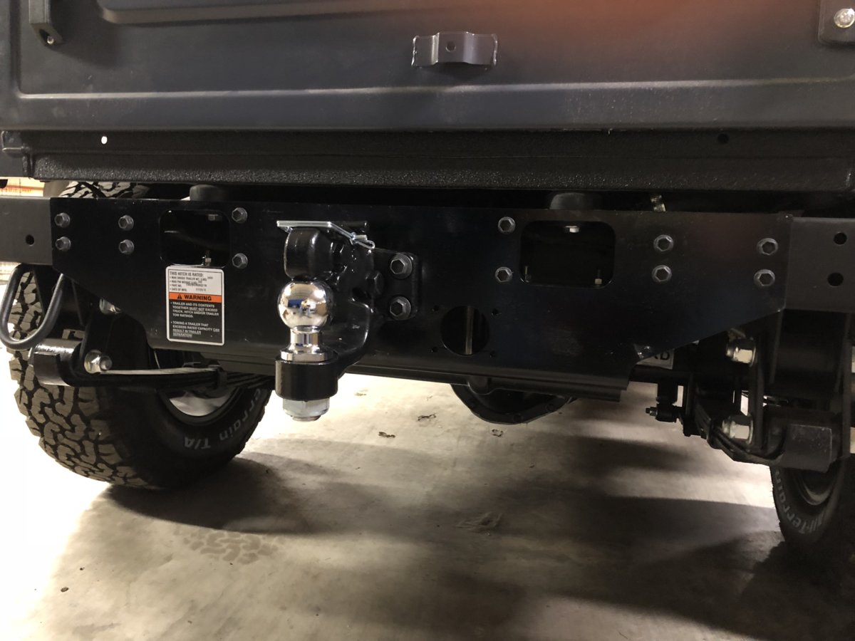

Picked up a Mahindra Pintle hitch today along with a strong made rear receiver hitch. I installed the one from Mahindra today and I’ll try the strong made tomorrow. The install of the pintle hitch was super easy and I have no doubts about how well it will hold up. Very stout setup. I’ll update tomorrow after trying the strong made.
