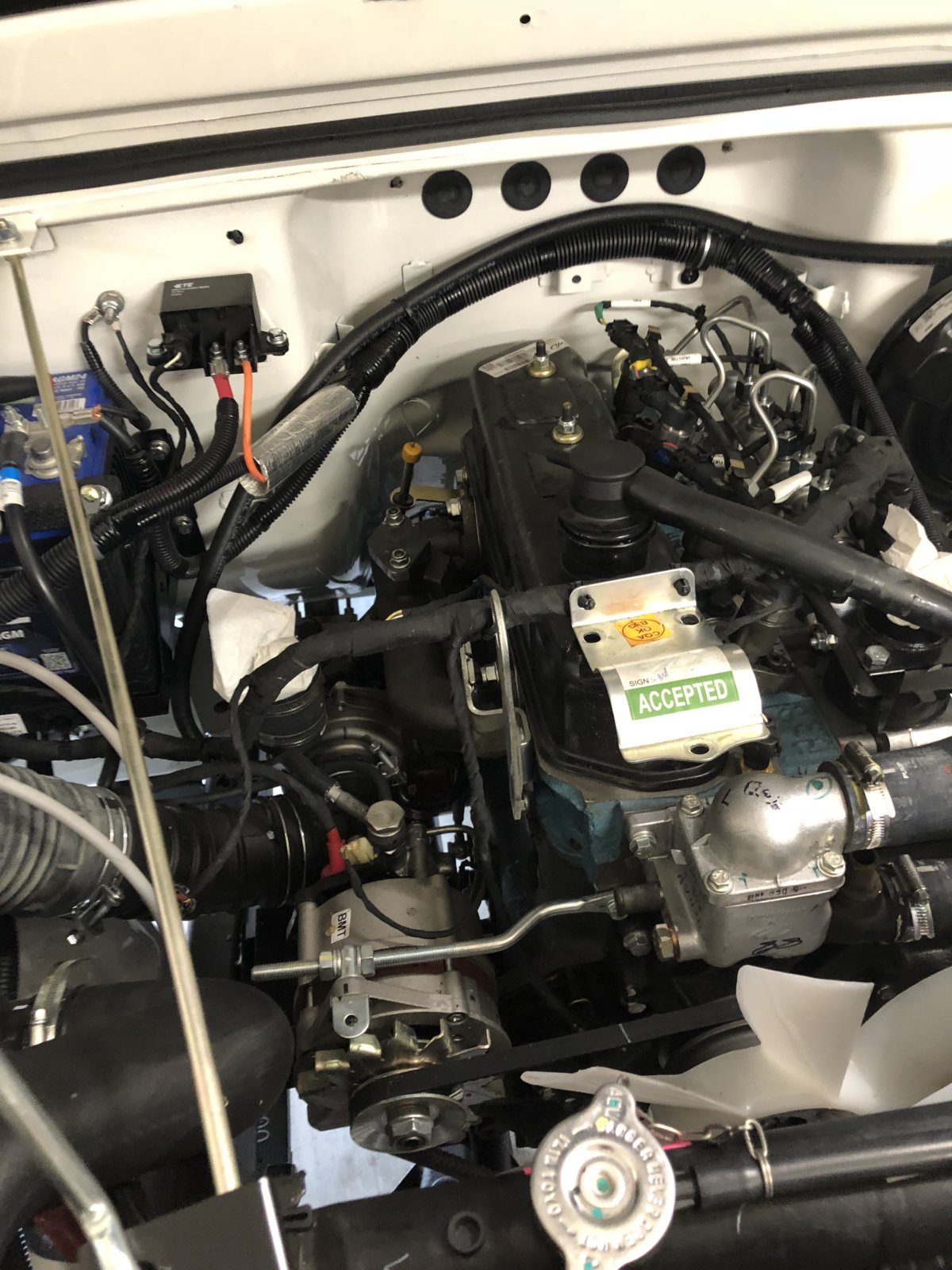

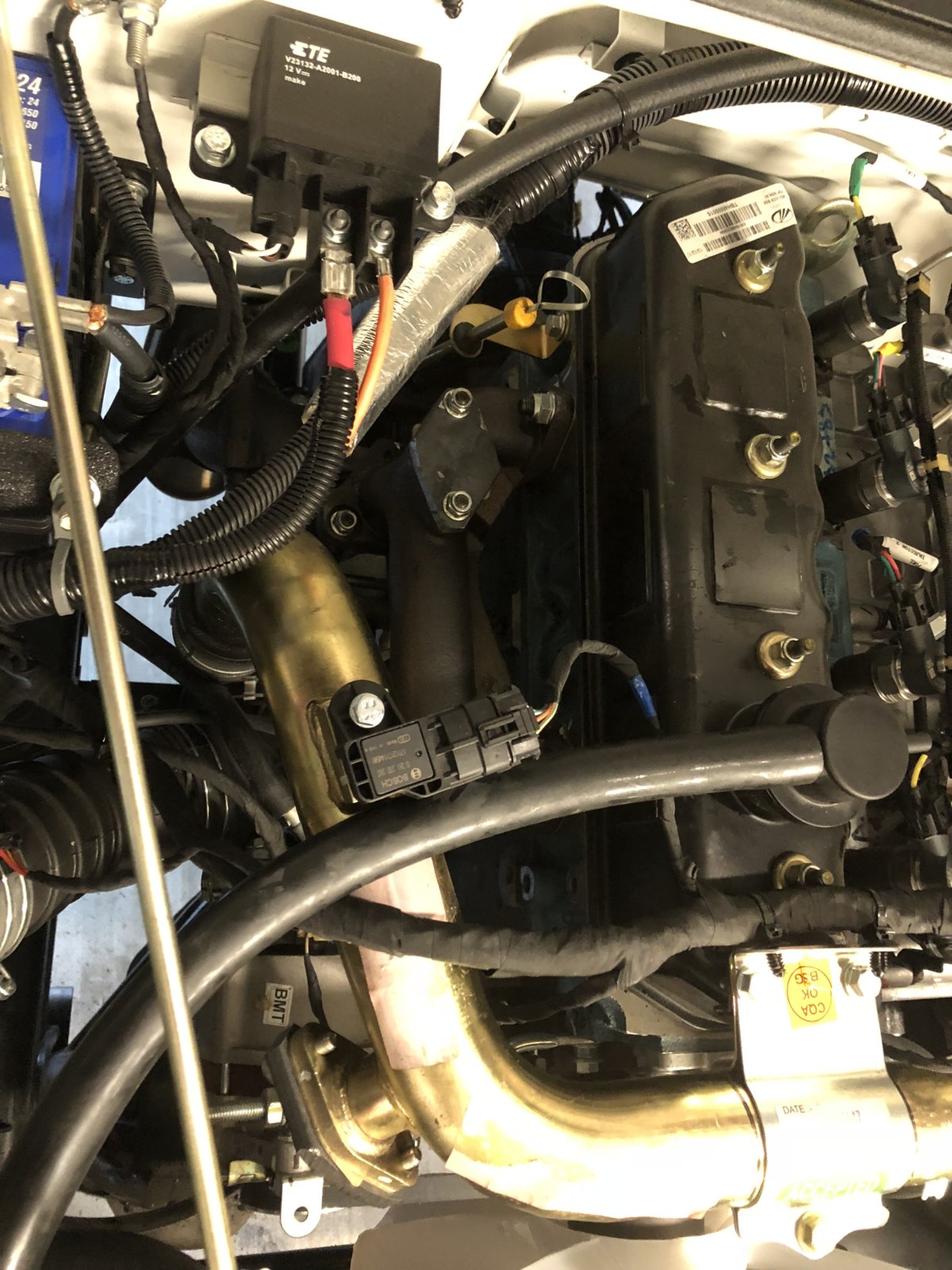

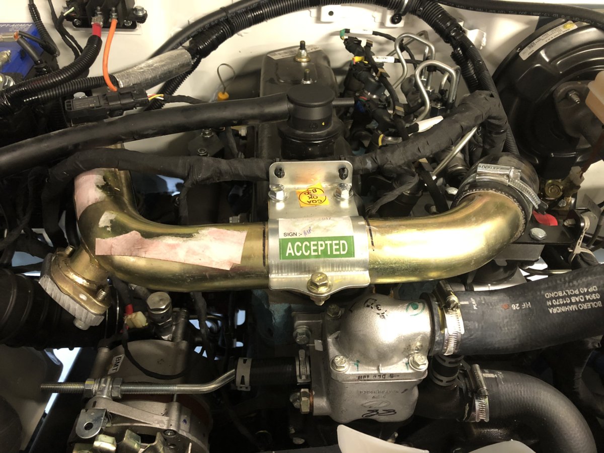

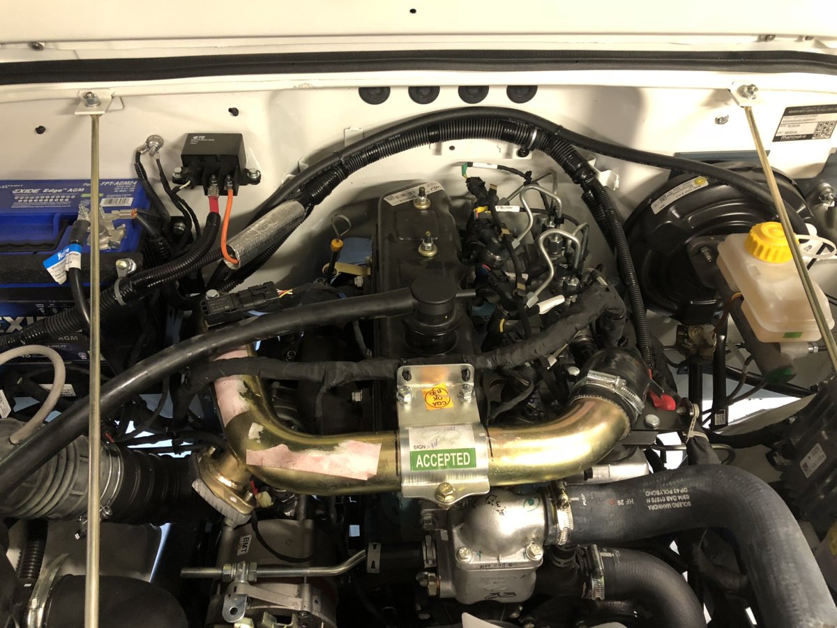

It’s minus an egr and all associated parts. Install was easy and no codes!
J
Jimmyb
Mar 13, 2018
189
I made the block off plates from 5/16” steel plate. It was probably a little overkill but I didn’t want them to warp and have a leak. You can reuse the metal gaskets that are on there. The only issue I had on mine was a coolant leak where I plugged off the water line on the pressure side but a worm gear hose clamp fixed it.

Now there is no benefit other than removing some excess heat from the engine compartment but over time and left alone a big difference. There was a surprising amount of soot for only 140 miles.

I plugged the coolant line on both sides of the water pump because the egr cooler was the only thing it fed. A bypass would just rob coolant flow from the engine because it would be a 6” loop that isn’t feeding anything else.
