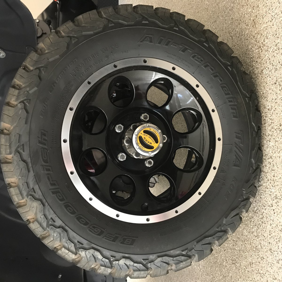

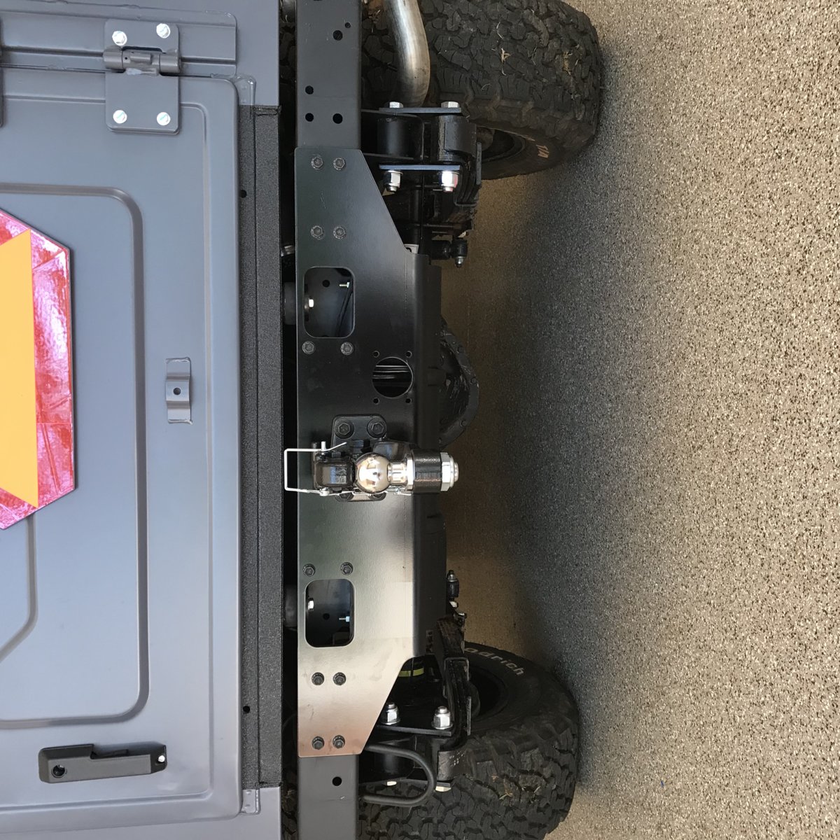

I am adding this to your thread. Had my ROXOR Warn hubs installed today along with the hitch. As for the hubs, it does seem to drive a little less binding if that makes any sense. It could be pyscosymatic cause I want to feel a difference, The hitch would pull hell off its hinges if you could hook to it.

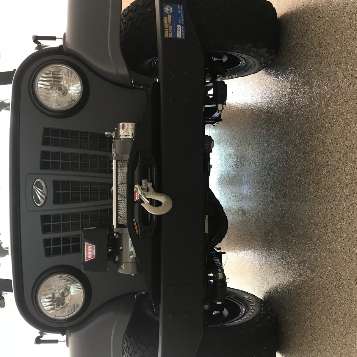

Now I want flat plat mount attachments for the front and rear to have D Ring Shackles. The best I can measure, the pre drilled holes on the rear are 3 1/2 x 1 3/16 and on the front 3 1/2 x 2 3/16. Clemson 4whell will fabricate them, but I intend to communicate with Mahindra to see if they are they are going to offer them. It will be much less expensive.
Pictures attached.

Bobby, it looks good. I’m waiting for my local dealer to get a hitch in stock. I bought an aftermarket rear bumper with a receiver hitch and shackles but it’s nowhere close to fitting and I wouldn’t feel that comfortable towing with it. The mahindra hitch is definitely next on the list. As for the hubs, I do think they make a difference in rolling resistance and turning ability when unlocked. Makes sense to me because you are no longer turning each axle shaft and u joint.
