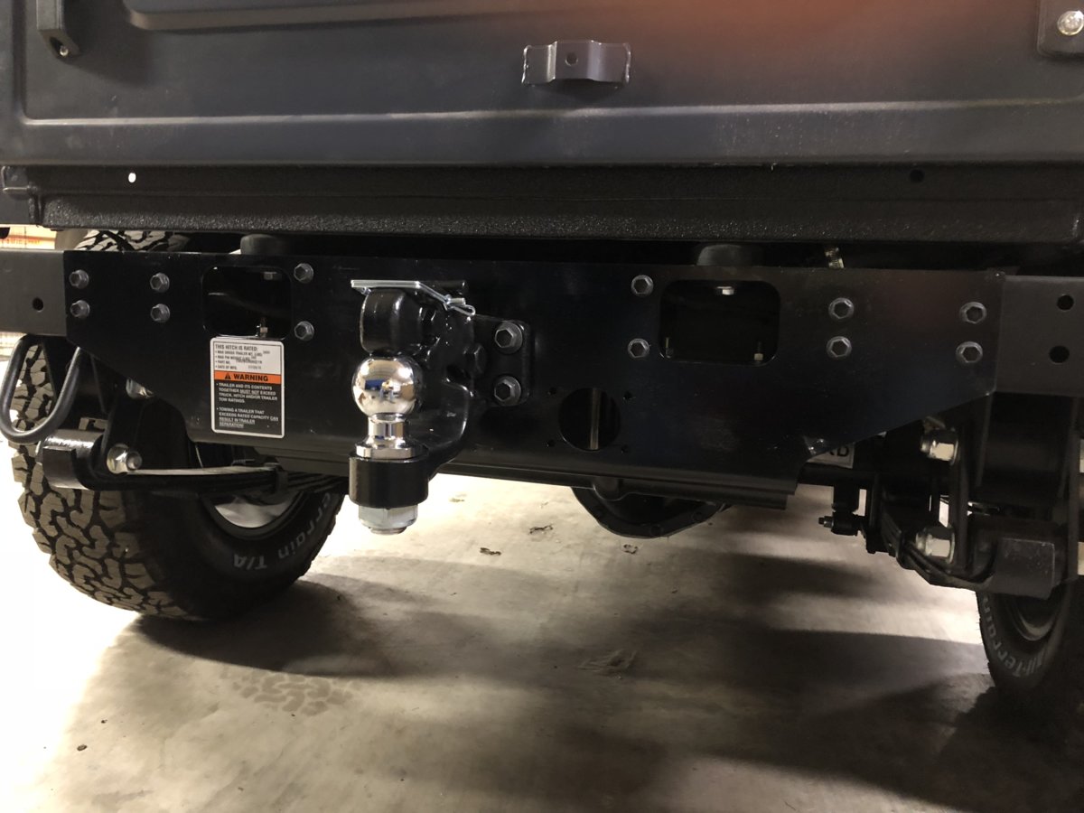

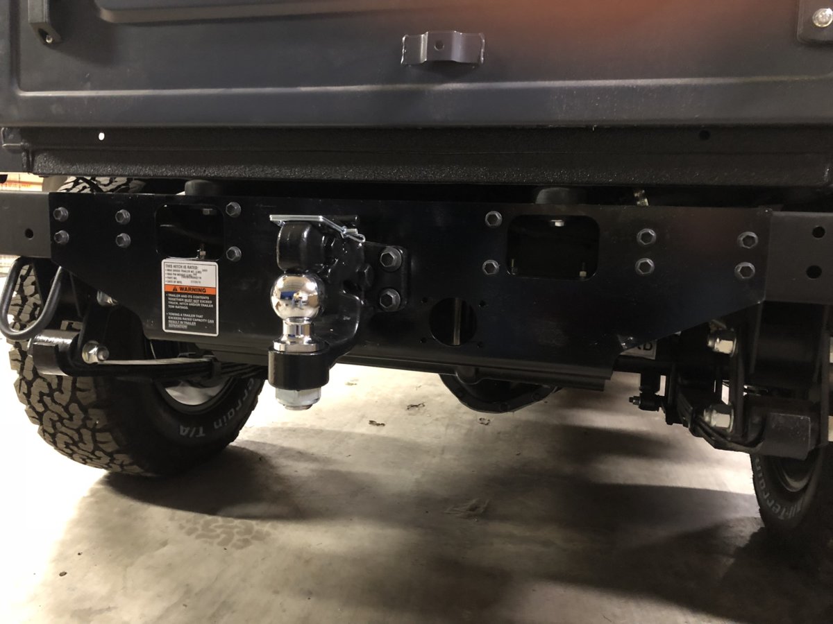

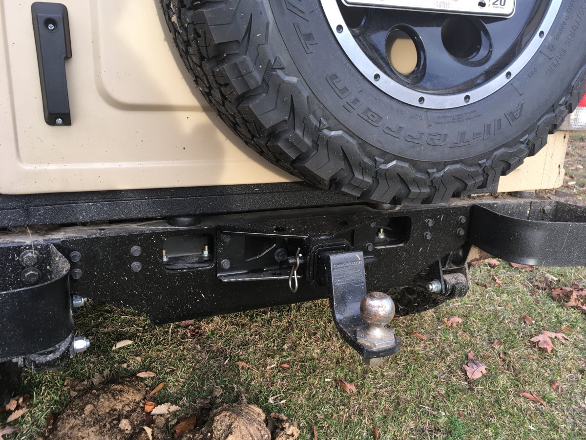

Picked up a Mahindra Pintle hitch today along with a strong made rear receiver hitch. I installed the one from Mahindra today and I’ll try the strong made tomorrow. The install of the pintle hitch was super easy and I have no doubts about how well it will hold up. Very stout setup. I’ll update tomorrow after trying the strong made.

What did you think of the Strong Made?
Install was simple and it’s well made for what it is. I will say it’s nowhere near as stout as the one from Mahindra. If I needed a receiver hitch instead of the fixed ball mount, I would still use the Mahindra kit with the strong made receiver bolted to it.
That’s what I did. Not the cheapest route but possibly the strongest bolt on solution. Still cheaper than custom fabrication and powder coating.
And way cheaper than replacing parts should you tear the center of that cross member out with just the strongmade when you are trying to pull that buried 1 ton out.

Thanks guys. I really wanted the flexibility of the receiver hitch...I’ll look into your suggestion 44.
That’s exactly what I was trying to say, I agree 100%. Spend a little more up front to have peace of mind that you won’t break anything. The Jeep bumperettes look good.
Thanks.

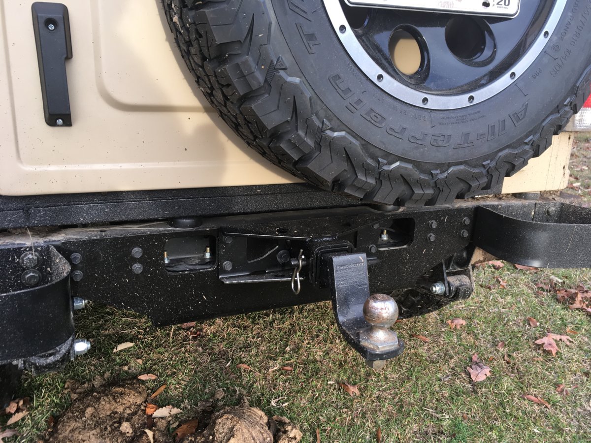

I Metabo’d off the hitch and drilled a new pin hole so it would fit in closer. Yea you can still catch your knee on it but I figure it’s worth it for protection of the spare tire and tailgate so I leave It installed. Between it and the bumperettes I should be safe from anything moderately stupid.

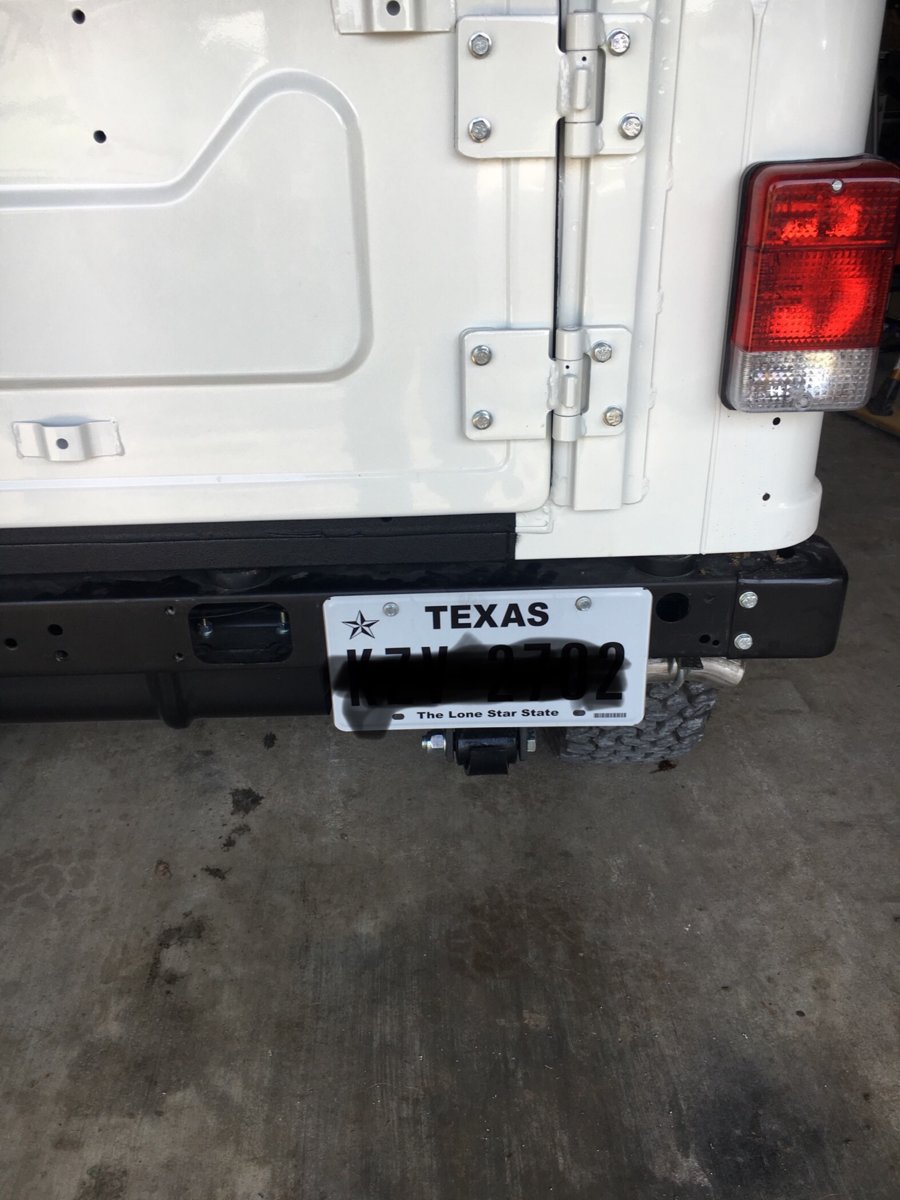

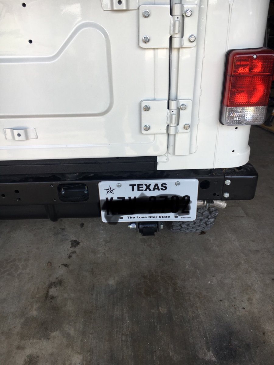

I officially got it licensed in Texas today. It was difficult but it is possible. It is registered as a mahindra not a replica. It looks funny having license plates and a sticker.

876
Yeah the OEM hitch setup is beefy

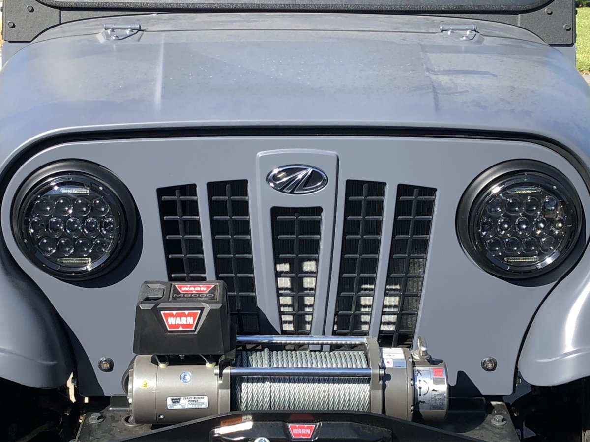

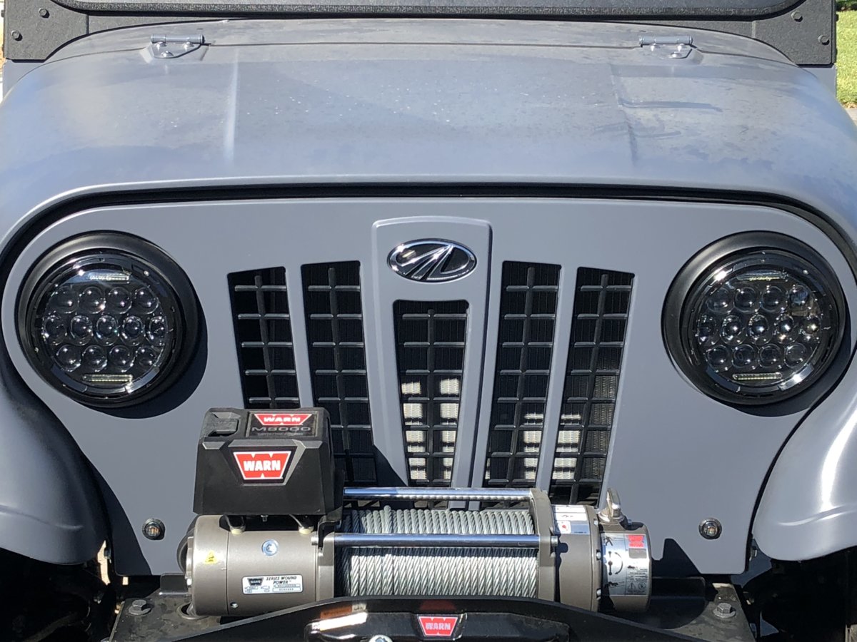

I got another new set of headlights today. They are cheap eBay lights but a huge improvement over stock. They are led with a H4 connector, plug and play. As with the last ones, you have to trim the headlight buckets in 2 spots but this a 5 minute job with a dremel.
How are the lights holding up??.....some reviews are not so good on long term use...

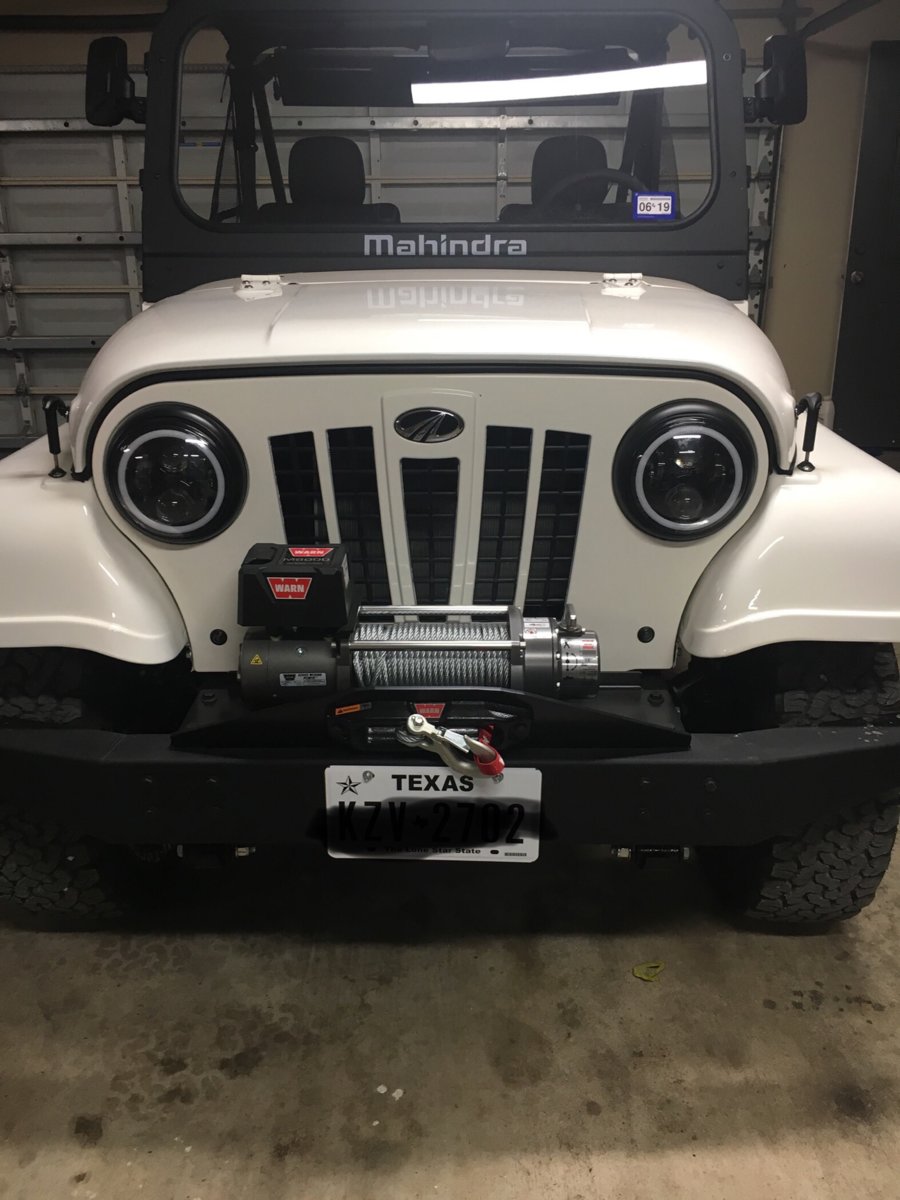

Thank you, I think it will vary a lot state by state as far as what is legal. I could have used it on the road for short distances for ranch use where I am the way it was but I wanted to find a way to do it completely legitimate. I have plates already made for a egr delete, I just need some aftermarket help with tuning and I will be completely satisfied with what I have “for now”!
View attachment 621View attachment 623View attachment 624

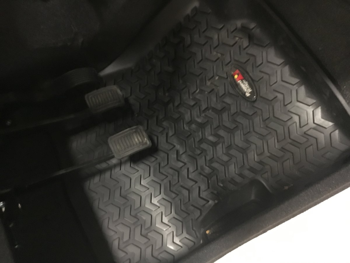

JIMMYB

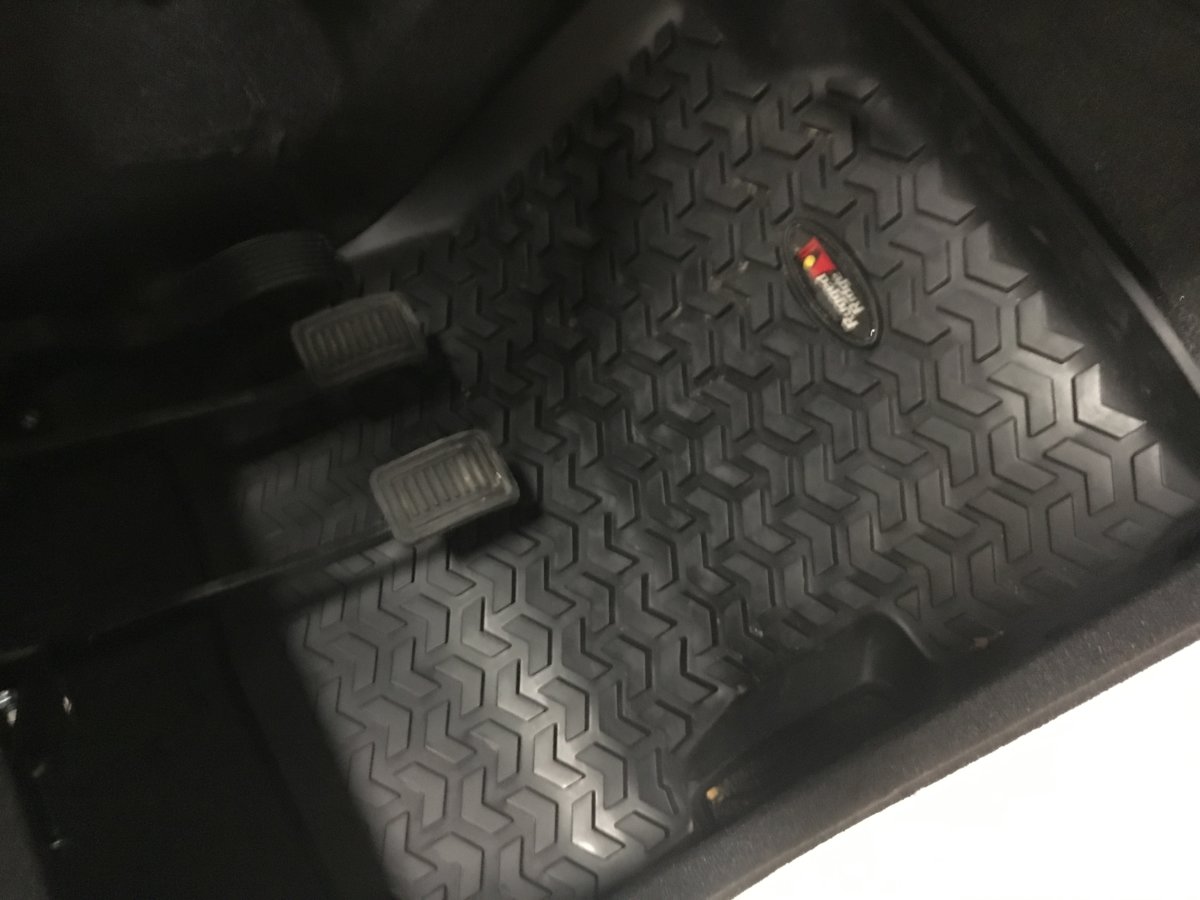

Ur floor mats look like they fit like a glove.
Can read rugged ridge. Is there a part # or year of jeep these are from?
Jimmyb
Mar 13, 2018
189
JIMMYB
They fit pretty good but not perfect, they are rugged ridge for a cj. Part number is 12920.21
