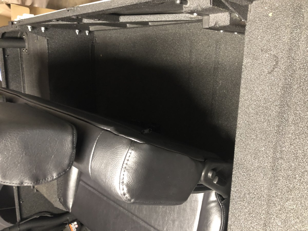

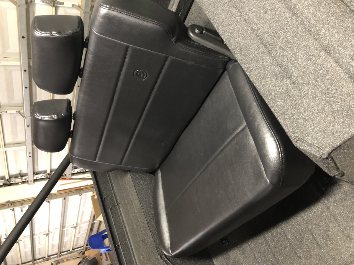

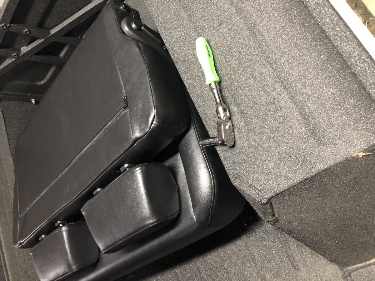

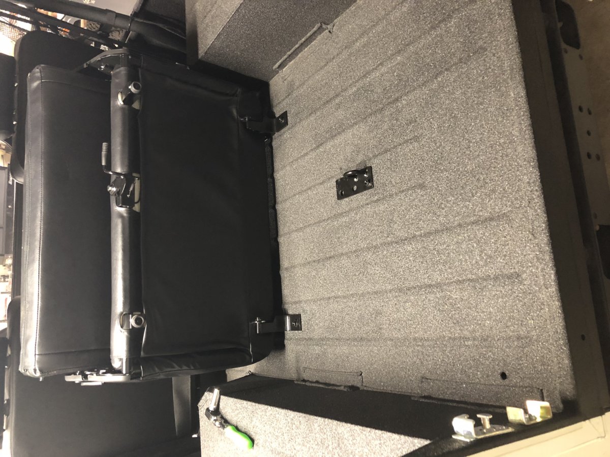

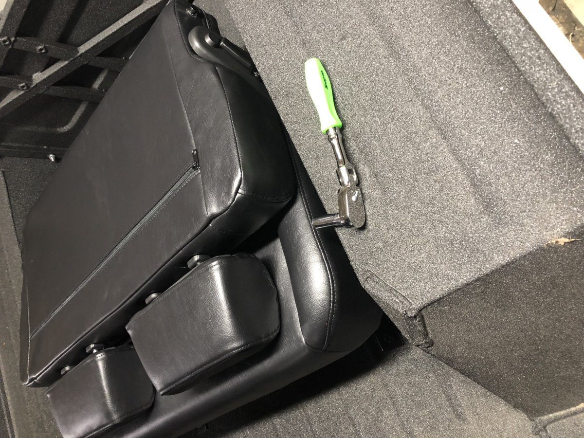

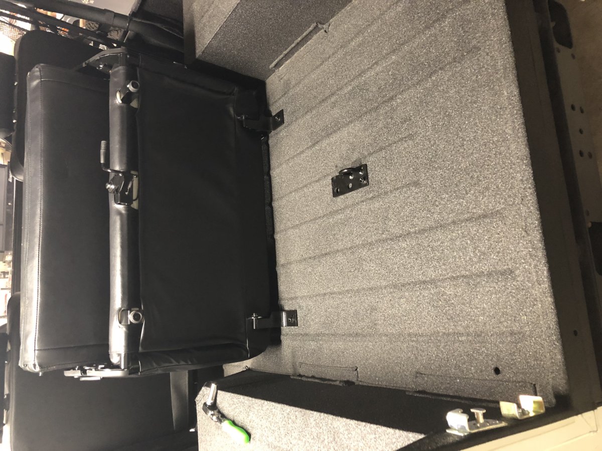

Rear seat info for any of you looking for one. I bought a rear fold and tumble seat from Bestop for a CJ, part number 39440-01. The fit and finish were great, I would definitely recommend this seat if you are looking for one. They have another one that doesn’t fold and doesn’t have headrest, aesthetically I think it would look better but I didn’t want to give the bed space without having to completely removing the seat. It is possible to install by yourself but would be a easier if you had an extra person. Total time by myself was 1hr and pretty straightforward. Enough rambling, here are the pictures!
View attachment 793View attachment 794View attachment 795View attachment 796
The seats look great! Do you have any ideas for seat belts?
Thank you, today I ordered a rear lap belt kit from crown automotive for a CJ. I’ll post pictures after it comes in.
