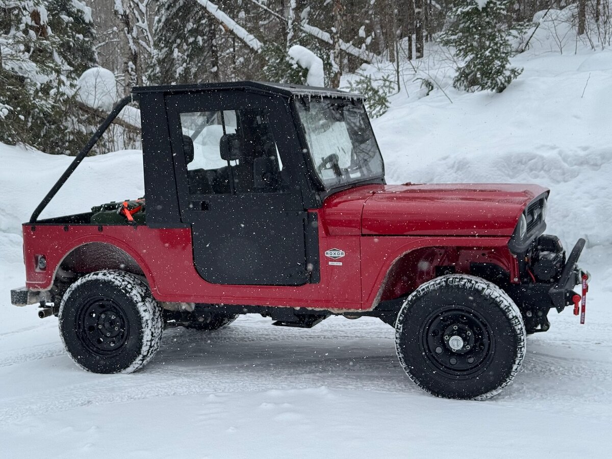

The DMV must not have a good standard statewide SOP for the process. I talked with a bunch of local folks that had gone through the process and the DMV seems to be the part where the process breaks down if it’s going to break down. My county is full of backwoods Yoopers that have done this so I was surprised the local DMV acted like it was a new process. The first DMV lady didn’t even understand what I was trying to do even after giving her the completed forms. You’re a Marine and I’m Army. If we were handed a form we hadn’t seen before the form number and title usually explained exactly what it was for. He eyes said “Does not compute.”
The picture was at the end of my lane. I had to beat a storm to get gas for my generator. I got out when I got home to stretch and thought “wow, this is a post card picture.”
