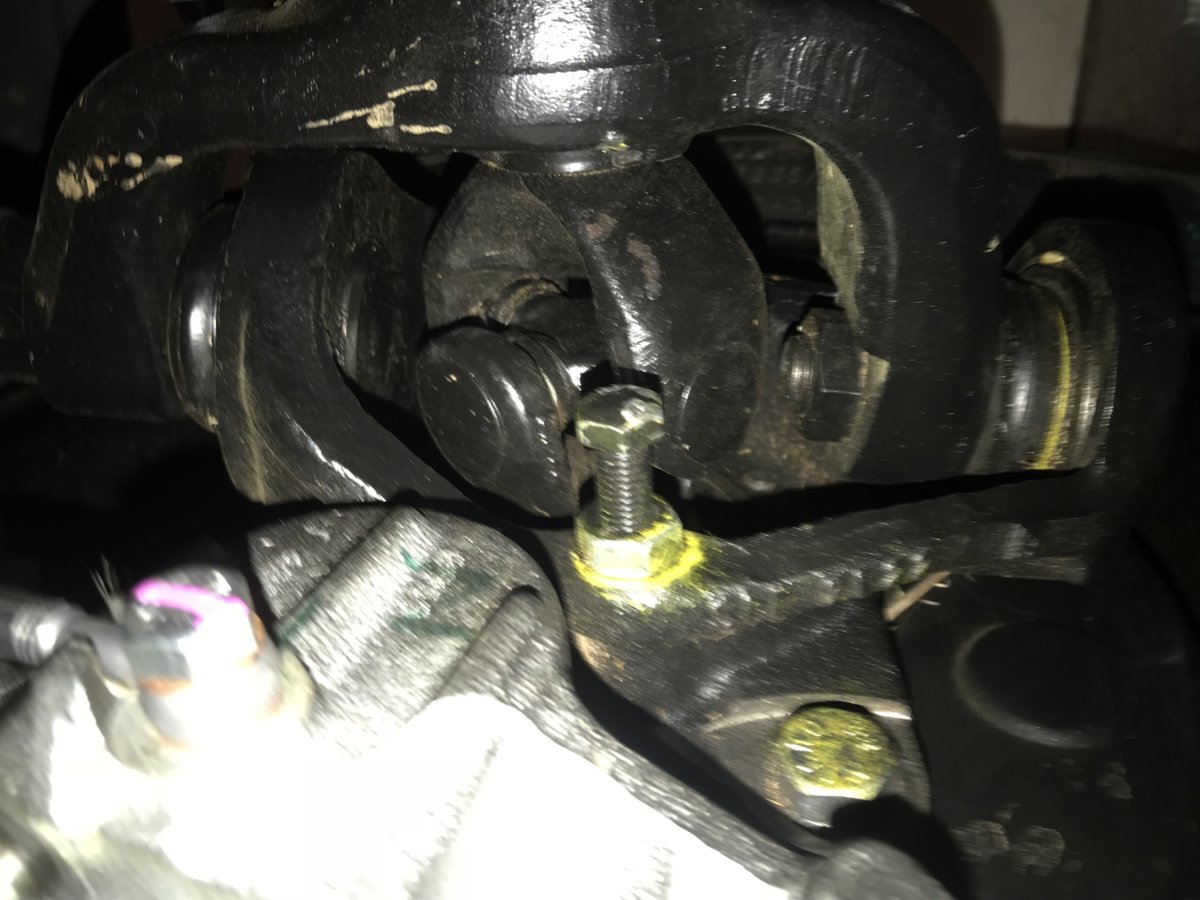

Turning radius. I was way disappointed with the turning radius or lack of, and the left was much worse than the right. Simple fix. There are bolts on the knuckles that are a stop. A 9/16” bolt with a 13/16” jam nut are all that stands in the way from a much more pleasant driving experience. Adjusted in about 3/4” on the drivers side and a 1/2” on the passenger side still has plenty of clearance.

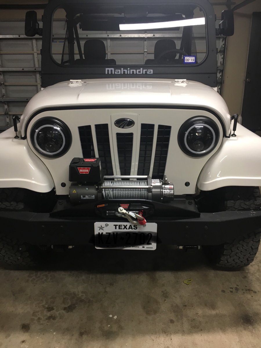

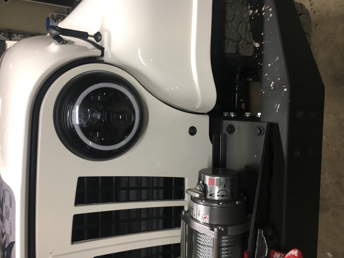

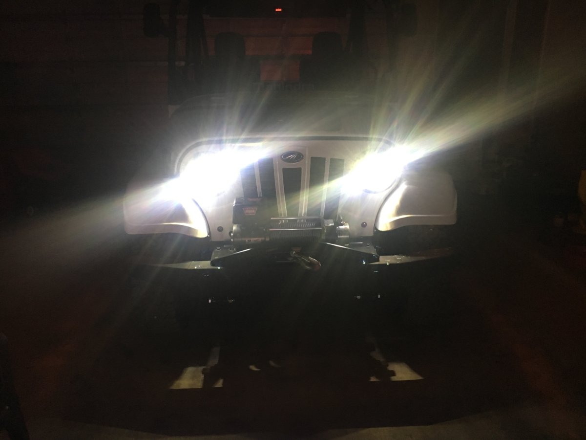

I had some led headlights from a JK and thought I’d see if they fit, a little trimming and notching was necessary but they now fit the factory ones.

Jimmyb: I made the adjustment to the steering today. You are right. A huge improve. However, I didn’t have the bolt length adjustment you mention and I ended up screwing them all the way in and tightened them down. No problems. Also, my bolt was an 11/16 not a 13/16. I am not a mechic and very dangerous when I start tinkering with things I don’t understand. Please Tell me if there are consequences I don’t comprehend.
I am attaching a picture of the bolt I adjusted.

View attachment 596I tightened mine all the way in and when I turned the tire hit the leaf springs. I then jacked the front end up put it on jack stands and readjusted them until I had a 1/4” gap between leaf springs and tire.

I didn’t hear or notice mine either while driving but I decided to jack it up and check and I noticed it was barely rubbing. Also so it doesn’t confuse anyone “The bolts don’t tighten all the way in. I believe I had a little over an inch of bolt head sticking out before it wouldn’t tighten anymore.”

The only reason I could see an issue with them adjusted all of the way in other than rubbing on the leaf spring would be premature wear on u joint at the knuckle but only time will tell. I would much rather change a u joint early to have the increase in turning radius.

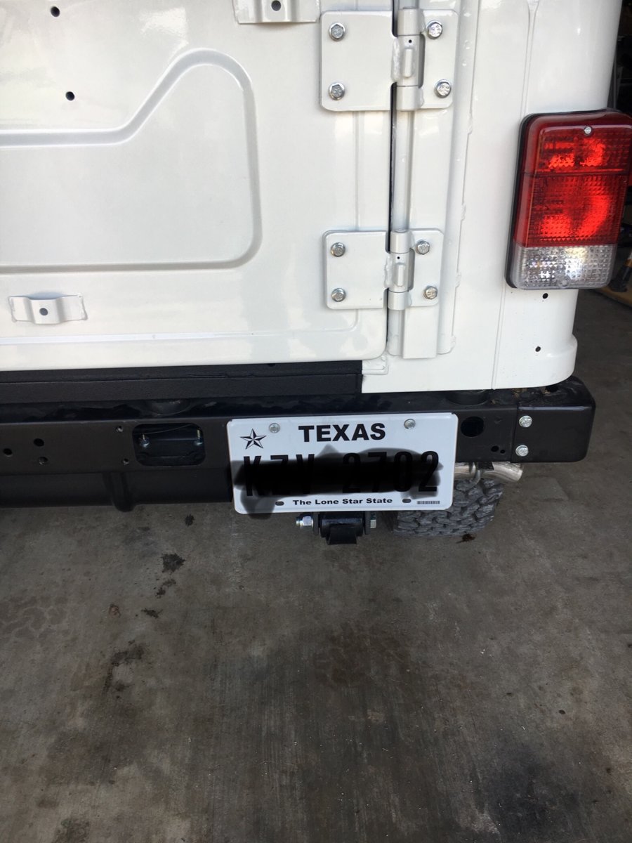

I officially got it licensed in Texas today. It was difficult but it is possible. It is registered as a mahindra not a replica. It looks funny having license plates and a sticker.

Awesome and congratulations. It sounds from your post you have put a good bit of time money and effort into the process. Like I said earlier I am running on a golf car permit somewhere between the letter of the law and the spirit of the law. I am hoping the officer is in a jolly mood and more interested in the ROXOR than the letter of the law when I get stoped. We will see.
Jimmyb
Mar 13, 2018
189
Thank you, I think it will vary a lot state by state as far as what is legal. I could have used it on the road for short distances for ranch use where I am the way it was but I wanted to find a way to do it completely legitimate. I have plates already made for a egr delete, I just need some aftermarket help with tuning and I will be completely satisfied with what I have “for now”!

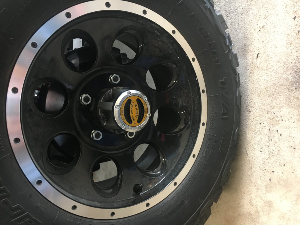

I finally had some time to install the Warn locking hubs, the install was super simple and took 30 minutes start to finish. Both of mine were difficult to put in four wheel drive much less trying to get them in 4 low, I thought maybe things were just tight from being new. After the hubs the transfer case moves easily in any selection. I wanted to be able to drive in 4 low with the front end unlocked in the pasture when it was dry because of the difficulty turning with front end in a bind, the ease in shifting the transfer case was just a major bonus!
