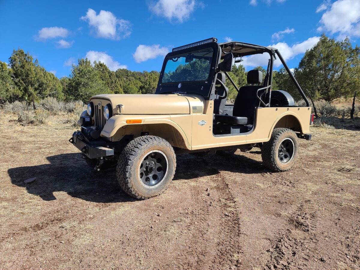

2604

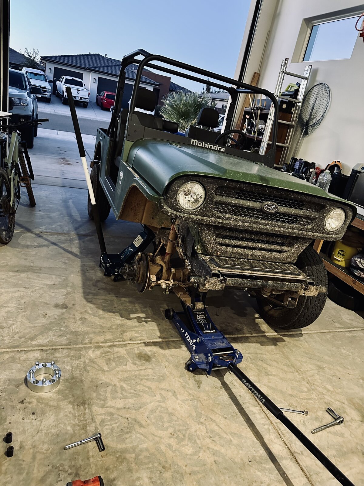

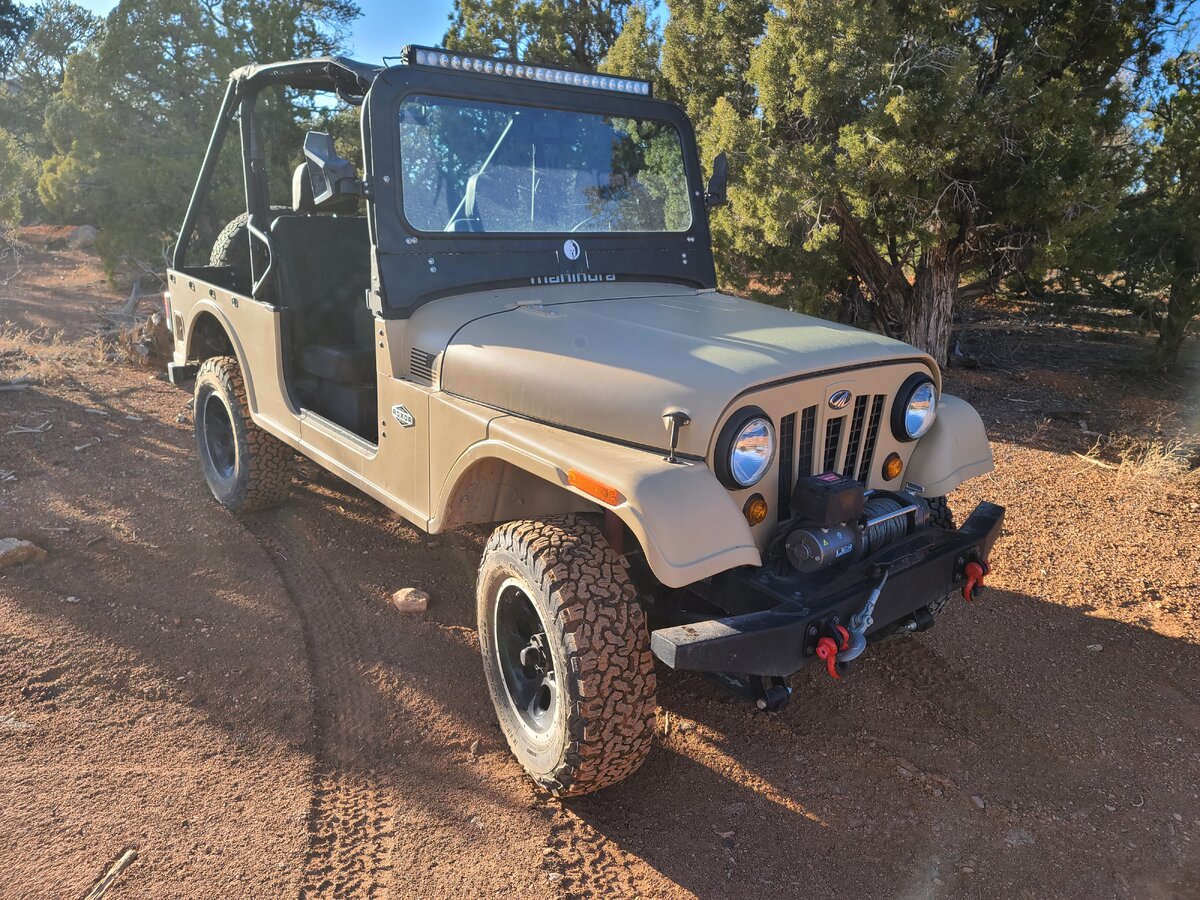

Put Climax 1.5" shackles on the front and bumper shackle mounts on. Easy-peasy.

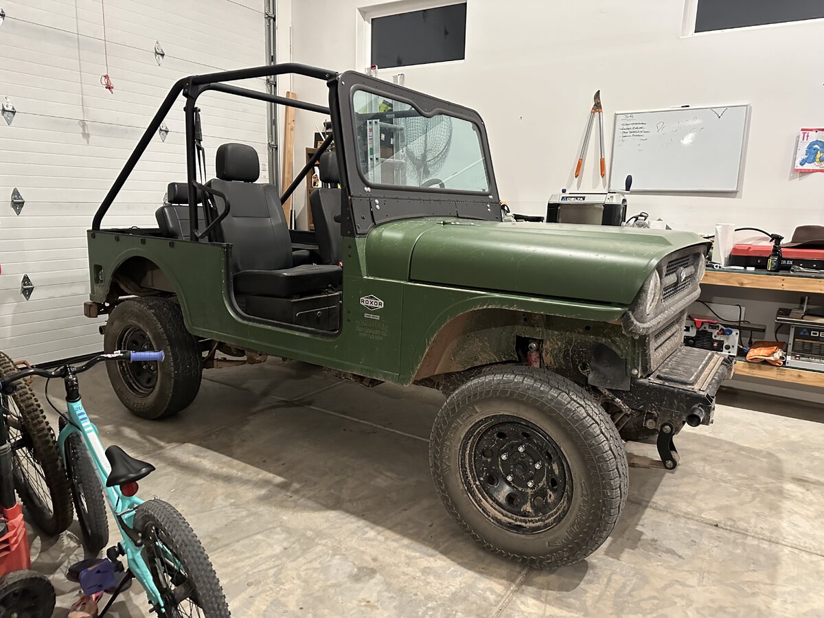

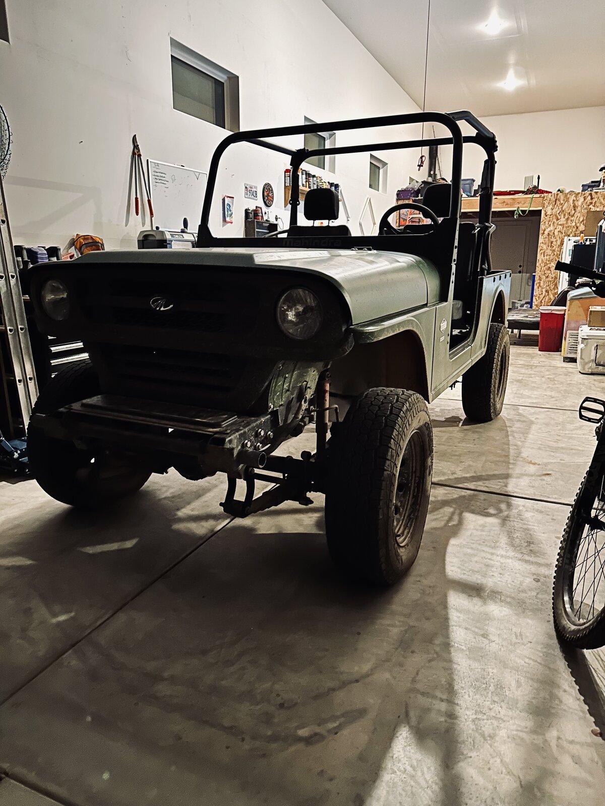

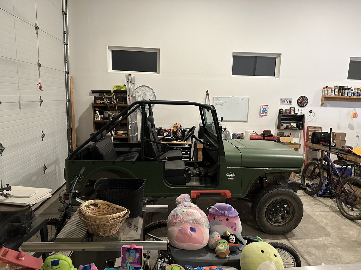

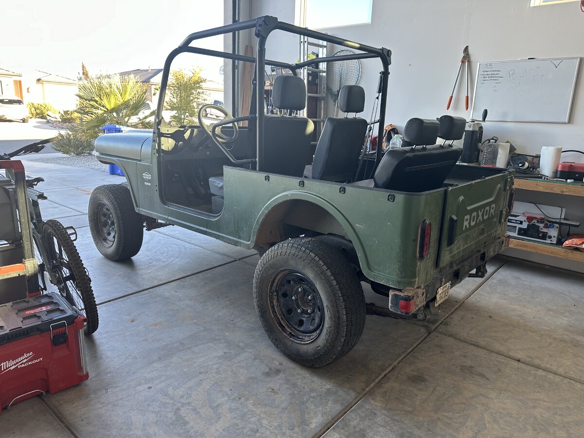

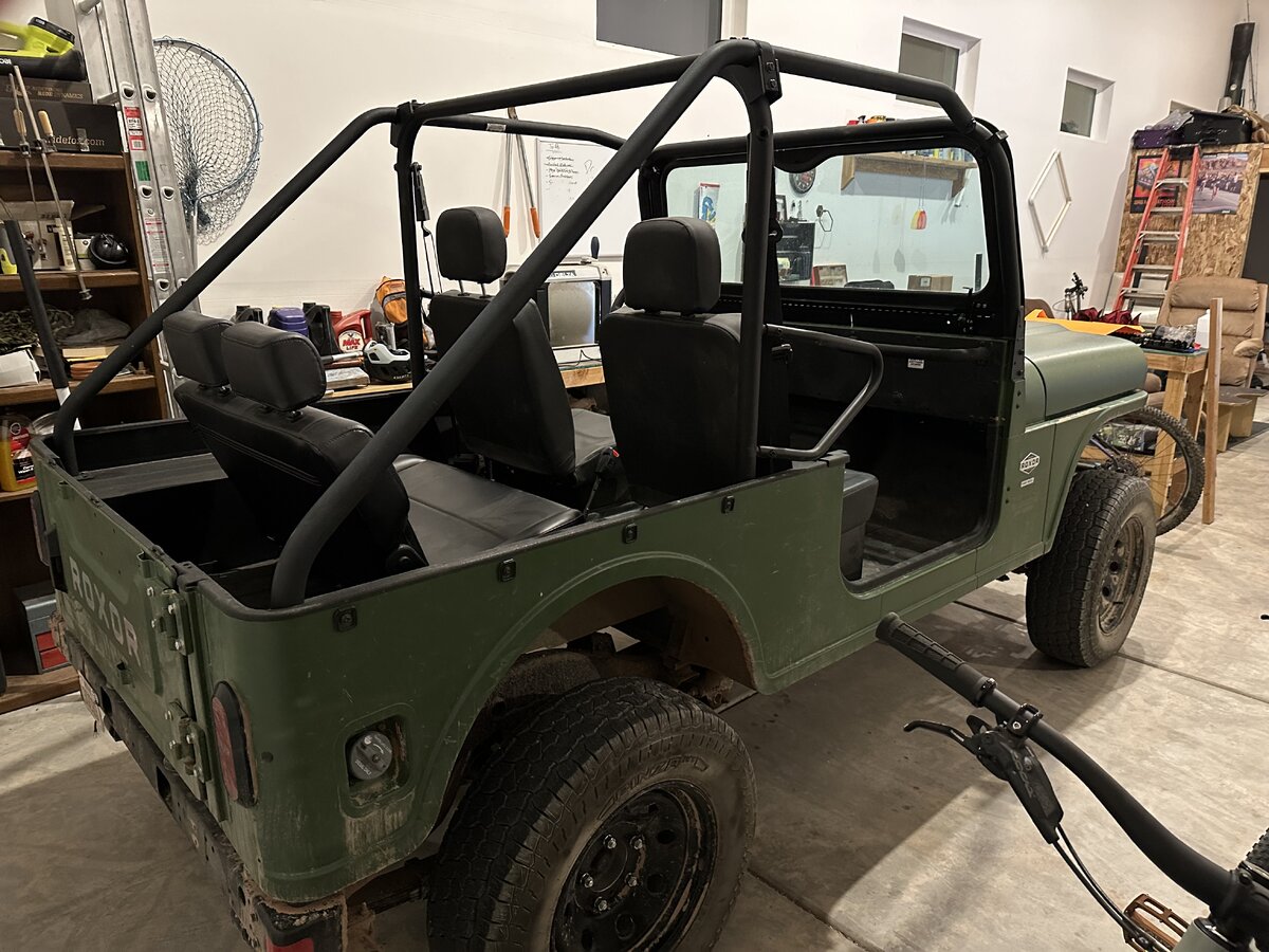

I’ve got the ‘24 HD Base. I’ll combine today, and a few days ago! From bone stock status, I installed 1.5” Climax shackles on the front, and 2” wheel spacer adapters all the way around, made a new friend who hooked me up with a windshield, and a set of factory sport bars. All things in and we have a hell of a transformation! Next up, tires and shocks!

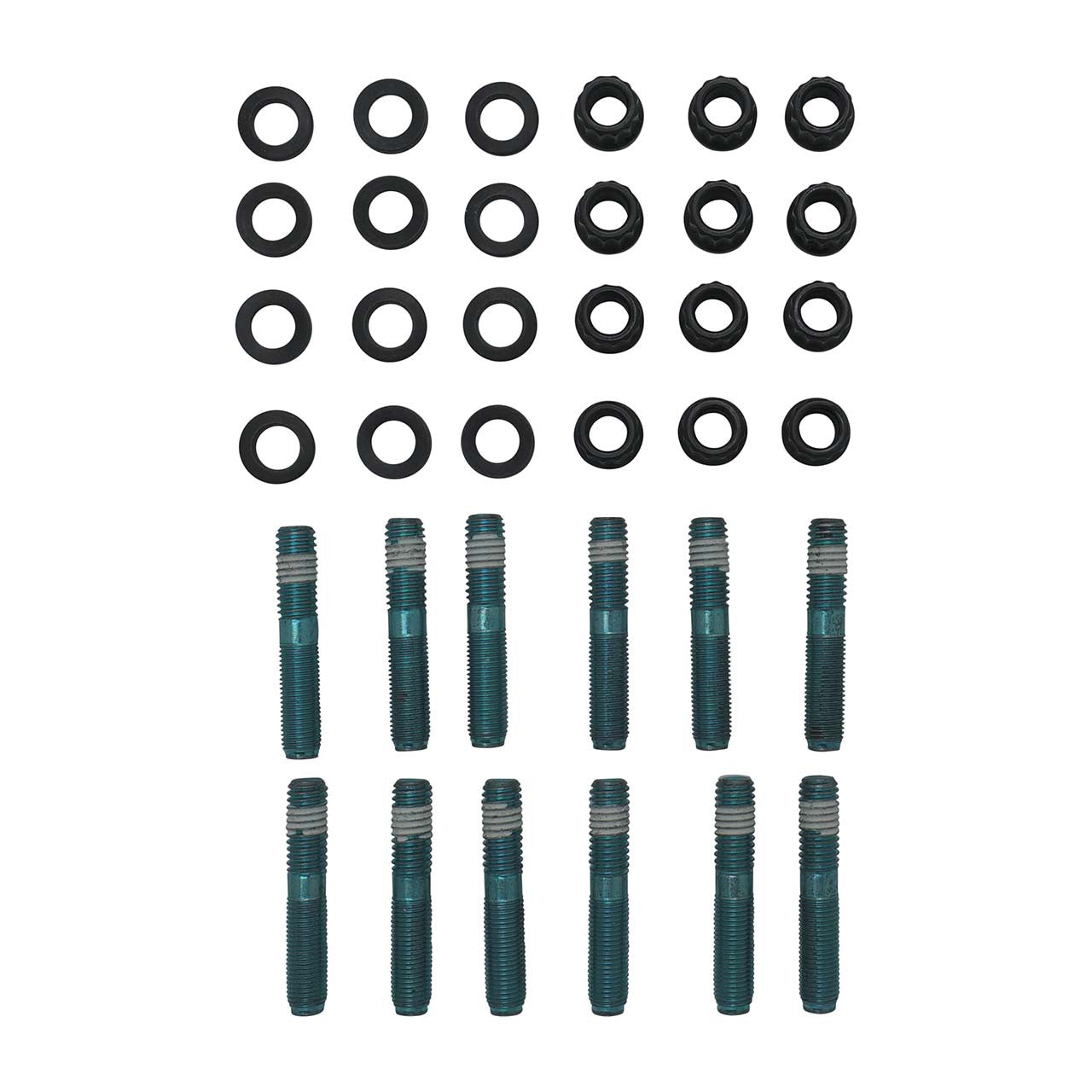

Weather is crappy outside, so I only swapped out the 14mm hub bolts to cap head bolts on each of the front hubs. When I bought this used Roxor, it was missing 3 bolts on each side, so I figured since I'm going to eventually put some locking hubs on, I'll replace all of them with the hex head bolts. It should make putting the new hubs on easier when I get them. Days like this make me miss my old house where I had a 40x40 steel shop! My new house has a little 2-car garage and I have too many motorcycles in there to work on the Roxor in there!

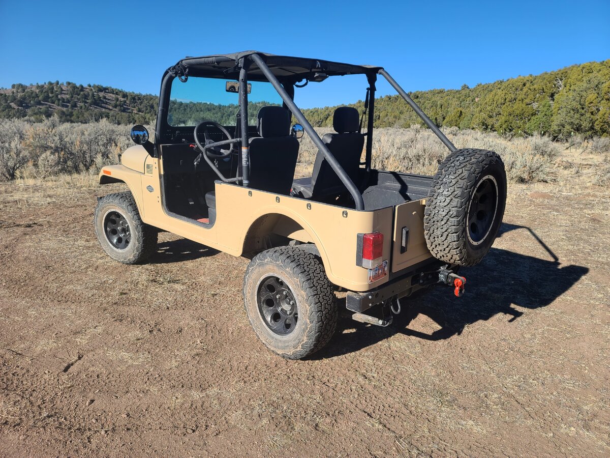

I received my On The Rox Fabrication spare tire mount. I purchased the extended mount for my 35 inch tires and in case I went to wider tires. Anyway, the tire mount is built very sturdy. It looks nice to have the spare tire mounted on the rear versus it laying in the back of the Roxor. My grand daughter says it looks like a Gladiator now.
Those bolts will continue to work themselves loose and always need to be torqued down during/after every trip off-road, especially on hard ground like rocks. I imagine that’s how those ended up missing. I ended up swapping these on my Roxor and hopefully that problem will be greatly reduced if not eliminated all together.
Thanks man! I'll take a look at that kit.

Greased the zerks on the leafs and rear axle. The previous owner must have never greased the rear axle because it took about 30 pumps per side to get grease to start coming out the weep hole. Then took it for a spin!
SteveinUT
Oct 14, 2024
148
Southern Utah

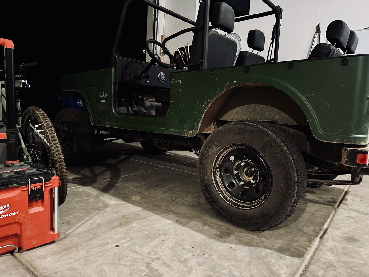

2604

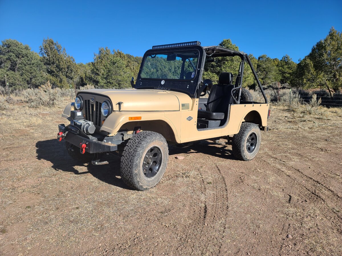

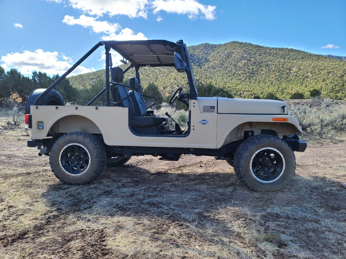

Put RC 1.5"-wheel spacers on. I like the stance of the machine a little better. Looks good. After that, I went for a 4-hour ride and after that, fortunately, my wheels hadn't fallen off, so I think she's good to go.

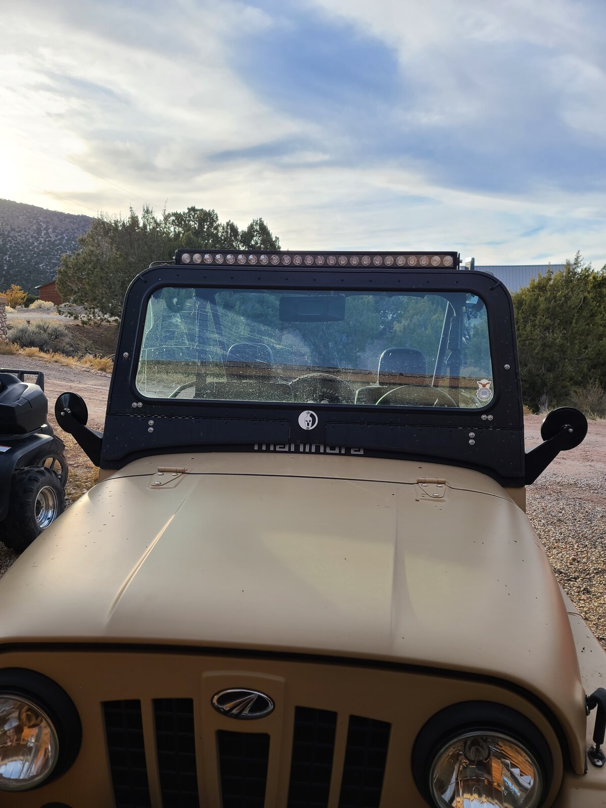

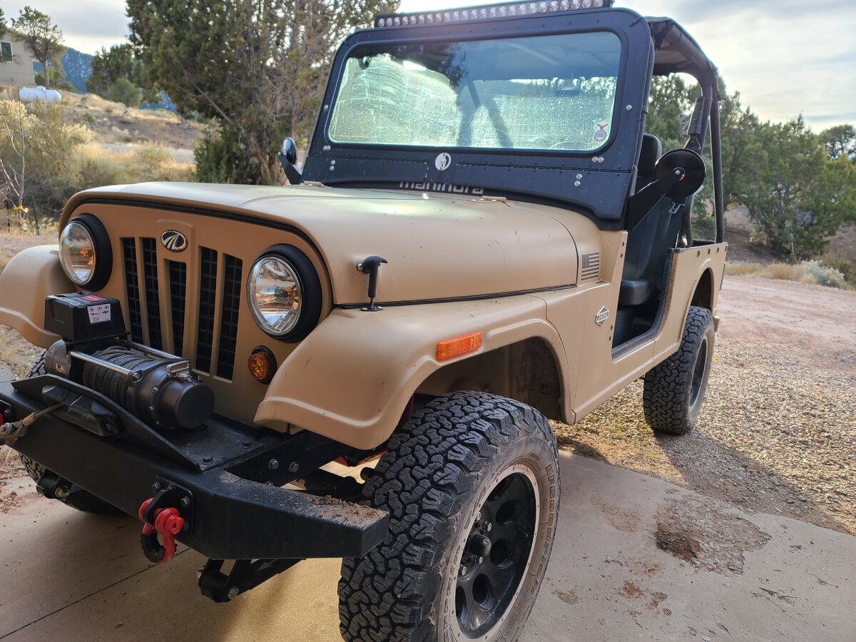

Put some Diesel Freak mirrors on my Roxor today. These things are solid and a hell of a lot better than those SxS mirrors!
