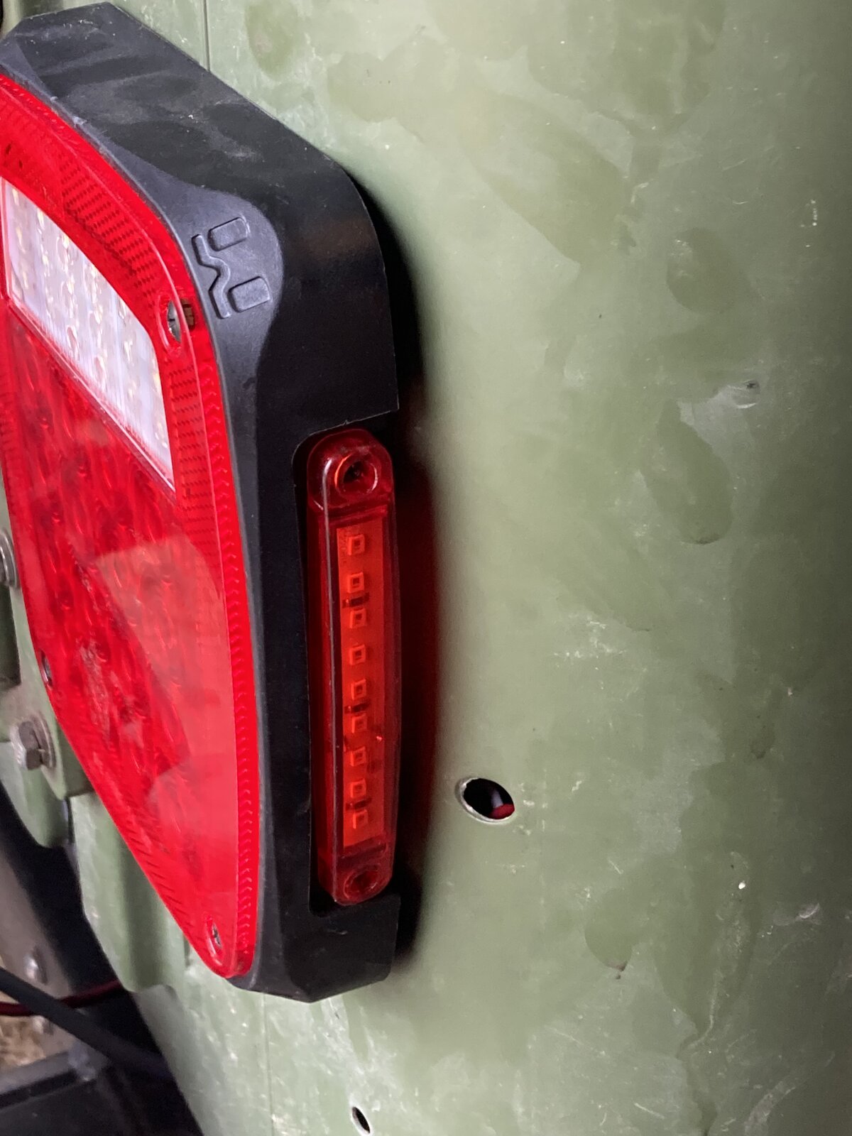

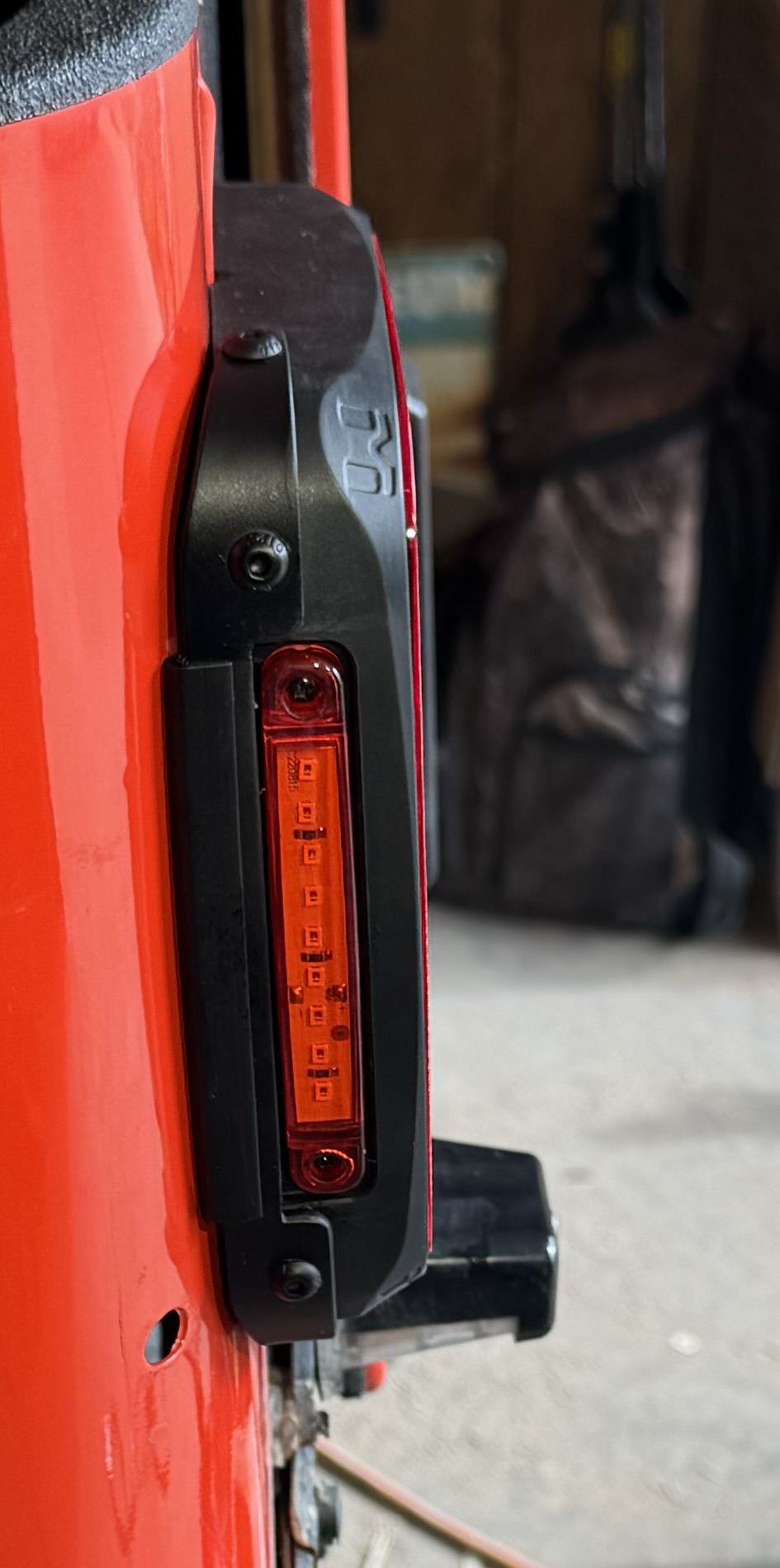

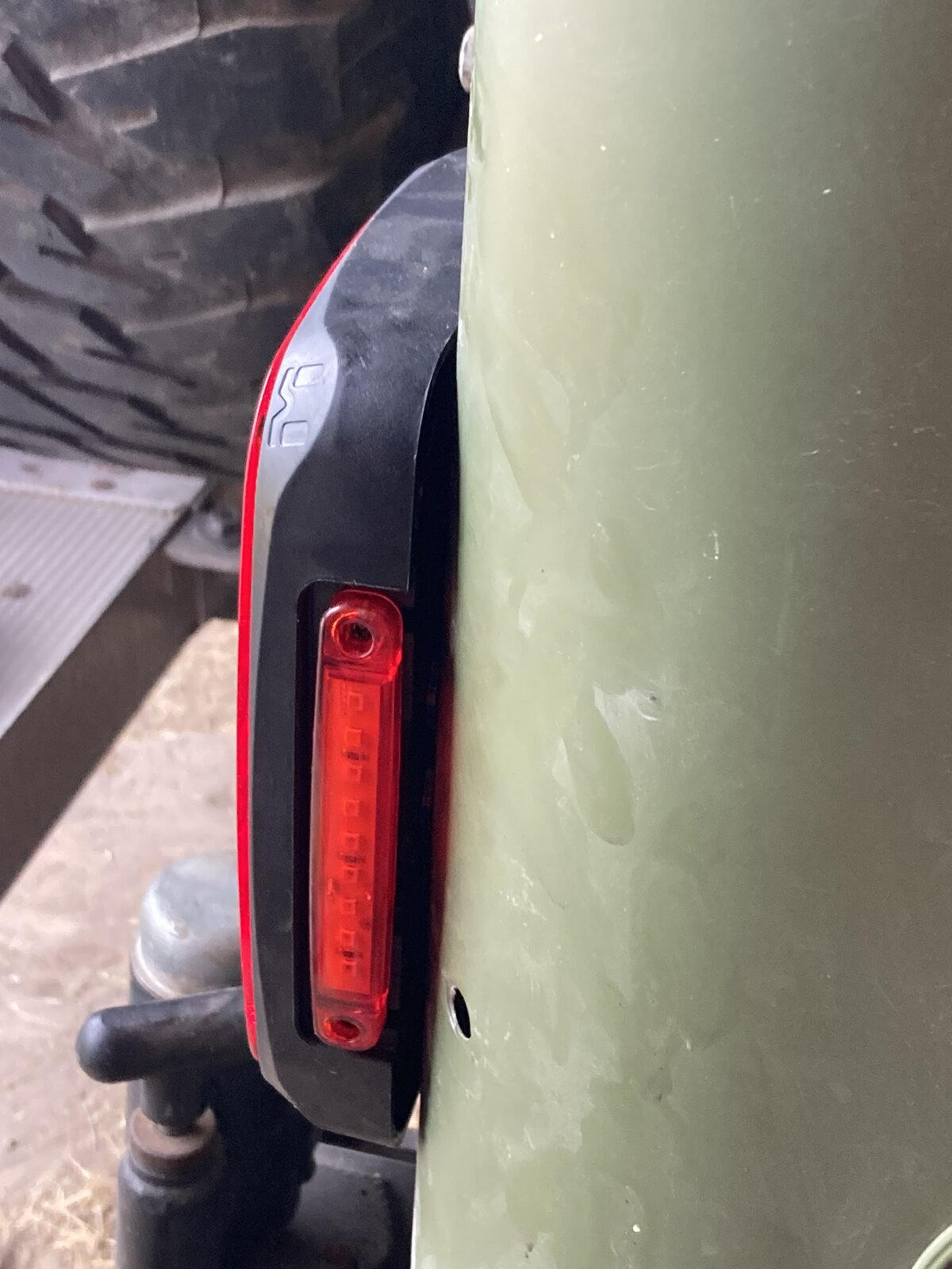

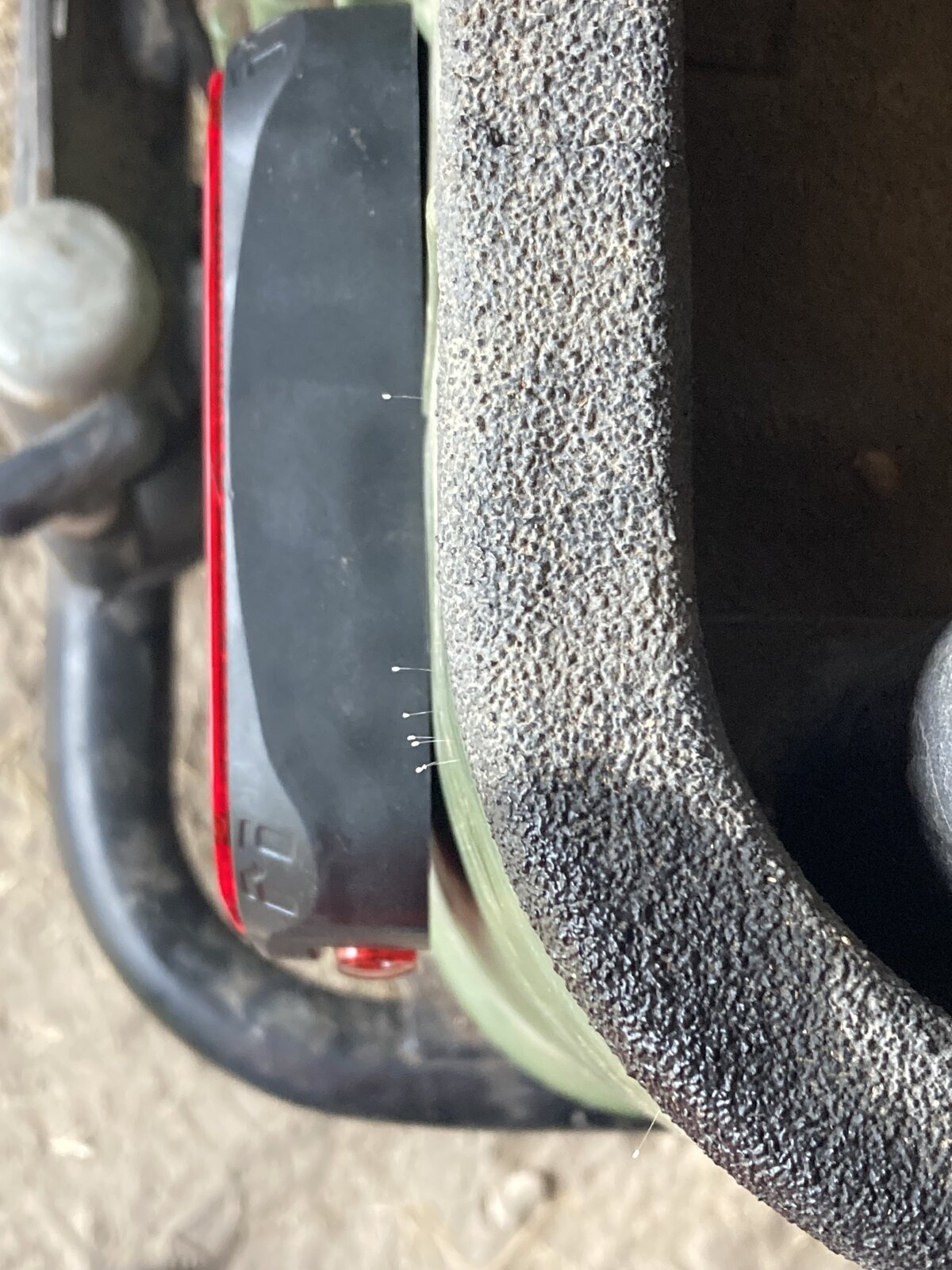

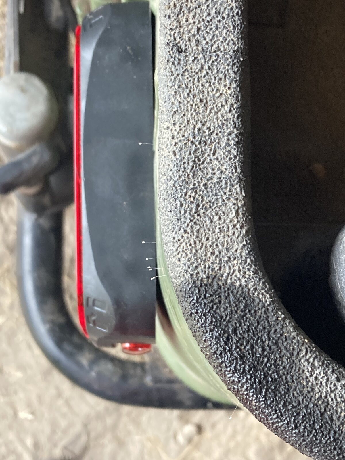

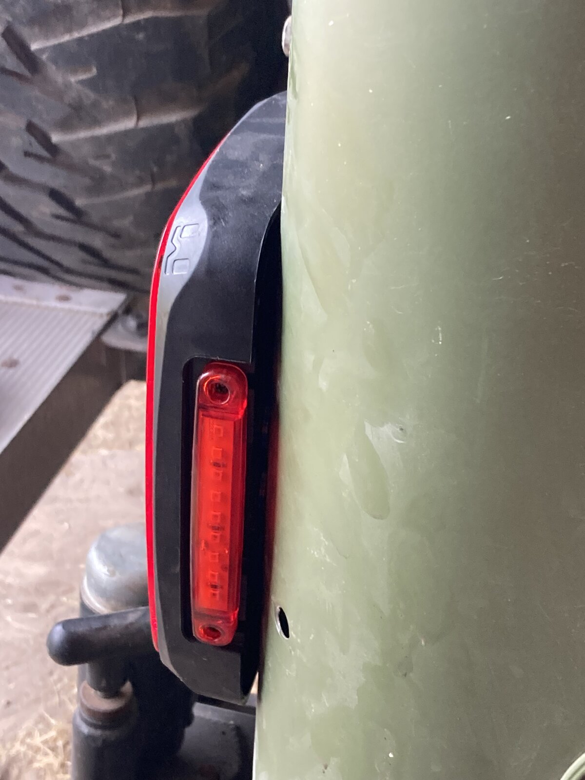

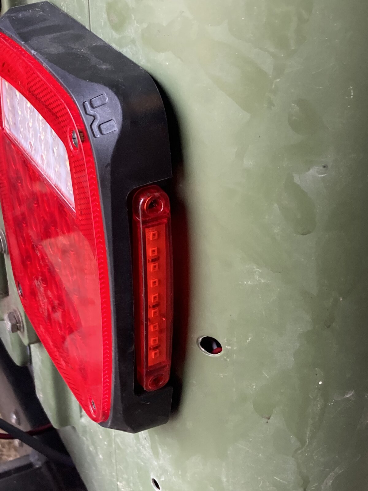

Got my metal cloak TJ/YJ lights installed. Used one of those converters to get the brake and turn signals on the same wire. Very easy install. Also I now have a 4 flat trailer plug. Still have to get another ring terminal for the ground on the converter then I can clean up that mess down there and complete the install.
Ccoombes
Sep 27, 2018
Lovington, NM, USA
1806
Got my metal cloak TJ/YJ lights installed. Used one of those converters to get the brake and turn signals on the same wire. Very easy install. Also I now have a 4 flat trailer plug. Still have to get another ring terminal for the ground on the converter then I can clean up that mess down there and complete the install. View attachment 14065View attachment 14066View attachment 14064View attachment 14063View attachment 14062

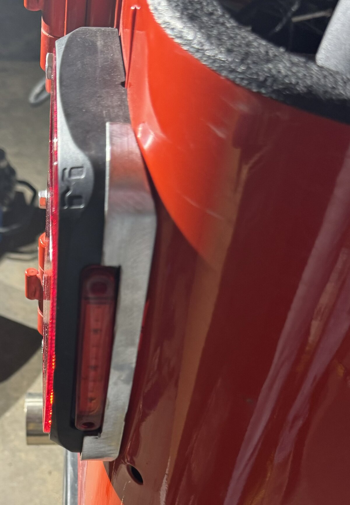

I used the same lights and made aluminum pieces to cover the gap.
