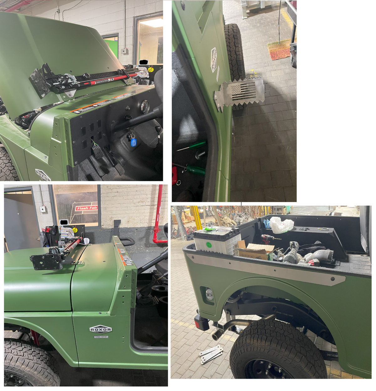

The Flash Fab guys have been busy this week. More to come soon, and keep an eye on RoxorPartsDirect.com for many new product offerings.

RPD-NICK Who did you go with on the Hi-Lift Jack "Hood Mount", and why?
It looks like the Aluminum one Hi-Lift sells in the picture.
Looks to me like a new Roll Bar set up may be in progress. OR Roll Bar modifications. Possibly more CJ7 Windshield friendly. Just Guessing :)

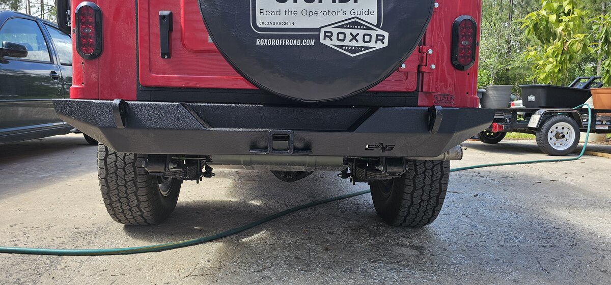

Feel free for me to test a rear bumper for you guys! I’m ready to buy one. 😛
Not exactly a bolt on, but it looks good to me. EAG TJ rear bumper. I had to make an adapter for it. I picked up 16 holes in the rear frame member. If it pulls off, it's going to be ugly.

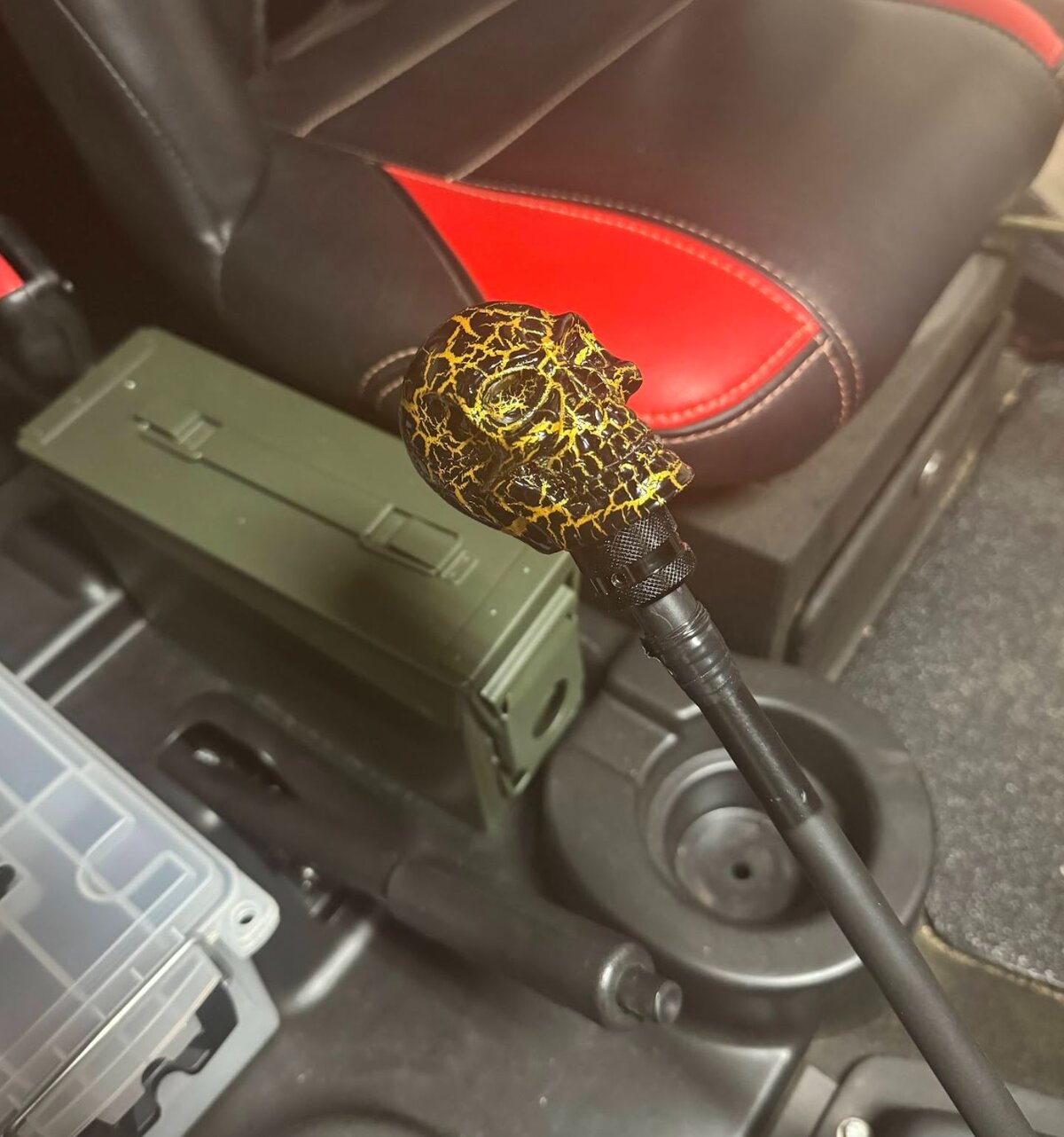

Added a new shift knob today!
