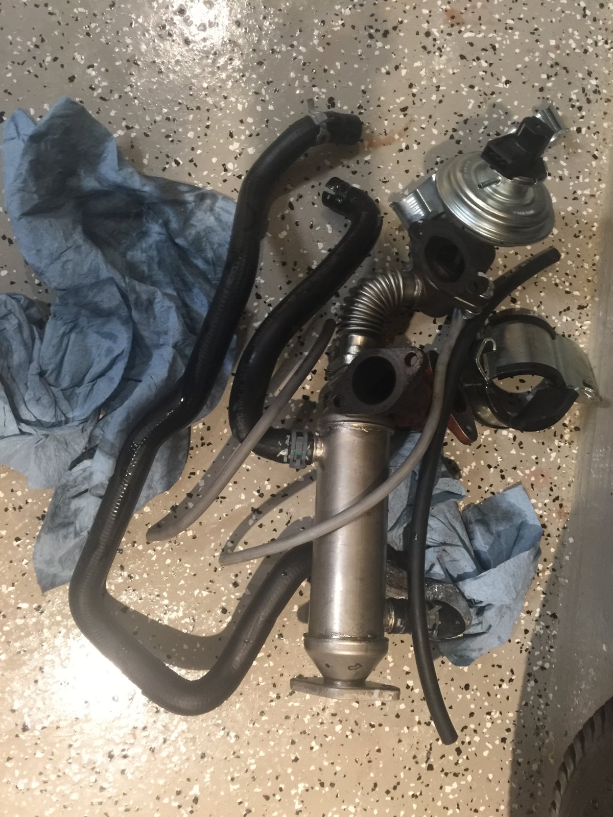

JimmyB's kit is super high quality. Worth every penny. Perfect fit and excellent instructions. Here is a pic of almost everything that came off the motor after the EGR delete.

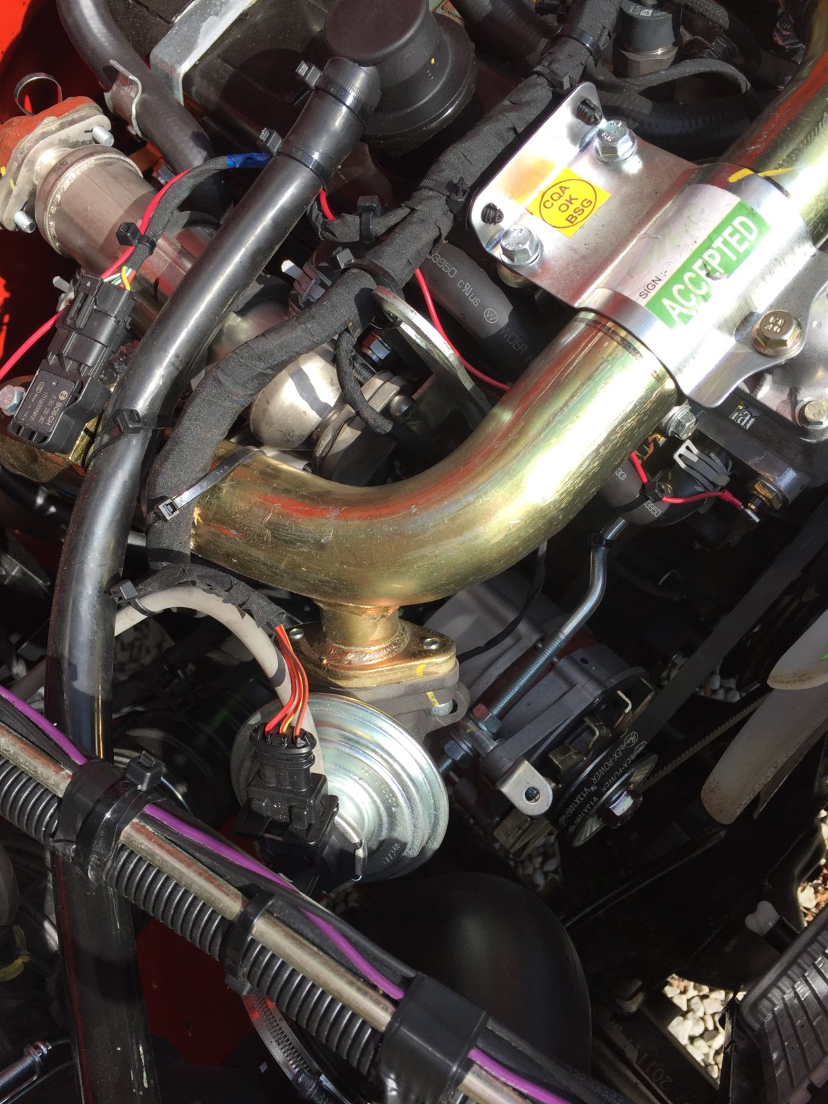

Can u delete the egr without doing the flash of the ecu??? codes??
Yes I did it and no codes. Removed cooler and coolant lines, blocked Ex manifold at rear and put the second plate between the EGR valve and intake pipe leaving the vacuum lines and electrical sensors active, all works great. Pic is of valve and sandwiched block off plate.

OK Doshounds, educate me! This is what you removed after having a flash done with the EGR delete?

Yes, that is what all was removed from one that has the egr disabled through tuning. In your case it will be just like woodlot said, the egr cooler gets removed, the egr valve and vacuum solenoid stay plugged in to keep it code free.

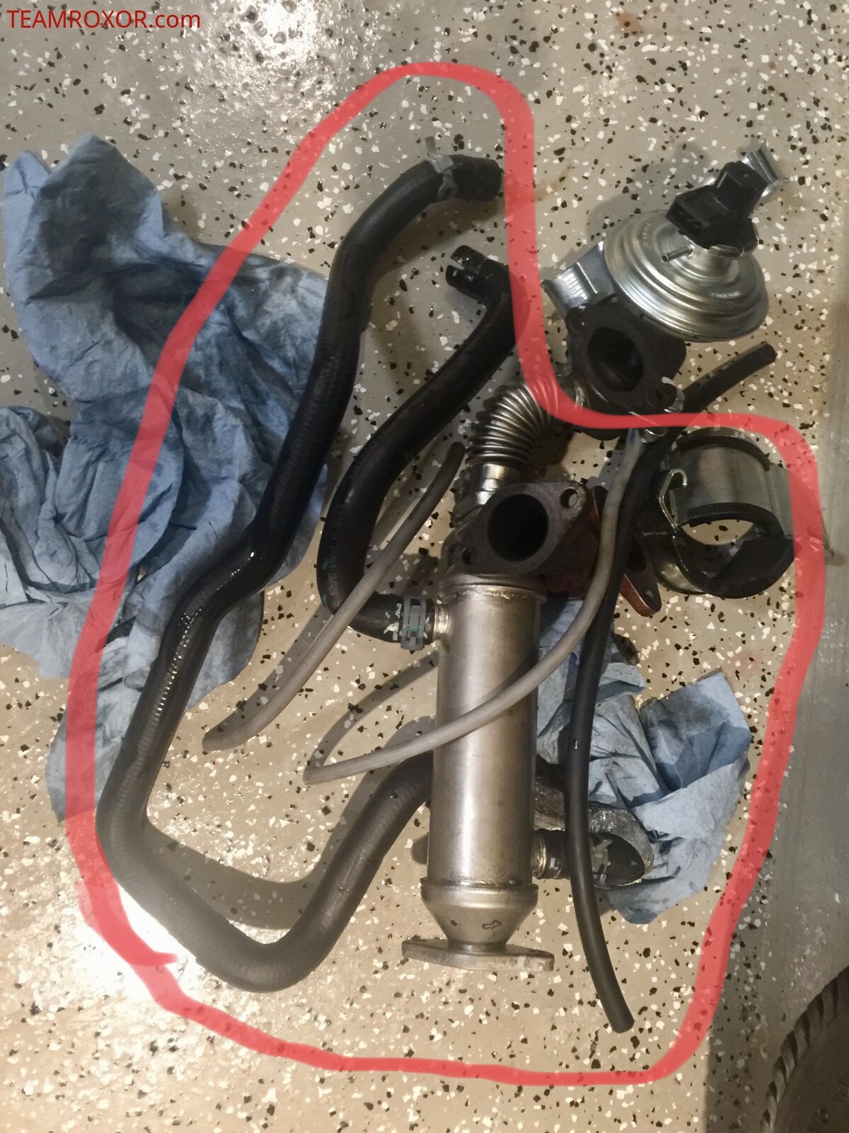

Everything circled goes away with a stock tune except a couple of the small vacuum lines.

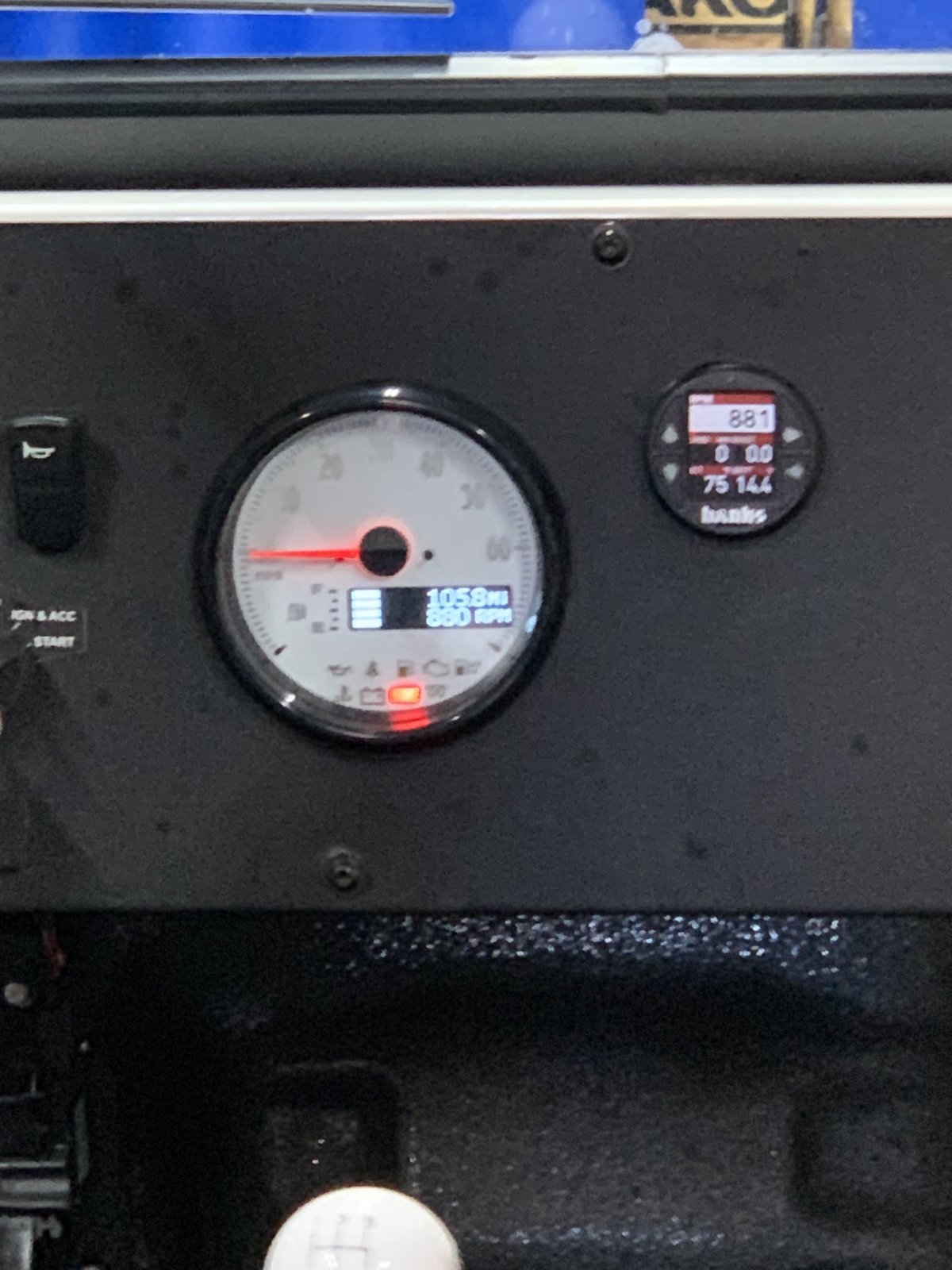

I put the banks idash 1.8 gage in and it works great. Need a exhaust that is stainless so I can install a get egt probe.
Looks great, why not drill and tap a hole in the rear block off plate instead of the exhaust. It will be much easier than trying to put a bung in the exhaust pipe.
Great idea thanks.

EGT probe goes pre turbo, right into exhaust manifold. When i install them, done a few on Cummins trucks, i let engine run as i drill and tap the hole. If i remember right prode should be 1/8th NPT thread.

I can pull the block off plate jimmyb sent me and drill it.
