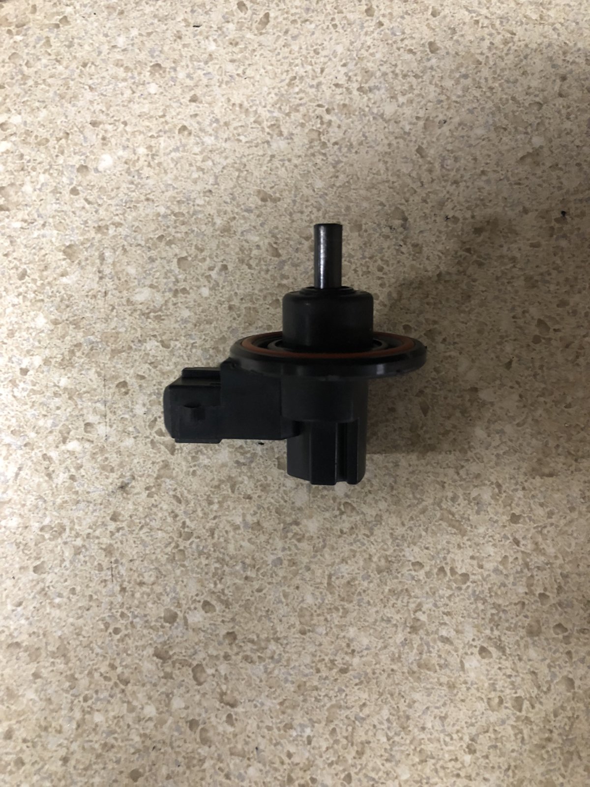

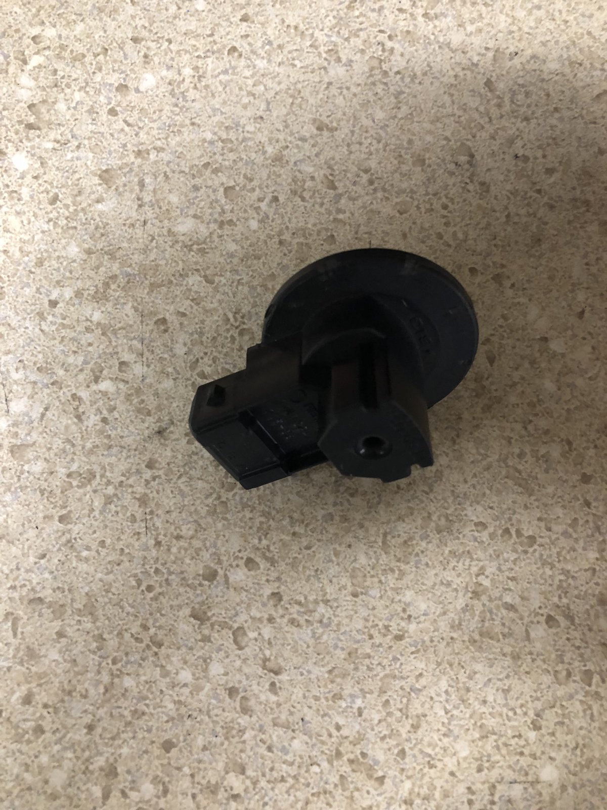

Jimmyb
Mar 13, 2018
189

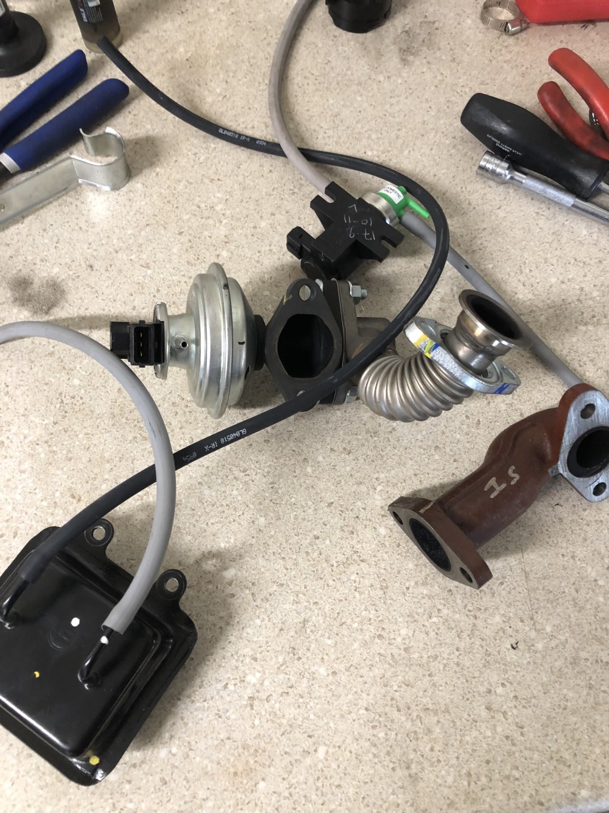

I found the sensor, pictures added. You can pry up the tabs on the top of the egr valve to remove the sensor from the assembly. Then you can tie the sensor plugged back in to the connector out of the way somewhere. This should fix the check engine light and keep the engine bay cleaned up without the whole valve assembly just hanging out in the way!

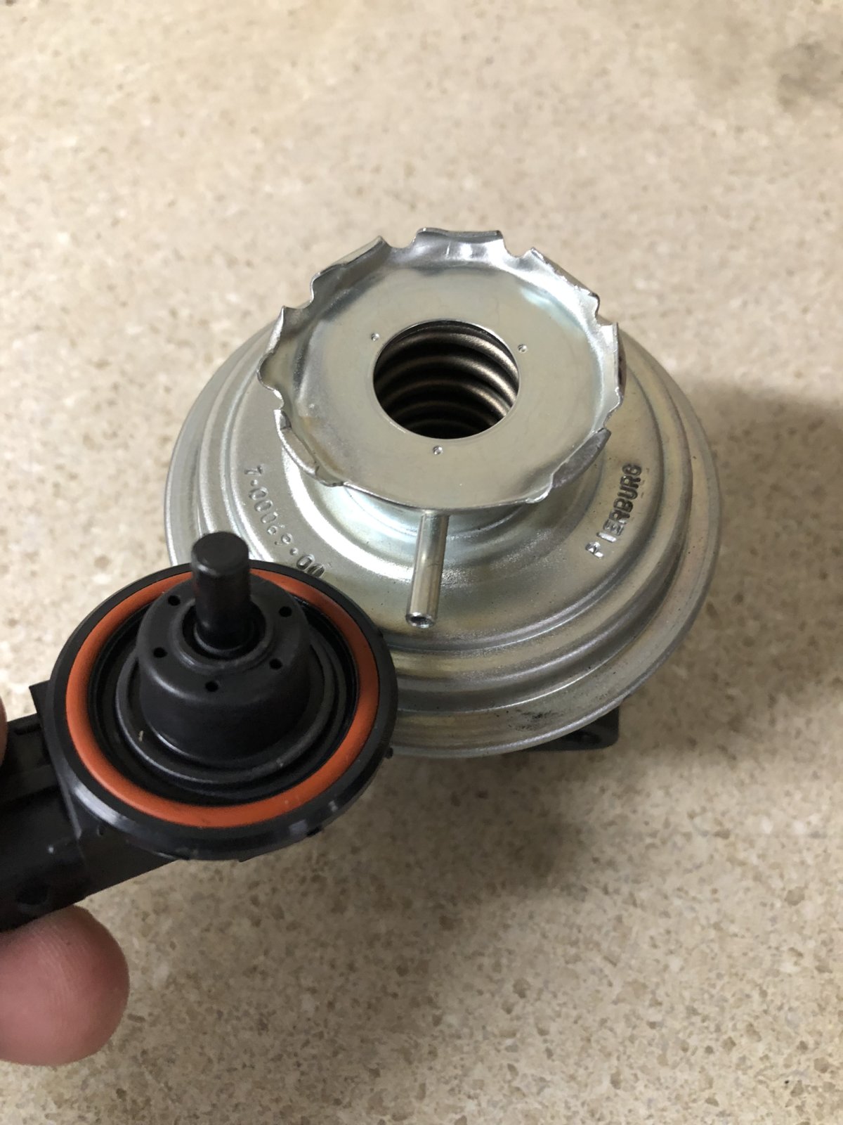

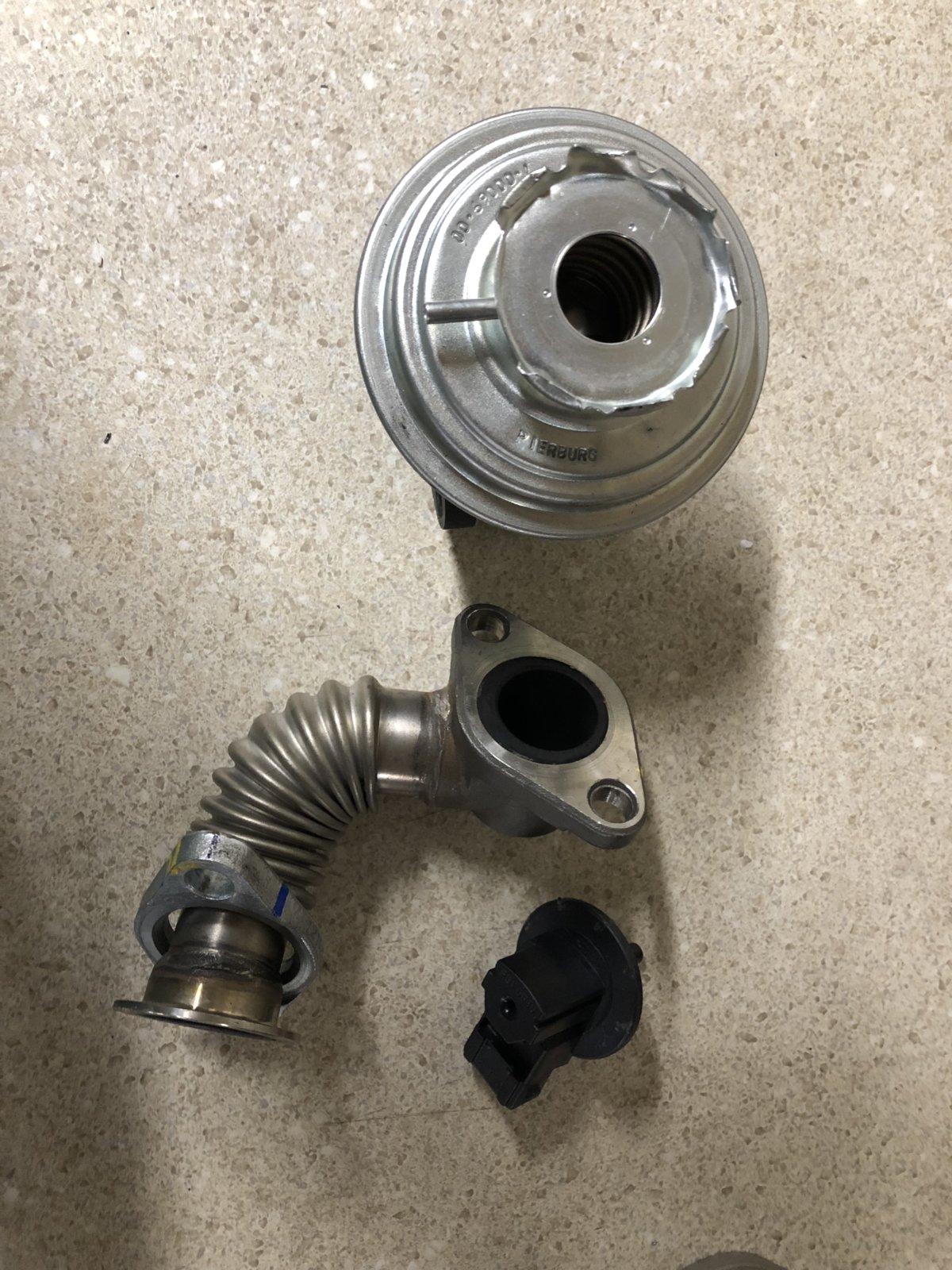

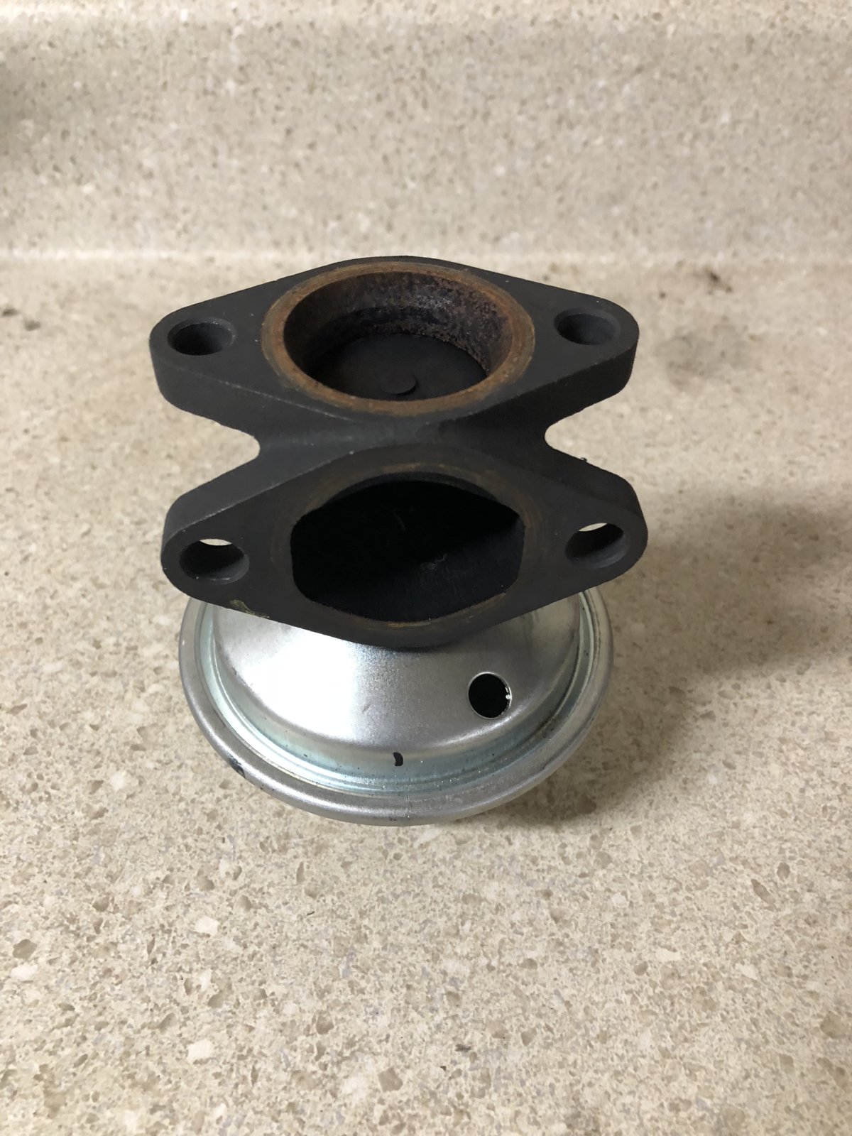

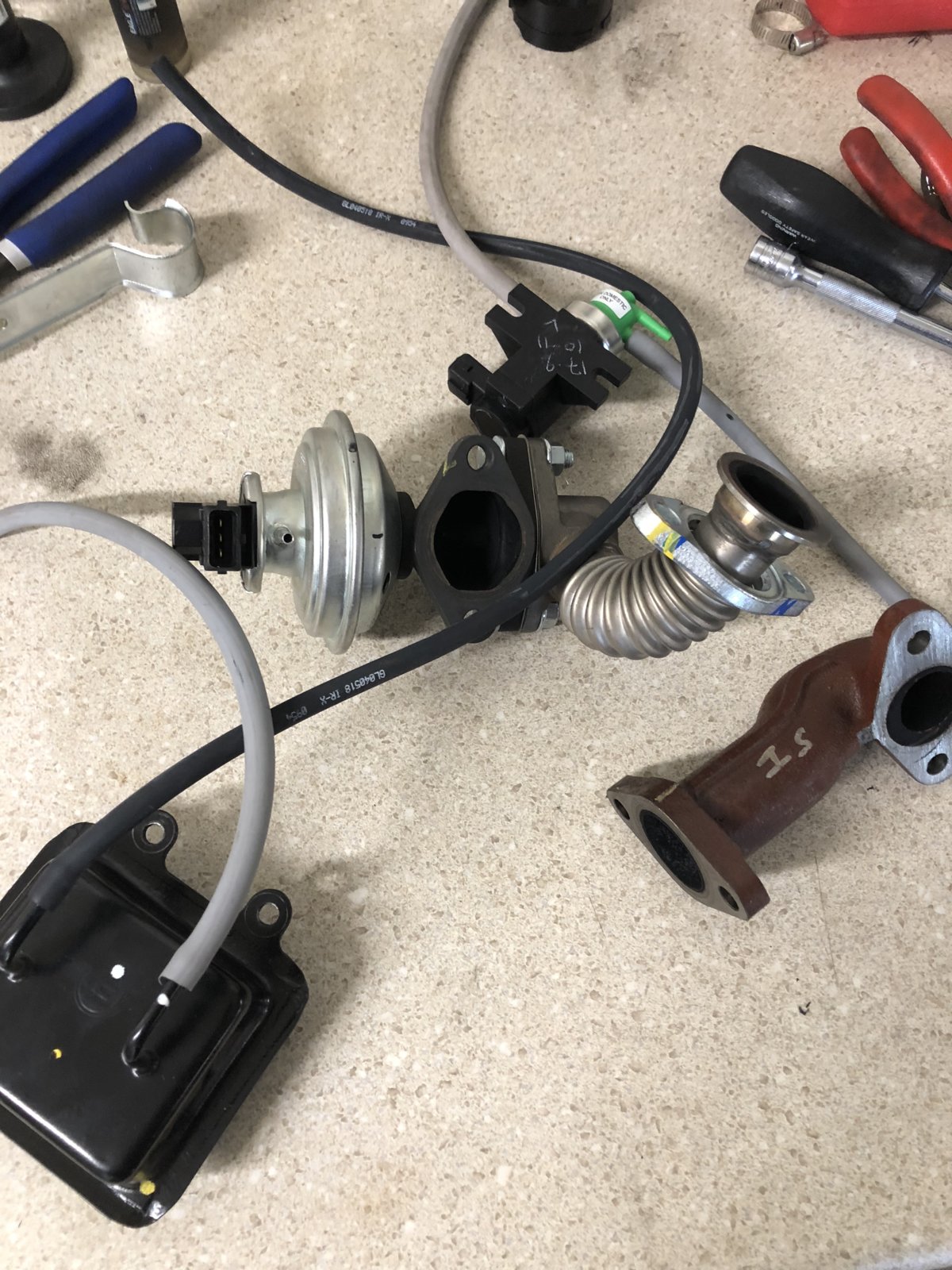

Jimmyb
Mar 13, 2018
189

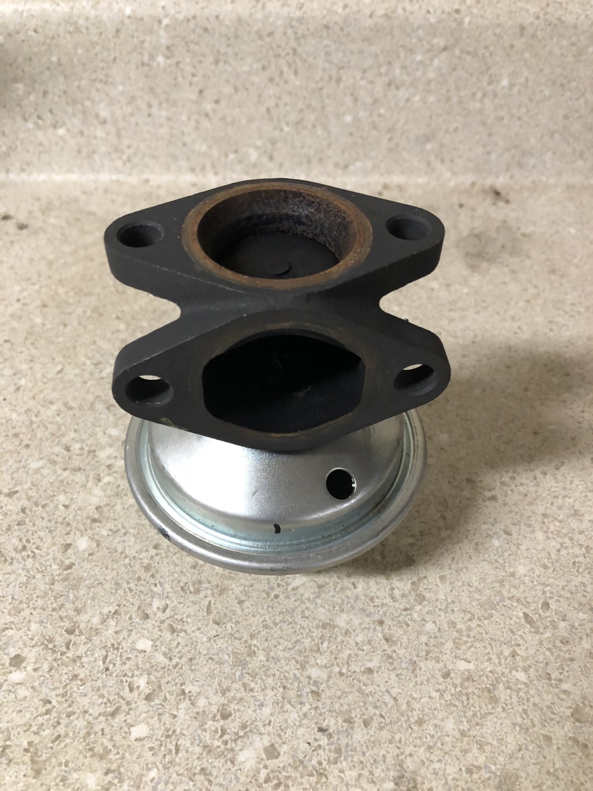

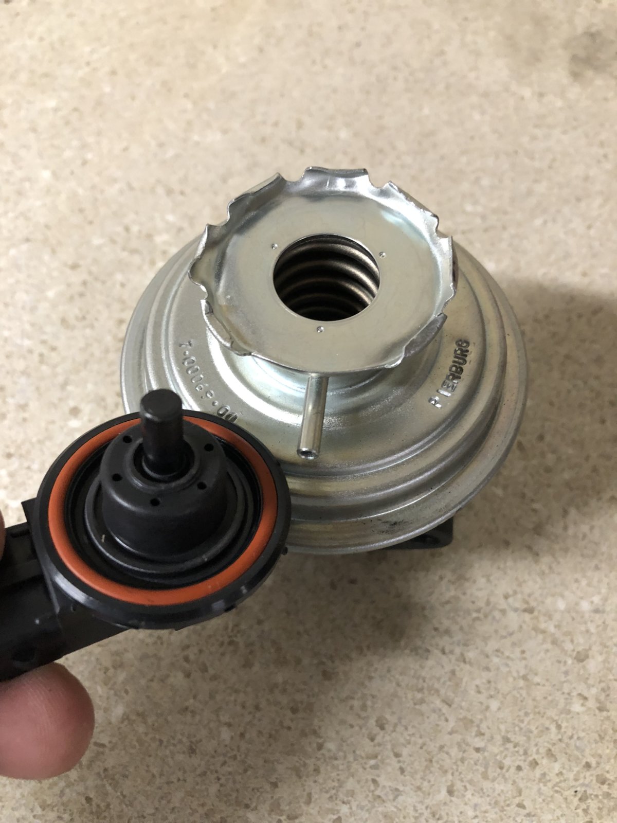

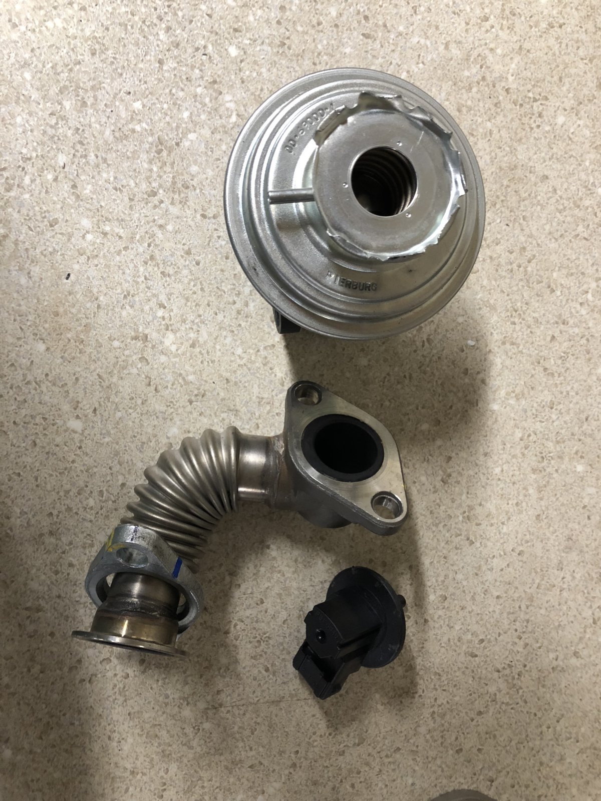

Wait, I may have another option or two and it may turn out for the best. I went to the garage and decided I was going to pull the egr valve as far apart as I could to see how it works. All of the new diesel trucks use an electric solenoid to control the operation of the egr valve. This one is much simpler by design and is effectively a spring controlled valve and the electrical connector in the top is a plunger that monitors the position of the valve. As you increase exhaust pressure, it overcomes the spring tensions and opens the valve, decrease the pressure it closes. I hope all of this makes sense, but I’m sure pictures will help.View attachment 1760
Disassembled, top of valve, the flex line that connected to cooler and sensor removed from the top.View attachment 1761Bottom of the valve with the flex line disconnected.View attachment 1762And finally the sensor removed, if you look in the top of the valve you can see the spring. So to answer your question of what to do: A) you can remove the flex line and leave it alone because both ends are closed just the open end of the flex line doesn’t give you a warm fuzzy feeling or B) which I like best, take it apart as I did and plug the sensor back in and tie it back out of the way. As it is now, nothing is making the valve travel up and down therefore you should still be code free and not have that big ugly valve just hanging out on the intake tube! Sorry for the long post, but I’ll be more than happy to answer any questions you have about it.

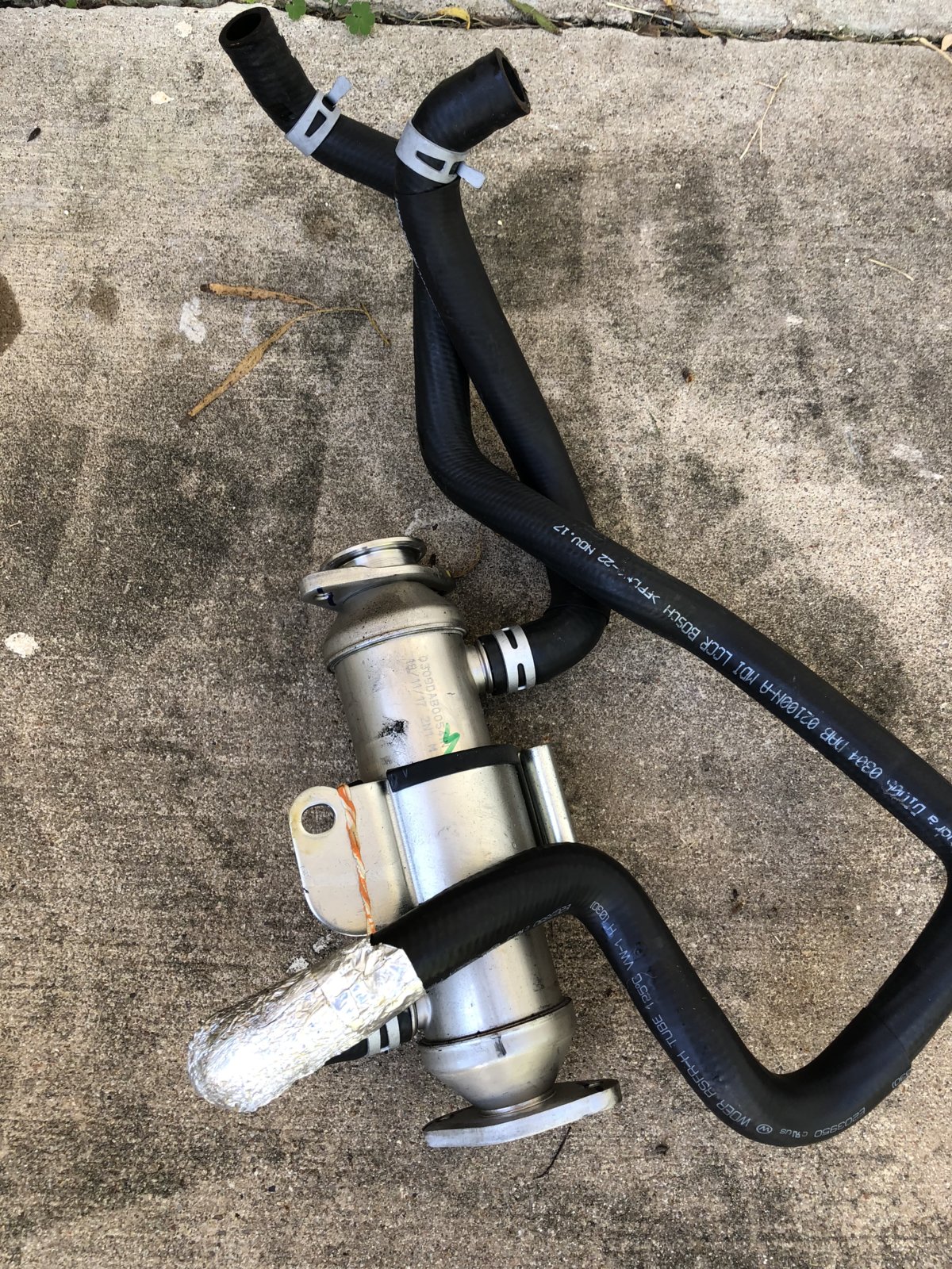

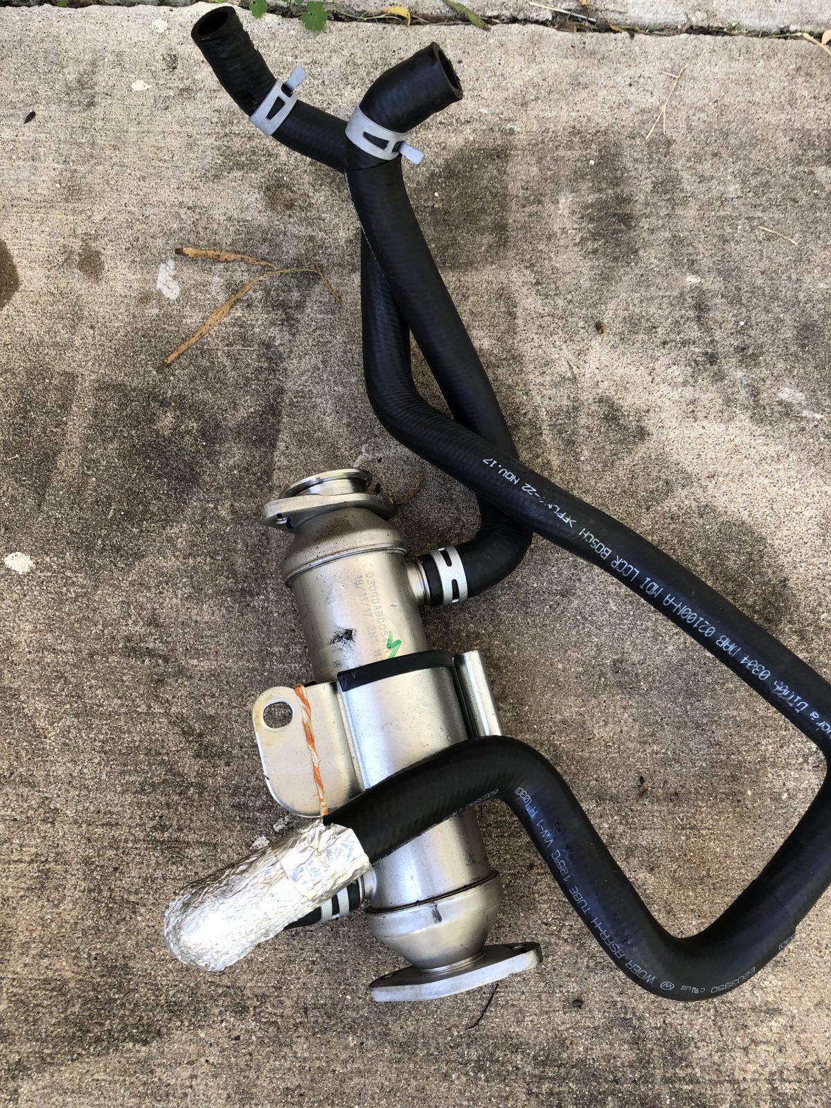

Main reason is it’s cheap insurance because if a cooler fails it puts coolant in the cylinders. Plus removing all of it including the vacuum stuff that is no longer used cleans up the engine bay a lot and gets rid of excess heat when the outside temp heats up. See pics below. Total time to install start to finish should be less than an hour.
View attachment 1544View attachment 1545
