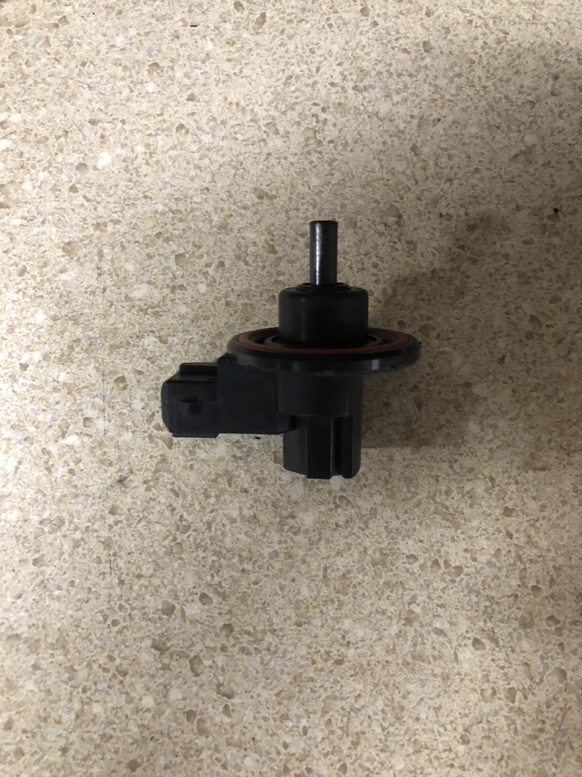

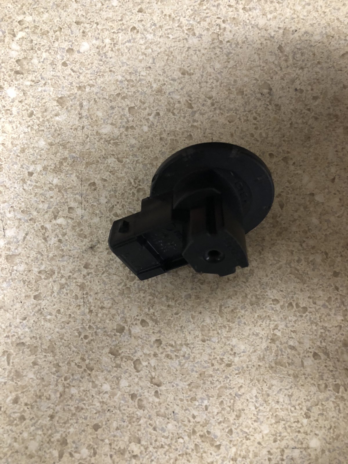

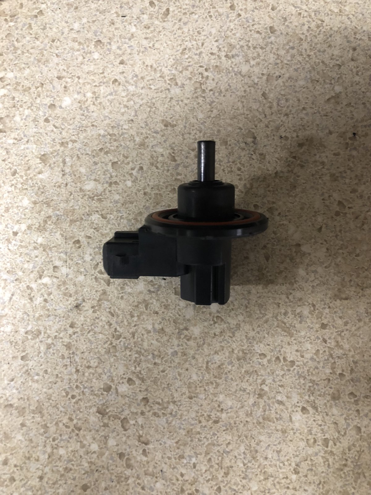

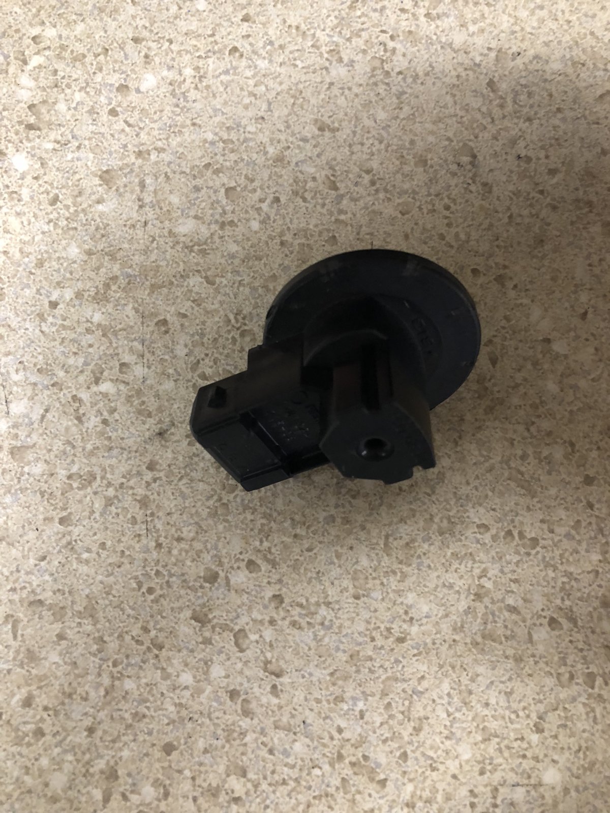

I found the sensor, pictures added. You can pry up the tabs on the top of the egr valve to remove the sensor from the assembly. Then you can tie the sensor plugged back in to the connector out of the way somewhere. This should fix the check engine light and keep the engine bay cleaned up without the whole valve assembly just hanging out in the way!
View attachment 3182 View attachment 3183
I know I am resurrecting an old thread, but has anyone got any input as to whether there is some long-term trials running the sensor sans the rest of the EGR valve assembly? I'd like to try it, but I don't want to destroy the complete assembly getting the sensor out only to find out this isn't going to work. Thanks!

Did you leave the sensor in the assembly and zip tie the whole thing, or did you pry the sensor out of the valve assembly and zip tie it? If you did take the sensor out of the valve assembly, are you getting codes? Thanks for the help!

I don't have codes because I did it correctly via the ECM and deleting it. I left only the wiring, got rid of the sensor. What year is your roxor? Just making sure you can delete it accordingly without throwing codes or going possibly into limp mode
At some point, yes. That isn't the question or concern I have. What I am asking is if anyone can confirm any long-term success with removing the sensor from the EGR valve (as is being discussed in the above quote attached and previously discussed in this thread). I'm just trying to figure out if I should leave the EGR sensor in the valve assembly (still in comms with the ECM) or if I should remove the sensor (still leaving it in comms with the ECM). I understand that until the ECM gets reflashed, I'll have to have the sensor, one way or another, in communication with the ECM.
To answer your question again yes it'll be fine, only after you do the delete from the ECM. 32k miles and no issues
