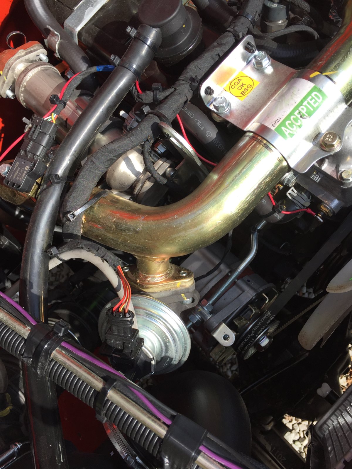

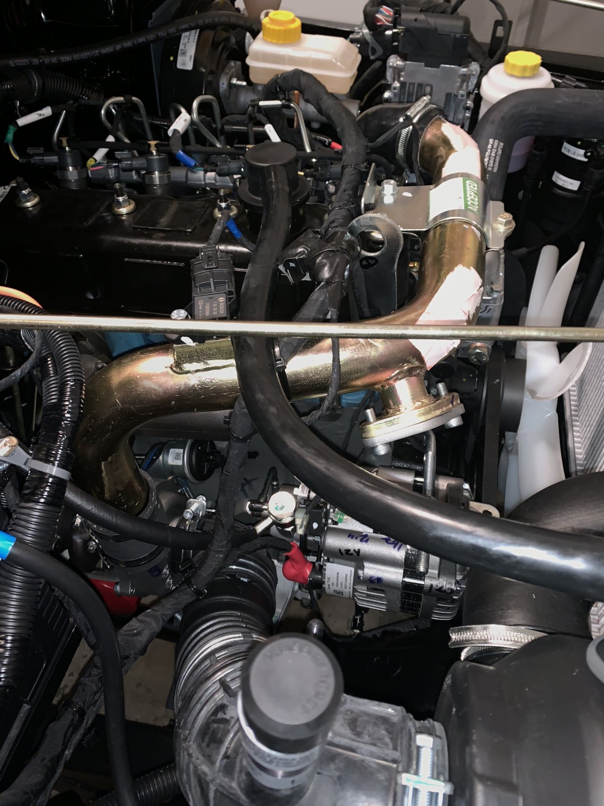

jddotson68
Oct 19, 2018
7
Stewartsville, NJ, USA
0739

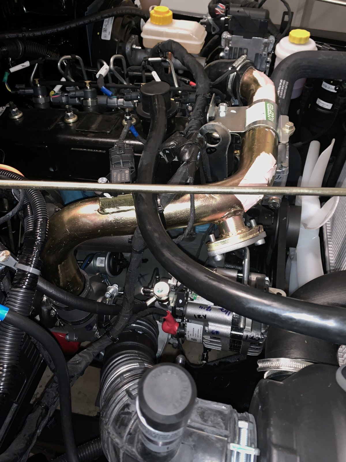

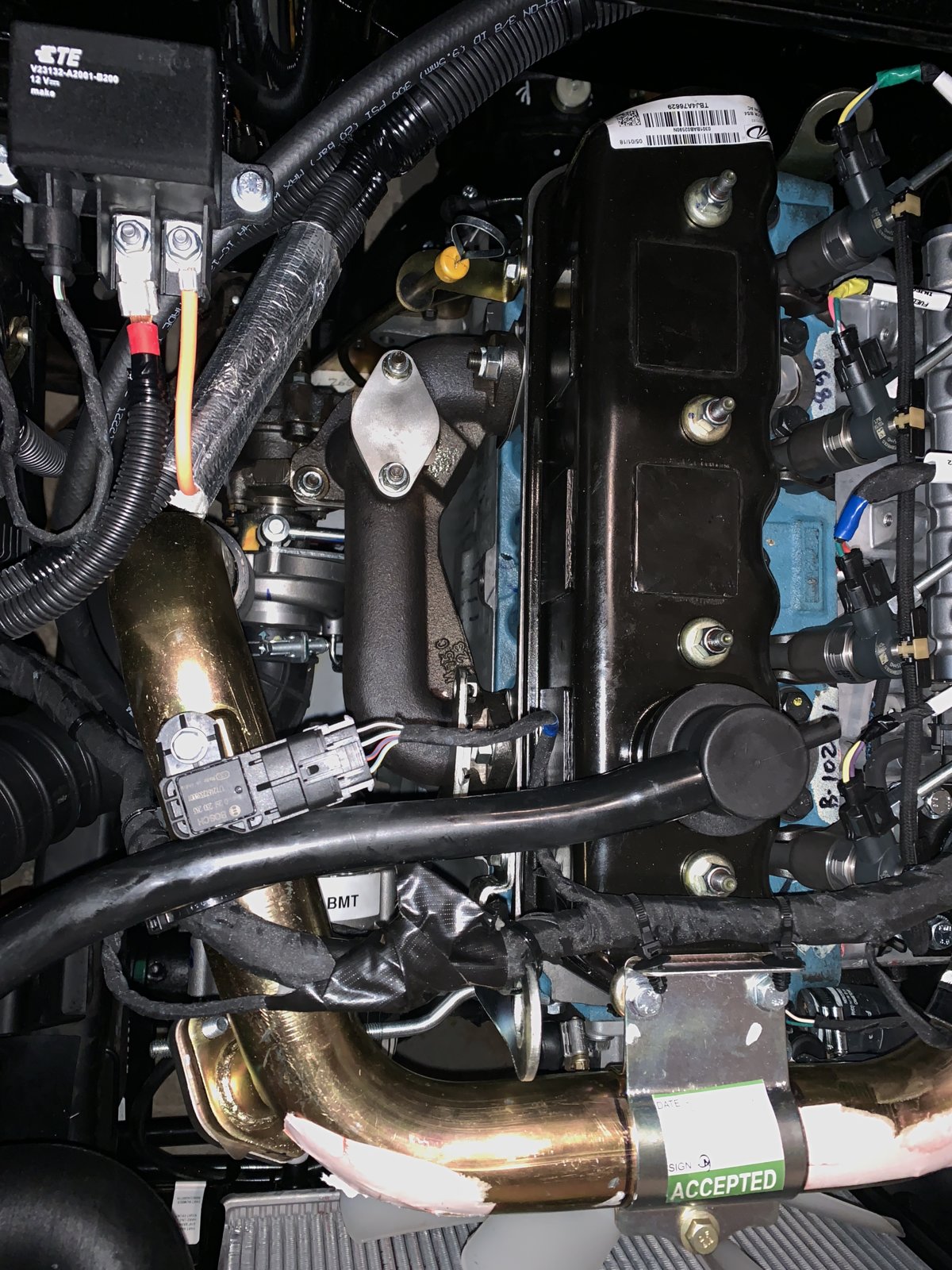

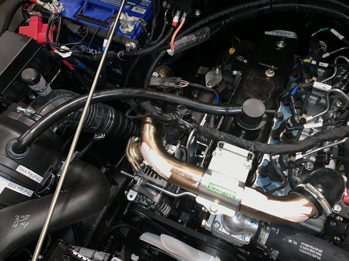

I received my kit from Jimmyb today as well. I have to agree with the previous post...quality parts and detailed instructions. EDIT...deleted EGR this evening. The instructions were simple and easy to follow. The block off plates fit well. I only drained about 1/2 gallon of antifreeze from radiator and didn’t have any coolant leak when removing the EGR coolant hoses. Waiting on the coolant to drain was the longest part of the whole process.

View attachment 1665View attachment 1666View attachment 1667
Looks great! I’ll modify the instructions to drain 1/2 gallon instead of a gallon. Also seeing yours reminded me I forgot to include removing the coolant line bracket from the top of the valve cover. Thanks for sharing!
