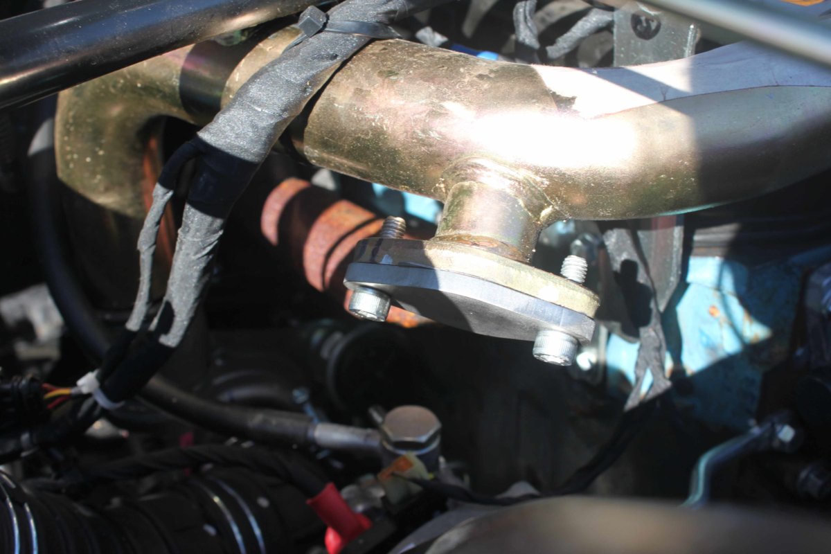

I can pull the block off plate jimmyb sent me and drill it.
Exactly, you can drill and tap the block off plate and reinstall instead of worrying about shavings in the manifold and turbo. If I were better set up for production, I would have sent them out pre drilled and tapped with a plug that way it would be easy for those that want to add a pyro.

Looked at a picture of exhaust mainfold, the block off plate is like the perfect location. I would remove it as well.

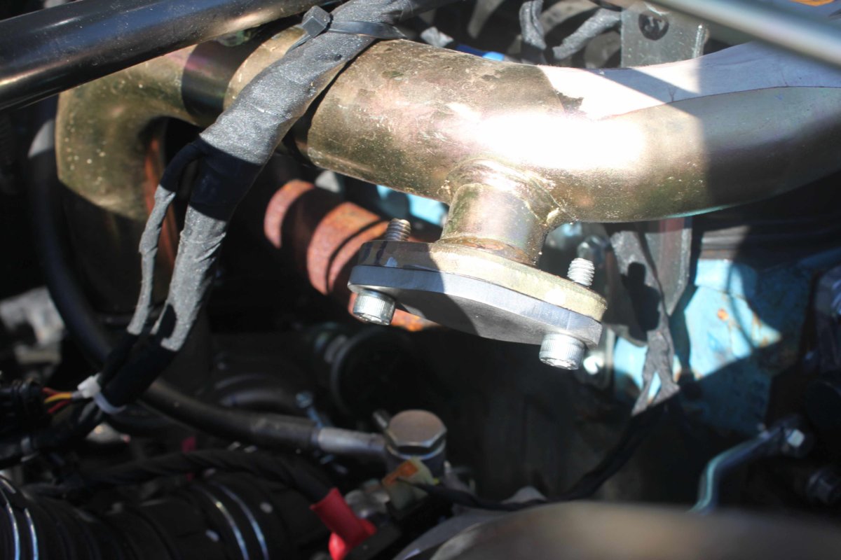

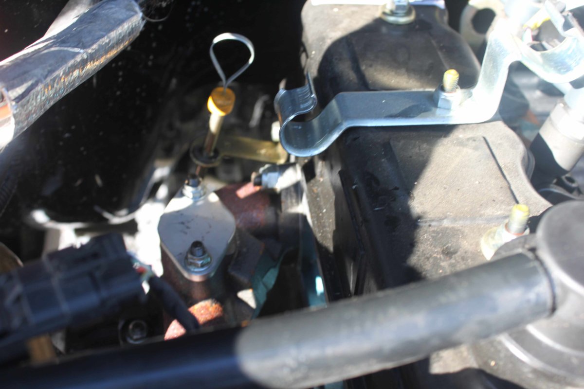

We had a burst of nice(ish) weather Saturday so I installed the EGR delete kit I got from Jimmyb. It took about 1 and 1/2 hours, mostly due to one stubborn 6 mm bolt, the left one in the first photo. It is nice to have some extra space under the hood, plus a place to hook the heater in when I get the time for that. The instructions were clear, and the only surprise was the small amount of coolant that was still left in the EGR cooler, which I spilled of course. I taped off and secured the unused connectors. And you can actually see the dipstick hole now. Since mine is a 2018 model with no tuning, I didn't see any codes. It is satisfying when something goes right!
View attachment 3131View attachment 3132View attachment 3133View attachment 3134
Did you leave the EGR valve hanging and connected to the electrical plug (connector)? Or did you completely remove the EGR valve and still got no codes?

I took out the vacuum solenoid and the EGR valve and taped off the connectors. I did not see the "check engine" light come on and so I did not hook up a scanner to see if there was a code. Of course, we are now getting many inches of snow, so it isn't easy to go out and double check my work and results. I will definitely go back and double check and put a scanner on the OBD port, as it seems I should be getting a code or two based on what others have reported. I did run the Roxor around the property for half an hour after completing the delete, and I couldn't see/feel any problems.

Well, either I'm not very sharp or I was abducted by aliens. (Probably both.) I do now get a check engine light, and probably did before. I connected an OBDII scanner and read a P0402 and a P0404 code, both related to the EGR valve. I cleared them, reconnected the EGR valve, and started the engine. No lights this time, I looked twice to make sure. So now I have to decide if I want to mount the whole valve assembly under the hood, or if I can strip off some of the uneeded plumbing.
