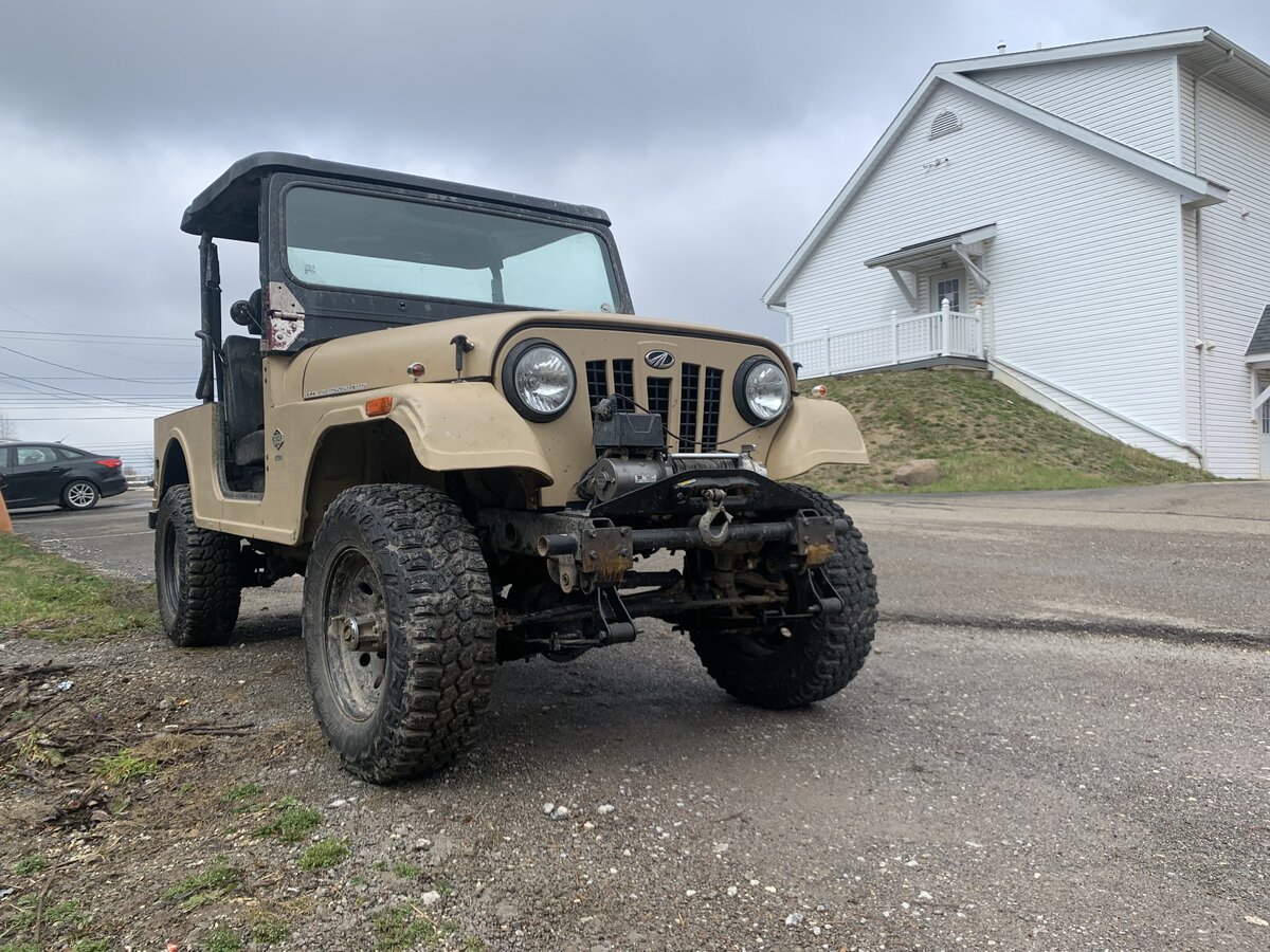

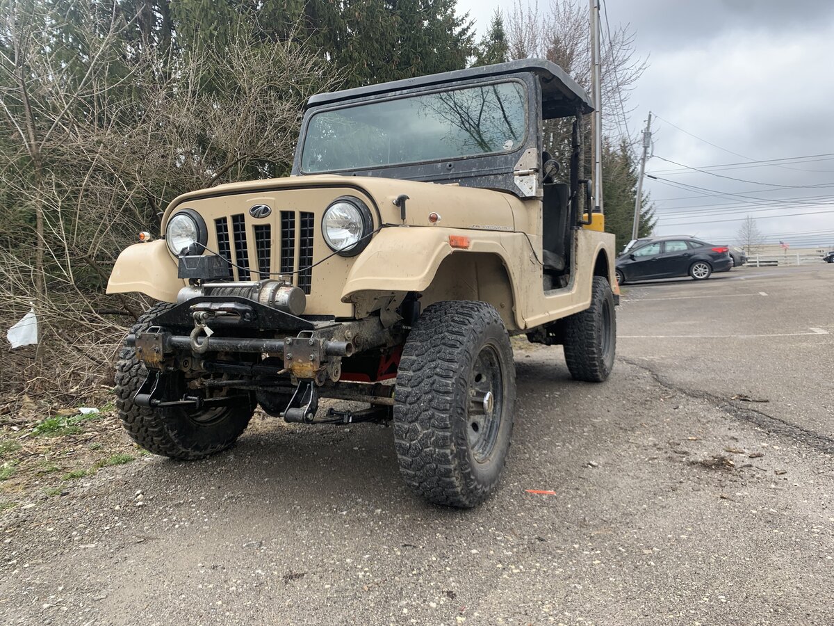

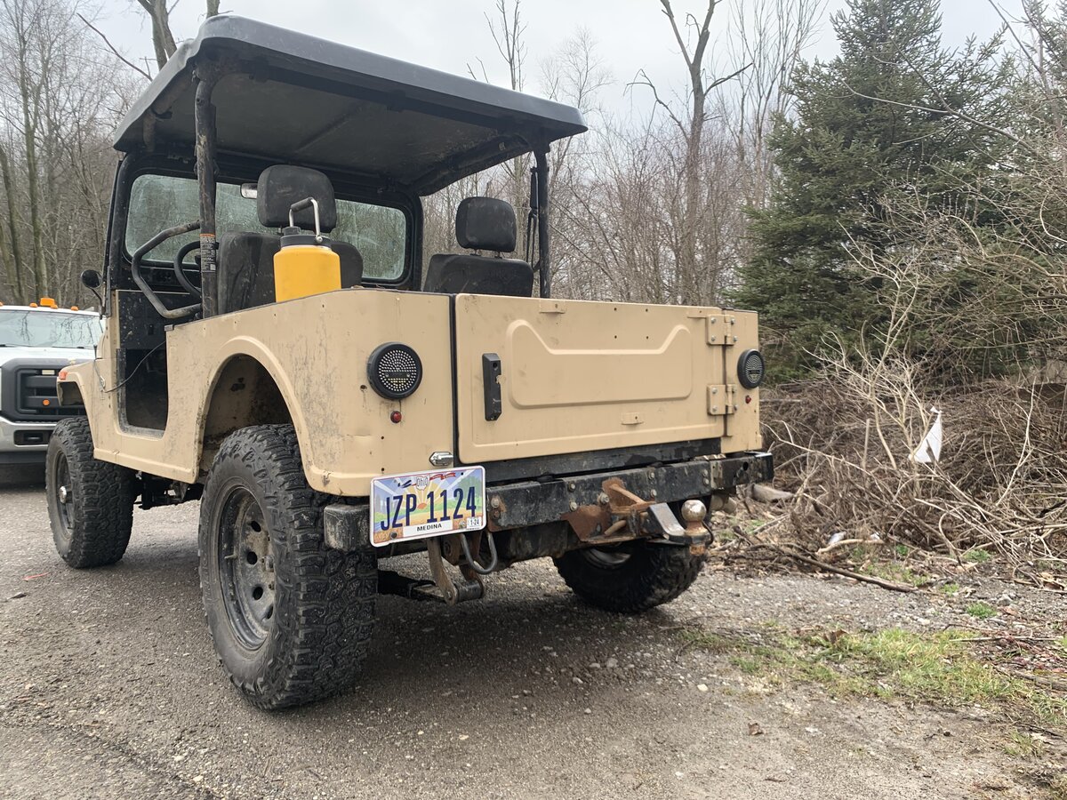

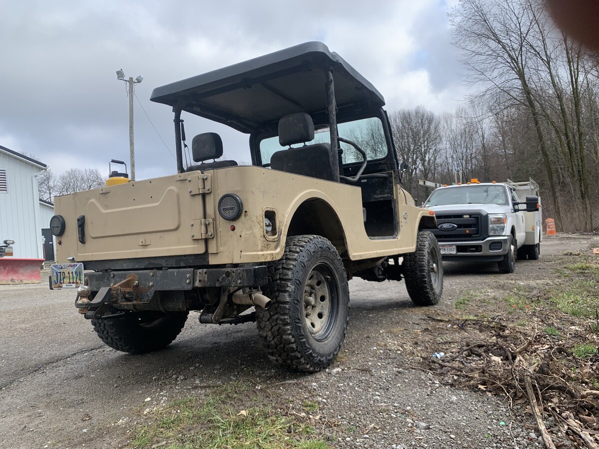

Another roxor done with stock height YJ springs.
His Email:
"Hey max! Finally got my kit on and driving it and wanted send you some
pics maybe you could add them in that long travel forum I found online.
I did your lift with stock height springs and their was another guy in
Texas that posted his shocks with the same stock height springs with
heavy duty 6 leaf rears and was hoping you could add this in share my
pics and say how great the ride is I love this new ride!! Also didn’t
have to extend the front drive shaft it didn’t move enough to worry
and I added the longer brake lines from ceccos website your the man
max!!"

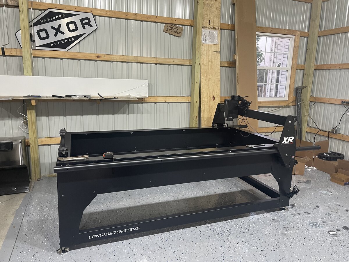

New plasma table will be here this week! Give me a couple weekends to get it wired, set up, and broken in. I’m sure there will be a bit of a learning curve to get it dialed in to were I’m happy with the quality to start kicking kits out to you guys.
Max A.
Nov 4, 2019
604
Baltimore, MD, USA
00168
Nice, you’re going to like that table.
I have over 30 miles of torch movement logged on my 24x24 table lol she is beat! But that little Langmuir never let me down.
