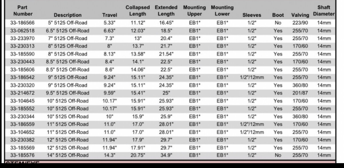

What shock valving rate is suggested ?
bilstien has 2 rates
255/70
170/60
very early in this thread it seems the shocks recommended were 170/60

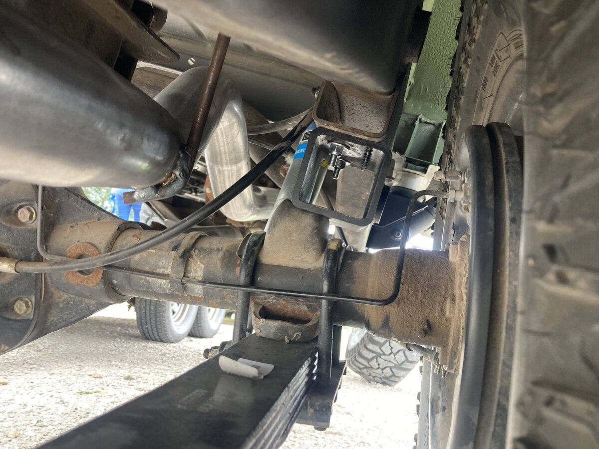

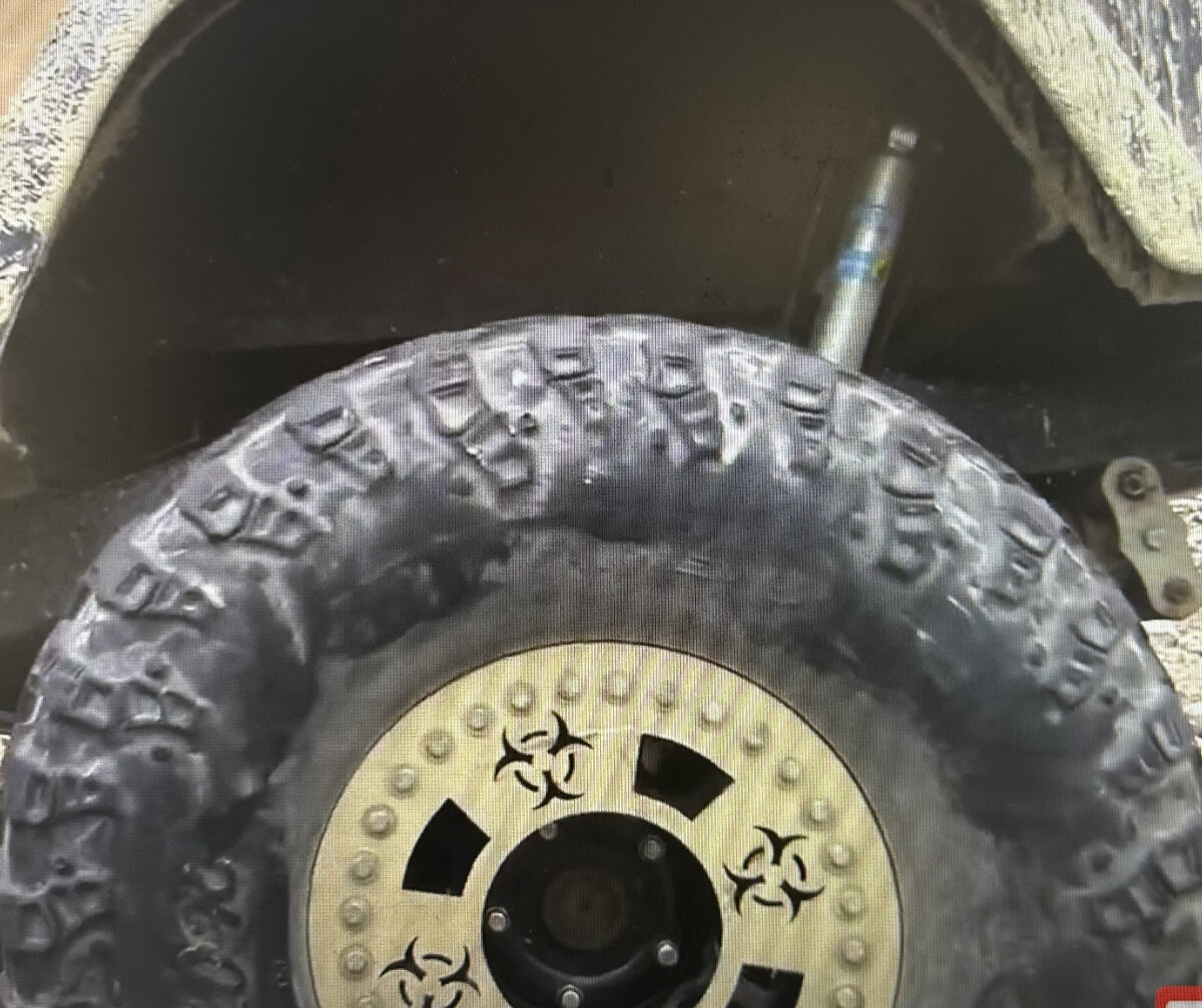

Anybody try to mount the rear shocks here like this wrangler YJ? Seems too tight on room
Thoughts? Longer travel shocks could be installed w this set up

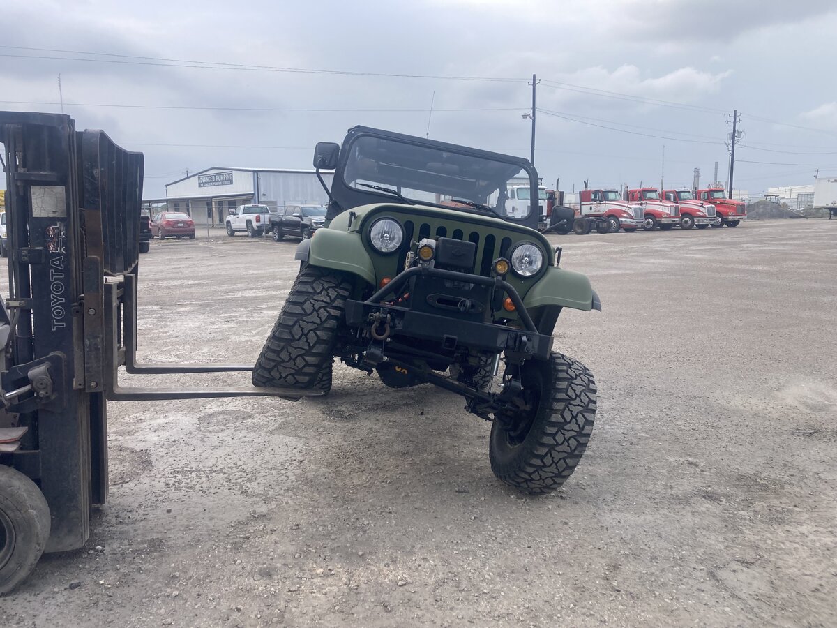

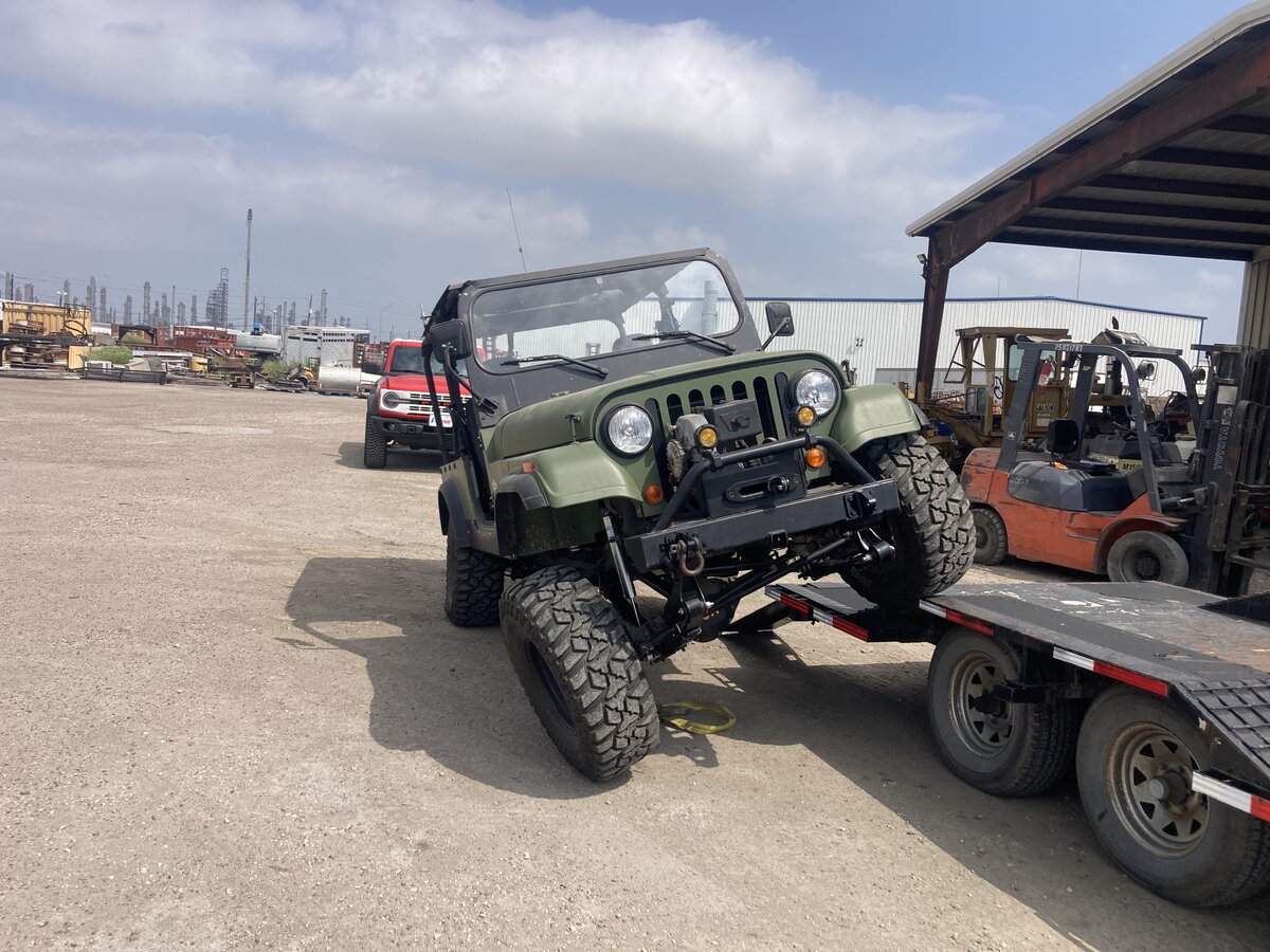

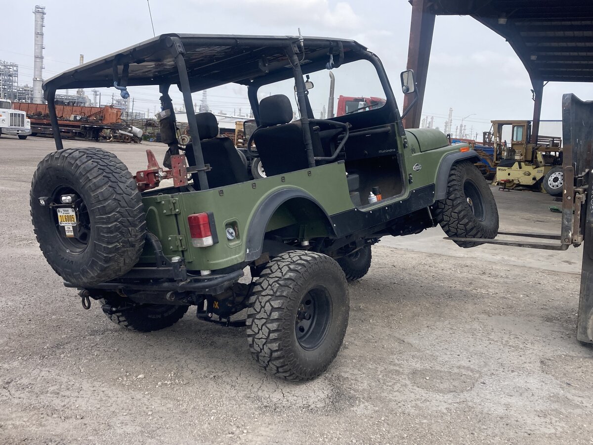

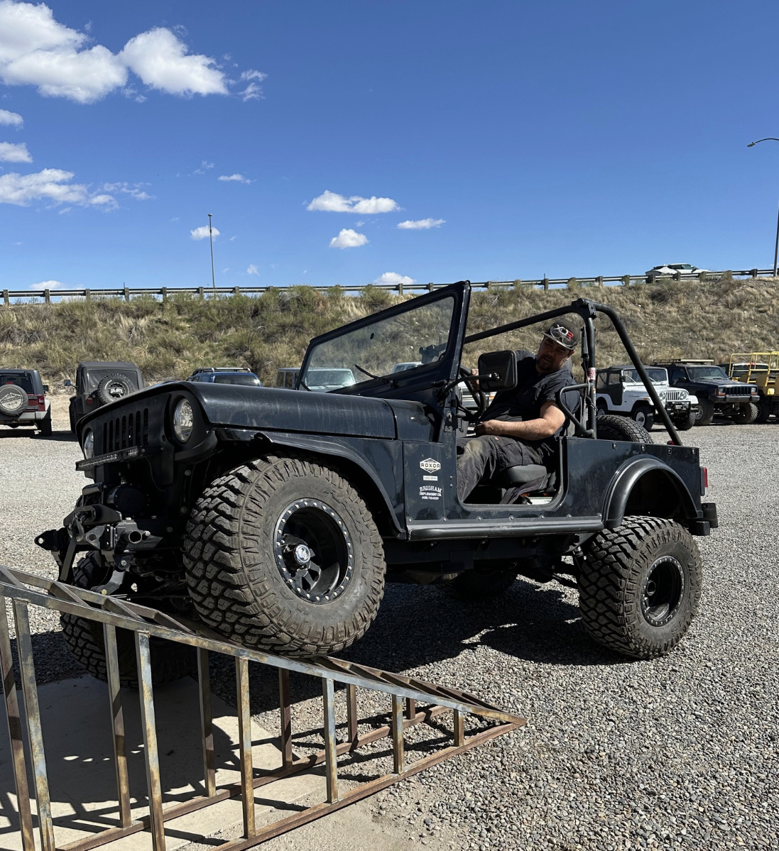

picked up the Roxor from the shop that put the lift in. I’m amazed at the difference in flex and ride quality. Wished I did it sooner. I am shocked that I was bump stopped perfectly for my 33s and I think even 35s. Now they need to be extended longer. I guess the Geometry changed with the dropping of the suspension hangers. Easy fix that I’ll do myself.

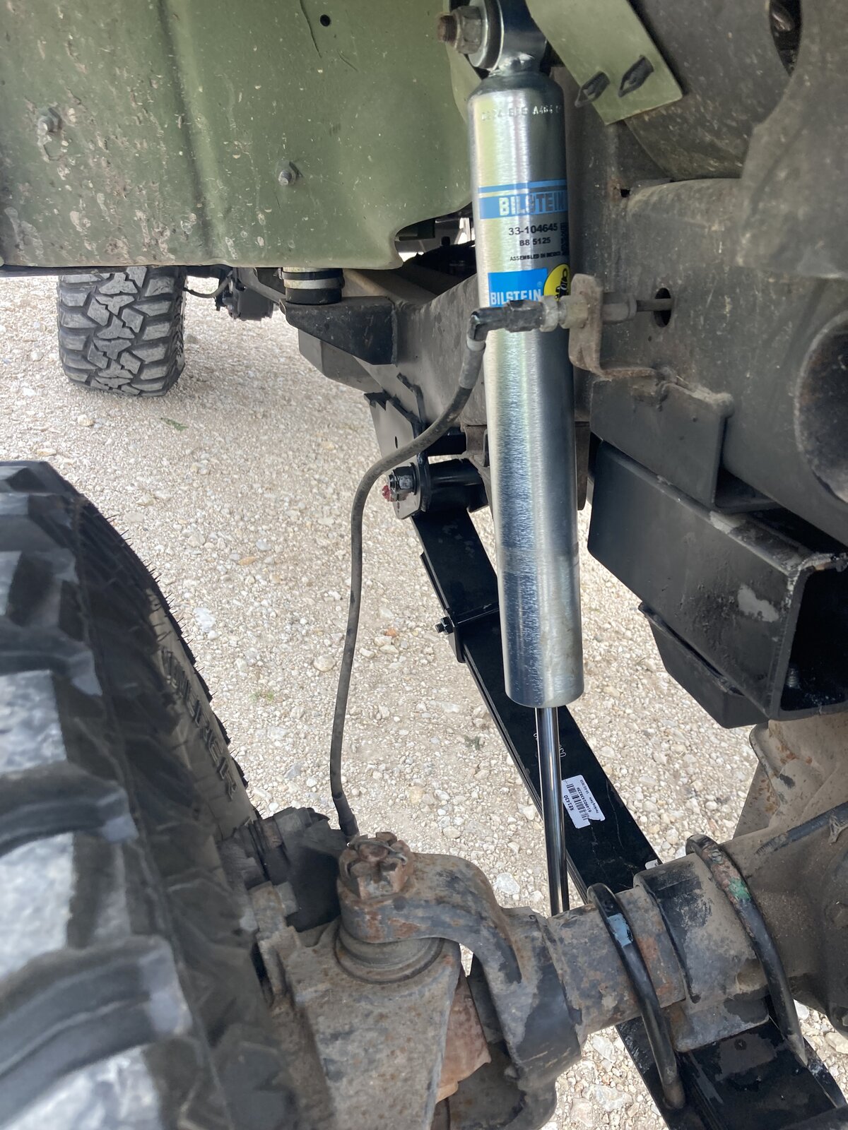

Txroadkill- what shocks do you have up front?
The shop has mine almost finished today
Need to pick some front shocks
TomRox
Apr 15, 2023
168
Colorado
8164
These?
Front shocks - 33-104645
Rear shocks- 33-230443

Unfortunately there just isn't much clearance for socks outboard of the frame. I do have extended shock towers available but they only work with axle swaps.

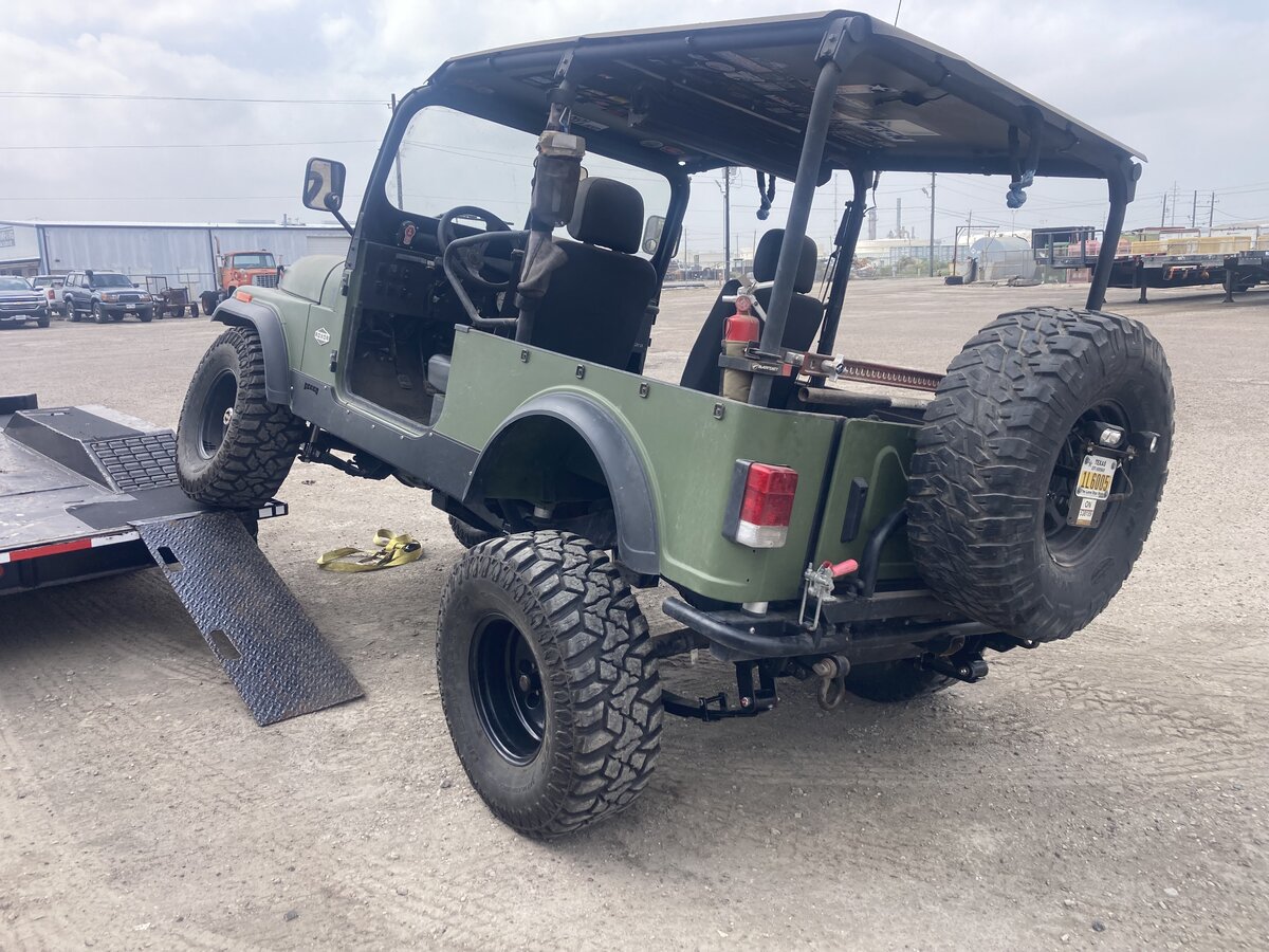

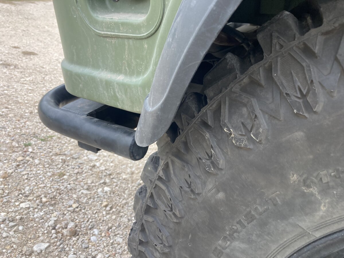

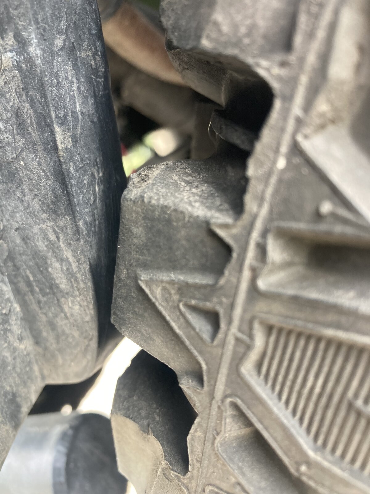

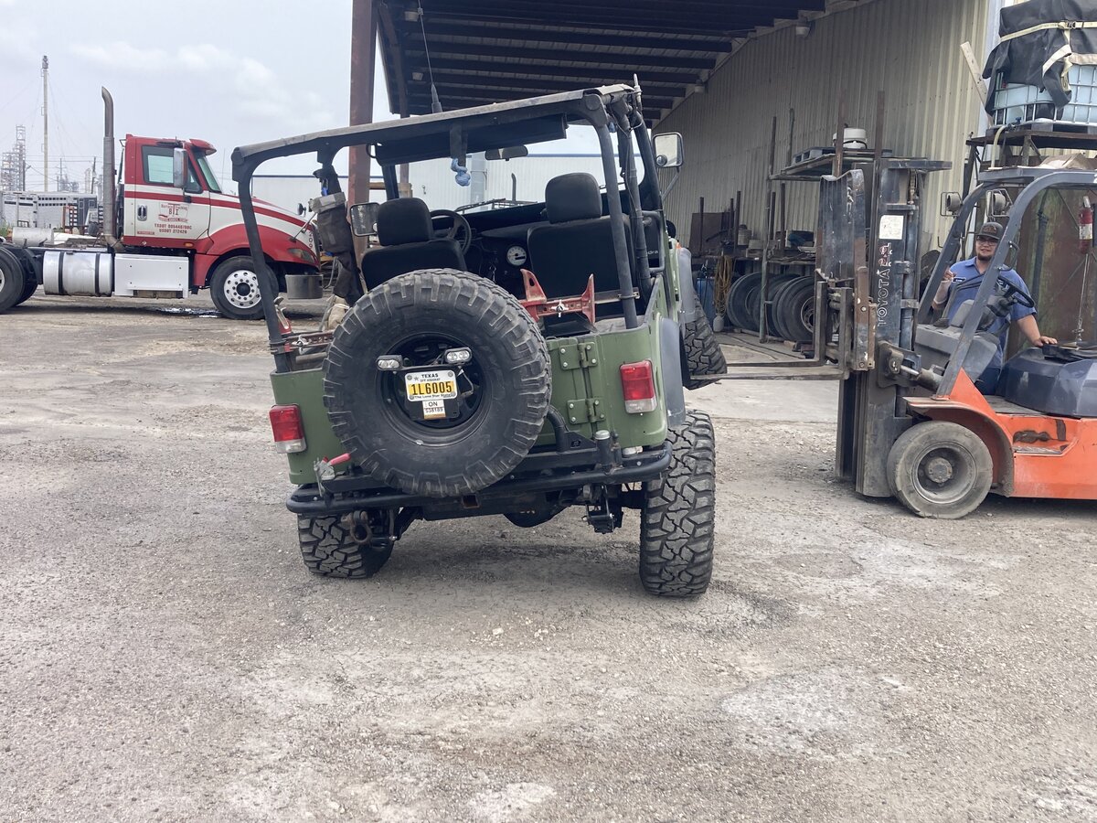

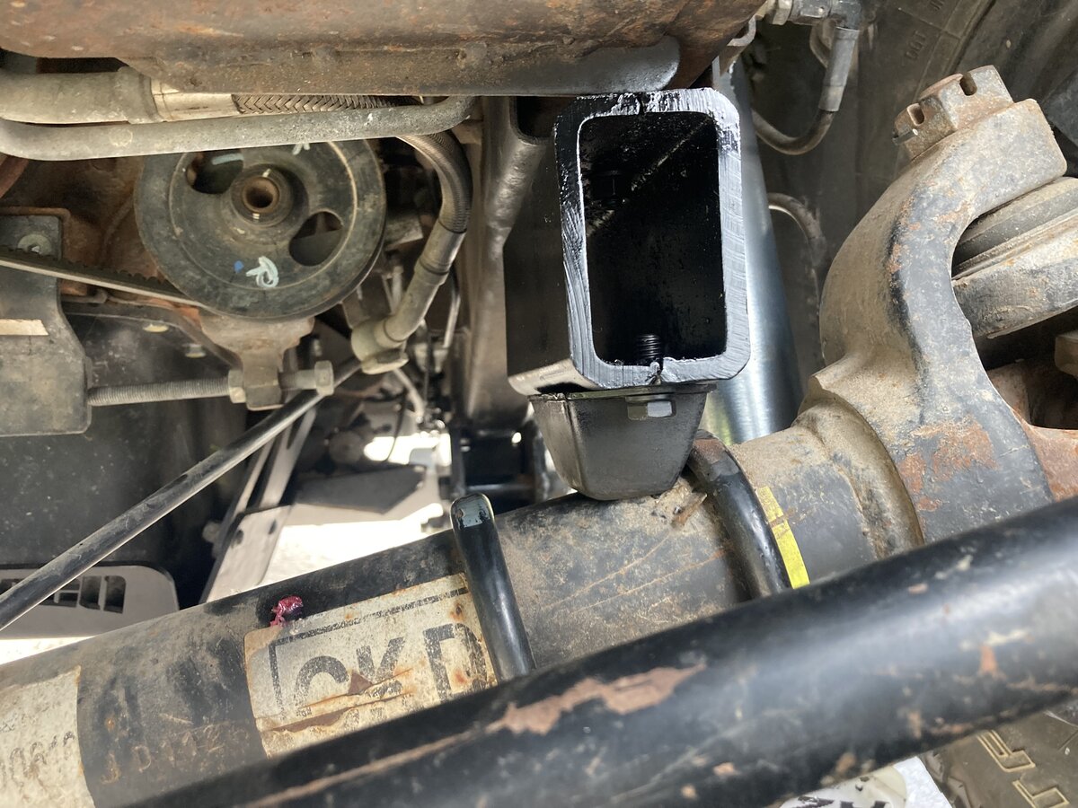

BUMP STOPS;
2.5RE springs and a cecco body lift
33’s bumpstopped for future 35s.
REAR: Some 3” tubing bolted to the rear frame works great for bumpstops. Thought I had them perfect for future 35s but the stock rubber bumps squished and fender cutting on the lower rear corner will be required for 35s. On the forklift they were fine, when I drove it on the trailer is when I discovered the squish. 33s clear just fine.
FRONT: used the same 3” tubing but narrowed it to 2” wide like the factory stop width and made them 7” long to extend the stops forward about an 1.5” to go with the axle stretch. They look to be good for 35s and I don’t think the stops will squish down like the rears did.

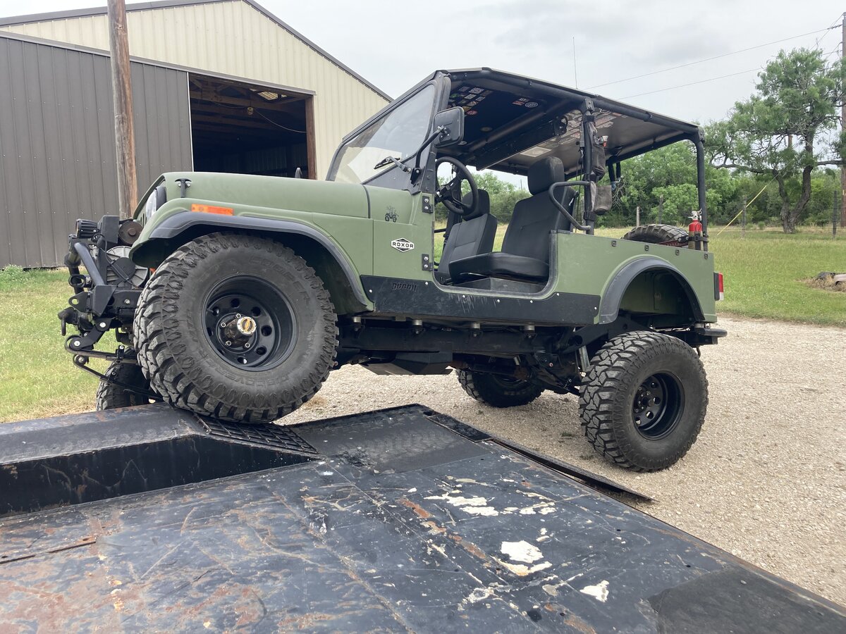

I went with 1.5” springs from super lift
I ended up with 2 3/4” lift in front and 1.5” in back
33” tires
I put generic Amazon 2” universal Jeep bump stops in front, vs the 1” factory
For shocks running the 33 series Bilstiens
Your limit will be the compressed length, you want the bump stops to touch prior to full compression of the shock,
You may want to check full droop extension
Compressed and extended length
Or
33-185590 would work If you don’t want to overthink it
