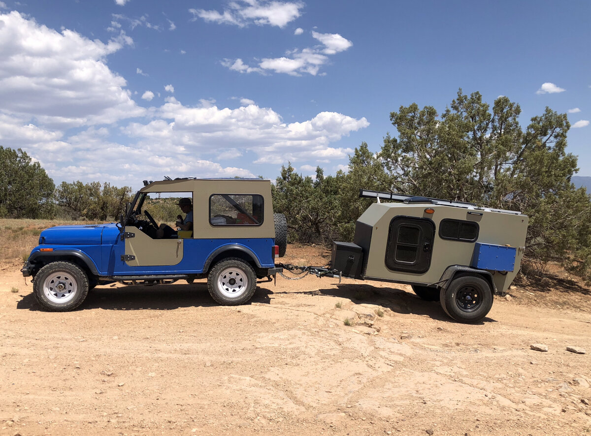

I took my 2018 Roxor to New Mexico and back from Iowa last June pulling my camper. It was a touch over 3000 miles in 10 days. Only issue I had was crossing the Rocky Mountains, in a couple places I had to drop to 4th and slow down a bit to keep my engine temps reasonable. Primarily back roads and ran 55-70mph.
We take it out nearly every Sunday for random wandering and a picnic, we usually cover a couple hundred miles on those picnics.
24,000 miles on it so far and problem free.
Its stage 2, aluminum radiator and electric fan, added a intercooler to it after the New Mexico trip.
824
I read the email version before I saw your pic and was wondering how big of a camper and was glad to see what you had behind the Rox. I assume you have a full size plate? Here in UT they are a SXS so no freeway for us. Good to see the Rox holding up great post on its durability

That's a fair bit of summer driving without A/C! Glad to hear that it held up well despite the section through the rockies where it was wanting to heat up.
Fallacy
Sep 2, 2019
65
33
Stanhope, IA, USA
It was brutal for a couple days, we saw a high of 113 the first day while in the middle of Nebraska, the second day in eastern Colorado was 105~.
