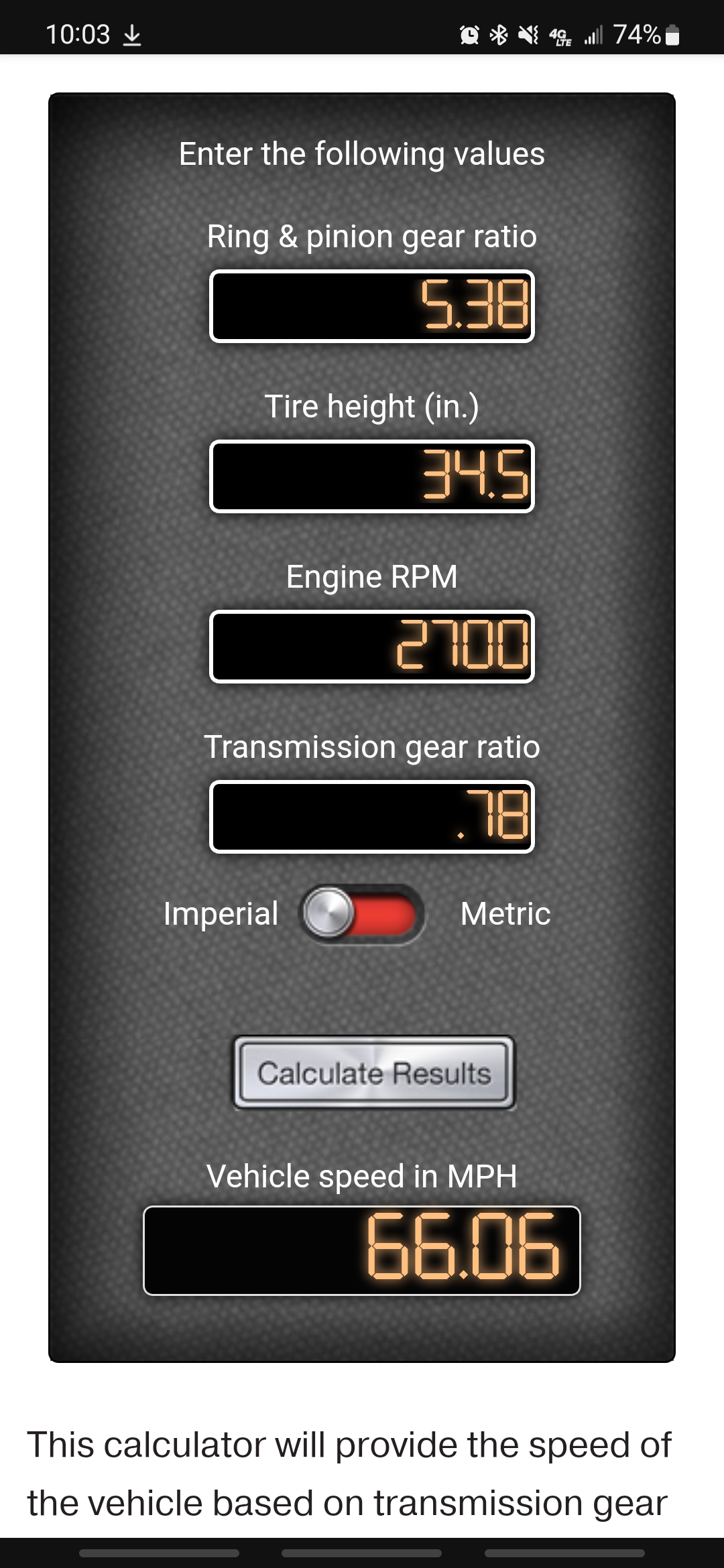

I have the 2022 roxor. Done a few modifications and two 1400 mile road trips. It's holding up good so far. But the newer roxors with 5.38 gear Axles can't go that fast so I only go on roads were the speed limit is 65 or less. I can go 55 to 60 mph without pushing the engine to hard.

I have the 2022 roxor. Done a few modifications and two 1400 mile road trips. It's holding up good so far. But the newer roxors with 5.38 gear Axles can't go that fast so I only go on roads were the speed limit is 65 or less. I can go 55 to 60 mph without pushing the engine to hard.View attachment 12353
Hey! I like that calculator. Got a link?
Thanks!
Unless you have a charge air kit, and a rx41 turbo with a intake correction kit I STRONGLY advise going above 60mph especially for long distances. The coolant temps alone will shoot up beyond what is safe. I noticed pre mods vs post mods. As another member say not built for speed, I can hit 80mph but I decide to keep it 55mph to 60mph. 80mph feels very uneasy for me
I haven't installed any of those items. I agree with you on the speed I try to maintain 2200 - 2300 rpm's. I figured that should be a safe range because that is the pto operation rpm's for most tractors.
I need to come up with some sort of curse control for it because it's tiring otherwise.
Per the roxors manual the power band with is anywhere from 2000 rpm to 3500 rpms. The roxor can handle the high 2000 rpms low 3000 rpms all day, with the right mods to help reduce the heat formation
