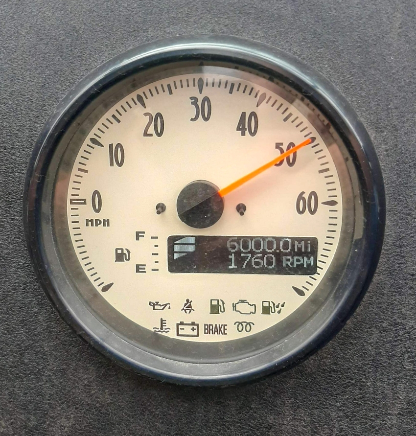

Hit 6k on the odo. 240 hours on the clock.
2,292
I’m just jealous that your gauge works
Lol, mine went out about a year ago, it seems there was a bad batch on some 18's and 19's, good side my dealer fixed it without any problems:)

Tokarev: 6K miles of pire fun, I hope!
Are there some pixels missing on the fuel gauge or is that some kind of shadow?

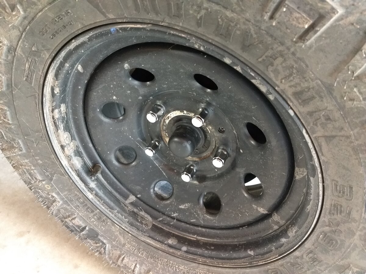

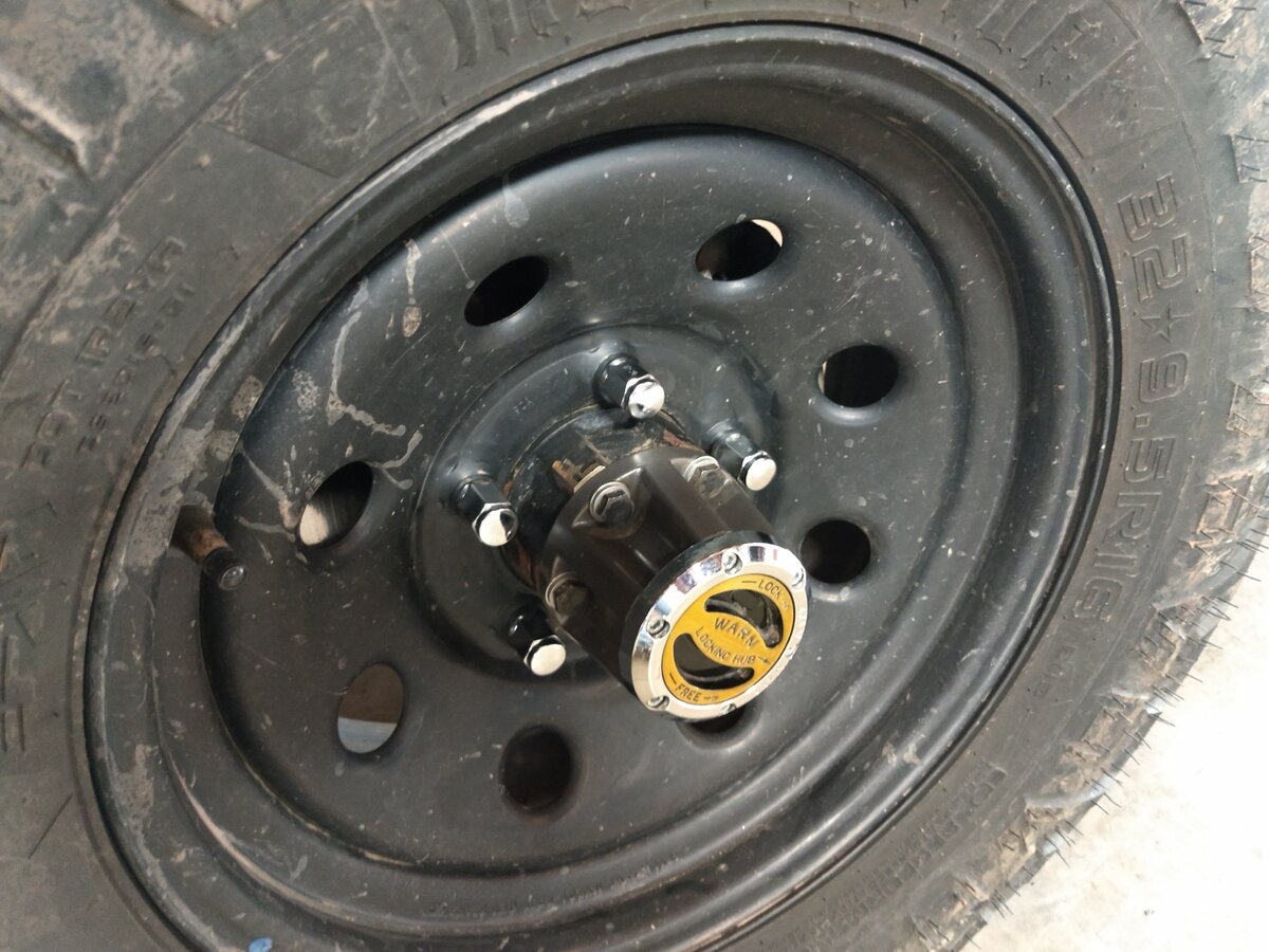

Subtle change, but I installed the polished acorn lug nuts I've had laying here for a week for it. Looks a little better, but mainly I like how the studs are fully protected now.
