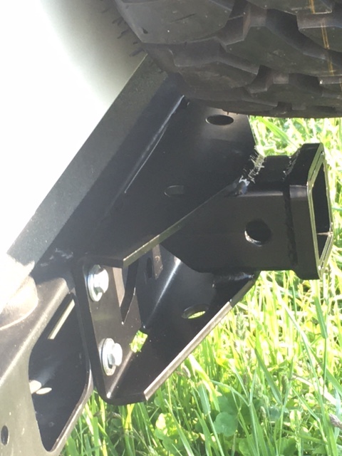

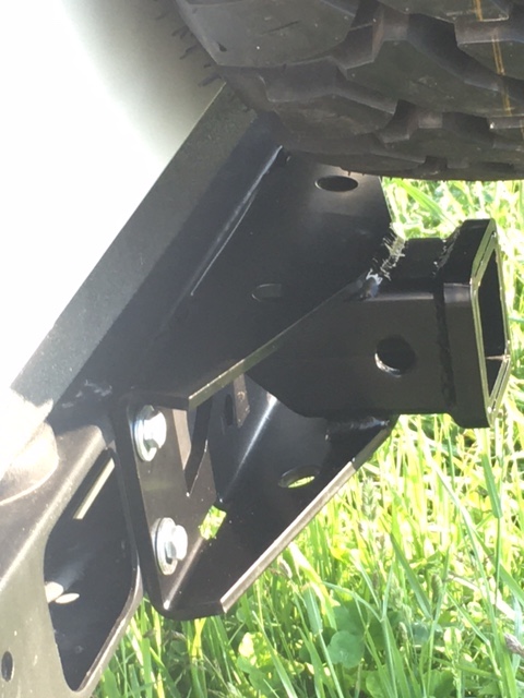

Over the Memorial Day weekend I bought a 2019 Roxor, driving 800 miles (!) to pick it up. First thing I did was to bolt on a Strong Made Universal Hitch. The Roxor will be a working vehicle and I need the hitch for a tray and to pull a surplus M416 1/4 ton trailer.

You're gonna rip that cross member apart using that hitch, and you will be denied warranty. Search the forum, it's happened to several. You need one that spreads the load out from end to end.

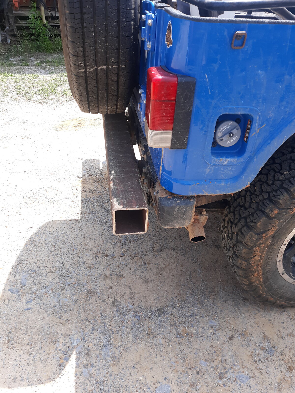

717
Like this. 1/4" wall. 4" box tubing. I used some old 5th wheel brackets I had lying around my shop. Got the idea off of here. Grade 8 bolts plus I welded my brackets to the frame. I still need to box in the ends. It should be there long after I'm gone....

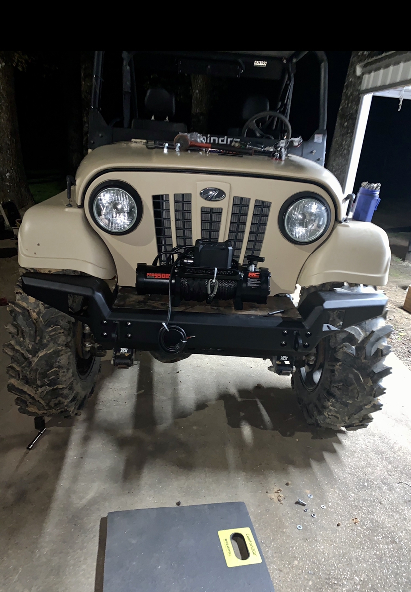

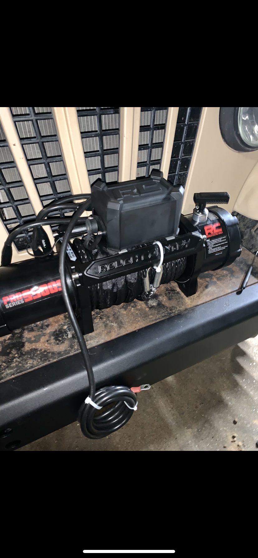

Got bumper an winch installed last night, still have a few modifications ( bracket for fair lead) but all in all starting to come together
