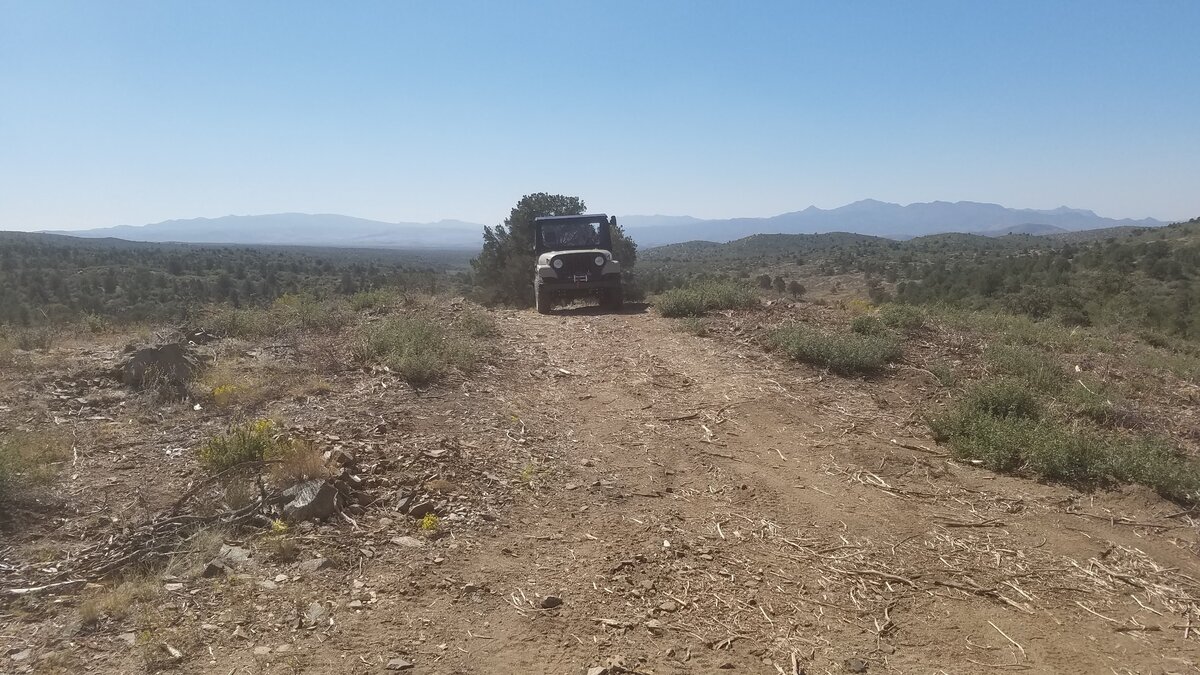

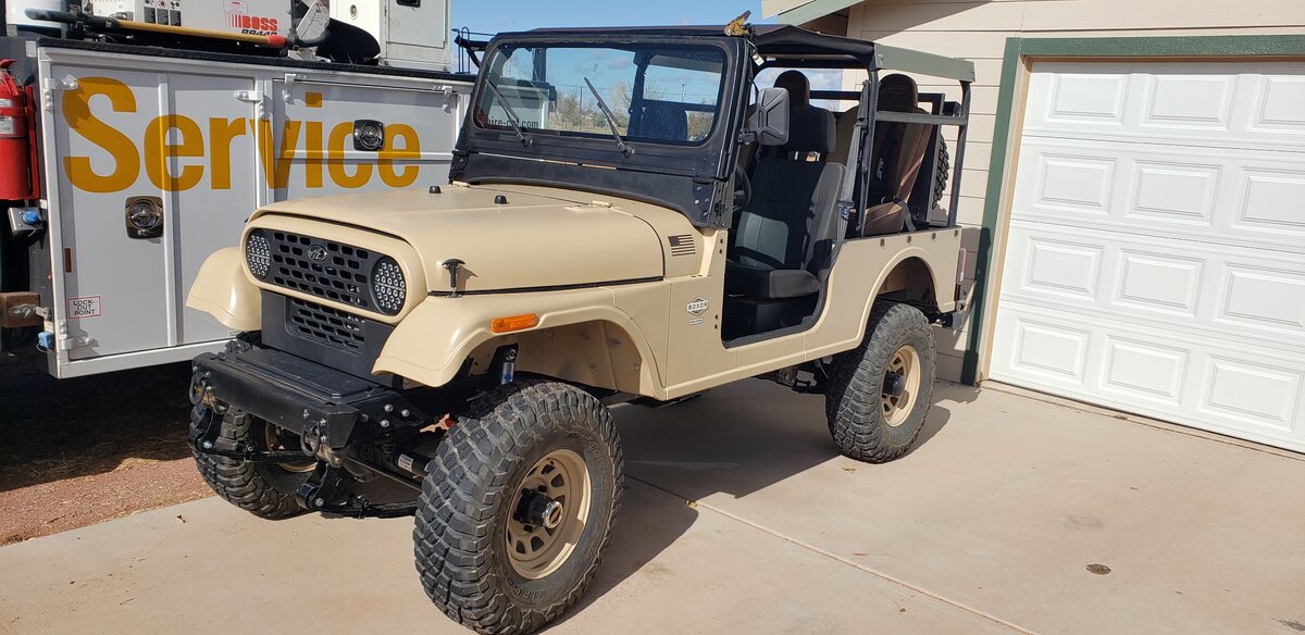

Took it out on the hills overlooking Kirkland Valley AZ.

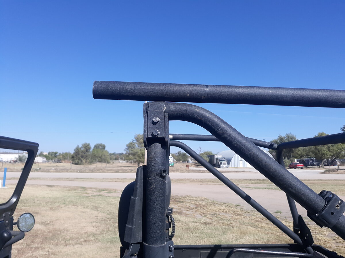

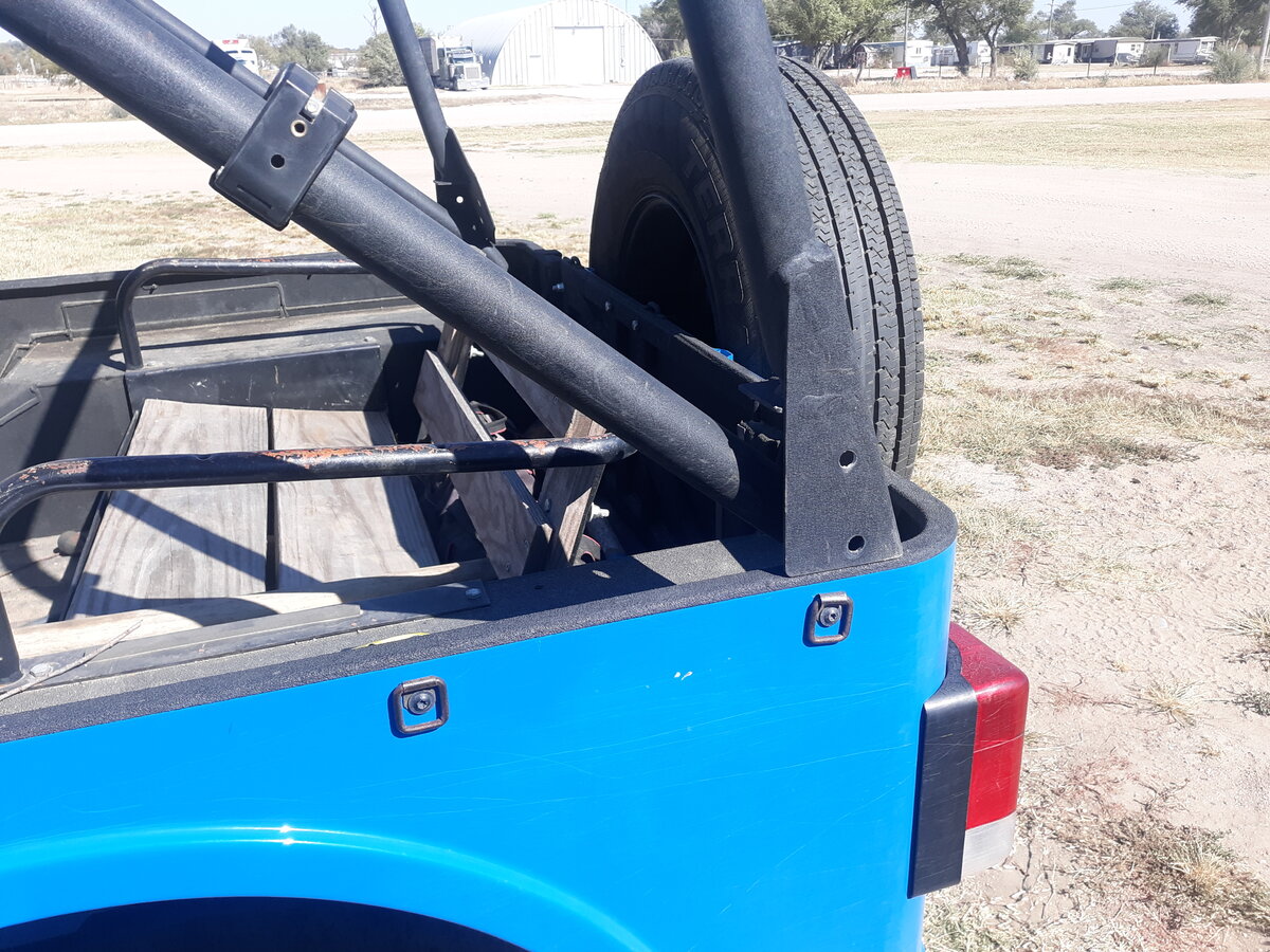

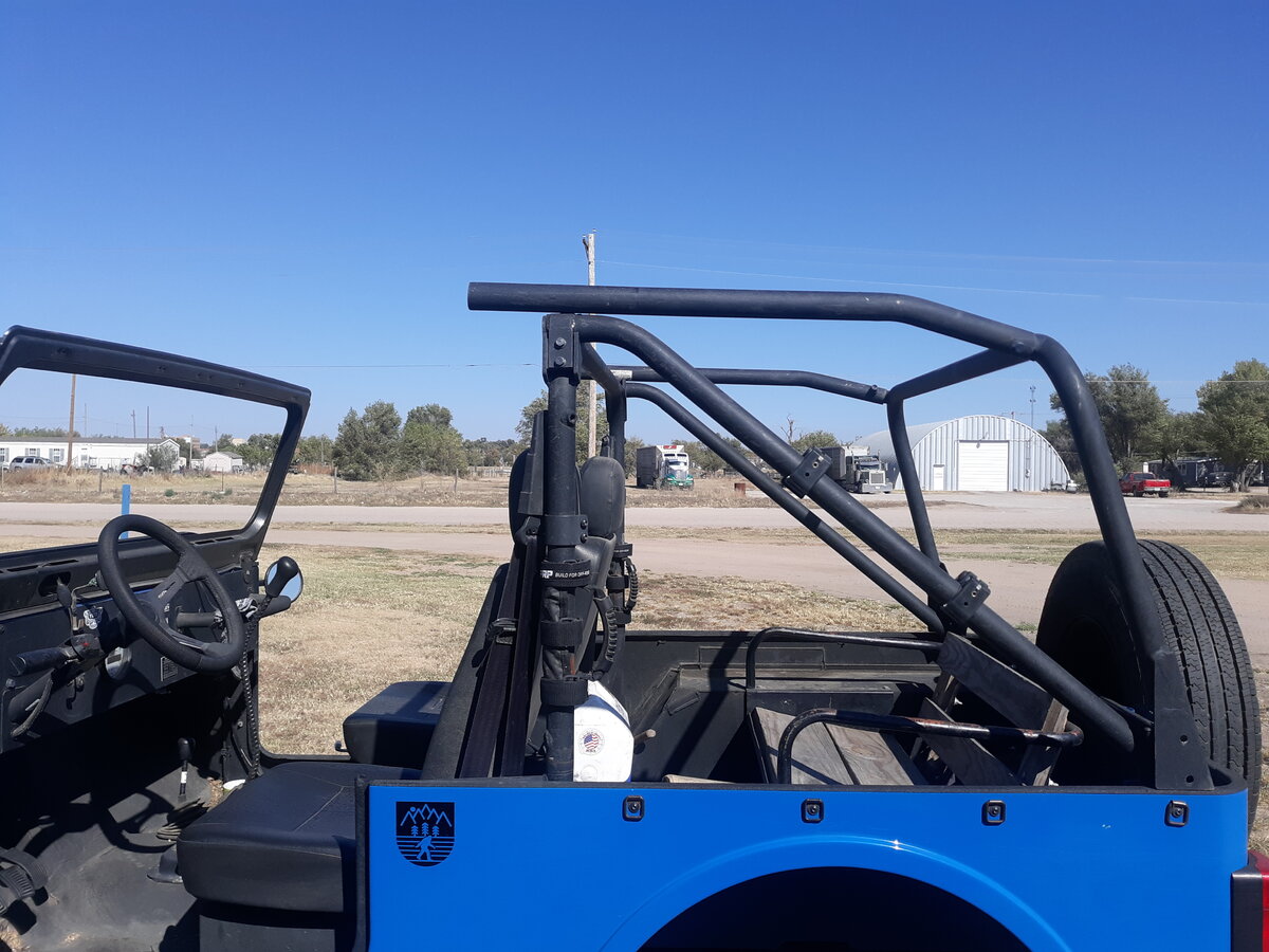

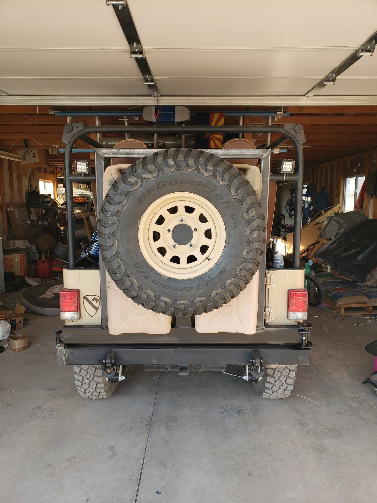

Almost finished my swing gate, and got it mounted. Then I cleaned my garage and behind my garage. Filled my 8x14 utility trailer all the way to the top of its 4' sides with clutter.
I have though about re-purposing my front hoop and runners. Minor trimming, notching and some welding. But I think it may work out once I get back home. I'd feel better about the extra roll over protection for the kids in the back.

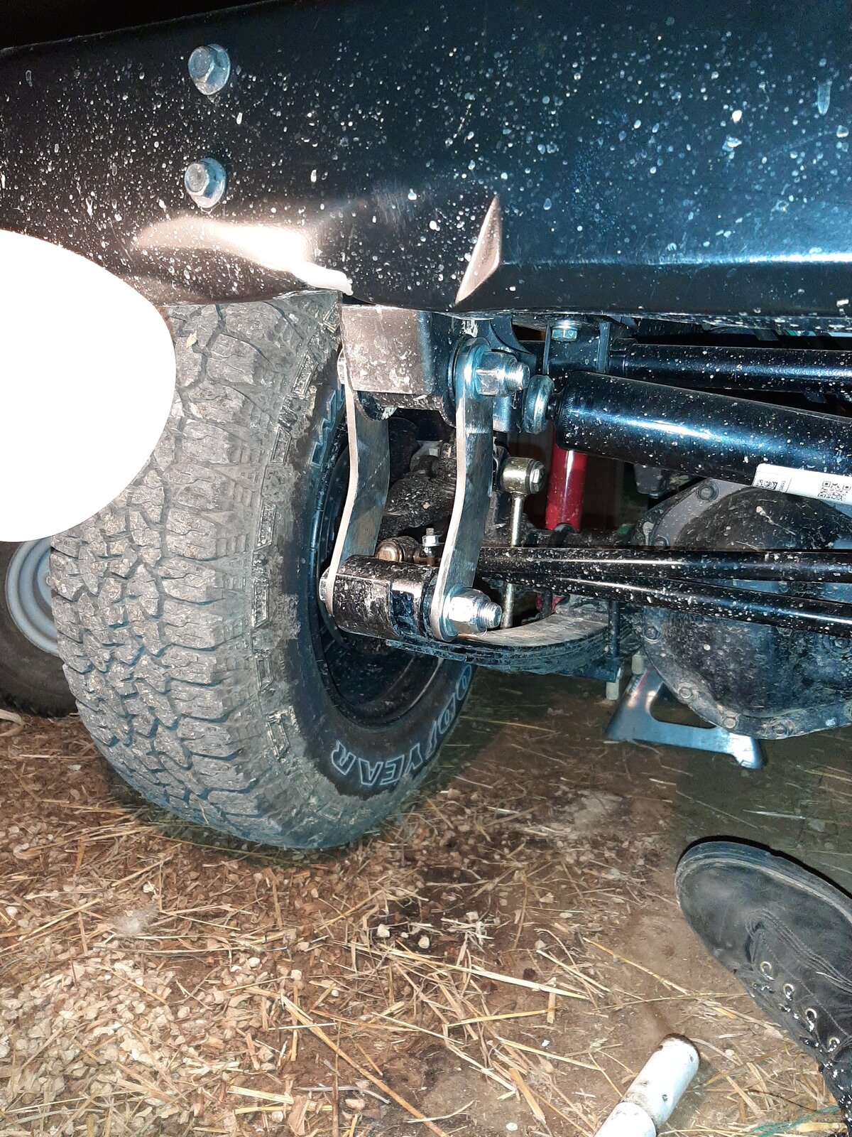

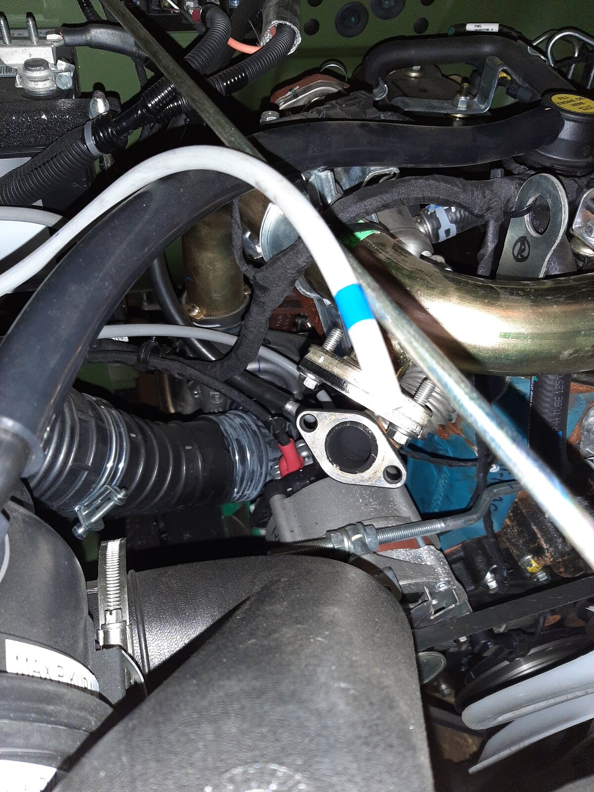

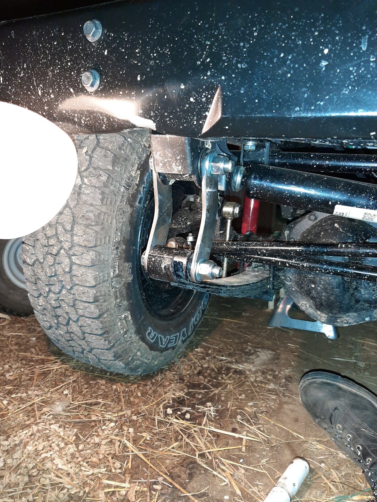

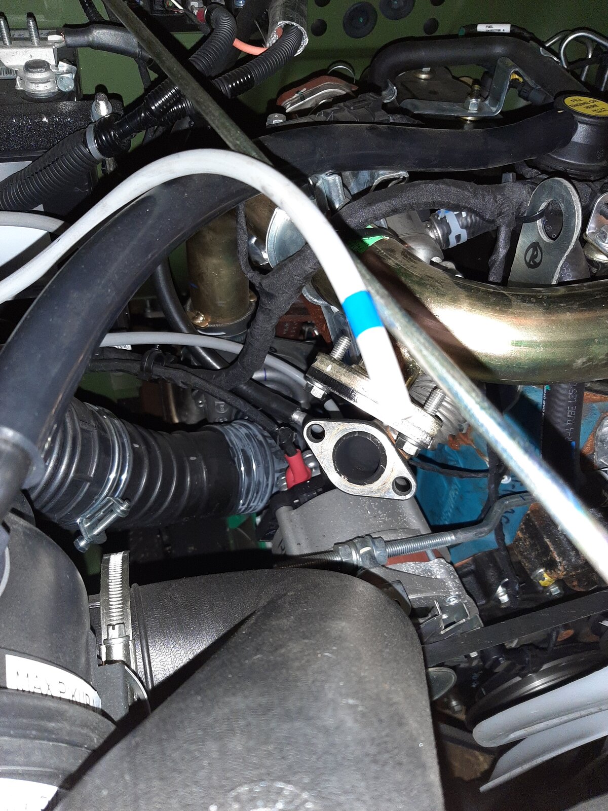

Tore up some trails, drove through a creek, went to dairy queen with my grandma, installed 1.5" lift shackles on the front (almost lost a finger because it's my first time playing with leaf springs) installed egr plates but left the cooler and coolant lines as is; tossed the valve and said hello to the Ford light, deleted the particulate filter/catalyst, got stuck on a rock, took the dog to get some attention from some women at the gas station, drove through the creek again, hit a tree...
Typical Sunday stuff

Shackles look good. I’d definitely suggest throwing on some paint. Black or green would look good.
Well I just learned I can get things powder coated for free...

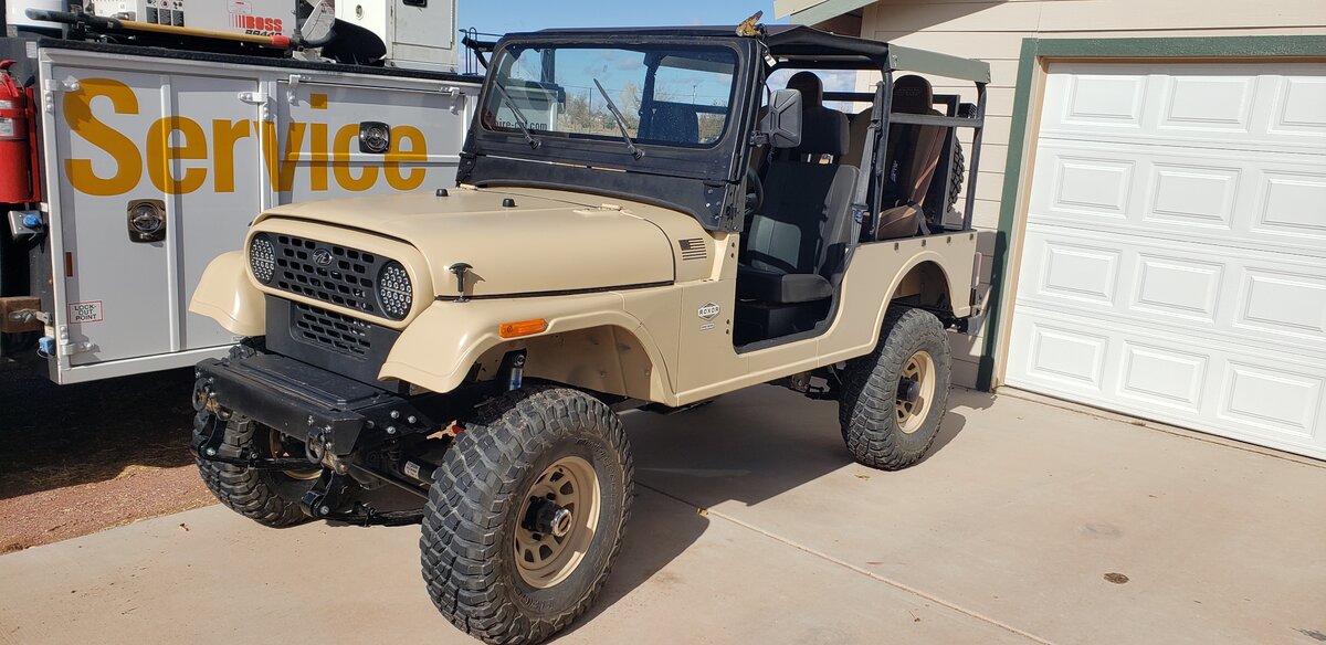

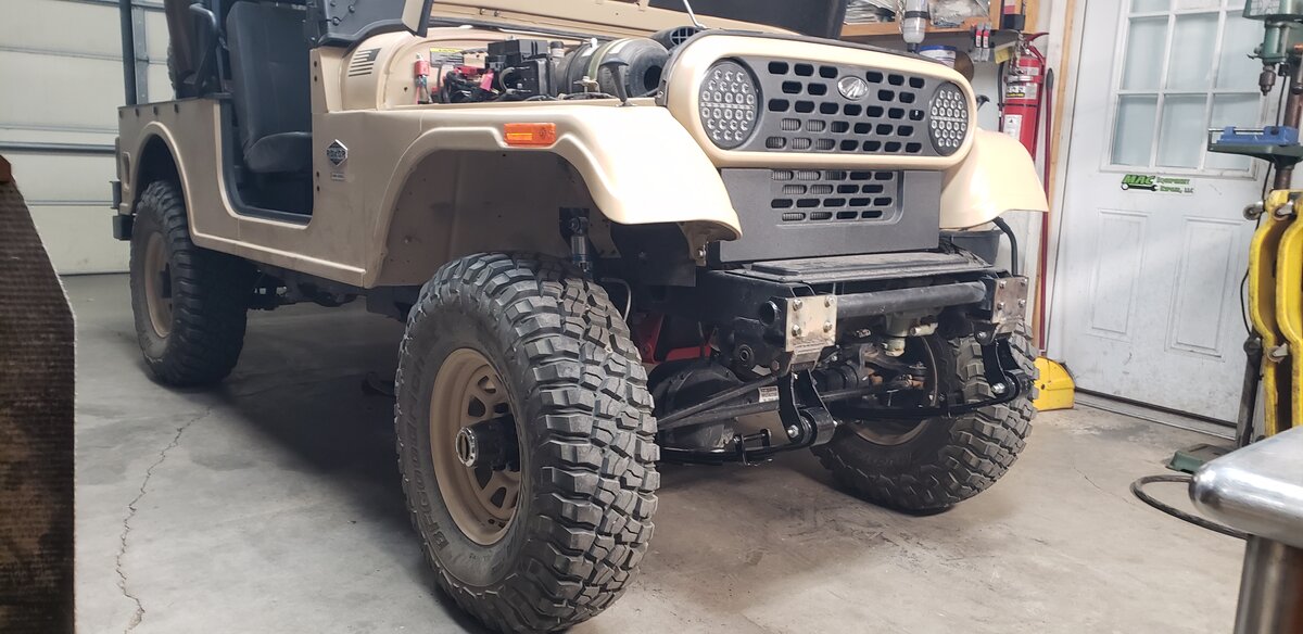

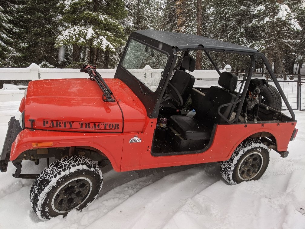

Welded up and installed Max's Max Travel suspension. Taking a break while my buddy welds the DOM sleeves in the frame holes I just drilled. After it's done, I'm gonna drive home in the freezing rain with no wipers
Drove home in the freezing rain with no wipers or heat. It was cold. Steering wheel is way off now. The top of the wheel is sitting at 3 o'clock now.

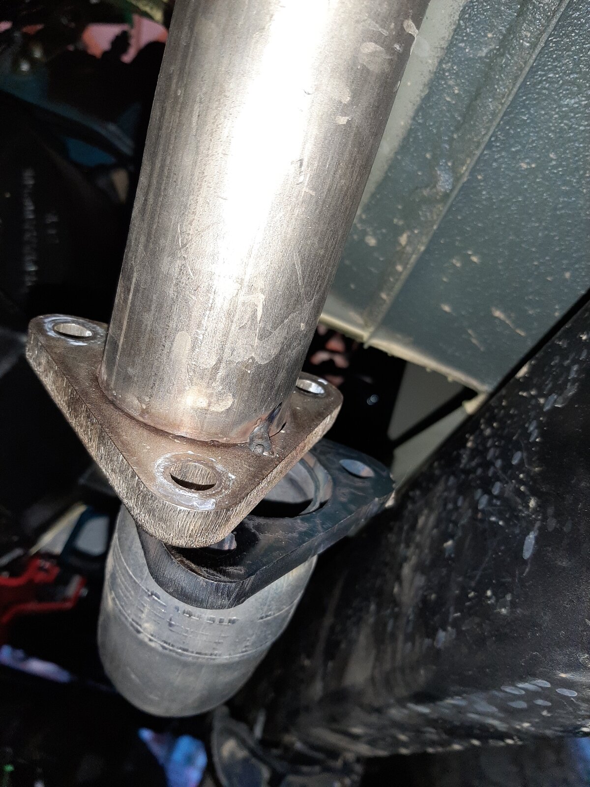

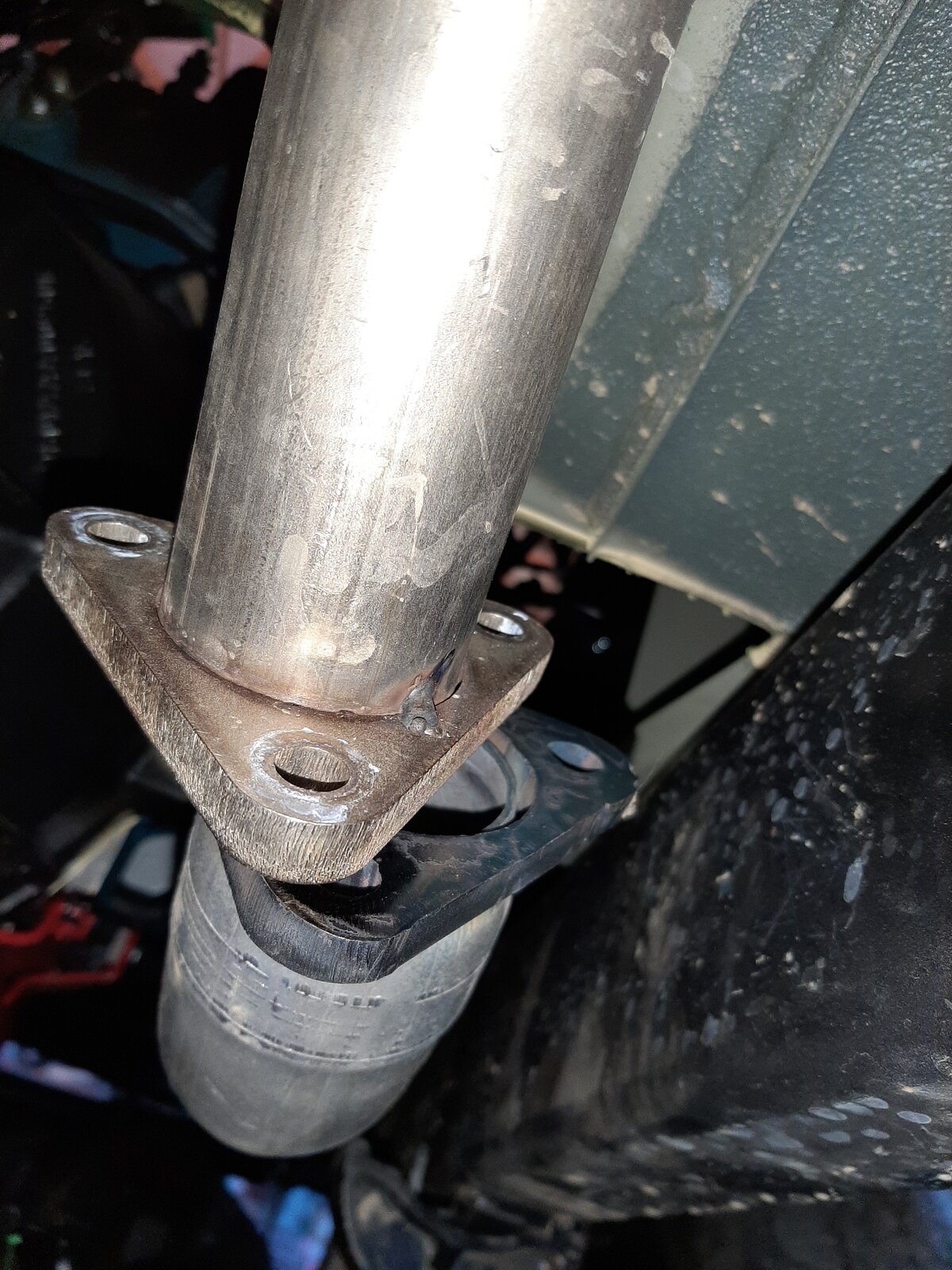

Why did you take the exhaust apart?
With any lift you will need to spin your drag link out a few turns to correct the wheel.
Looks great! Thanks for purchasing the very first kit! All 5 from the first batch have sold. I will be making more.
Eager to hear how much you love the new set up. It’s a huge change in ride quality.
