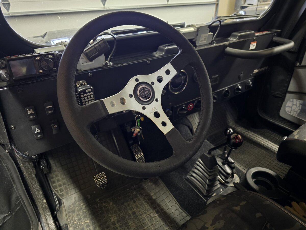

Upgraded the pedals and went to 15" steering wheel. This one is a flatter profile than stock. pushing the wheel away from you. Grant lists the steering wheel as a 3" dish 5 bolt. But it's not, its a 5 bolt, 1 inch offset wheel and comes with a spacer that is 3 bolt mount (useless for Roxor). I just used the wheel itself on the factory Grant mount, it worked great for me. Just note that Grant decided not to make offset (dished) wheels anymore, they just use spacers on 15" wheels from what I've found. Anyway, I'm happy with the outcome!

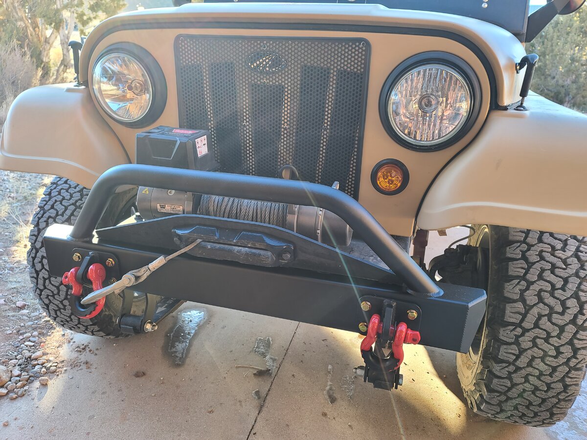

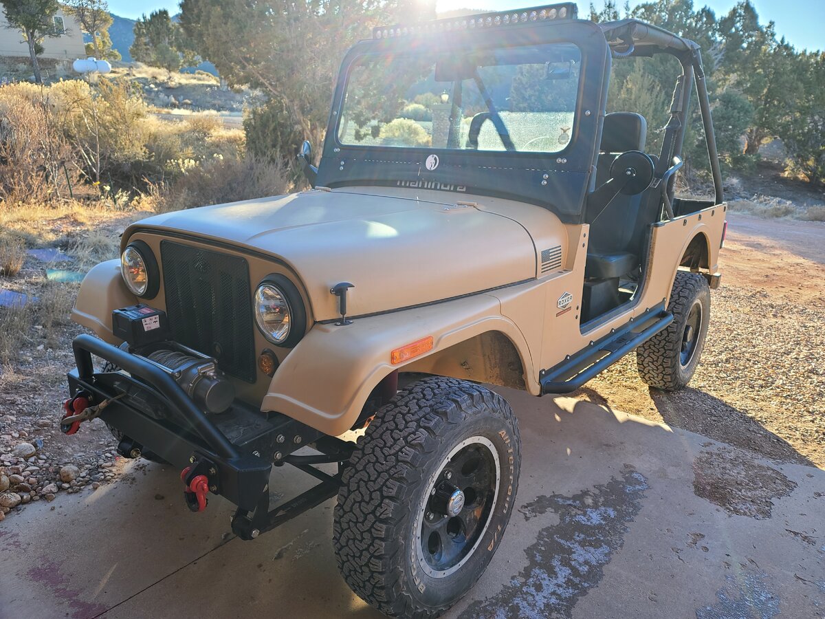

Mounted a bracket for my ham radio antenna on the rear of the tub. Now when I get a warm enough day to pull the dash off, hook up my gauges, etc., I'll mount a 2m/440 radio under the dash. I also ordered the HighFlo 2-1/4" right-side exit exhaust system. So, maybe next weekend I'll get the downpipe and exhaust installed and while the factory downpipe/cat is out, I'll install the oil pressure sending unit in the block. Slowly but surely...

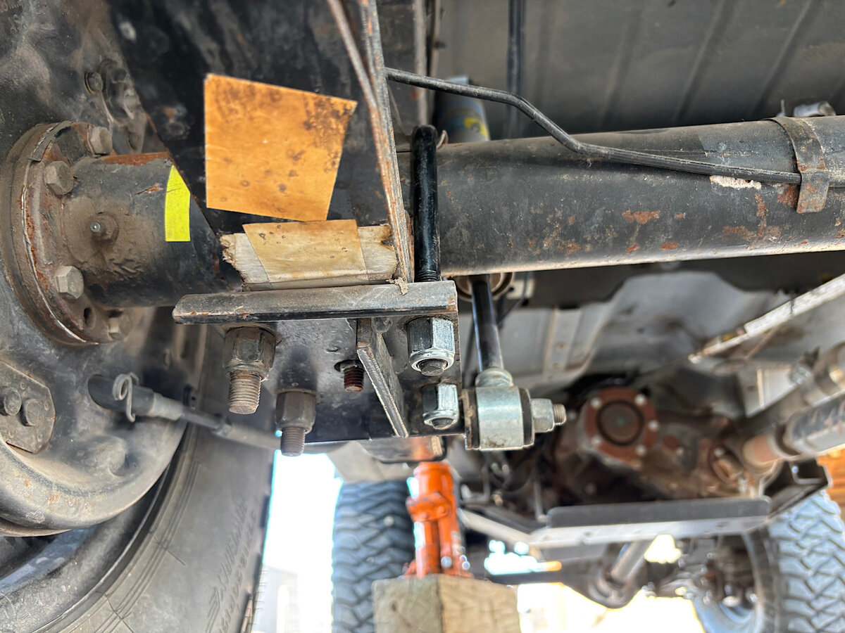

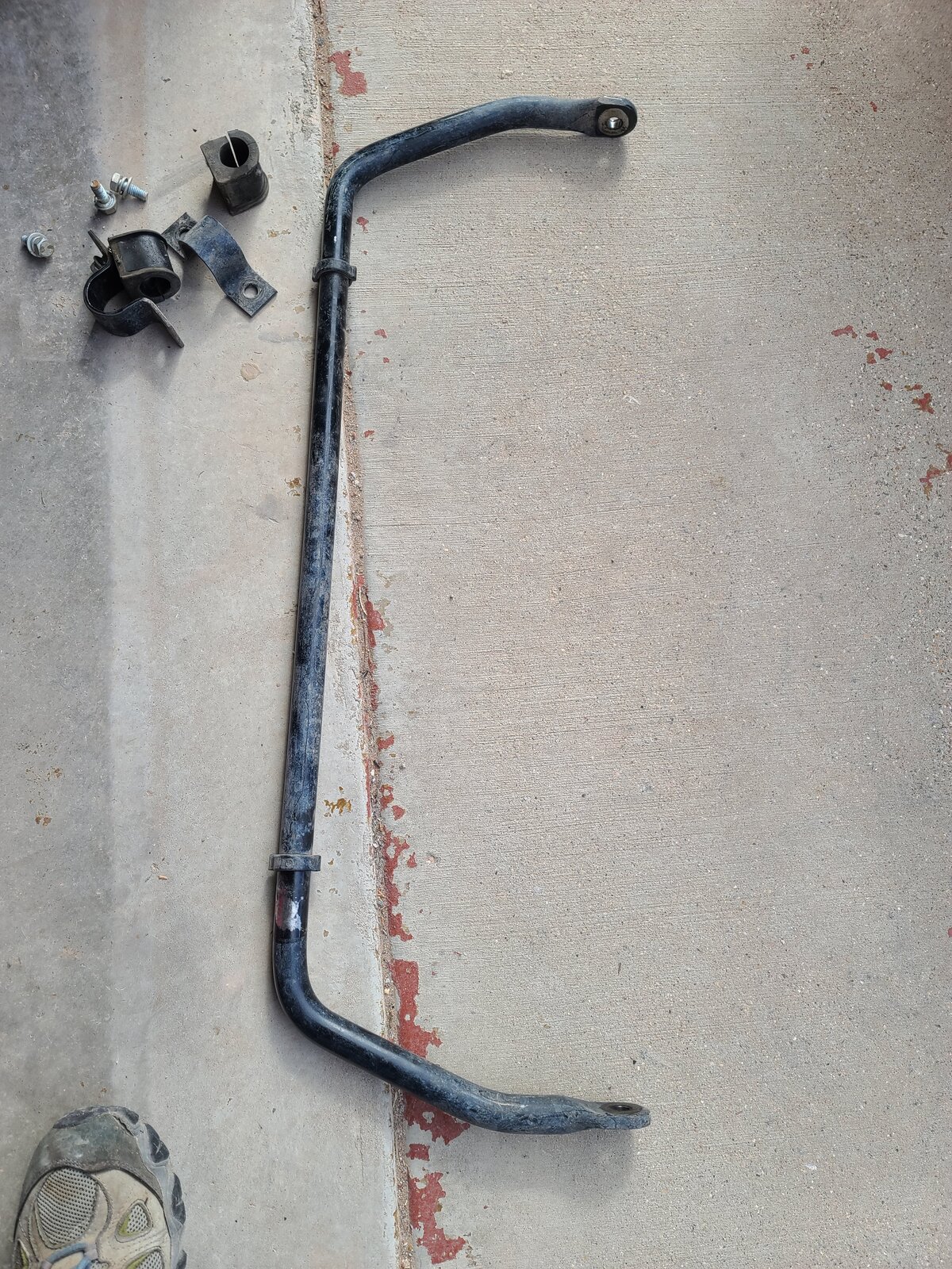

Front sway bar is off. One of the link bolts was MIA anyway. I guess my Rox was telling me it didn't want the sway bar on any more...
