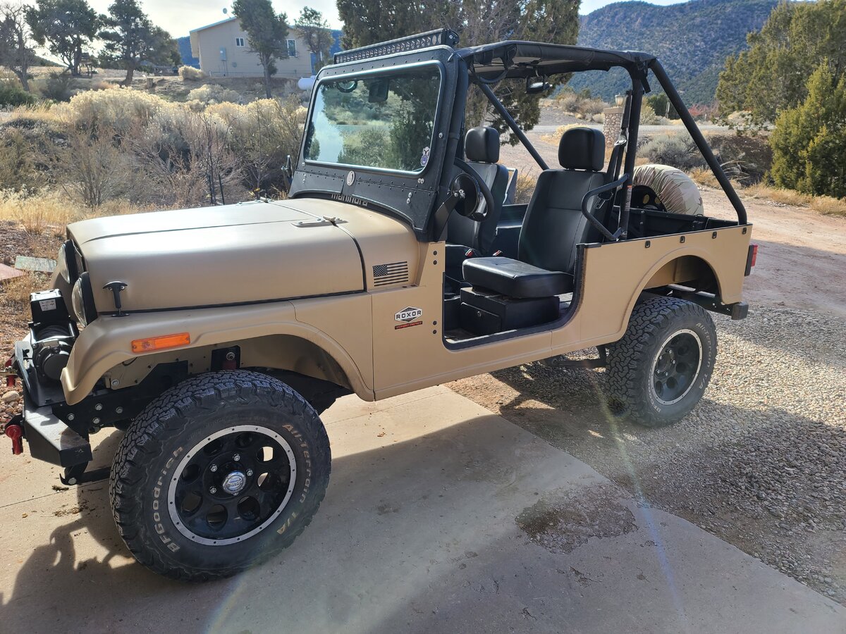

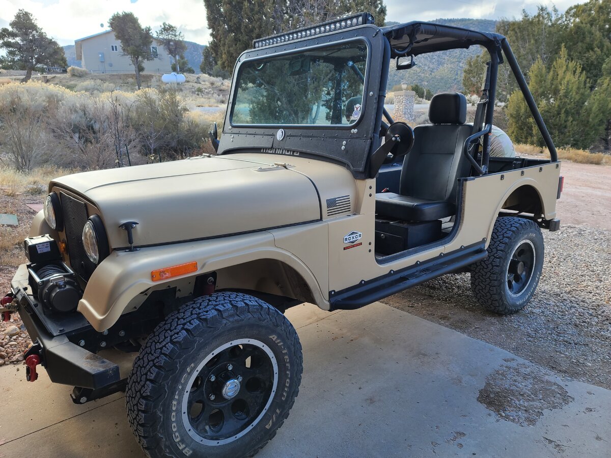

Pulled the wheels off and ran into town and had the tire shop switch the factory BFG ATs around to have the white-letters facing out. LACES OUT!

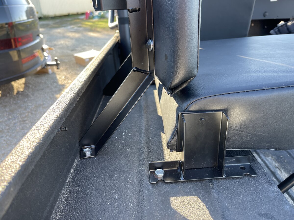

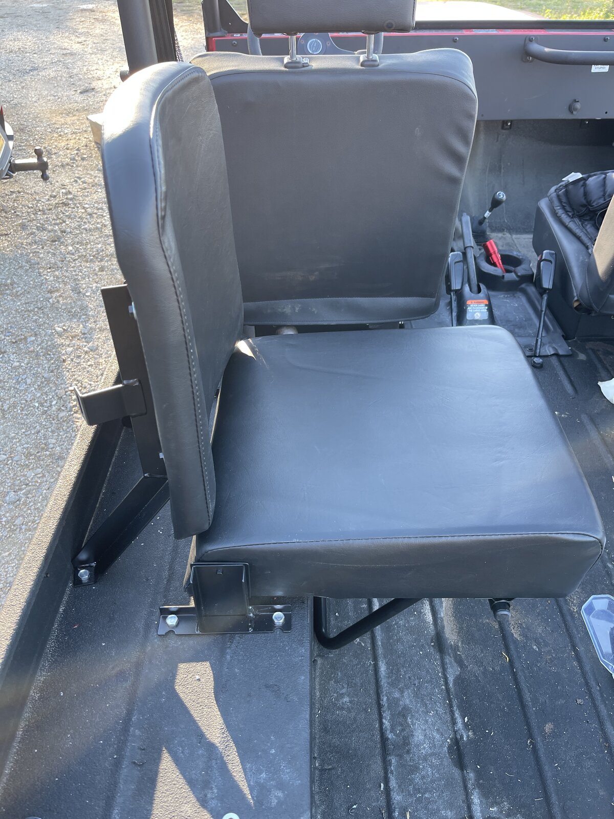

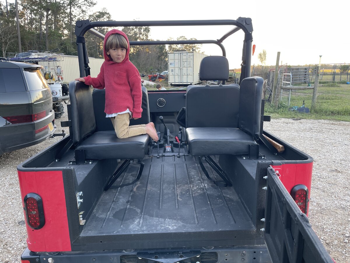

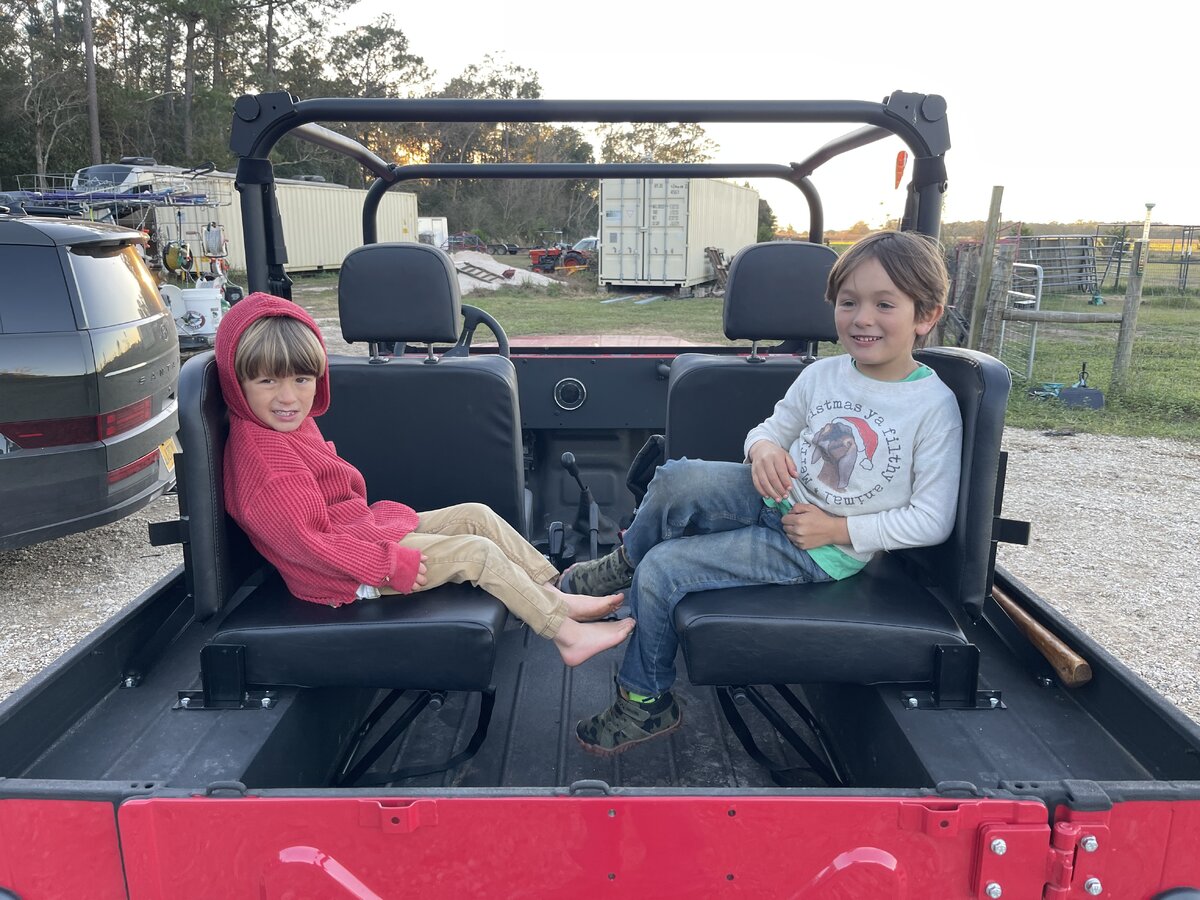

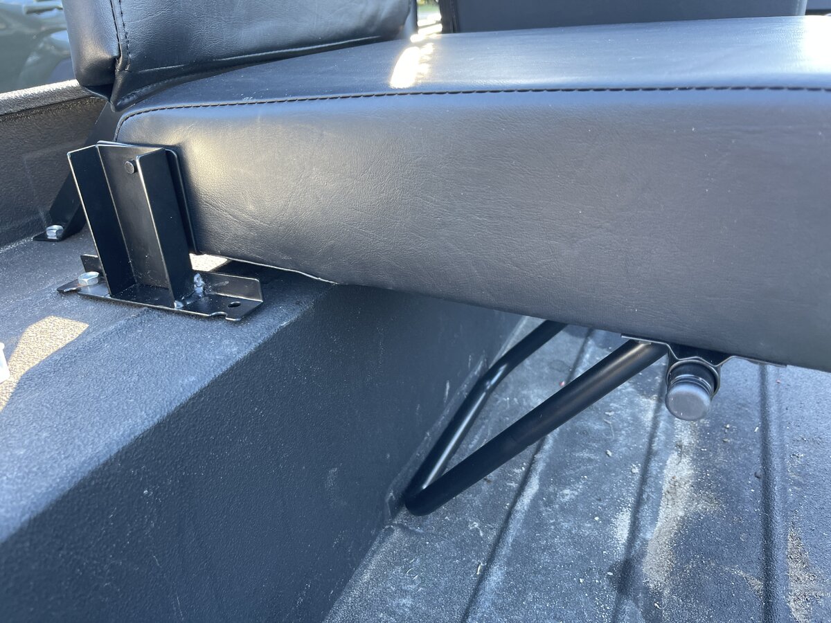

After reading other posts about inward facing bench seats on the wheel wells, I went with the defender single seats.
Pretty straight forward, need to get the 4 person extended rops so I can support the seat backs better, but my 6yo and 3yo love their new seats, and momma is happy they aren’t going to tumble backwards over the side.
Just a farm Rox, so hoping they hold up well.

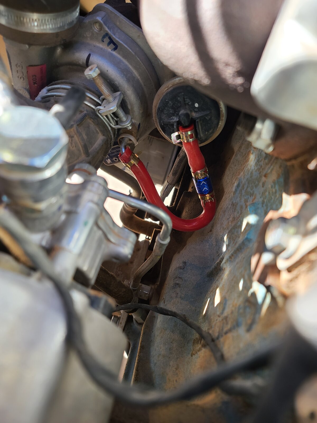

Put a Grit Shift wastegate boost valve in. Had it for a while and had a nice enough day to knock it out. I admit, I was a little paranoid about doing it after reading some guys had broken the wastegate nipple off doing it, but I cut the hose lengthwise on the nipple with a razor and it came off easy.

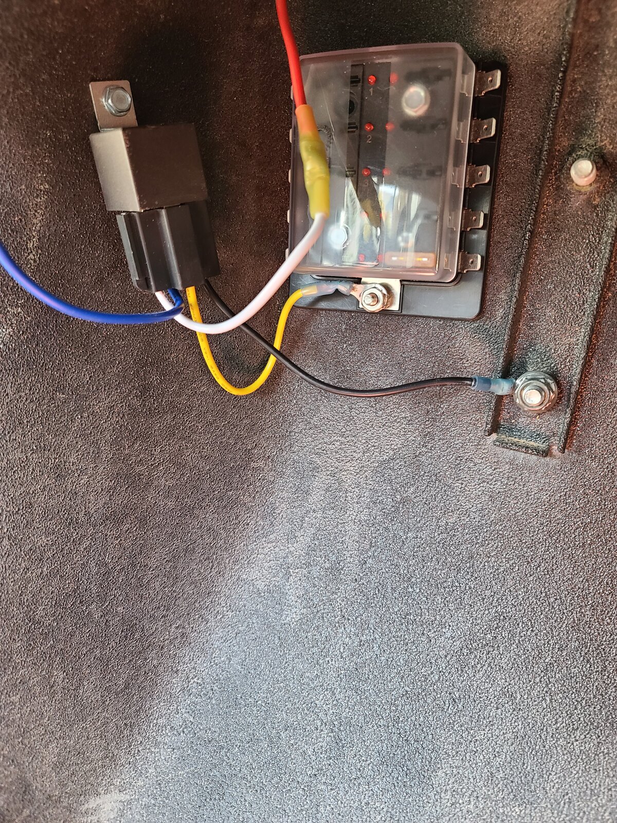

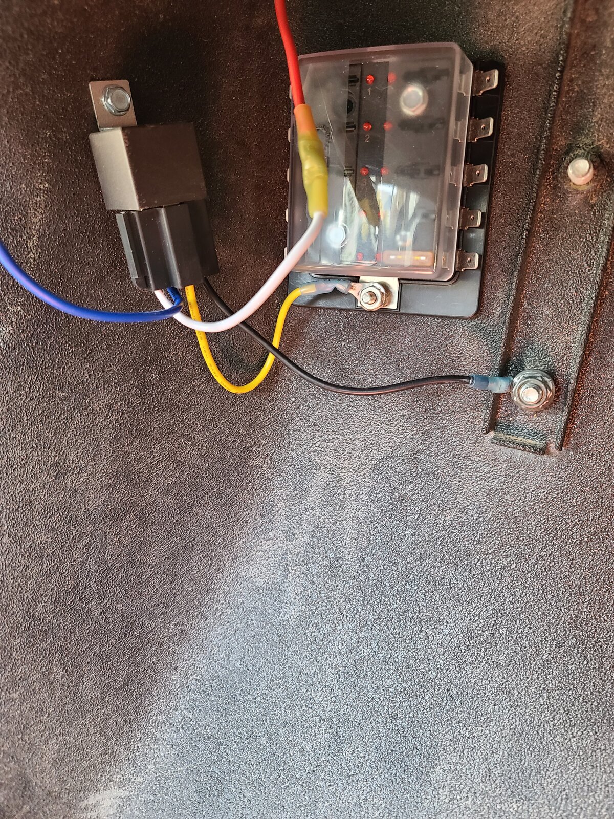

Wired up an aux fuse box up under the dash. Don't mind the loose wires. They are going to get zip tied up shortly. Good news is it works and I didn't burn down the Roxor!

Just remember that your limit will be your power and ground wires supplying the Aux panel and not the individual circuits. I bet that set up is less than half the cost of a Roxpower center.

Thanks and yeah, that is the key. I don't need wires melting. I ran 16 ga and all I plan on running off it is the lights for a few gauges I plan on installing and a 2m ham radio that draws 4 amps on high power. So I *should* be good. Probably a max of 20 amps coming off that aux when all is said and done.
EDIT: Actually more like 7 amps. Autometer says a set of 6 gauges pulls approx 3 amps.
