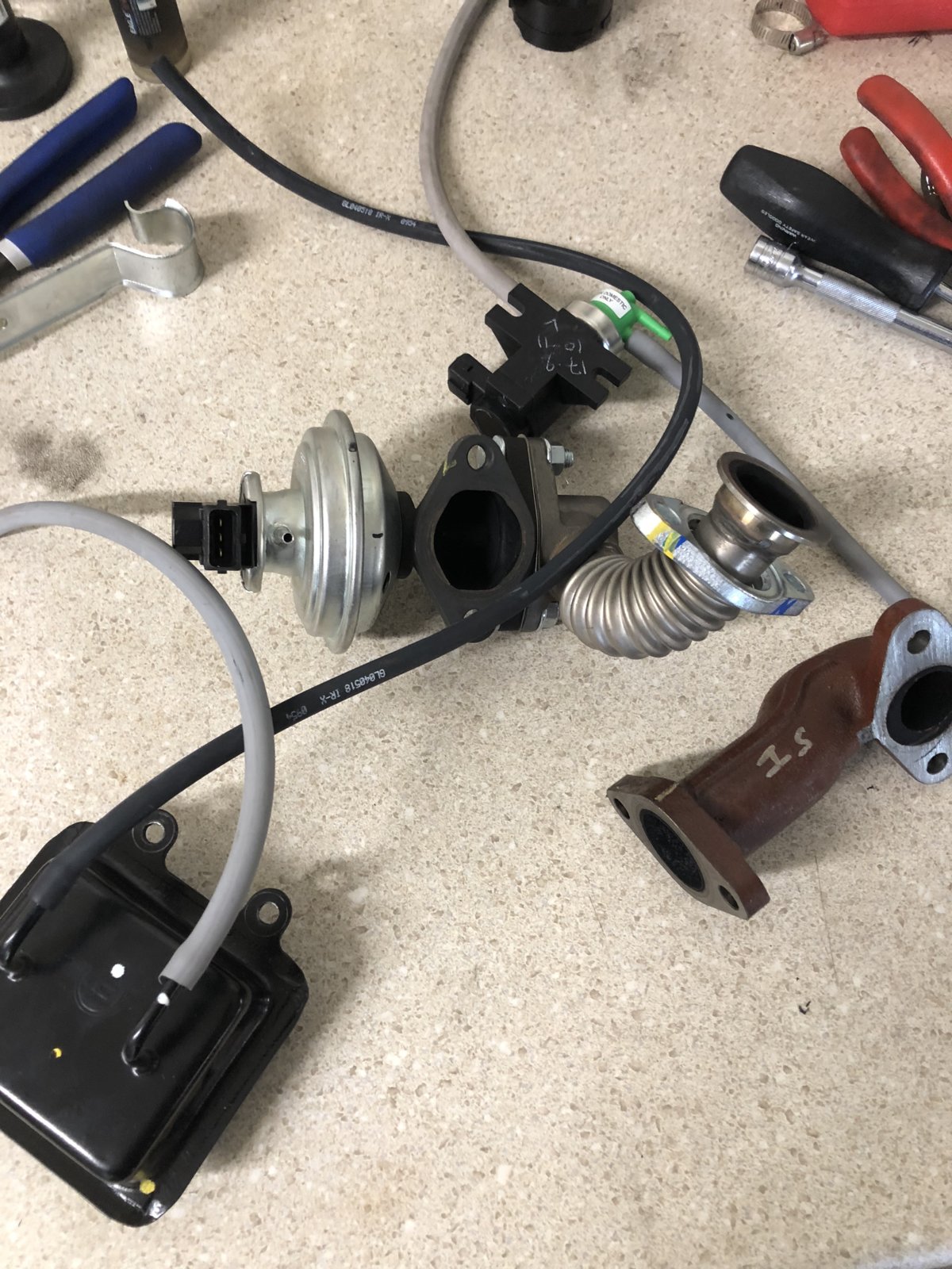

EGR delete done!

WOW! Thats alot of crap! Thanks for sharing, where can i get the EGR delete plates?
Diesel freak is supposed to be offering a kit at some point. I made my own.

I didn’t have any interest in putting a kit together if someone was going to offer one soon but I can if there is enough interest. What would y’all feel would be a fair price for a complete kit including plates, coolant caps, hose clamps and vacuum caps along with detailed instructions?

Everything is moving along, I could possibly start shipping by the end of next week. Just trying to get final pricing nailed down. The original ones I had made were out of carbon steel. The new ones I had quoted where out of stainless and that was a significant jump in price.

I’ll have 50 kits ready to ship by the end of next week. Kit will include stainless block off plates and everything needed to completely remove the egr valve and cooler along with all of the vacuum hoses that operate the valve. All parts I’m using are made in the USA! I’ll also include a hose for draining the coolant that won’t spill a drop. Without it, it makes a huge mess. Price will be $120 and will include shipping to lower 48.

Main reason is it’s cheap insurance because if a cooler fails it puts coolant in the cylinders. Plus removing all of it including the vacuum stuff that is no longer used cleans up the engine bay a lot and gets rid of excess heat when the outside temp heats up. See pics below. Total time to install start to finish should be less than an hour.
