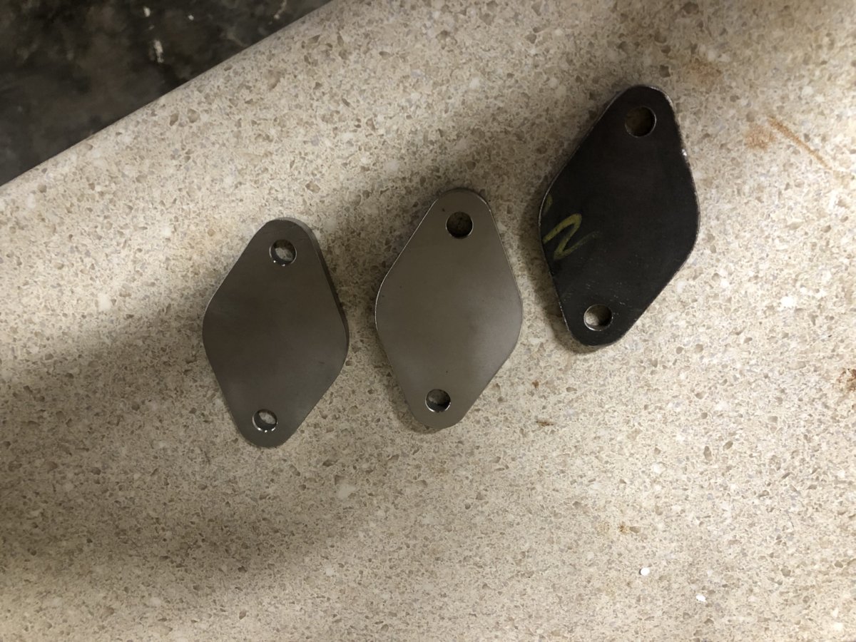

Stainless plates are in! Waiting on a couple more shipments to complete the kits. They should be here Thursday. I plan on putting everything together and packaging Friday through the weekend so I will be ready to send out Monday at the latest for everyone who wants one so far. I’ll get a paypal link up in the meantime (if I can figure out how, my wife says she has one and would be more than happy to keep the money. Damn the bad luck!) and get shipping info from everyone. Here is a picture of the stainless plates next a carbon steel plate I had cut originally. Definitely should stay looking good for a long time to come.
