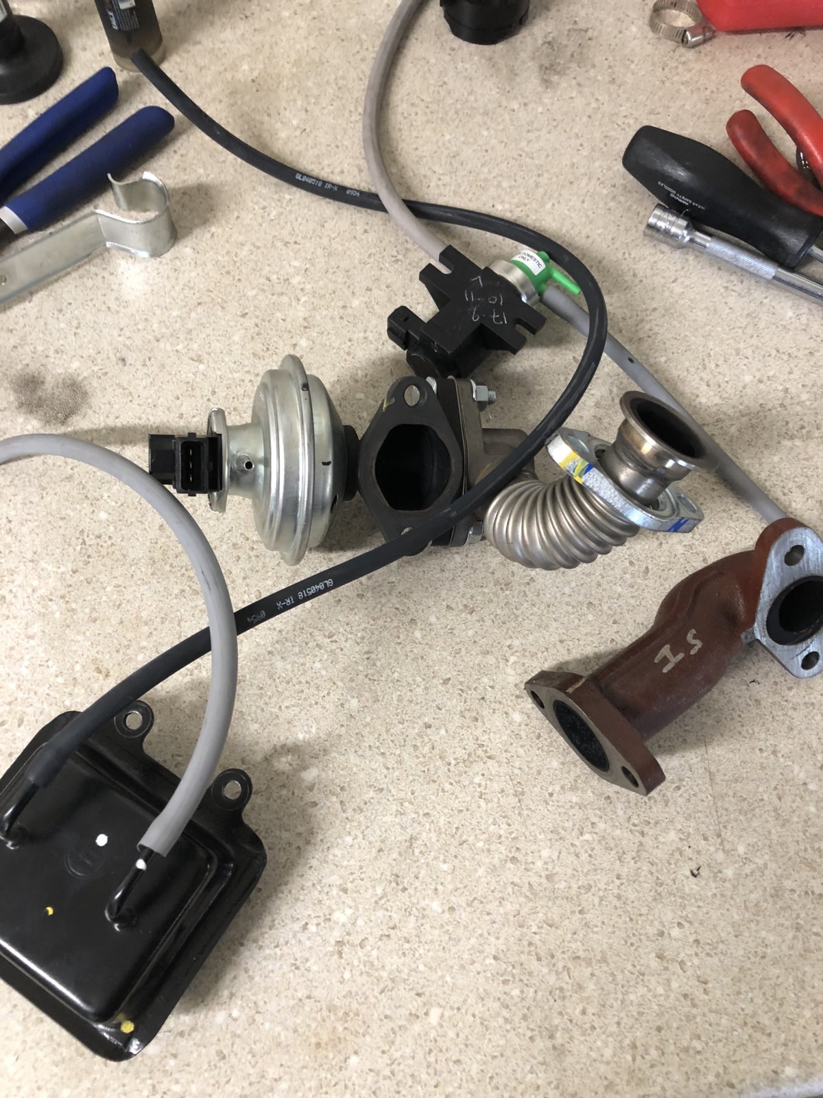

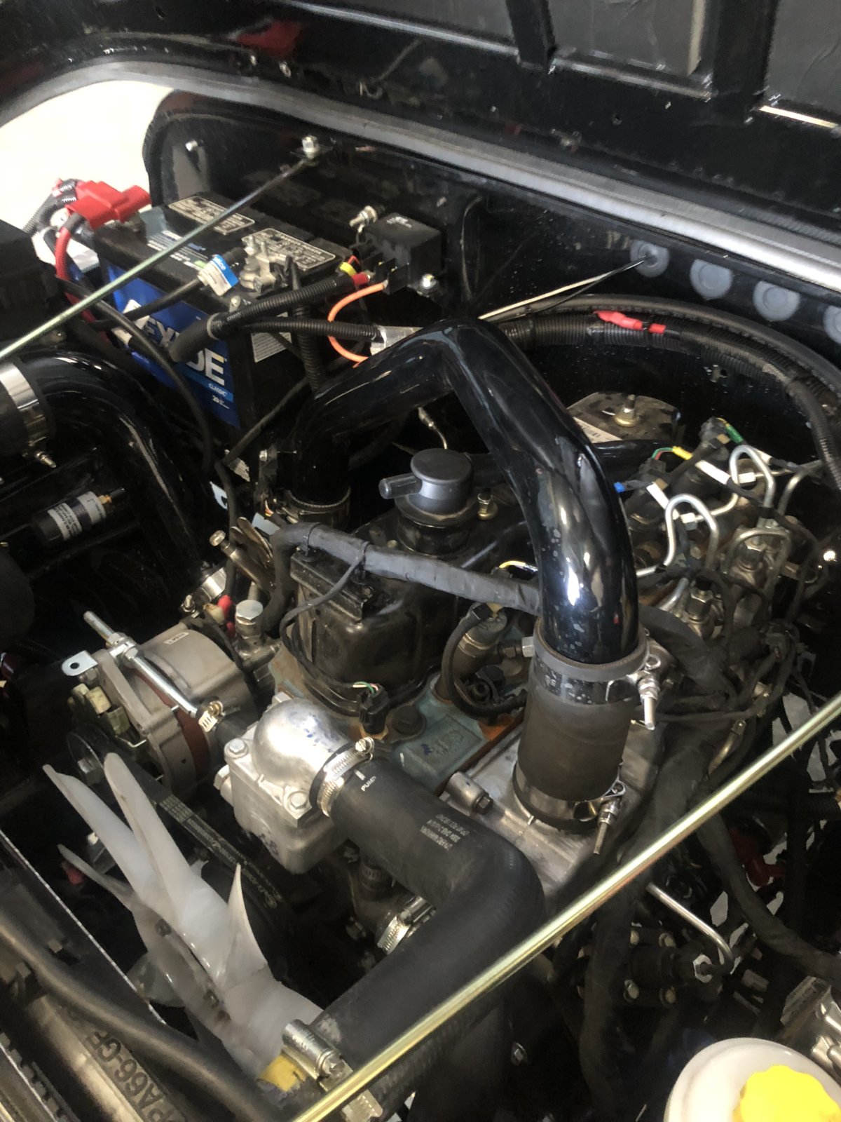

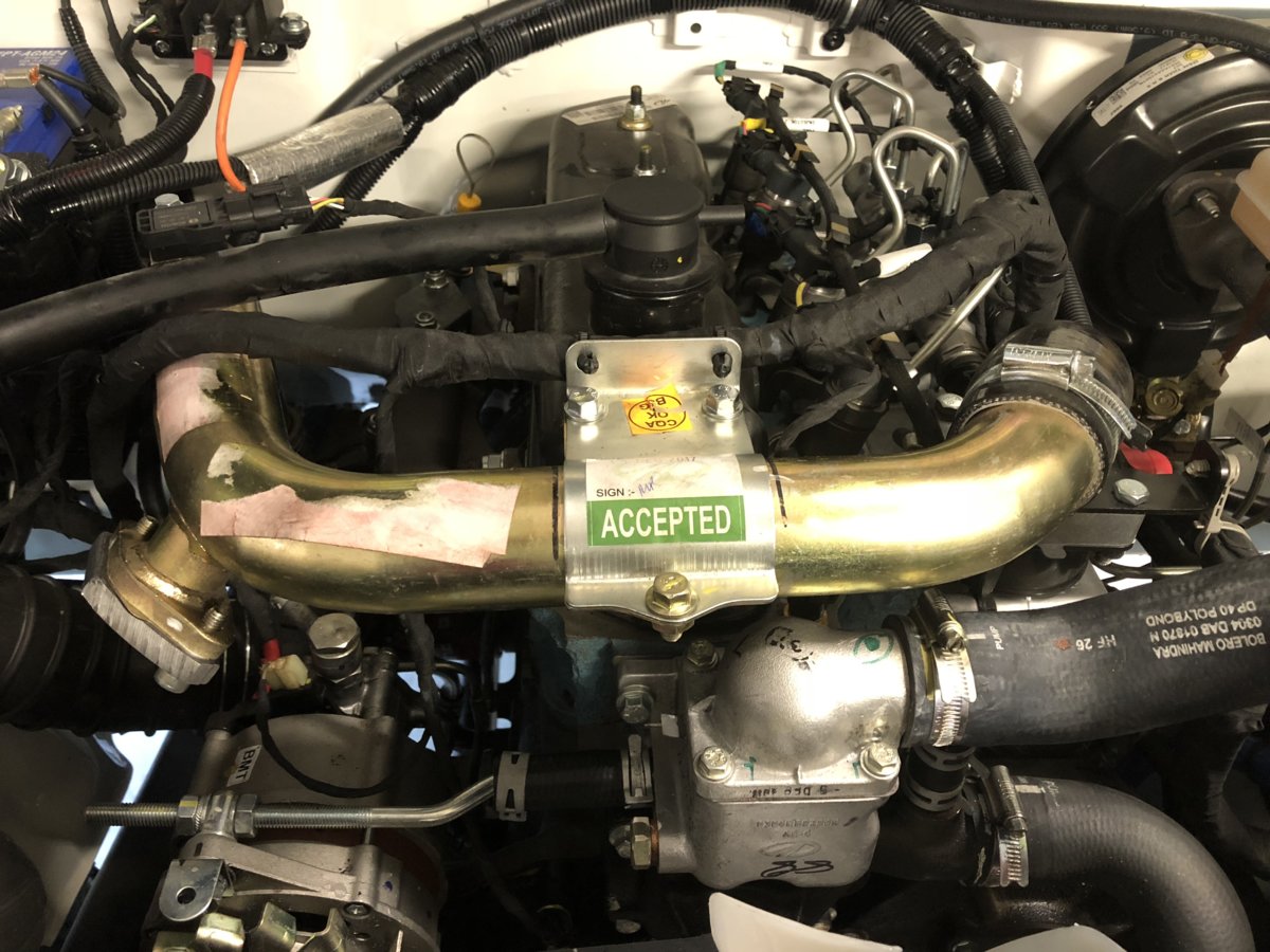

I’m just going to leave this here.
View attachment 868View attachment 869
We did ours back in May and love it.
2EF5A34E-273F-441C-BBEB-19234C0B23D4.jpeg AAFA4358-769B-4BFC-9018-98FAF51C8E3F.jpeg 45CB0F93-4B8E-4307-9538-B0B7FC97D534.jpeg

Looks great, when will you have the piping for sale?

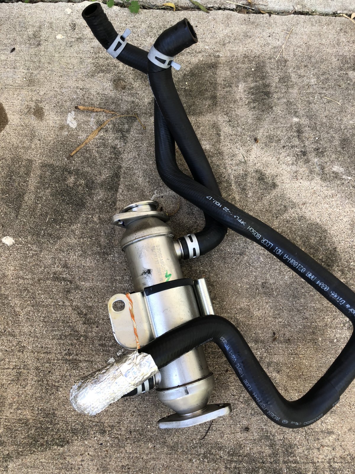

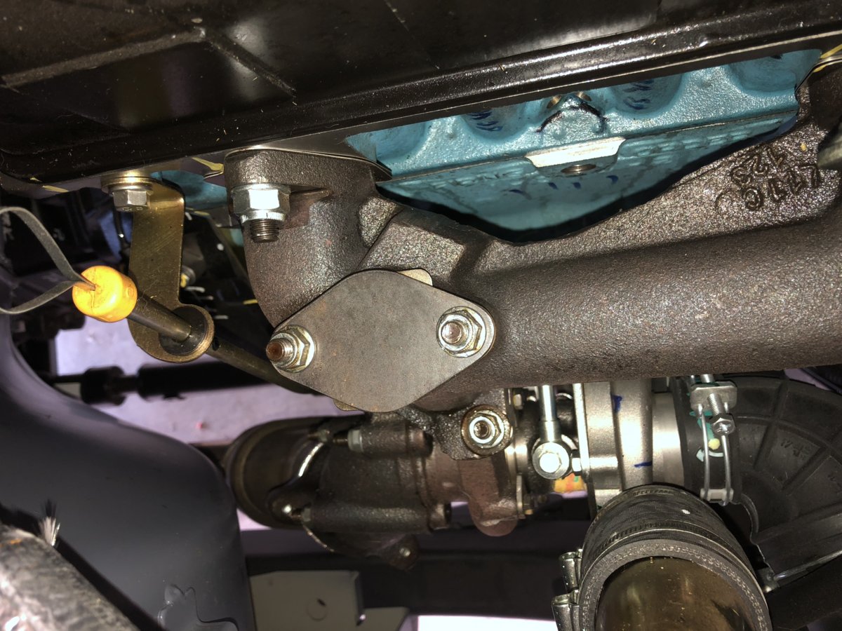

I plugged the coolant line on both sides of the water pump because the egr cooler was the only thing it fed. A bypass would just rob coolant flow from the engine because it would be a 6” loop that isn’t feeding anything else.
What size hose could you tap a heatercore into it?
ill double check but I think it’s 5/8 hose.

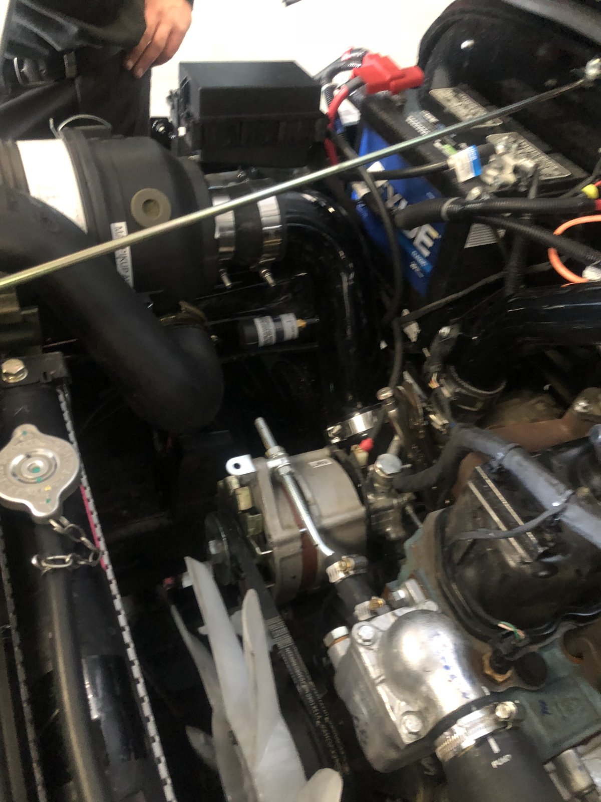

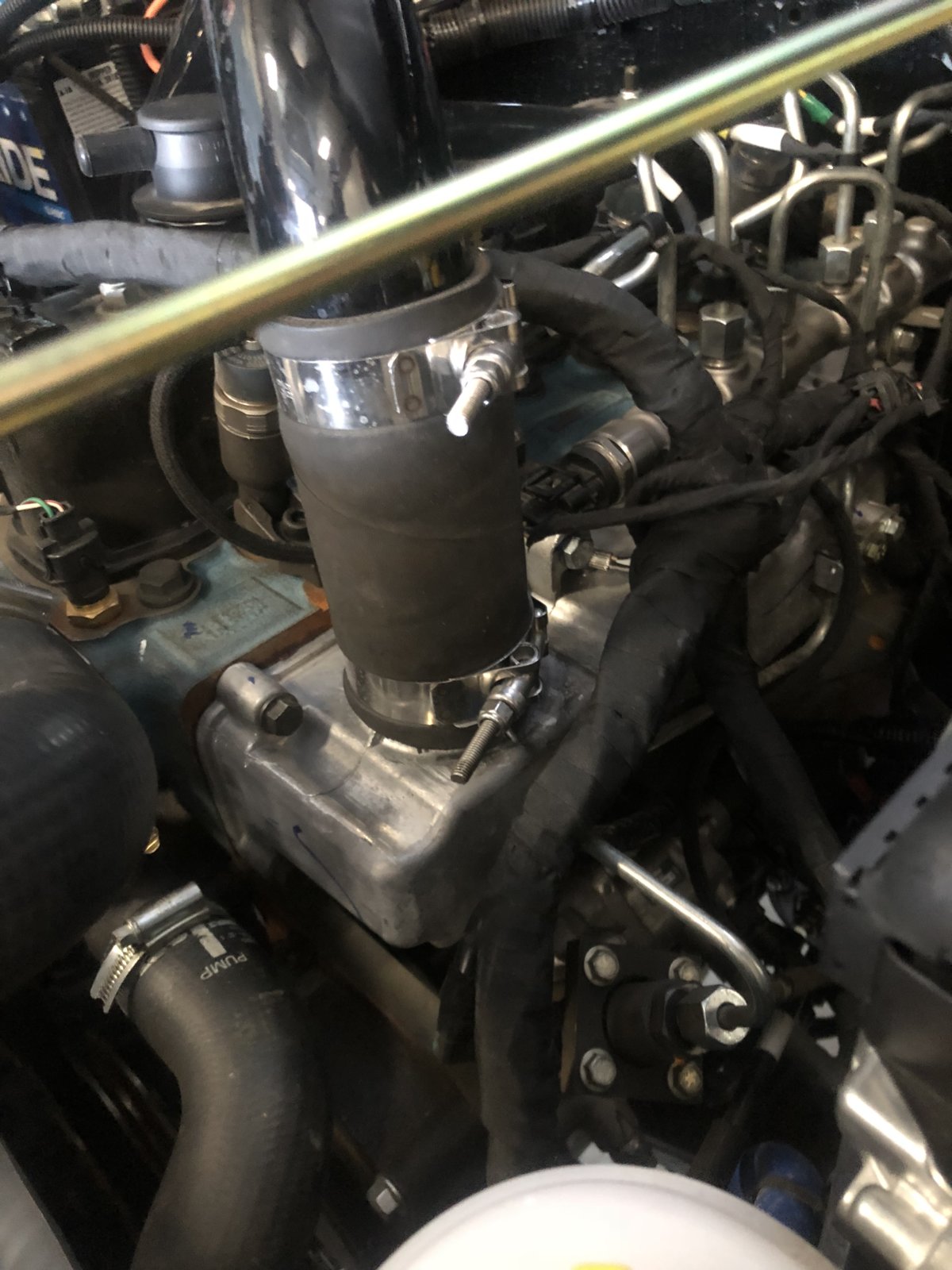

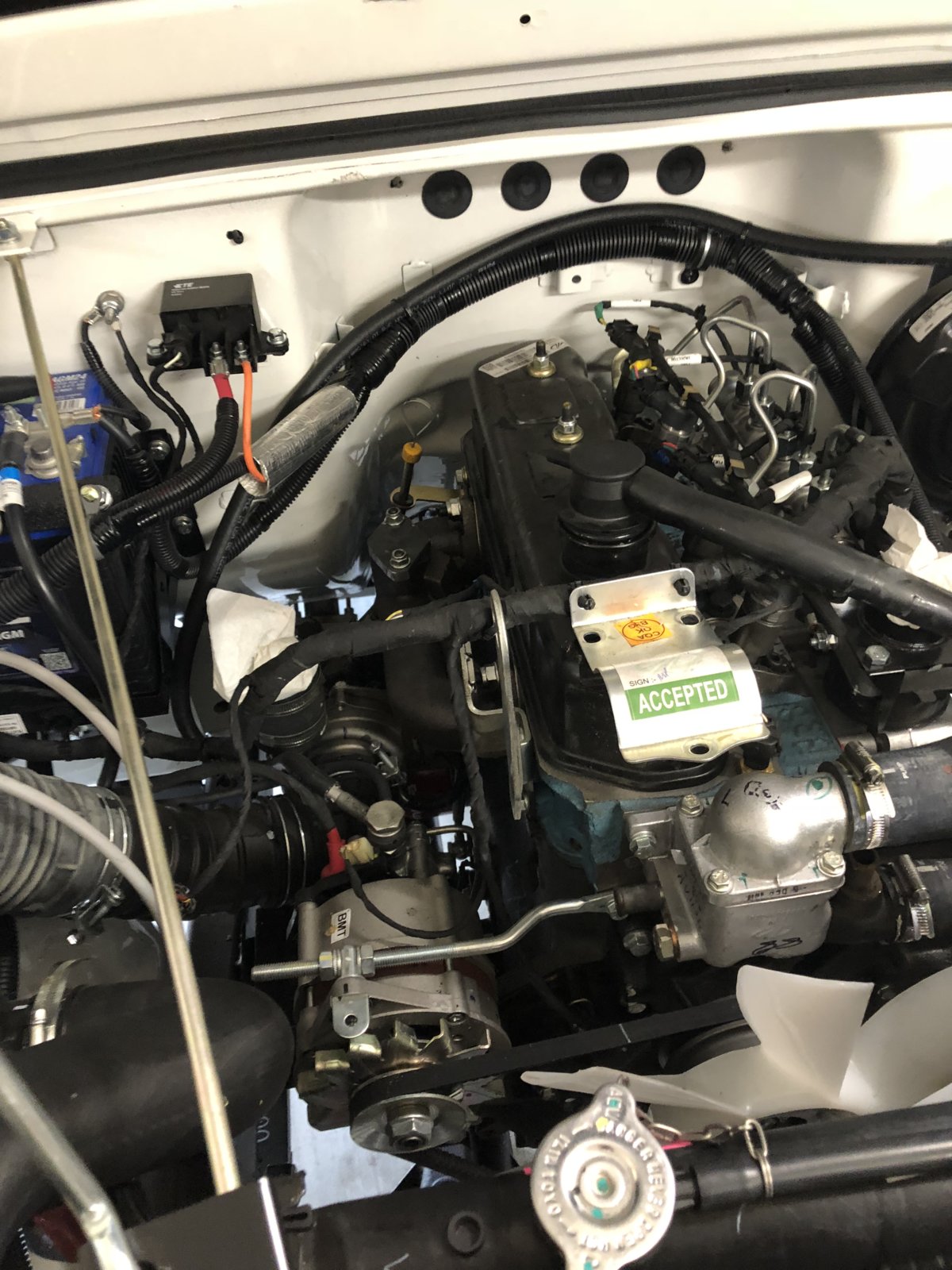

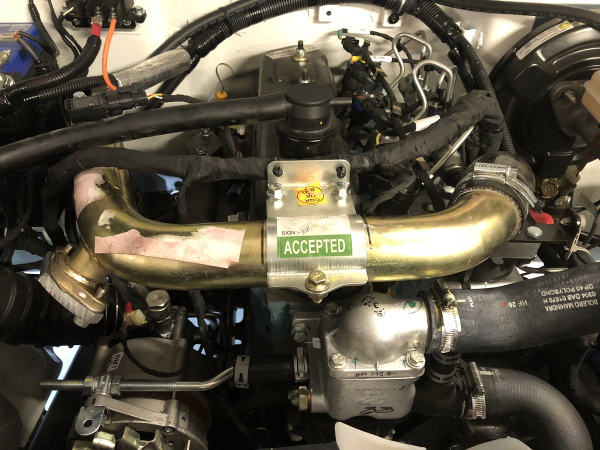

I am going to tackle another egr delete this weekend and I will take more detailed pictures and instructions along the way. The first one was pretty much digging in and trying to figure out a solution.

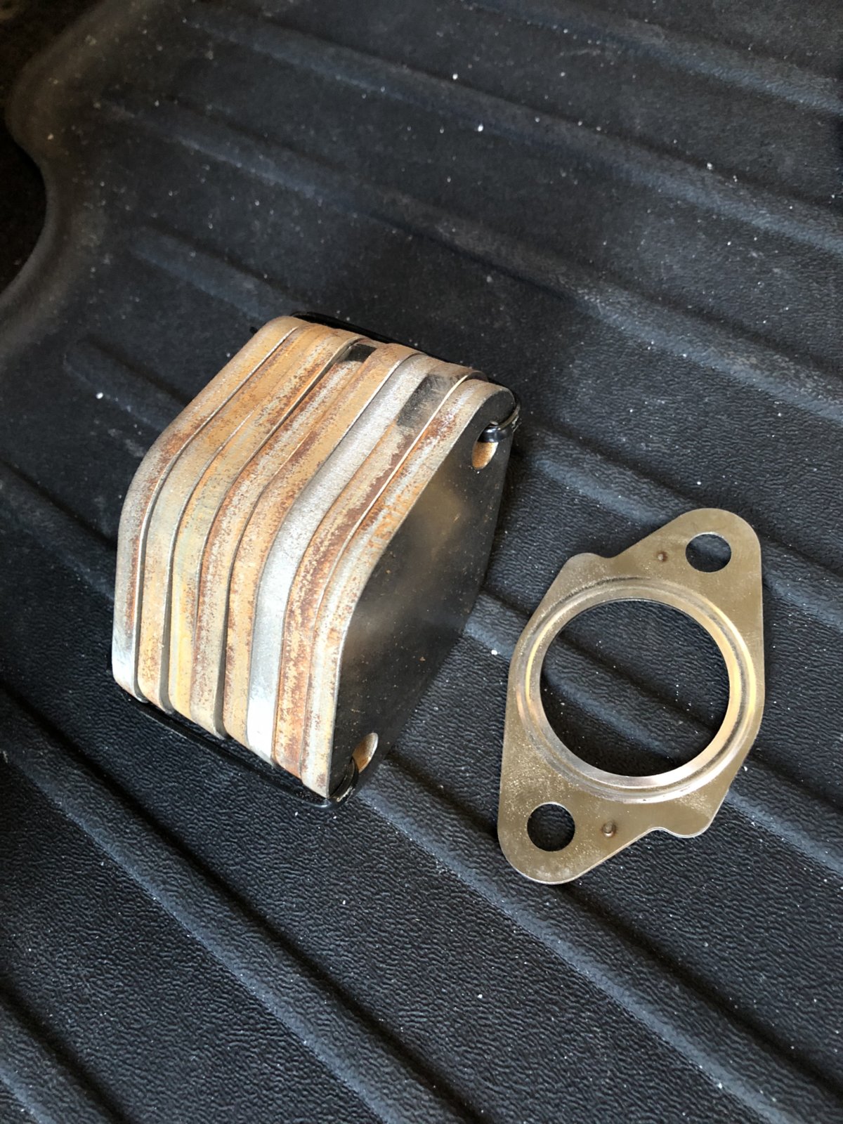

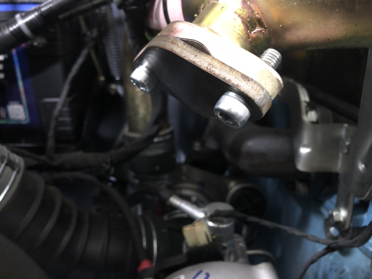

Completed 2 more today, I had some block off plates cut on a water jet. Much better finish than my first one. I’ll get a parts list together and better instructions if anyone is interested. On to the pictures!
