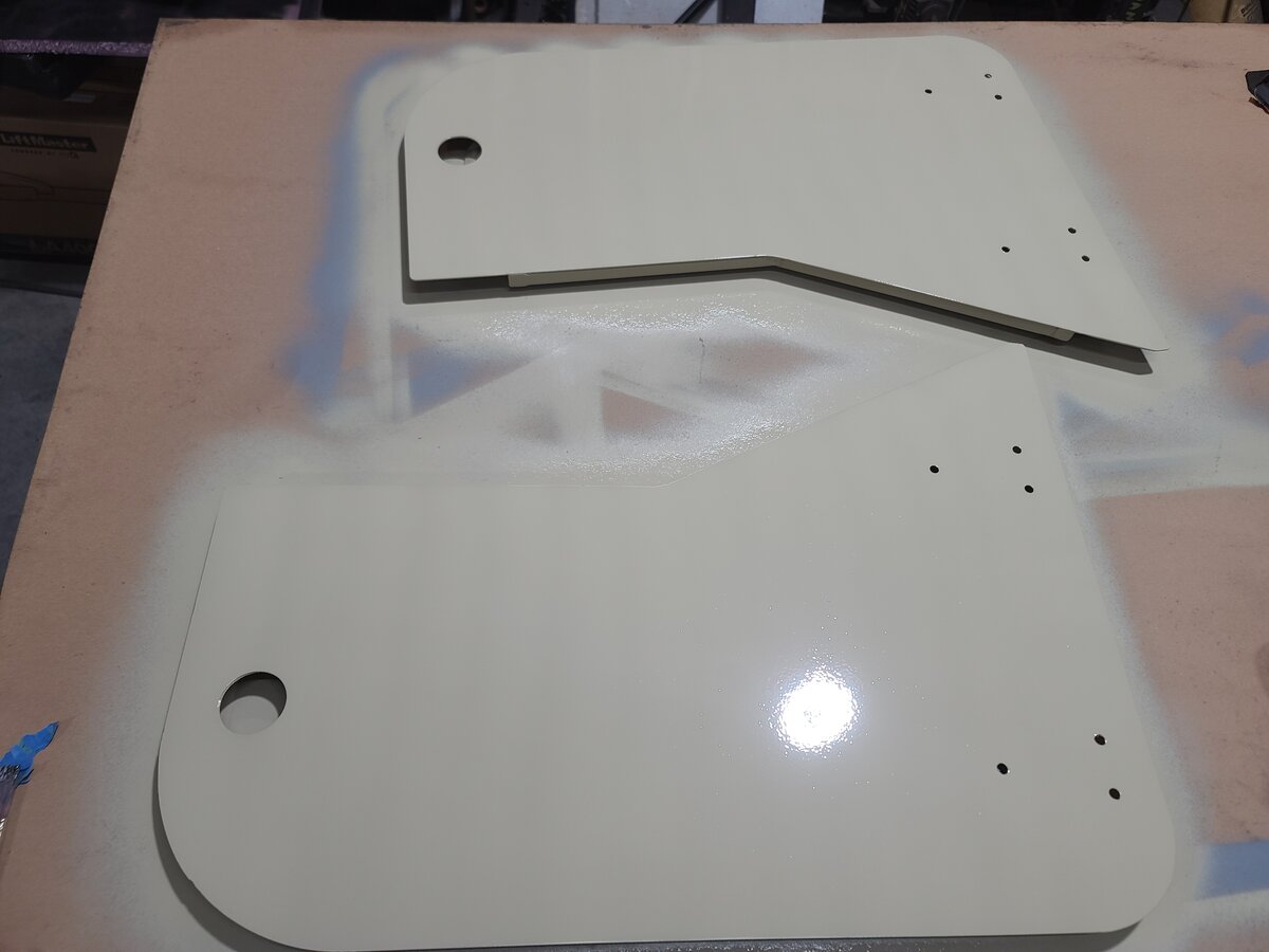

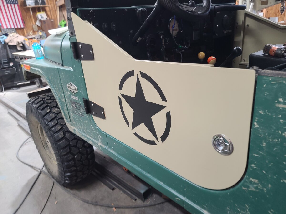

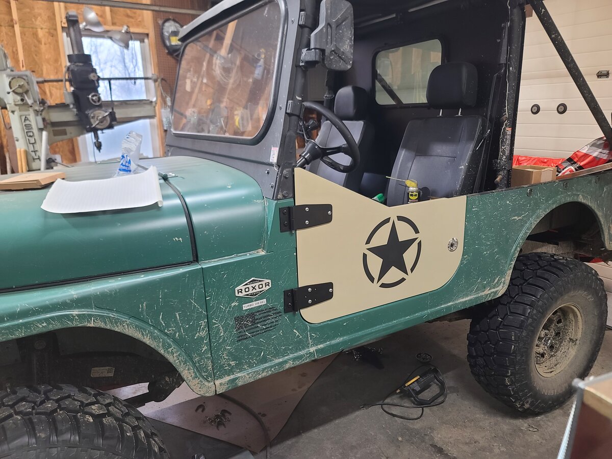

If anyone with a plasma table needs the dxf for the doors, let me know. I knew the color match would be off from the paint store so I went sand colored.
20240128_115845.jpg 20240128_065250.jpg 20240128_105304.jpg 20240128_115851.jpg 20240128_121222.jpg
1,201
If you know the RAL number for your paint code and the sheen you can get color matched paint. Looks like a satin or low gloss sheen to me. I know the olive drab isn’t a flat paint totally if I remember right. Yours is probably similar. I found a place that custom mixed the paint in spray cans. Even though my sheen isn’t a match in my grille it was close enough.

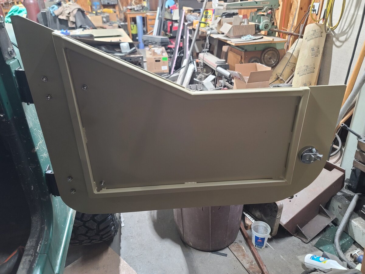

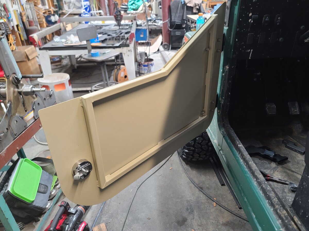

I spoke to my metal shop today and they are charging me $60.00 for two 3/16" aluminum panels. I will have them add the framework also so this is a great value. Thank you for the file!
That's cheaper than I would have cut them for made from 14g mild steel and I run a fab shop. So that's a good price if the framework is good

I cut mine afterwards. It would depend on the hinges too.
