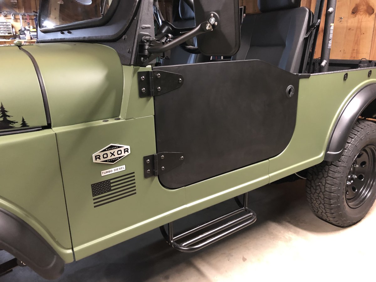

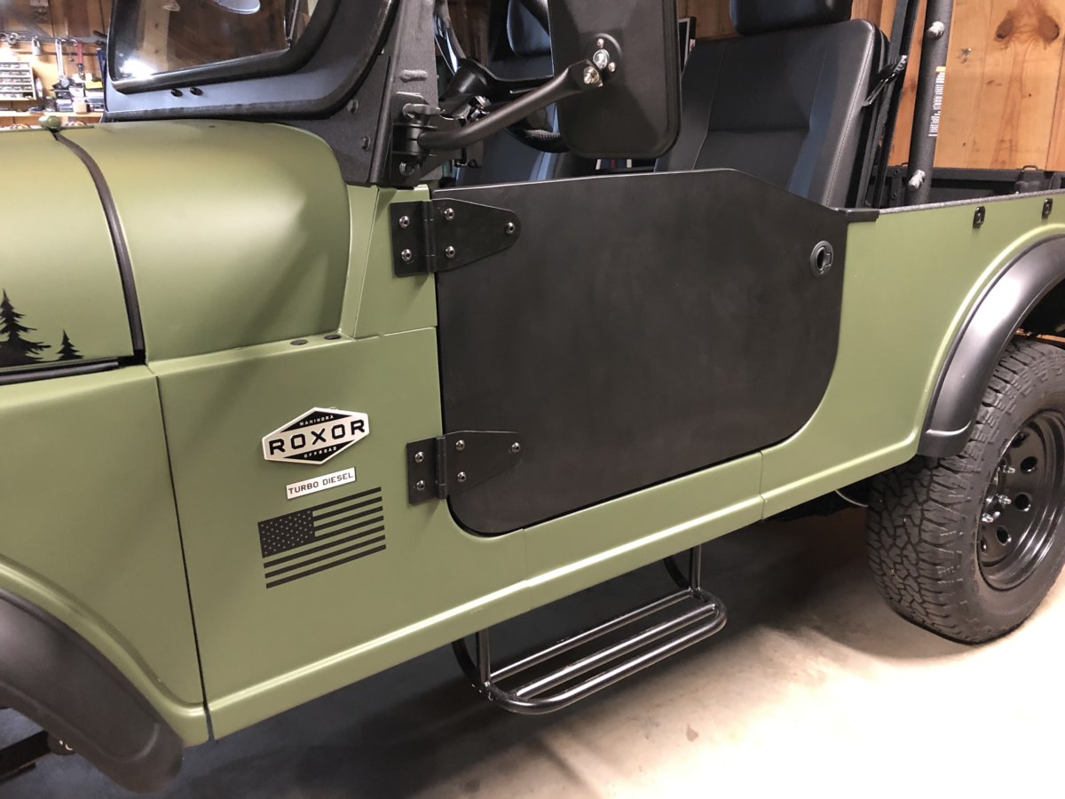

Here is a door I cut from Starboard, it’s 1/2” thick plexiglass. We’ll see how they hold up.
I still have to put the latch on and permanent bolts for the hinges

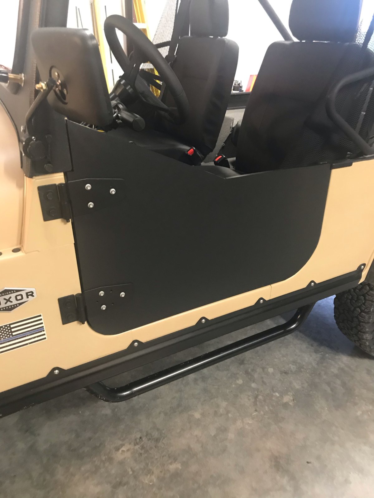

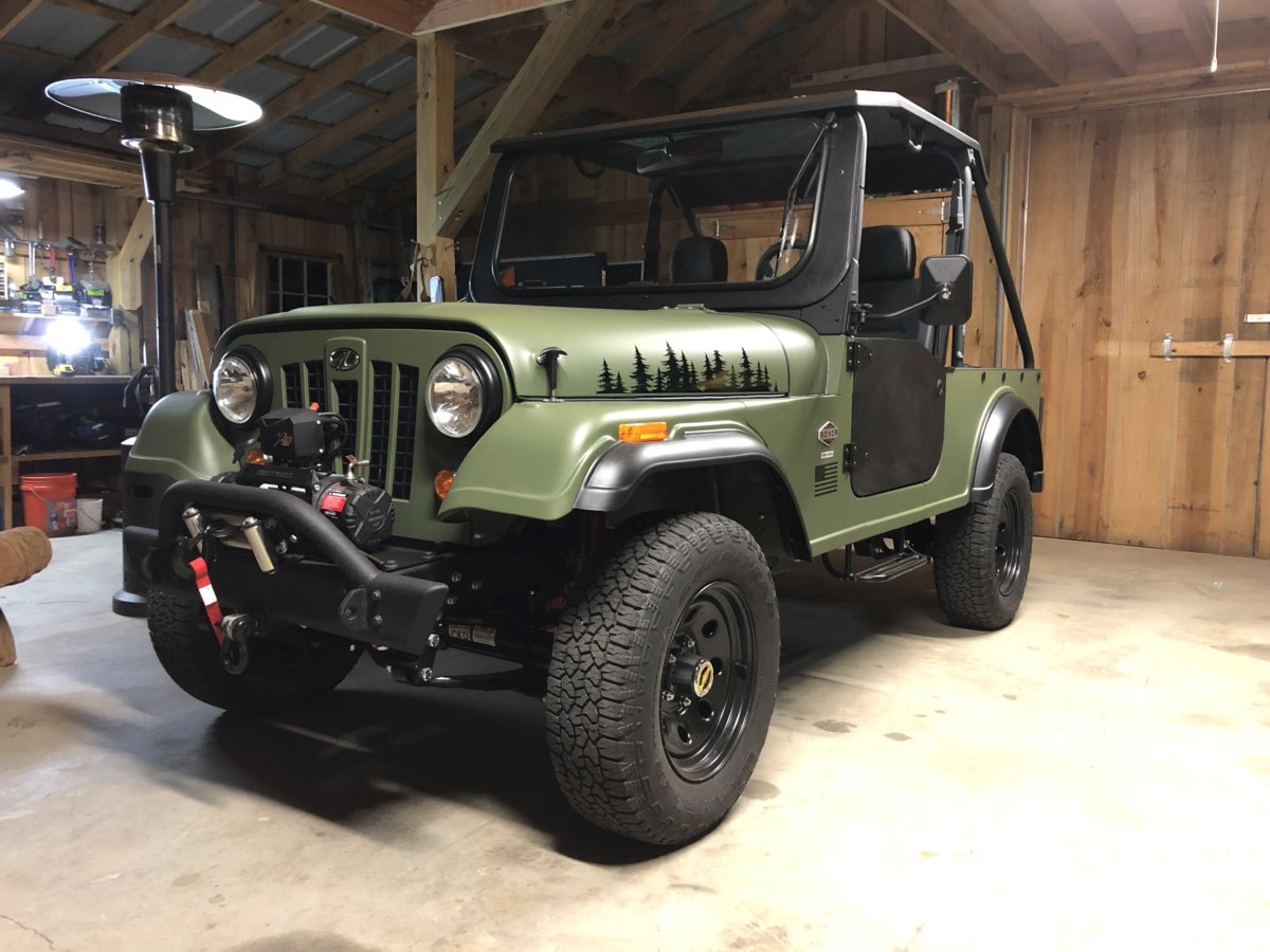

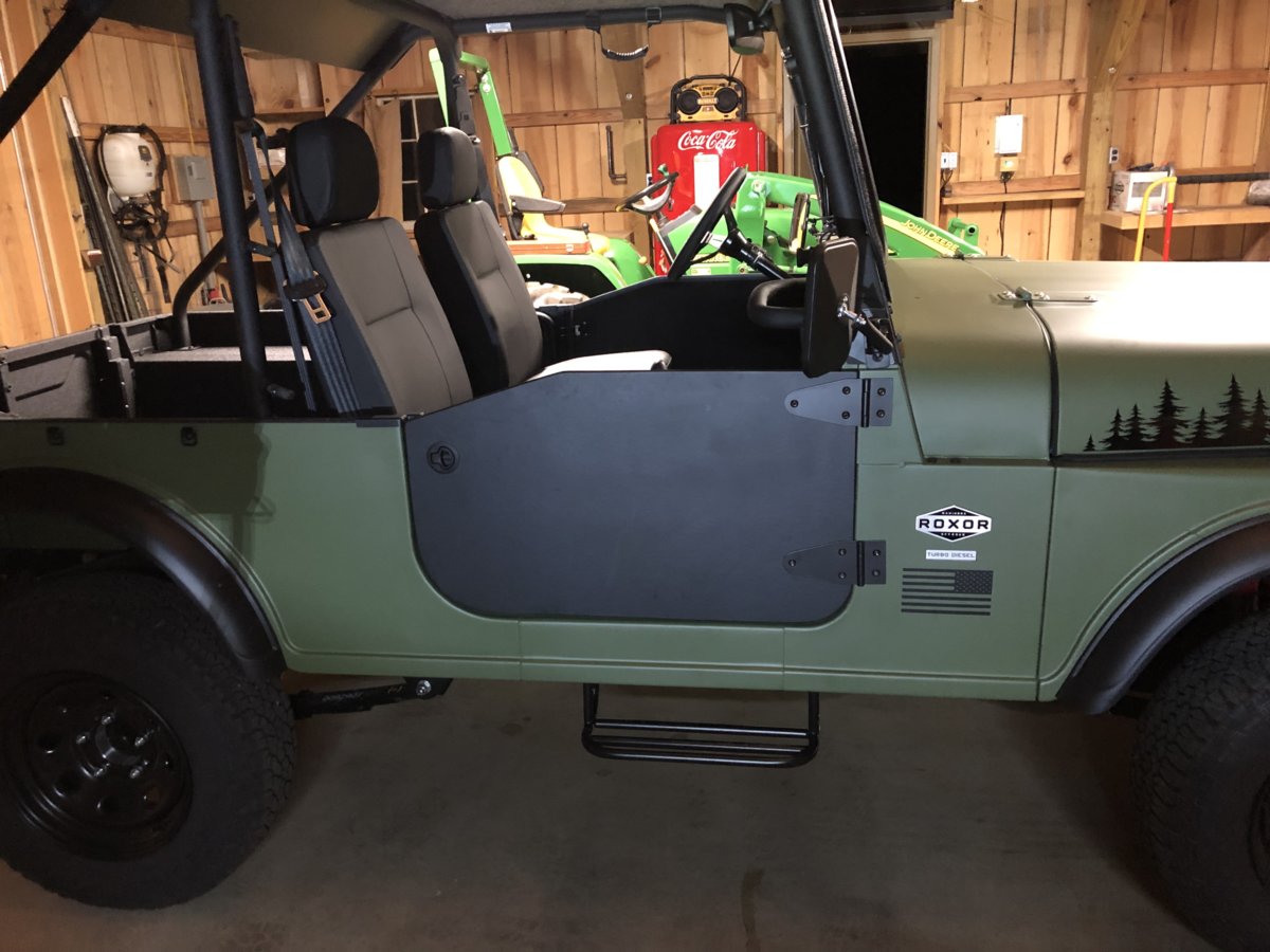

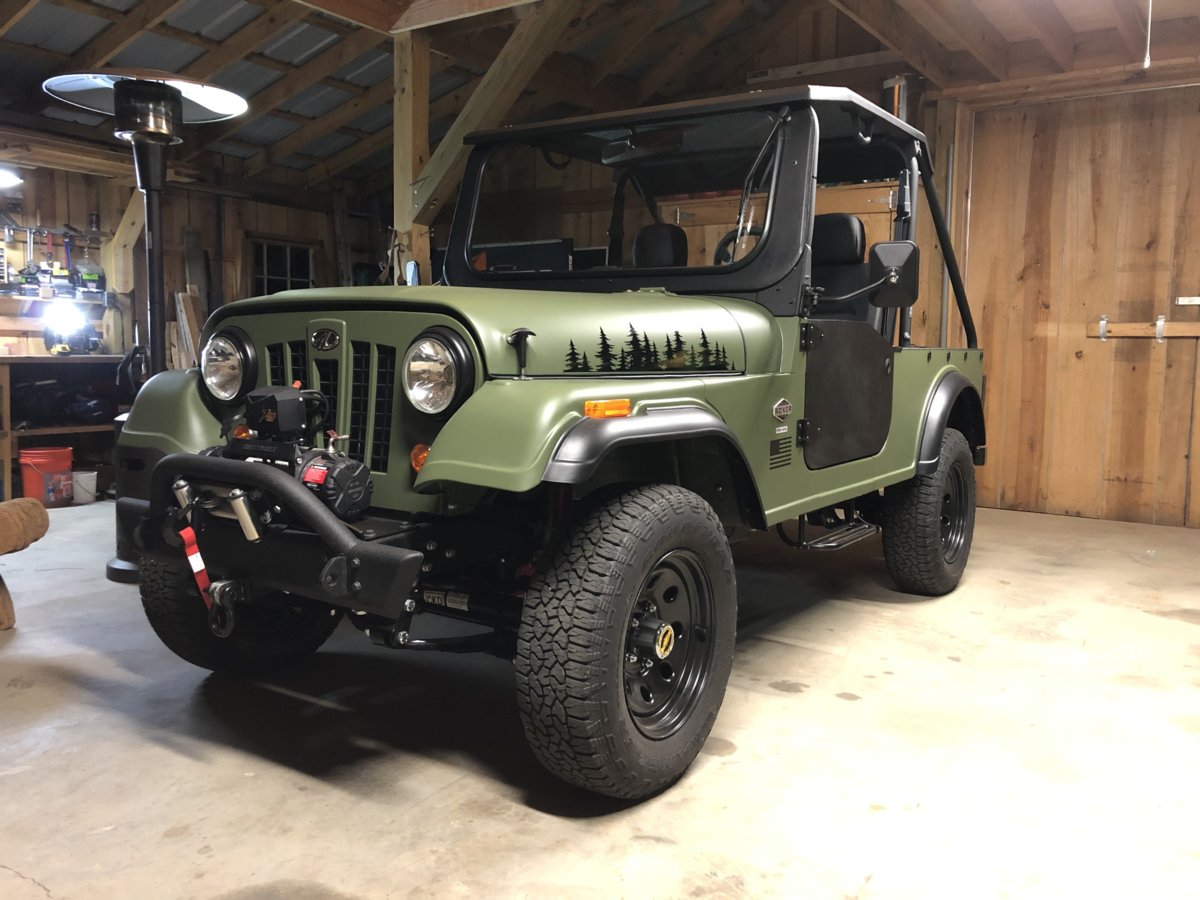

Ok I am “done” with this machine “for now” before I wind up divorced and living out of it. I have really had a lot of fun tinkering with this thing. Once the dust settles, I’m going to look into backseat options, mud tires and getting a tag for it.
.View attachment 2967
I was going to go with 3/4 inch Starboard, but the 1/2 inch would be a lot lighter and cheaper. It is hard to tell from the photos, did you have to do anything to make the door flush with the outside of the body? I measured about a 3/4 inch recess for the doors.

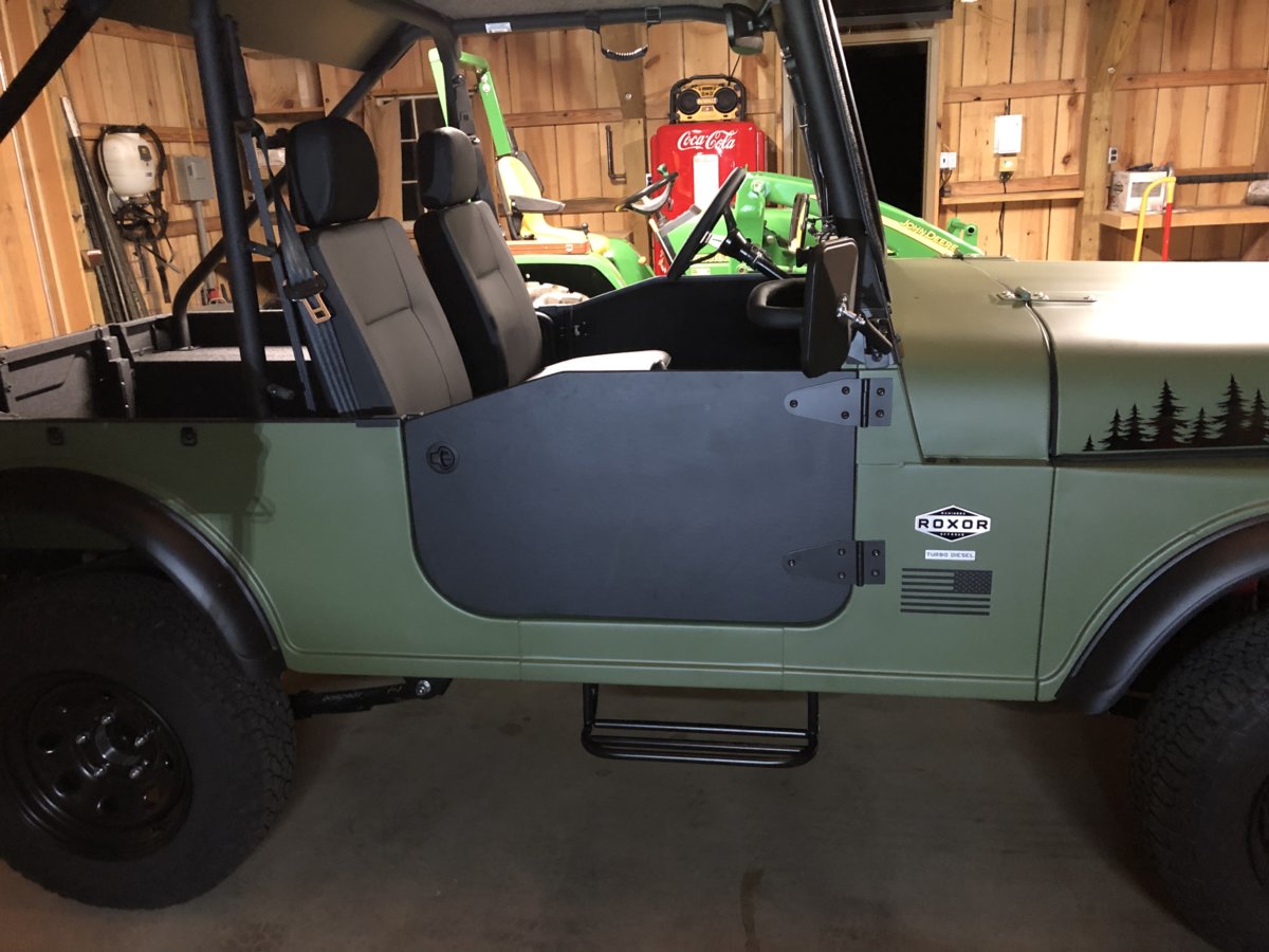

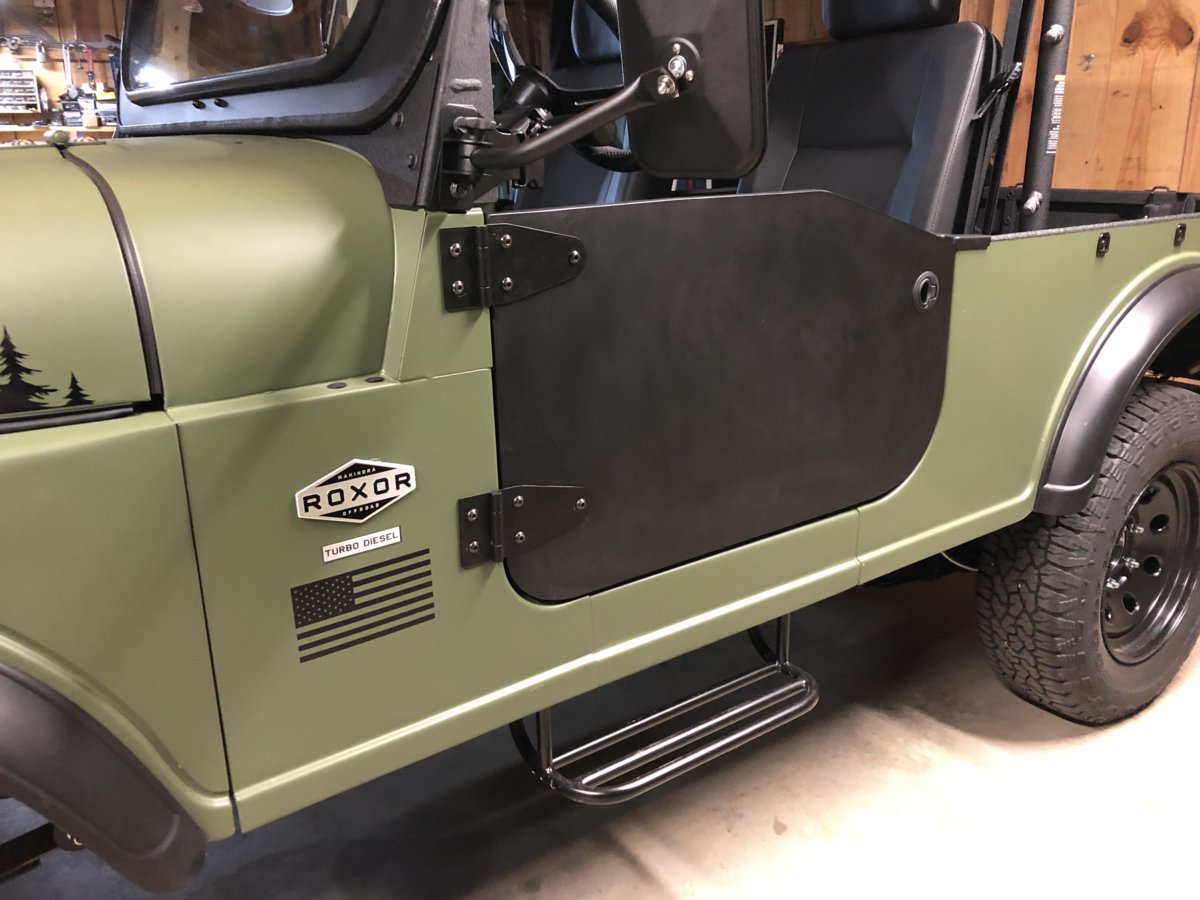

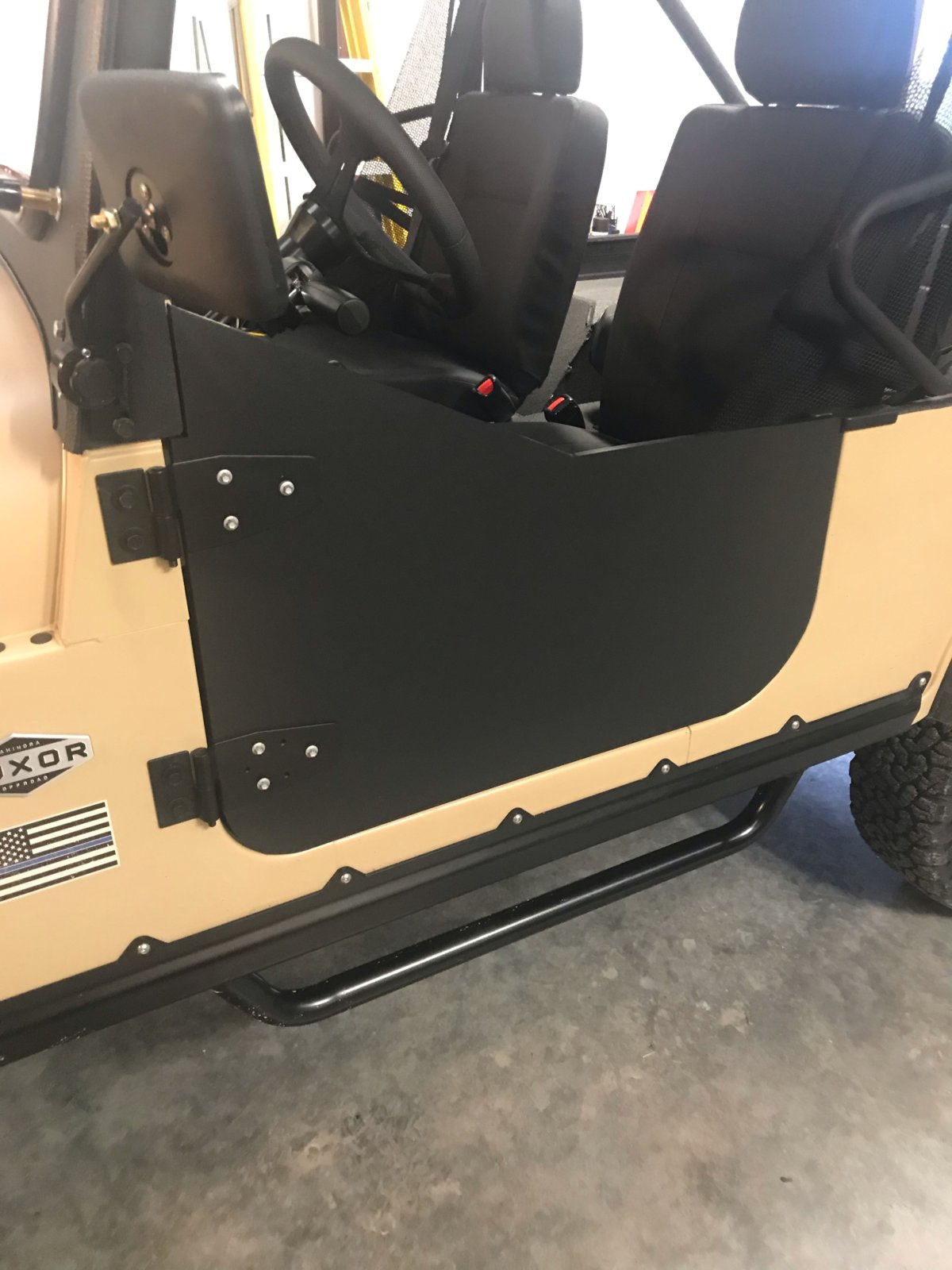

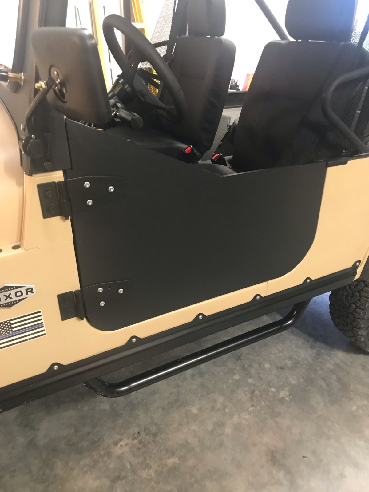

A few members have private messaged me about possibly building some half doors for them. I have found a source for pebble grain 3/4” black High Density Plastic and have ordered some door sized blanks. I will be cutting them out and installing them on my Roxor next week and posting some pictures.
If anyone is interested in a set I can build them for $400 plus shipping. This will include the doors, hinges, latches, weatherstripping and all hardware needed.

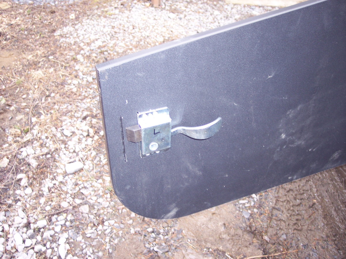

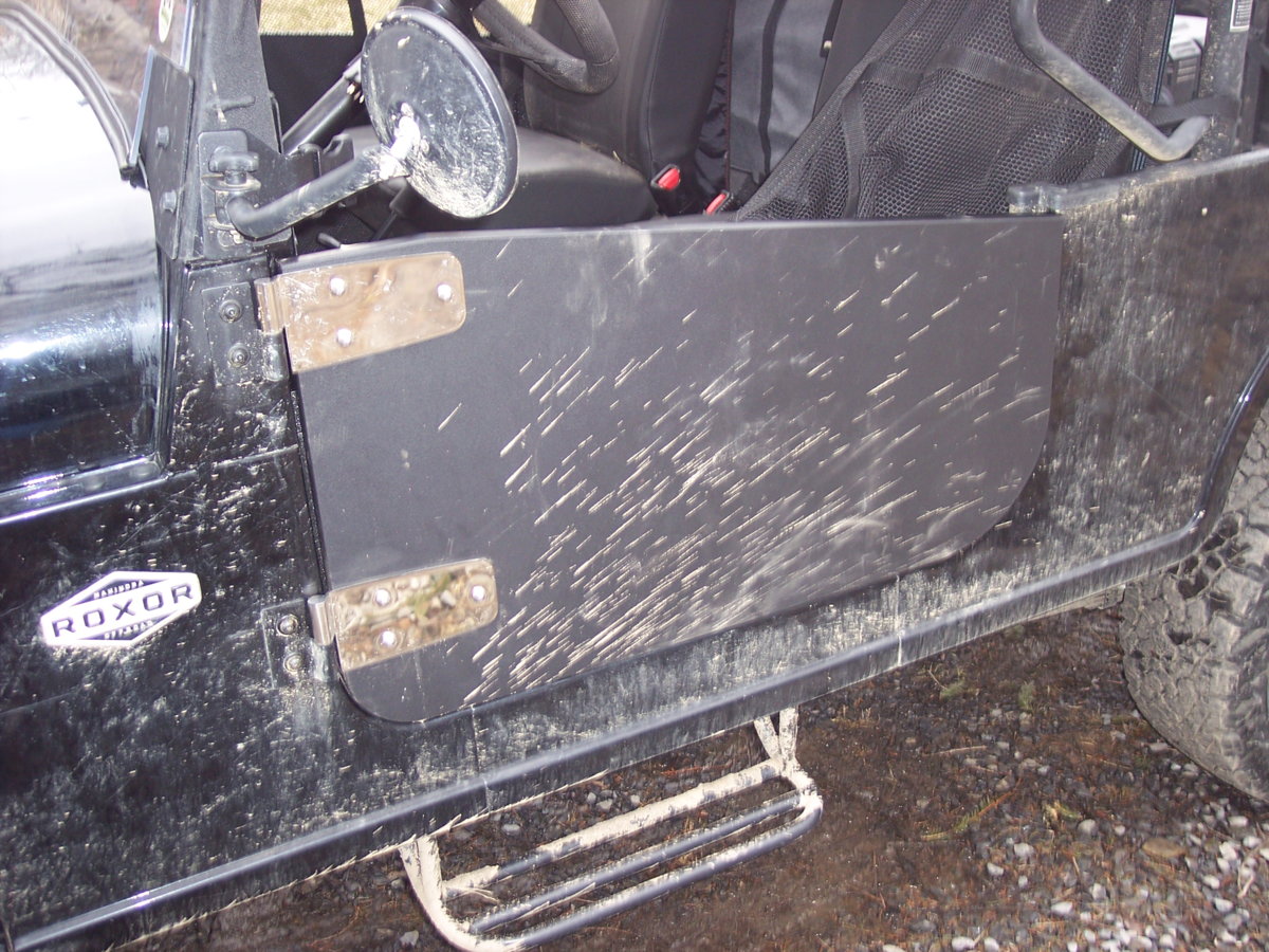

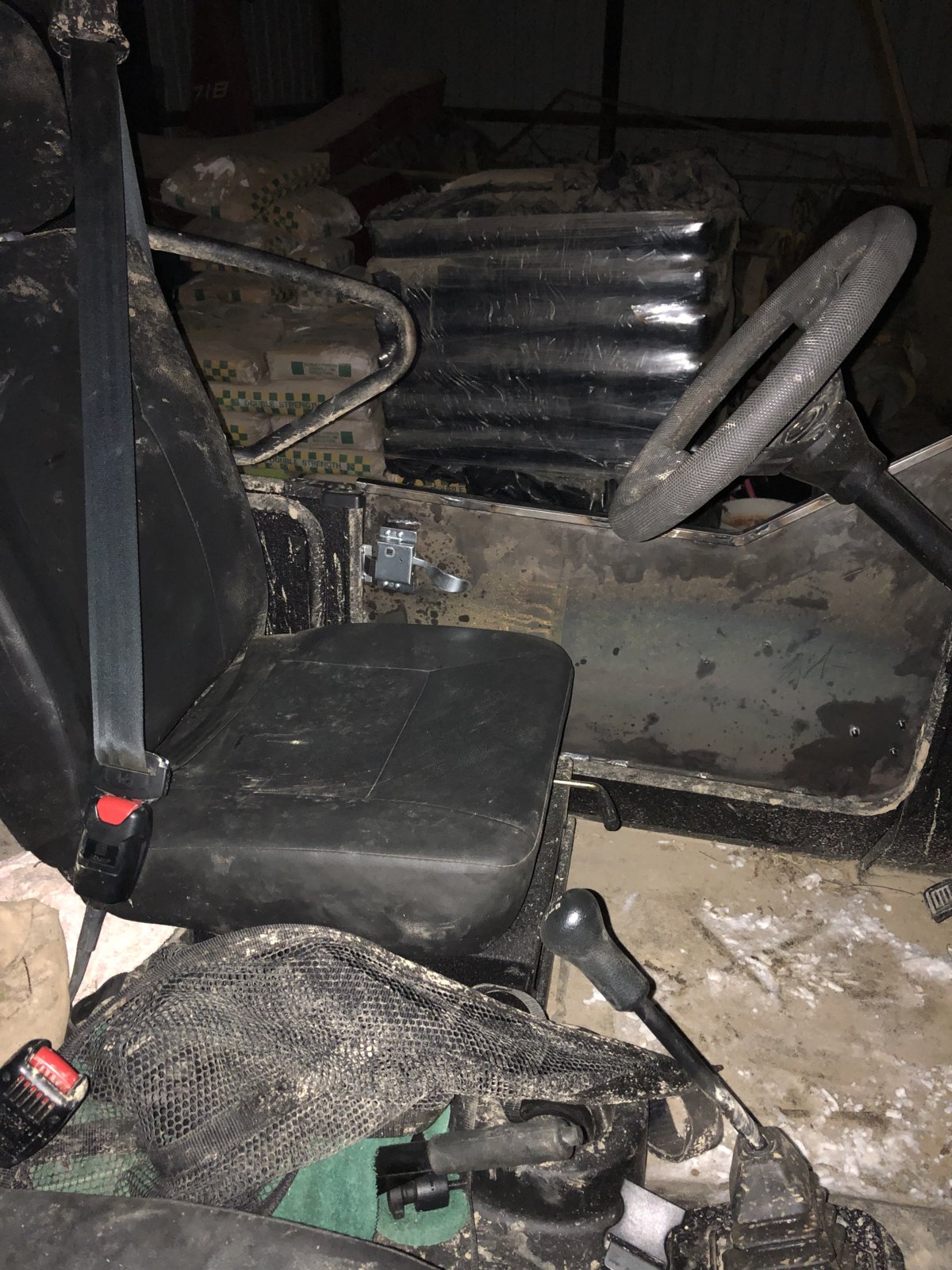

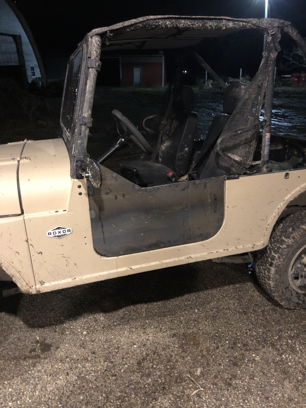

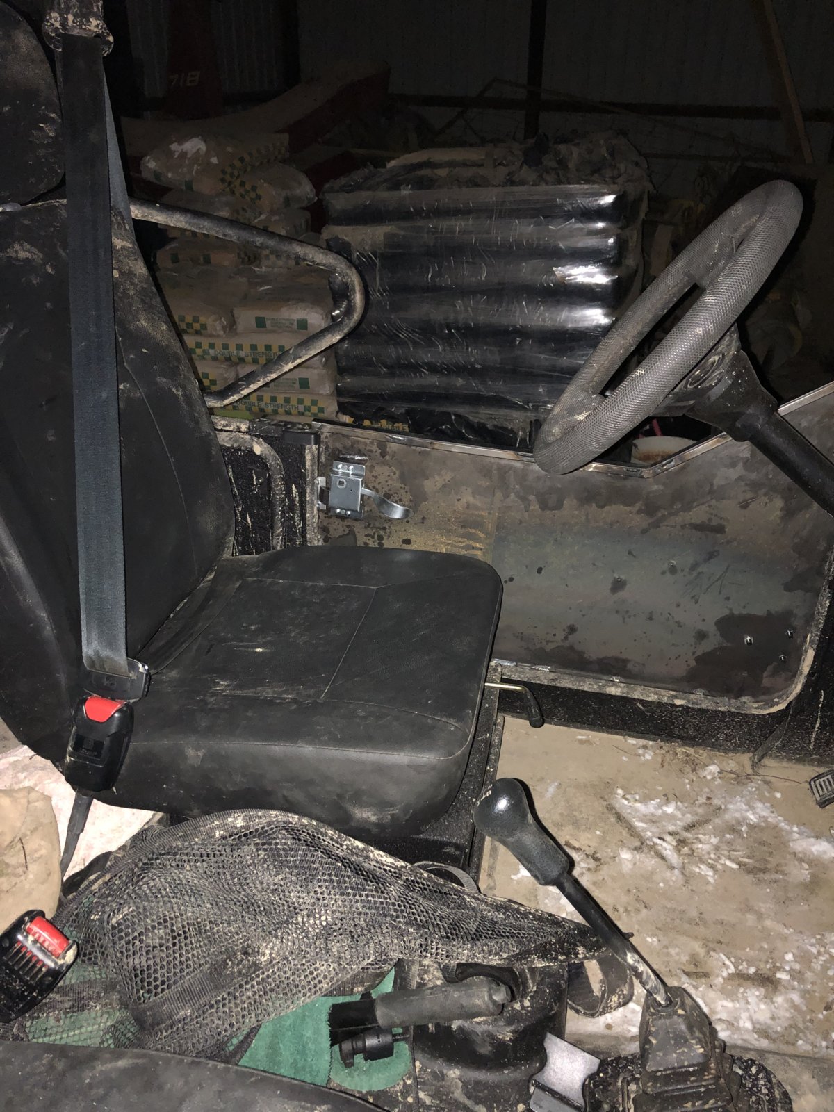

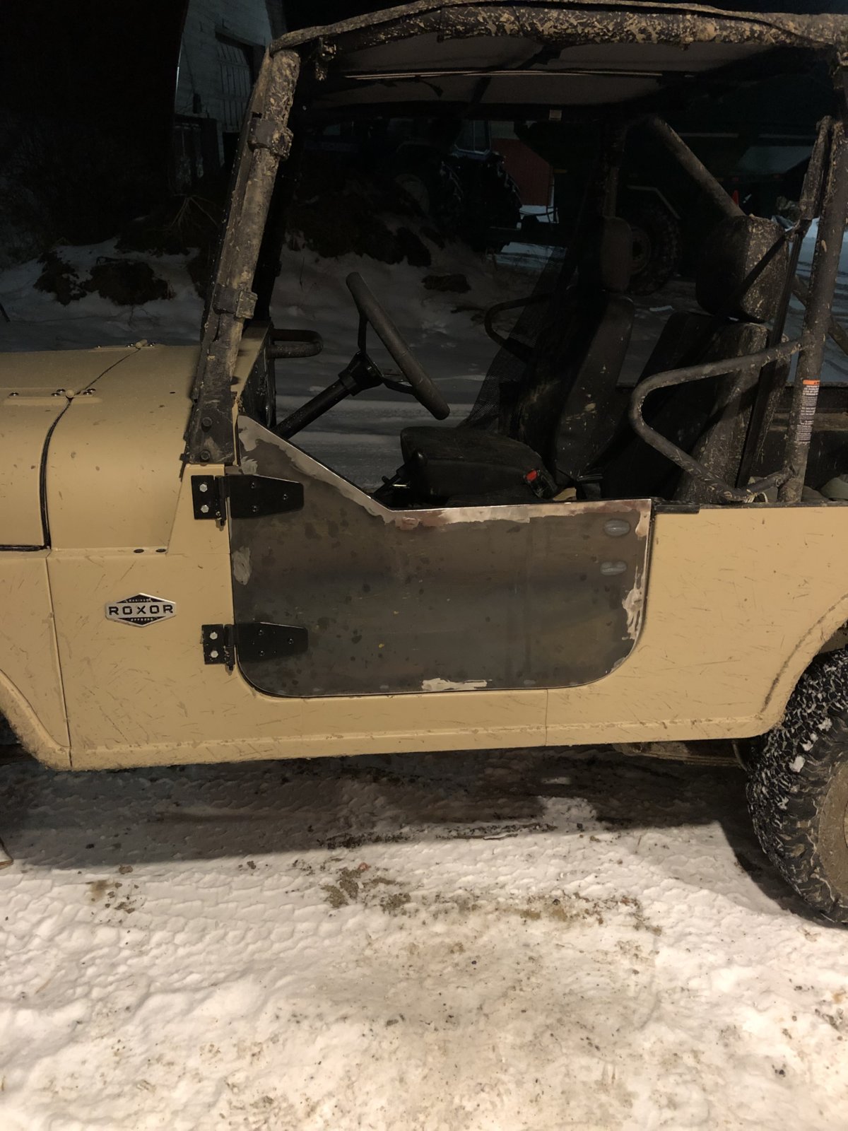

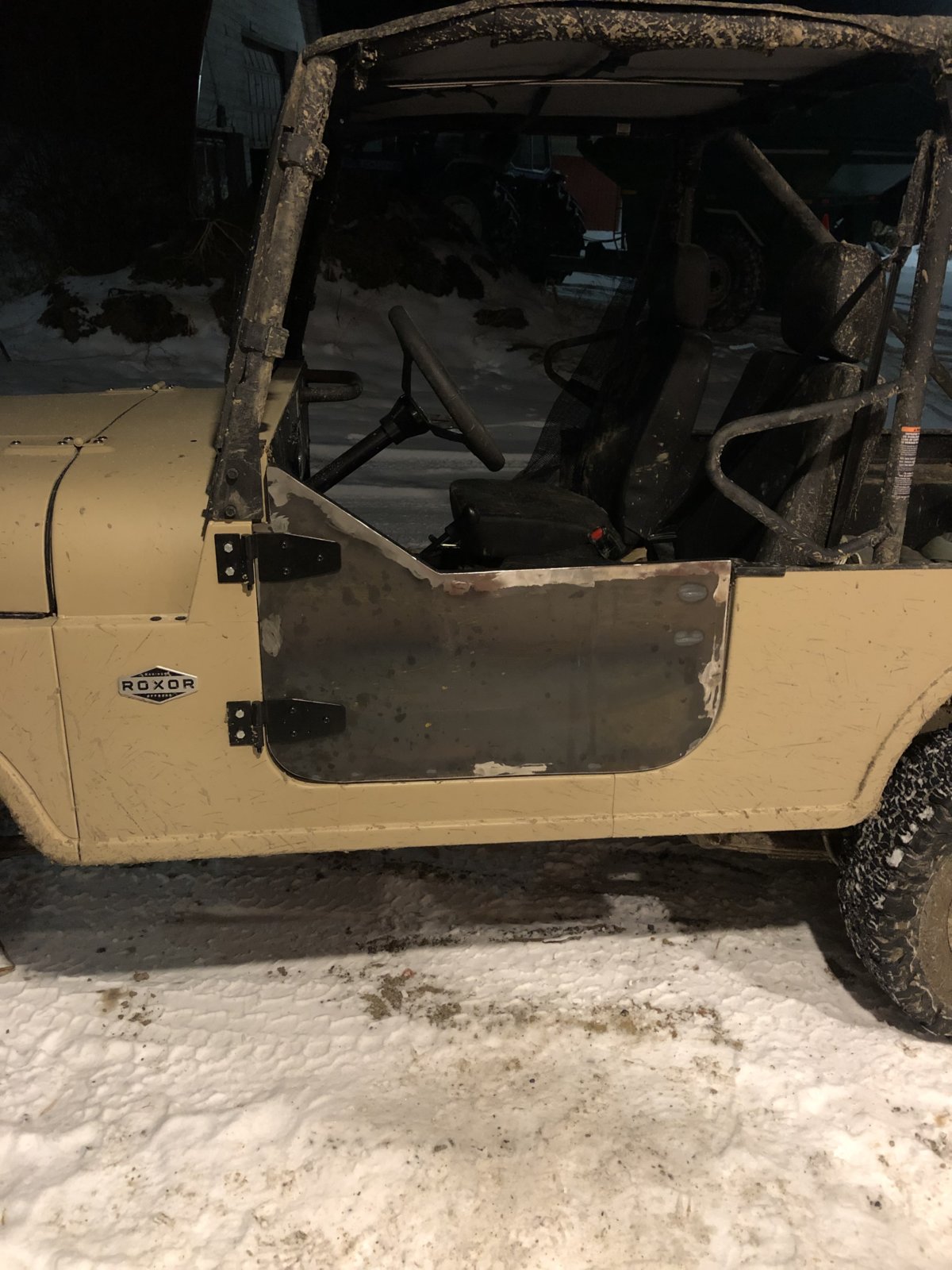

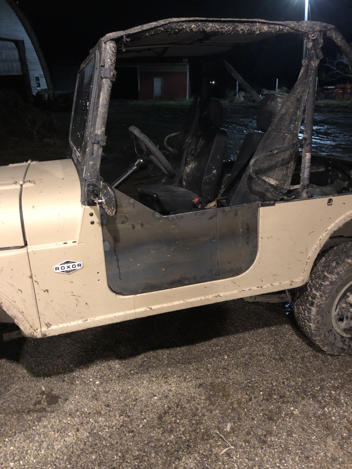

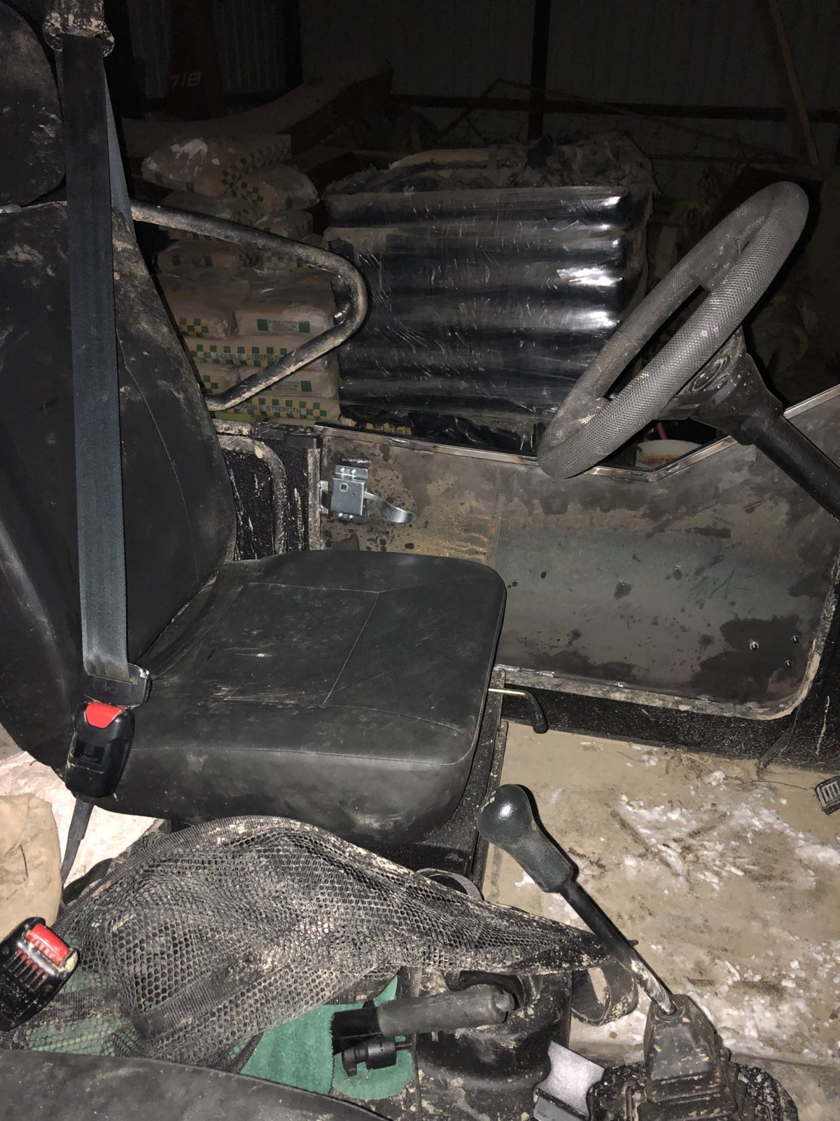

I finally got the doors made of Starboard attached, now I can see all the mud that is hitting the door instead of me. I used the All States Ag parts door latches as seen in the one photo. The door hinge parts don't match because I got the stainless half NOS at a lower price.
I now just have to figure out how to make a catch for them, there is less than a 1/16 inch between the latch "tongue" and the door. Any thoughts would be appreciated.
PS-just ignore that vertical groove by the latch-nothing to see here....

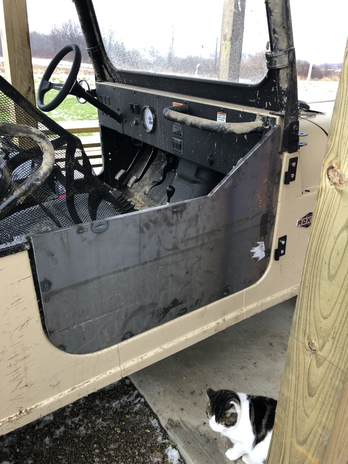

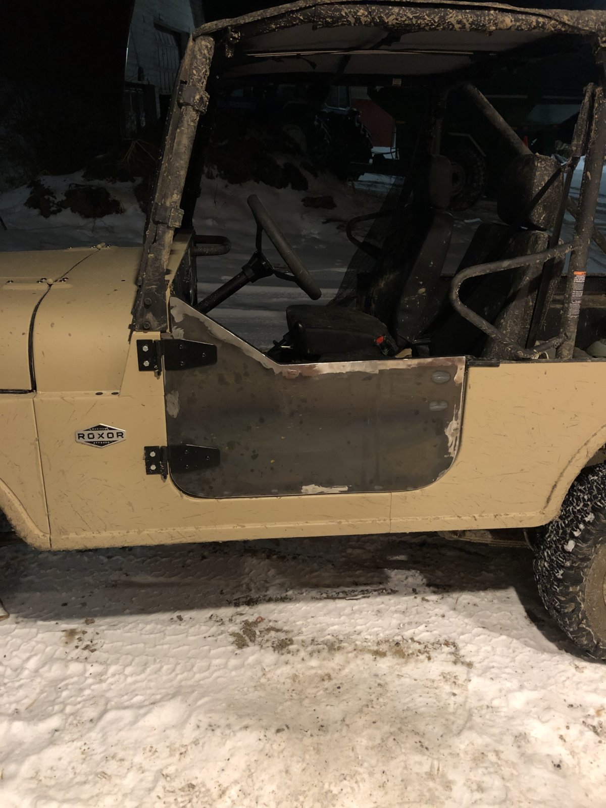

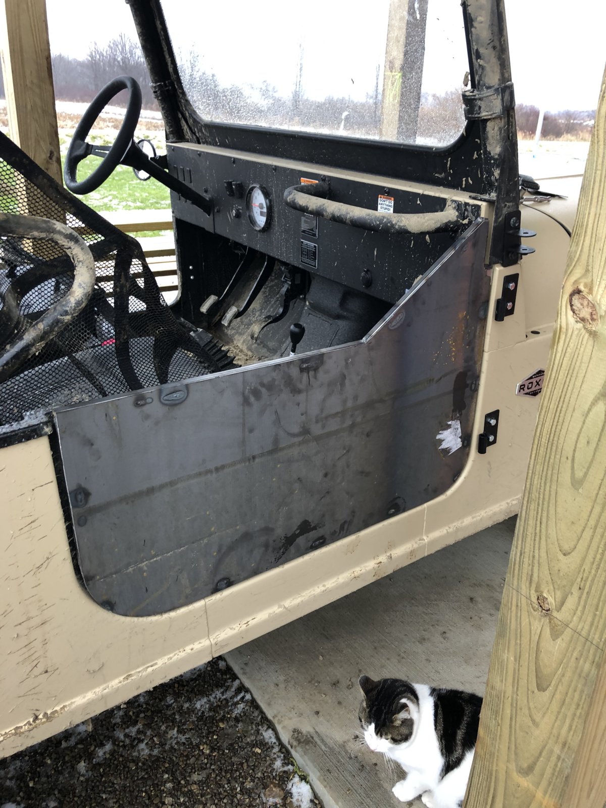

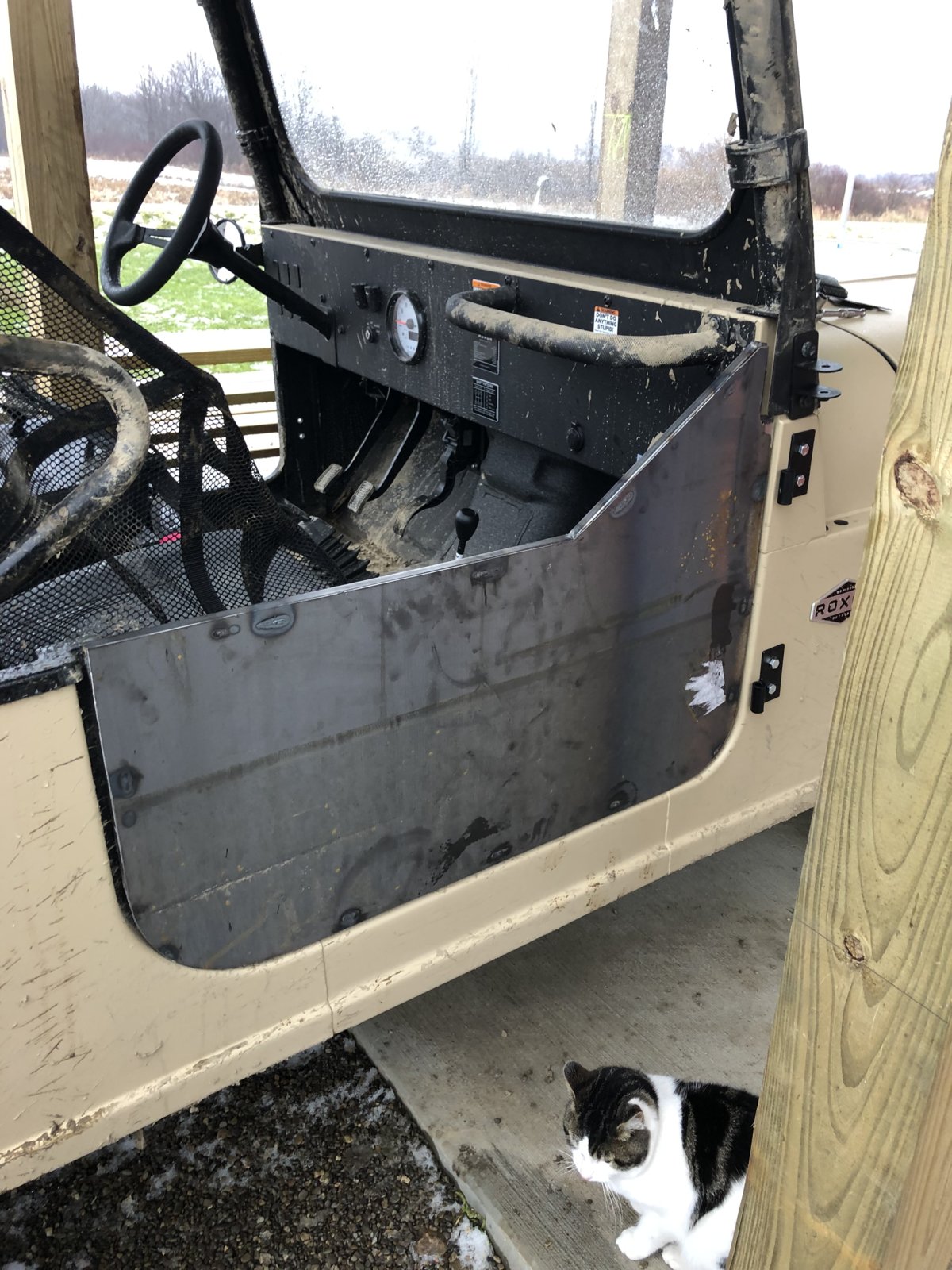

Since the mesh “doors” are kind of a pain I decided to make my own doors. I started with a cut out of cardboard and then traced it on to a sheet of 1/2” plywood. Then welded a frame out of 1/2” square tubing and flat stock. The hardest part was getting the correct arch on the flat stock (would have been easier with a bender. Then cut out 16 gauge steel for the skin of the doors. And welded 3/4” flat stock on top to cover the top rail of the doors. Bought hinges and latches I found on other threads, ordered off amazon. It was a little bit of fabrication but I’m only in about 300 dollars right now, still need paint but that will be in the spring. They aren’t perfect but they are perfect for around our farm. If you have the tools definitely worthwhile.View attachment 2665View attachment 2666View attachment 2667View attachment 2668
Awesome Job (y)
