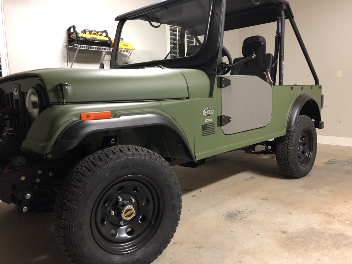

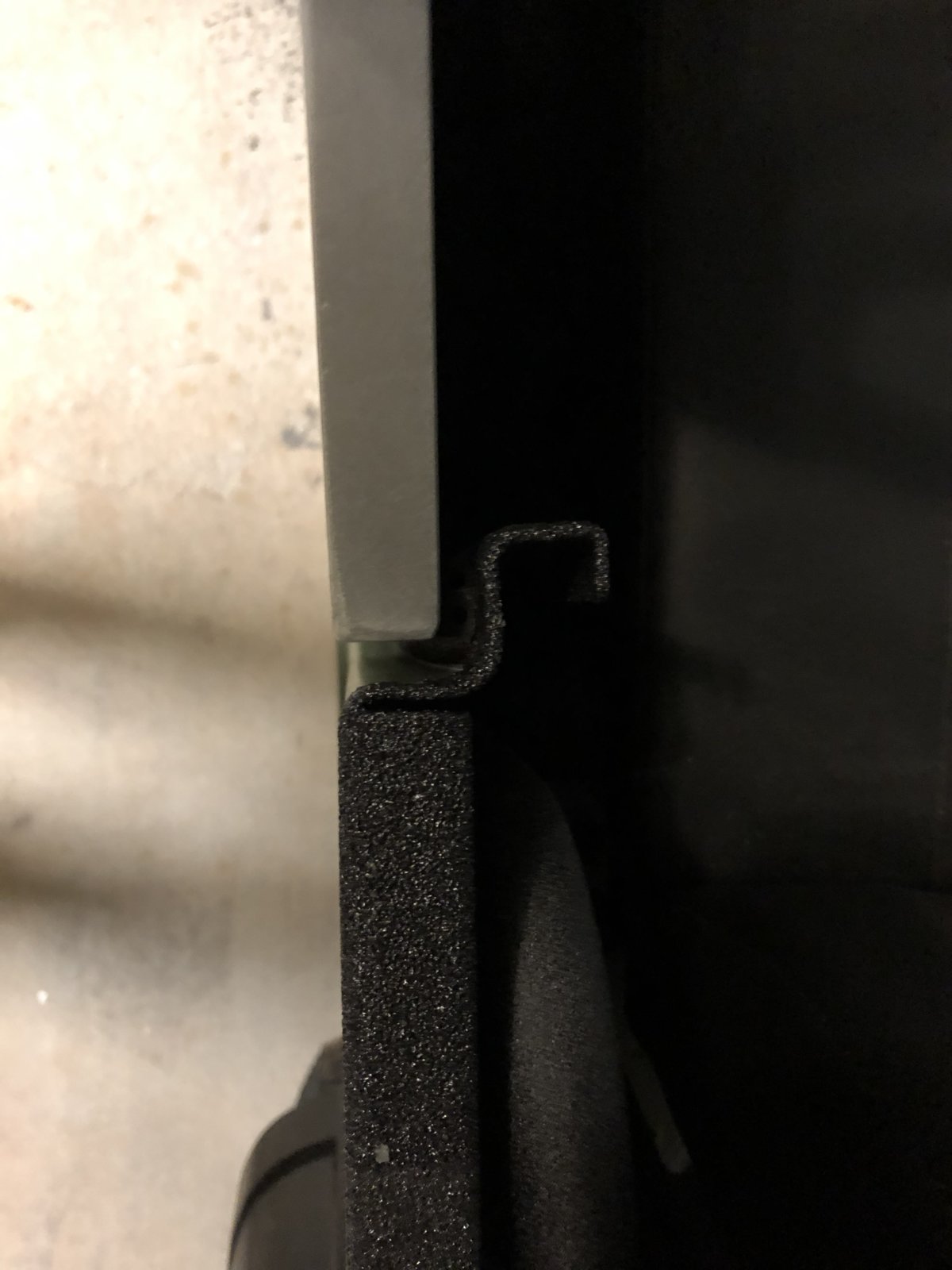

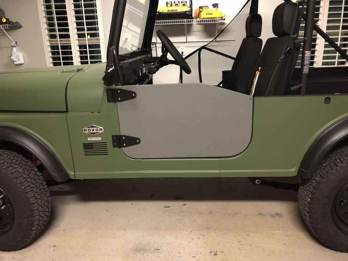

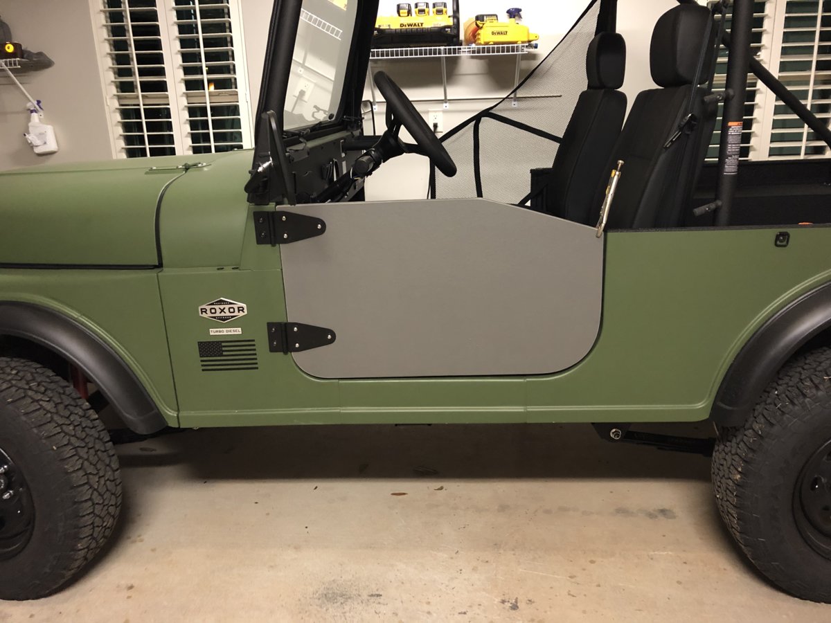

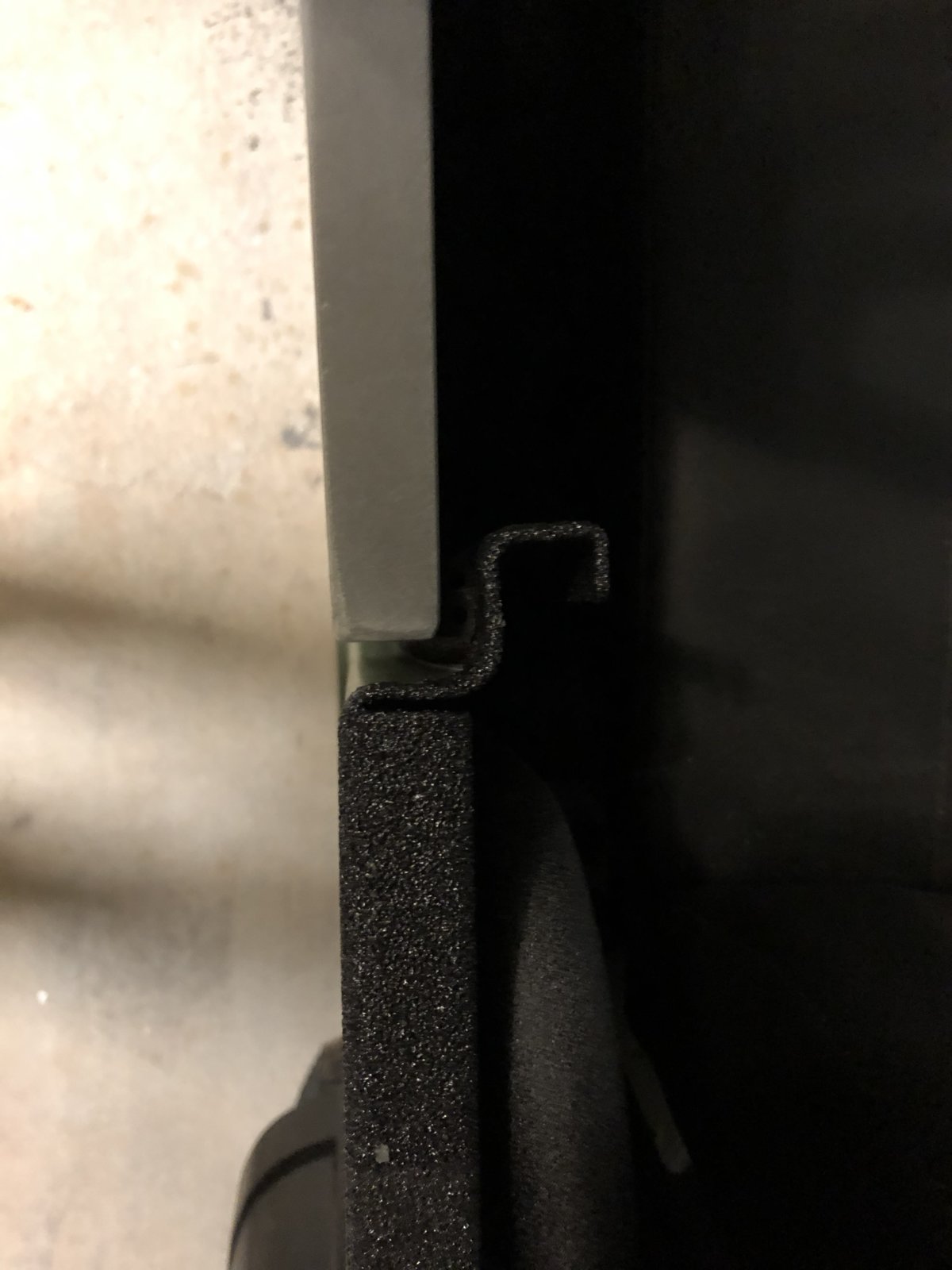

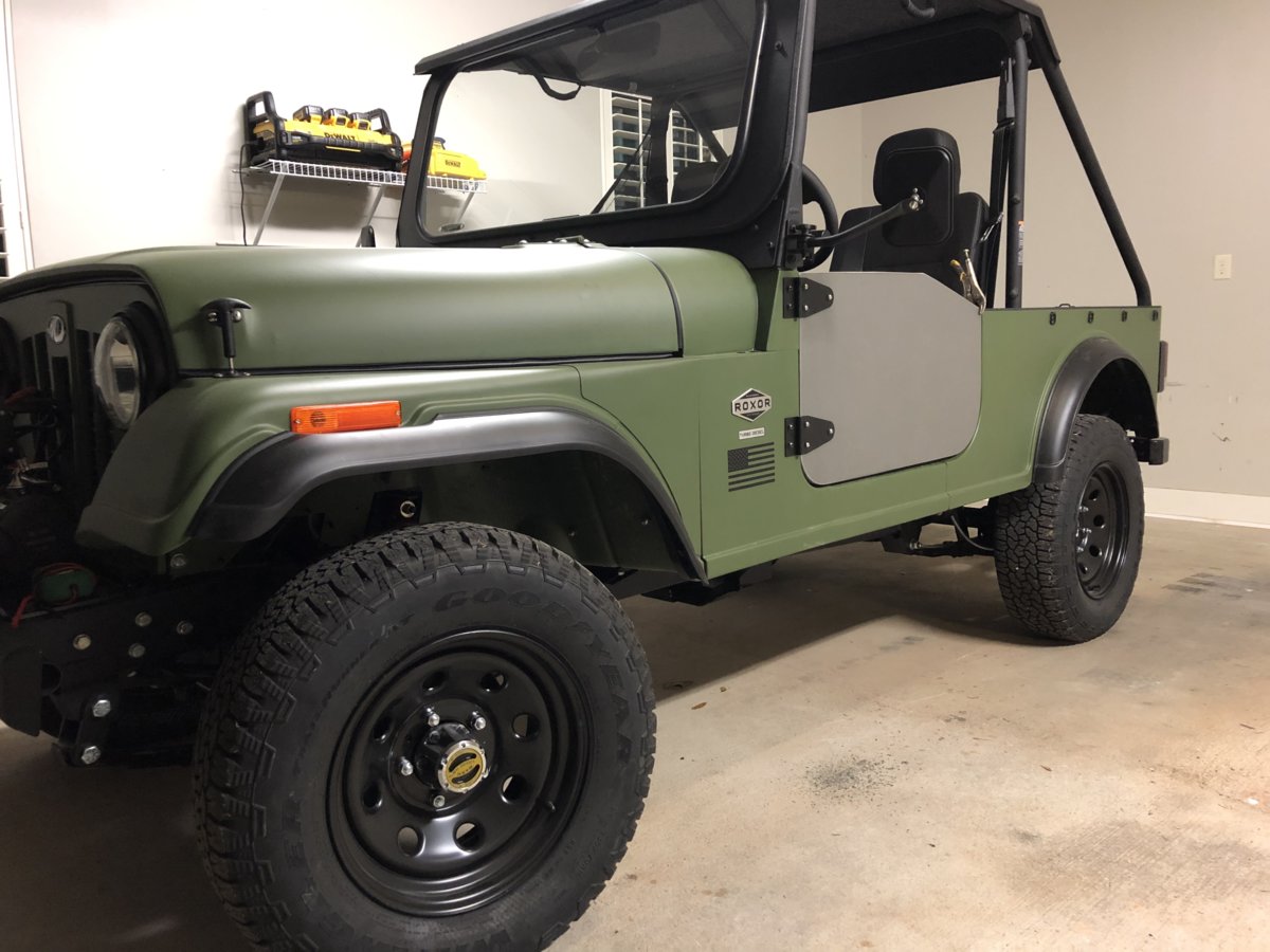

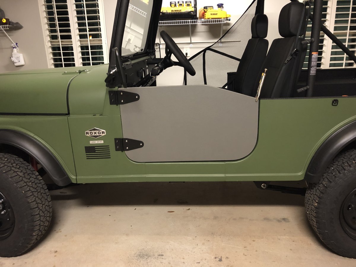

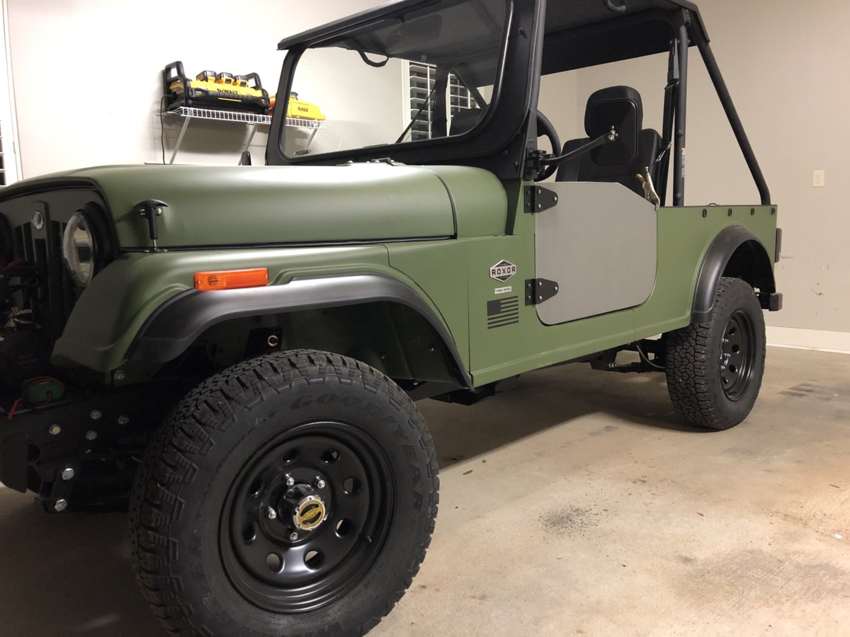

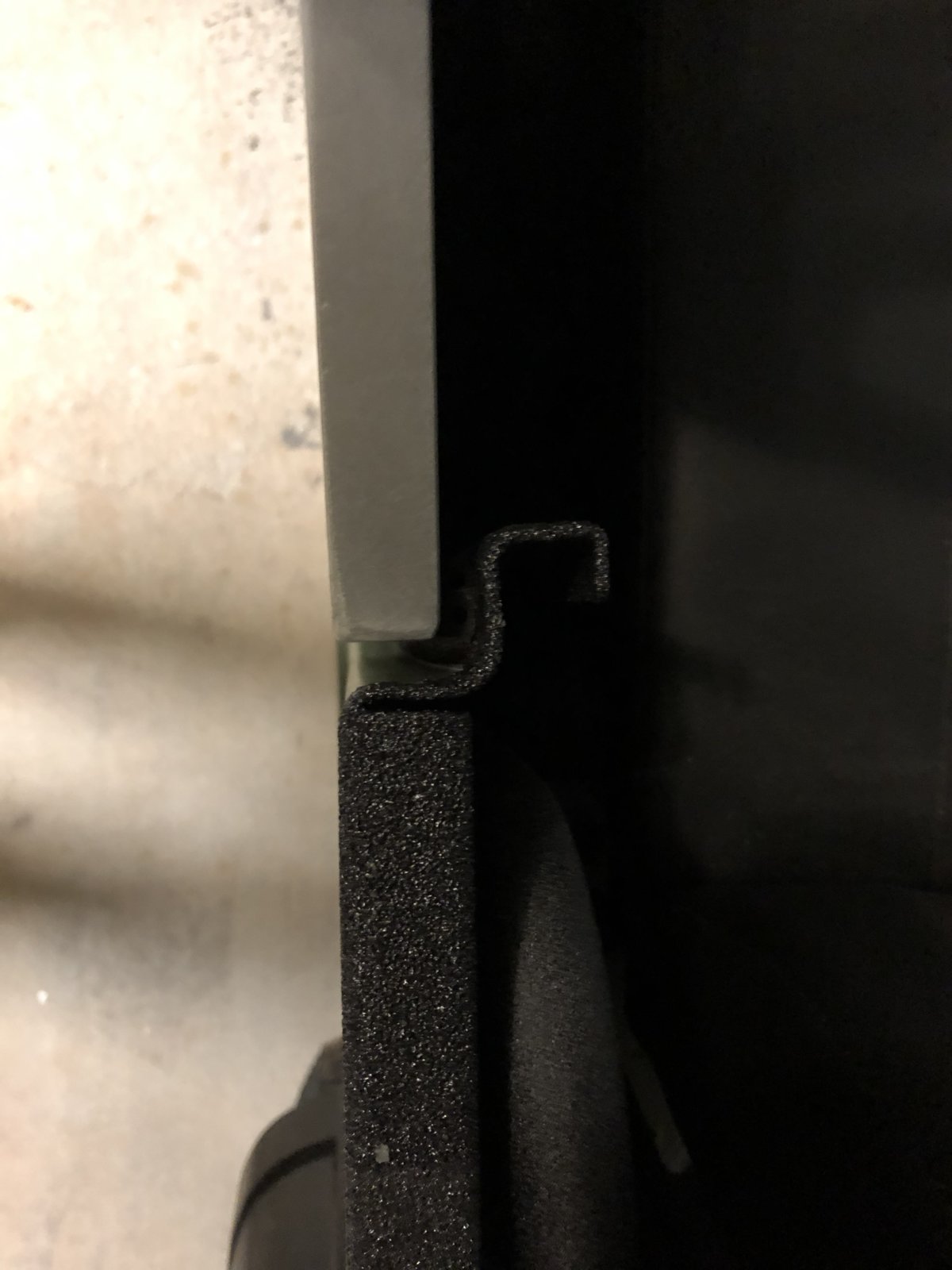

Started working on my bathroom partition Roxor doors today. I measured the hood hinges and figured out that the bolt holes line up with the factory door hinge holes. Found a set of hood hinges on amazon for $35. Had a phenolic toilet partition door left on a job and it took me about 20 minutes to make the first one. The phenolic is 3/4” which is perfect. It leaves 1/4” for weatherstripping. Just need to decide on paddle latch or slam latch. Will probably paint them black but the phenolic is hard as a rock and very durable.
View attachment 2889 View attachment 2890 View attachment 2891
What's the rough measurements of the doors ? Looking to order material before I get my rig delivered
