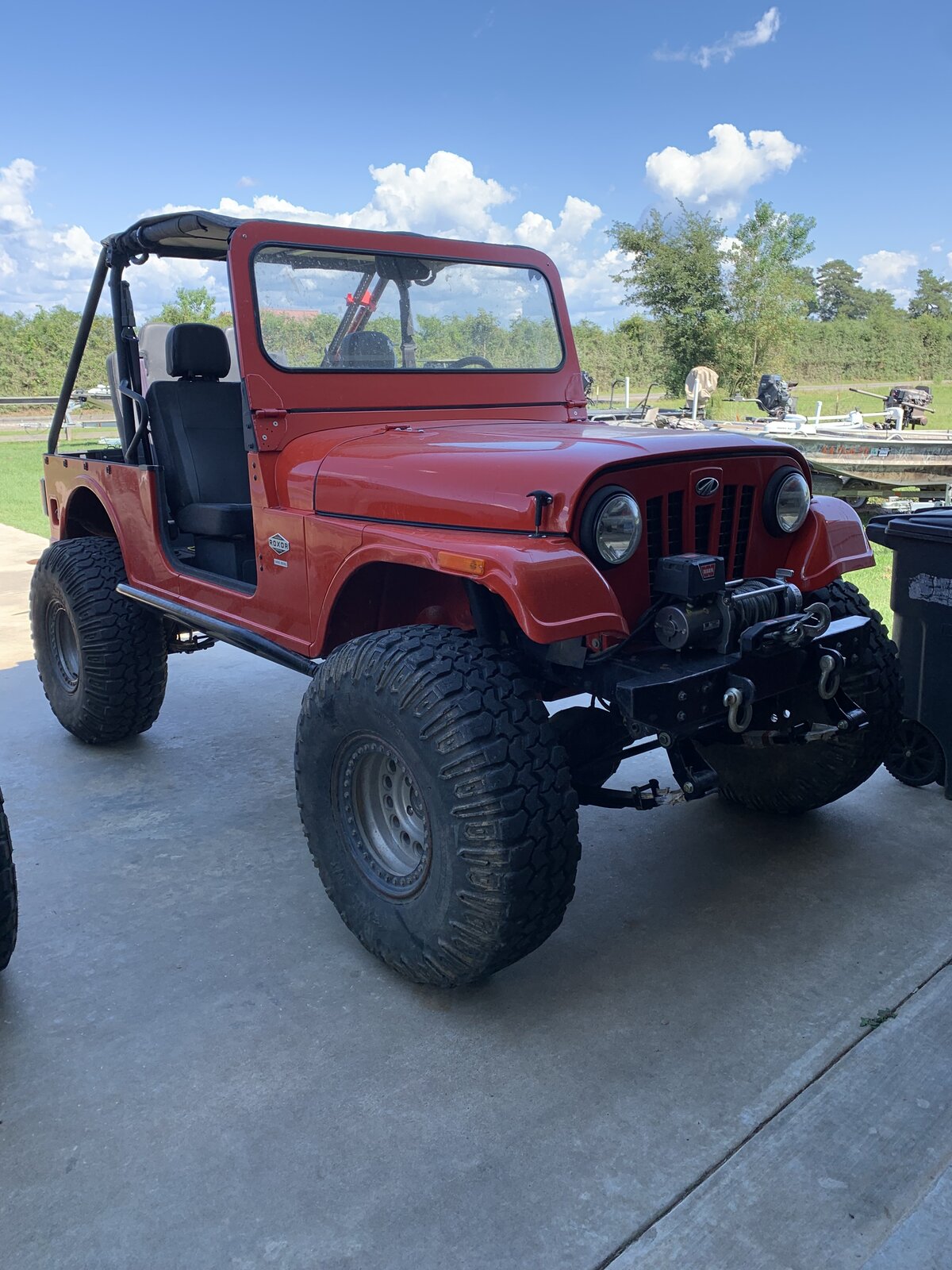

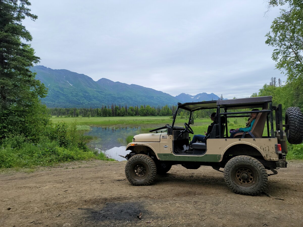

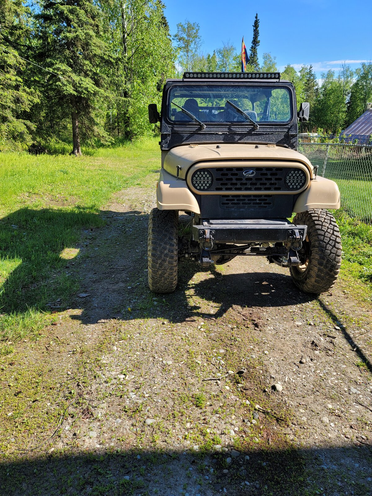

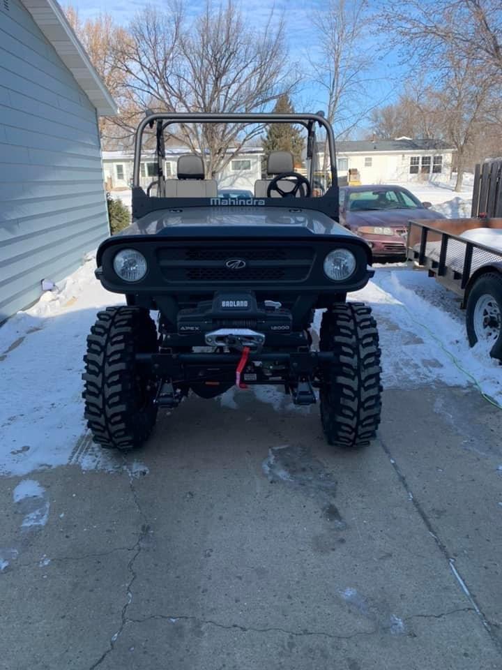

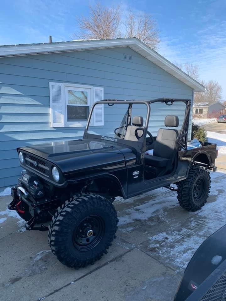

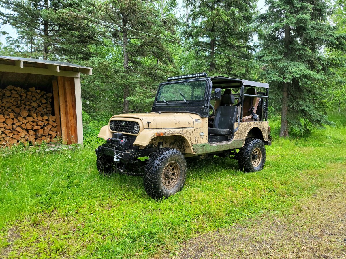

Can you guys with completed kits post pictures of your roxors? spring, tire, wheel, shock, and steering specs are helpful.
796
Rubicon Express 2.5 YJ springs
Bilstein 5100s, fronts are 33-104645. Rears are the same but too long, haven't figured out a solution for that yet.
Tires- BFG KM3 33x10.50x15. Wheels US Wheel 15x7.
796
796
Revised shock Part numbers for the 2.5 springs.
Front 33-19645
Rear 33-230444 (standard) or 33-185606 (stiff)
Thanks. Once I get the 60s on, I'll post those numbers when I get a shock length figured out.

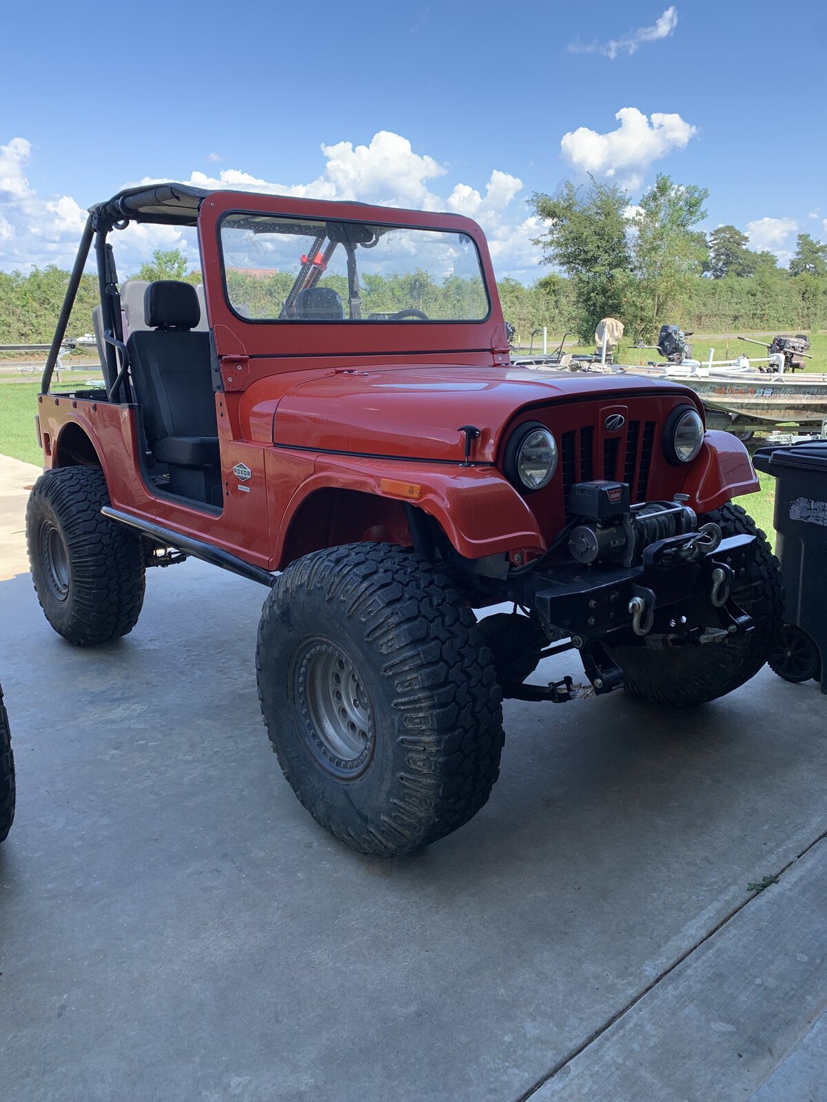

MaXXis85
Apr 23, 2020
38
Cleveland, TX, USA
03680
4.5” RE springs
37” tires
2” wheel spacers
Rear shocks are from a stock 1500 Chevy 4x4
I went with 12” travels up front with Ford shock towers.
watch the banjo bolt on the caliper with shocks in the stock location it will hit.
currently the stock steering works in this configuration. Slight dead spot from the tie rod roll.
I recommend bump stops. I have yet to install mine. I’ve bent all but 1 fender so far.

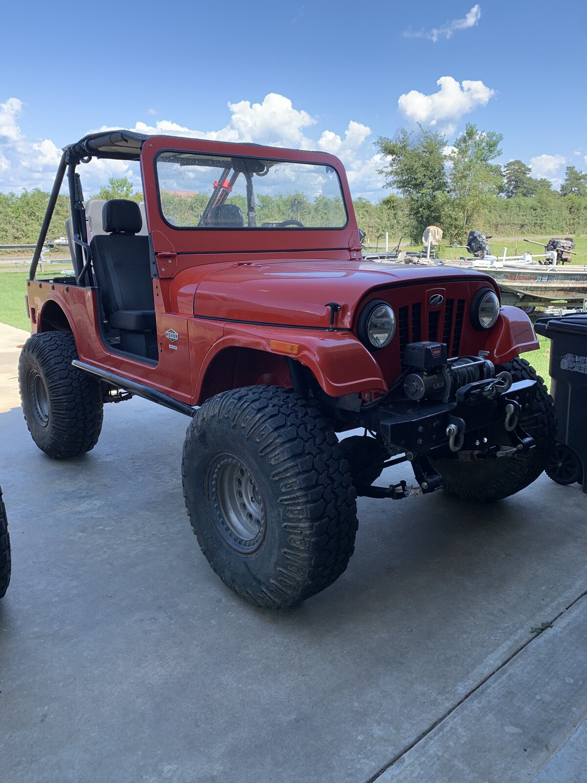

796
4.5” RE springs
37” tires
2” wheel spacers
Looks cool! How tipsy is it with the narrow axles being so tall?
