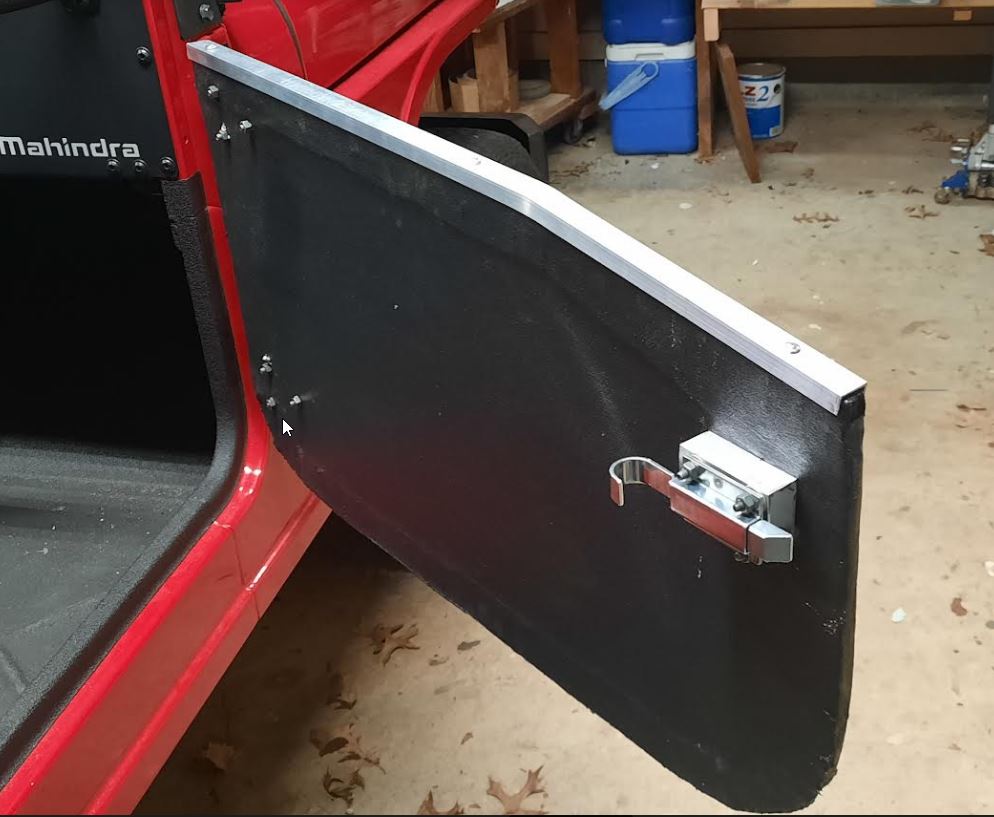

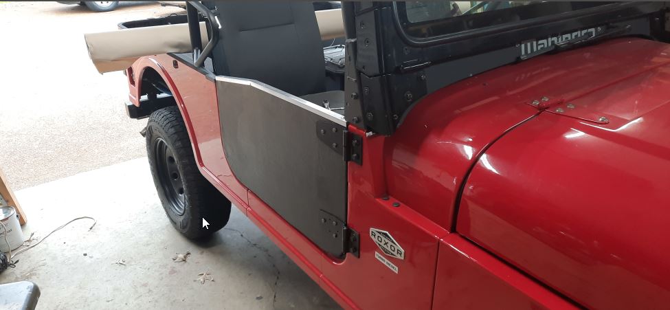

Hi All,
I know there are a ton of door ideas out there, and many are great but I wanted to try something I knew. I have built two homemade campers using "poor man's fiberglass" as siding so I decided to make my half doors the same way. For those who don't know "poor man's fiberglass" is basically 100 year old process of using raw canvas, glue and paint to make a waterproof covering... here are the results......

Works Great. The covering on my camper is 5 years old and still looks good so I figtured it would work for my doors.. I wanted the texture that the canvas provides, good UV and weather proof...... Very happy so far...

Not epoxy, it is titebond III wood glue. Look up "poor man's fiberglass" on you tube there are videos others have done. My camper has this type of exterior on it and it is still perfect 5 years in. Also the canvas must be untreated for this to work so the glue and paint can bond with it and the wood underneath.
Not saying it will work for everyone it just worked well for me... :}

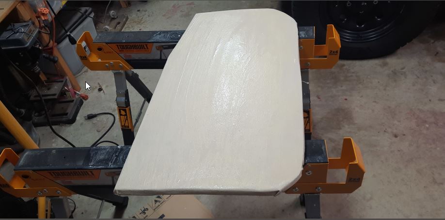

What did you use? Thin piece of plywood with the canvas over it? One of the videos showed using foam board with the canvas over it. Can you get a picture of the interior side.

Hi All,
I used 15/32 inch plywood as the base, I would be afraid foam board as the reason that the canvas fits tight is the glue and paint cause the untreated canvas to shrink and makes a nice tight fit. Plywood by itself might have been fine but the I like the grain of the canvas and it resists UV and water damage way better than plywood by itself....
Here is a picture of the inside of the doors.

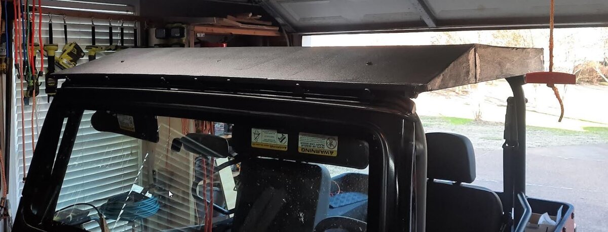

Not sure if anyone was interested but the poor mans' fiberglass on my doors worked so well I decided to do the roof also.. Here is a picture doing a test fitting. I still need to adjust the mounts and give it a final coat of paint but so far I am happy with it.
