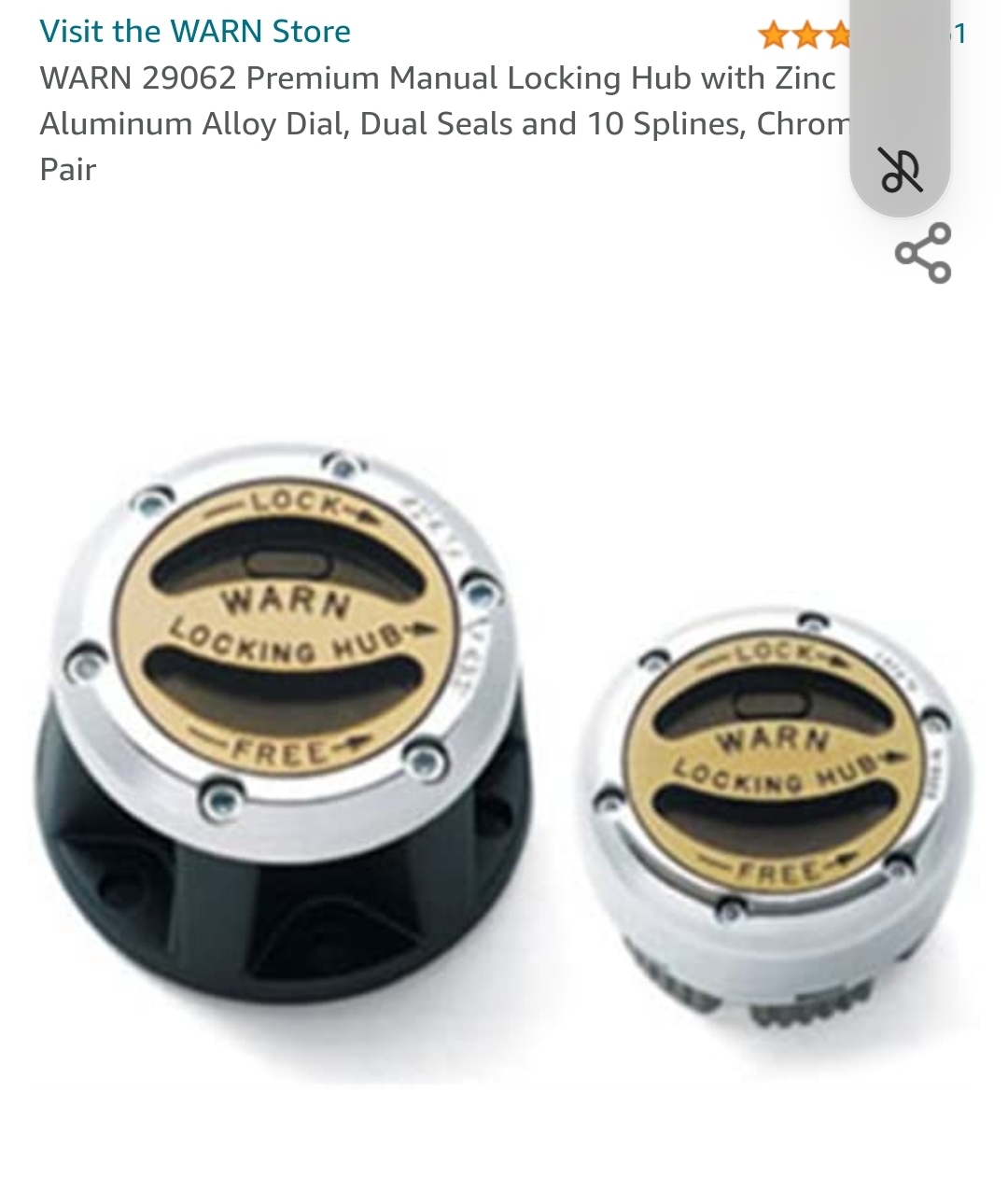

Thanks for the answers so far folks. I really appreciate it. For the hubs, that seems like a great thing to do if I'm driving often in 2wd. Is the part number for Warn 29062? That's what I've found, but it doesn't list Roxor in the fitment. Thanks for any info.

I don't remember the part number for the locking hubs. But it definitely turns better with them unlocked. I'm Shure the 22 still has a 45mph speed limiter on a stock tune. 500 miles would be a long drive with the crappy stock shocks also.
2,099
Here is the ones from Warn

You can easily install the hubs yourself. The hardest part is removing the stock center caps without scratching the wheels.
if you look around this forum, you will find some posts. There are also videos on YouTube just for the Roxor if you look for ‘Roxor locking hub installation’ or something similar.
2,099
I Posted a video on here on how to do it. If you would like let me know, and I can post it here
1,123
While your that far into the axle adding the hubs go ahead and remove the entire hub assembly and repack those bearings. Most likely they will need it, even if brand new.
