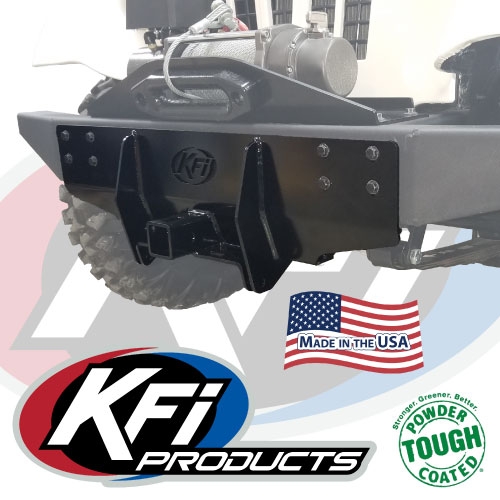

I have a ½ mile long gravel driveway that I need to plow every winter. Based on the group’s experience, what would be the best plow setup for the Roxor? I am thinking the winch raised plows are too fragile for what I need to do. Also, I have an OTR front bumper without the 2 inch receiver hitch. From photos on the web, it looks like I need to remove it for the winter to attach the plow mount,as the welded on D rings are in the way. Any opinions?

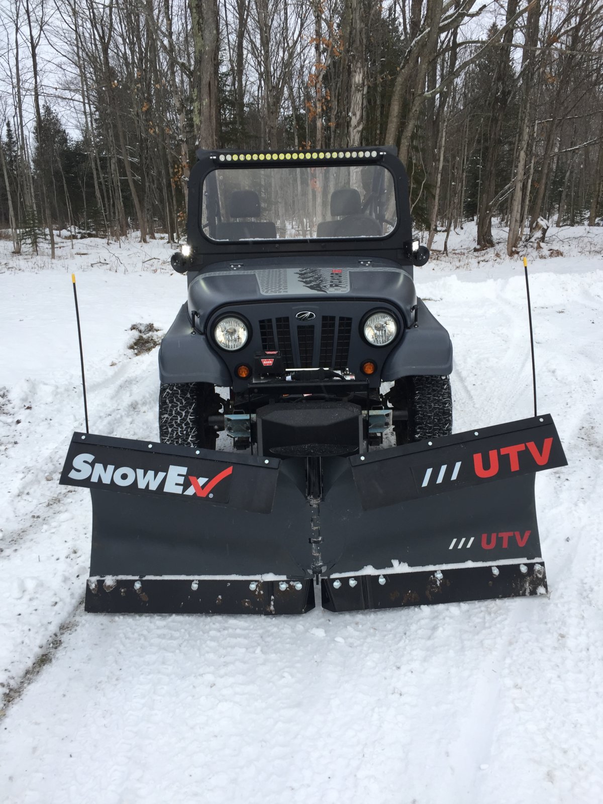

If cost isn’t a concern go with a plow from Western,Fisher or Snow-ex. They are the same plow just painted different colors.
The best (and most expensive) is the V-Plow set up. I just posted pics and video of mine in another thread that was just started. Same plow as above.

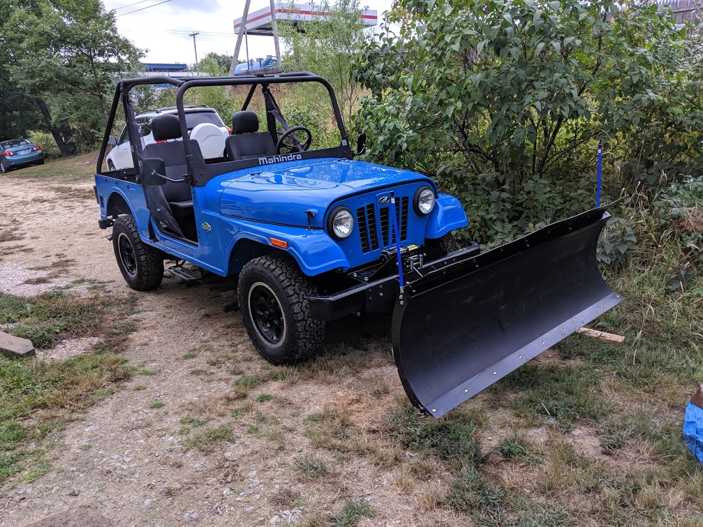

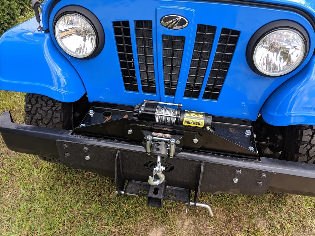

JimR, it sounds like you added the winch when you bought the plow. I already have a winch on the Roxor, so that would be half the battle, would just have to get the mount, push tube and the blade. The mount attaches to the push tube, which mounts to the blade?
Yes it does

How long did this take you to assemble? Did you have to drill anything? Great setup. As much as I would love the v plow, it ends up being around 3-4x as much and it is tough for my situation to justify. Let us know how it works out of you when you get to use it.
I used it all last year. I have the video on YouTube and the other snow plow thread.
The install instructions are on the Roxor webpage. It explains it best. Takes a couple hours initially, once the drilling is done, it only takes 15-20 minutes to put everything back on if you remove it for summer like I do.

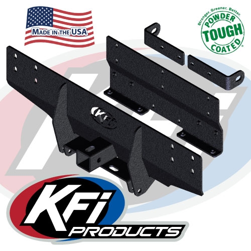

I considered the v plow too, but ended up getting the KFI plow because of the price difference. Especially since I will only be plowing my driveway. It only took me about a little over 2 to 3 hours to install the setup. I had to drill four extra holes in the bumper and I also trimmed the top of the bumper so the winch mount plate would fit without overlapping it.

Ok thanks JimR. I have the factory winch already. I think I am going to replicate your setup, unless I can find a deal on a used v-plow in the next couple weeks. My only hesitation is I want to use the plow for my driveway, but also for ice fishing. Last year we had so much snow on our lake, the v-plow would be ideal as you can just make one pass for a quick roadway.
