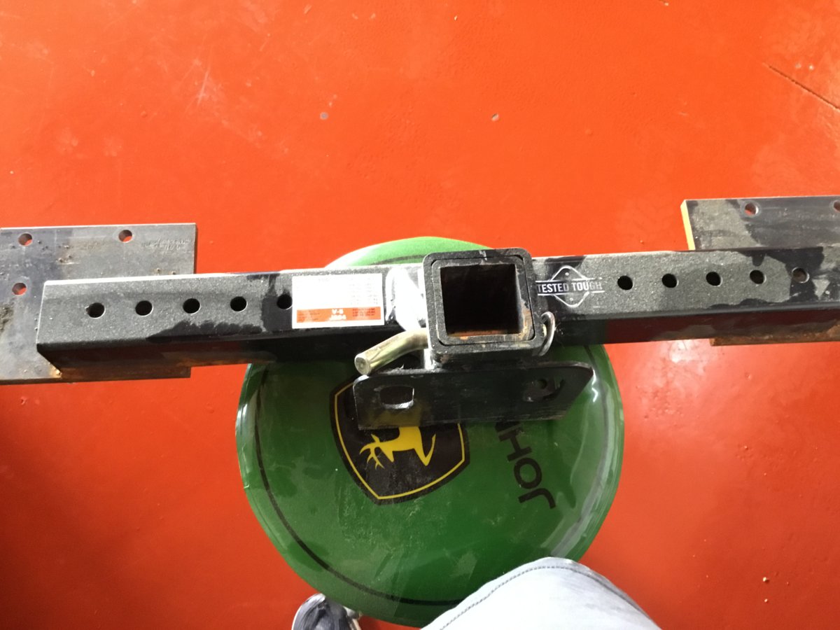

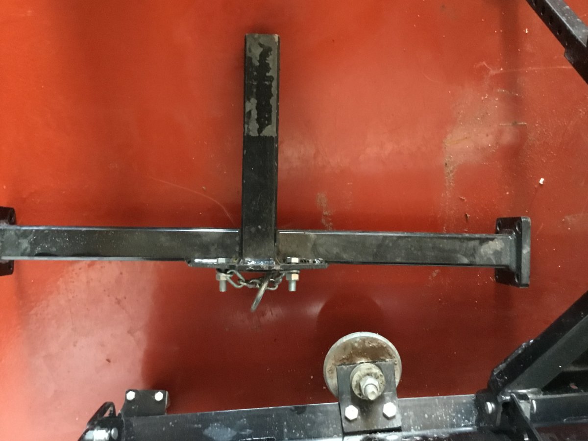

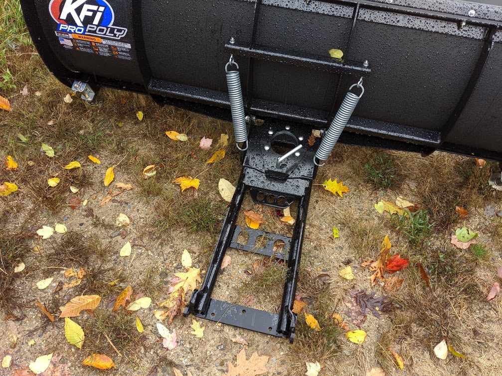

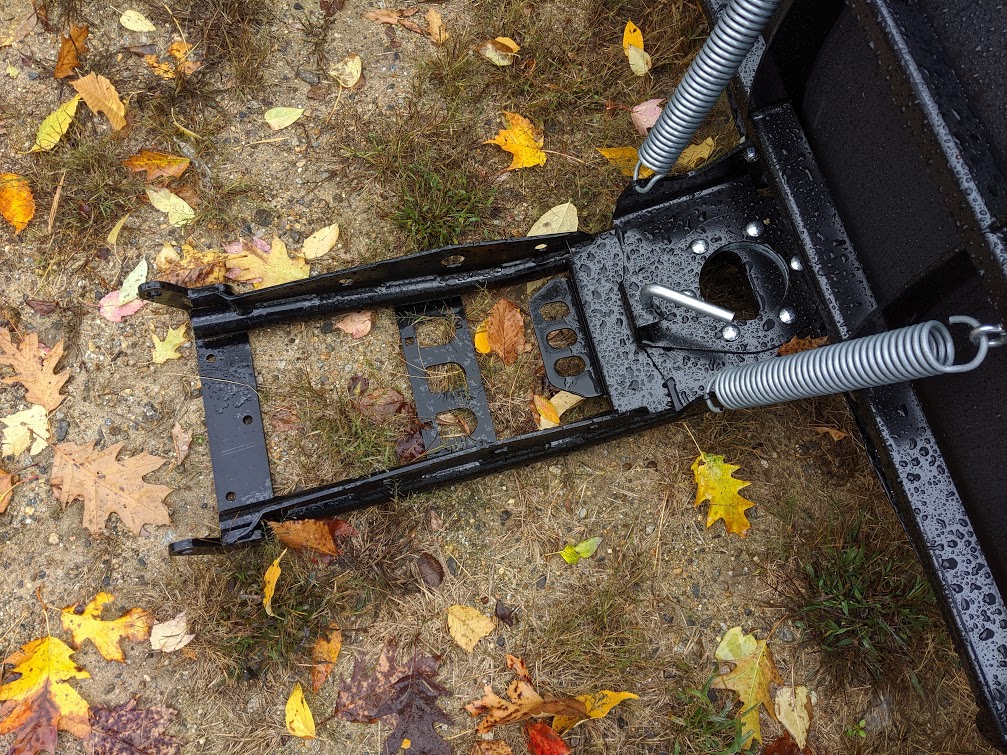

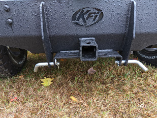

Im also thinking bout this as i have an extra blade and a winch mounted already. Can you post pics of the push tube? I think that part and the bumper mount are all i need.
MikeT
Jan 27, 2019
128
Montpelier, VT, USA

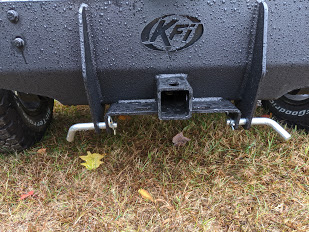

Thanks..What Im not getting is how that fits into the KFI 2 inch receiver. There has to be another part right?
JimR
Aug 18, 2019
Greenville, NH, USA
The 2 inch receiver on the KFI mount is not used to mount the push tube. The push tube is attached to the mount using two pins through the holes. These pins came with the push tube. No other parts needed
Sweet, that's a better set up that just the push tube and gives you the front receiver if you need it.
Edit: thanks fro posting that JimR, it makes more sense. I have the big v-plow, which I love, but for someone looking for a more economical plow, this looks like a good setup and way cheaper than buy the $900 mount from Roxor for the same plow.

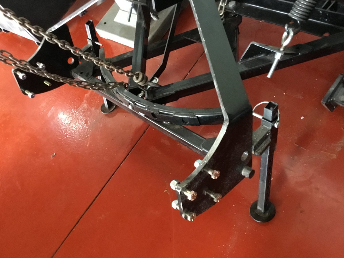

My Snowbear is set up this way...( those Canadians are crafty )
B3FDEC6E-9F6B-4AA9-B98C-4B1A6B07D693.jpeg 5BB025BF-37B0-4555-8B28-A1F93CAF0543.jpeg C6D0E919-C959-464A-BD70-E9F024B206C1.jpeg
DLR
Nov 24, 2018
72
Central PA
001176
There's a plate towards the front of the push tube with 3 holes. I used the center one
