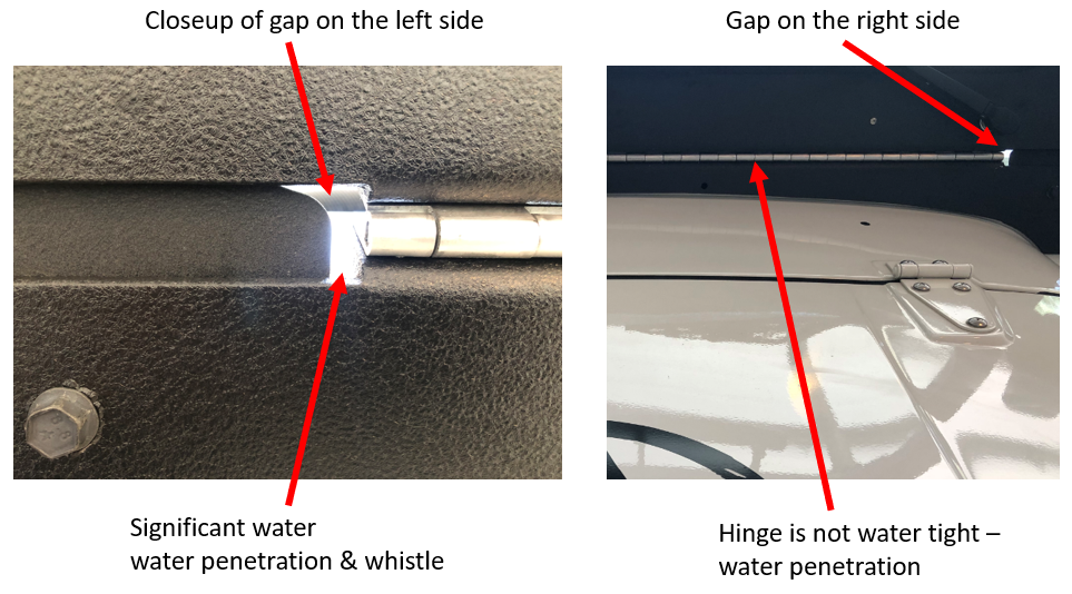

Yes, there is a at least 1” by 1 1/2” gap between folding windshield hinge and the OEM structural frame. This causes significant water penetration and an irritating whistle. The hinges are also not the kind that are water “proof” (sealed), so if you drizzle water over it, it seeps through to the cabin and if by chance you drive in the rain, you will have water penetration as it happens with me.
I am very hopeful that this design flaw will be fixed by OTR as it is an expensive product and one expects it to work properly but of course value is in the “eye of the beholder”...
Stay tuned!

The hinge looks like what I believe is called a piano hinge. I imagine it'd be hard to waterproof without a different hinge.
Disappointed to hear about the fit and the whistle as this is the frame I'm most interested in.

I have a OTR windshield and it does not whistle. I have weather stripping all the way around the windshield. Have not had it out in a rainstorm, so I cant testify on the water intrusion. I believe the weather stripping will help. BTW the fj40 "latches" are very nice. Folding the windshield down requires no tools. Make sure they are snug. I was on some rough roads this weekend and had to snug them up a little to keep things tight.
Stay tuned!
I wonder how much variation there is from rig to rig. Could the gaps at the sides be related to year model or possibly the nature of the manufacturing process? I've read/heard elsewhere that there is some variation from rig to rig as far as overall fit and finish.
