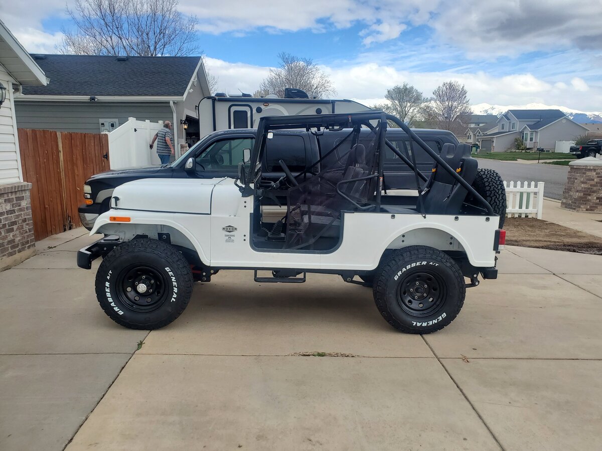

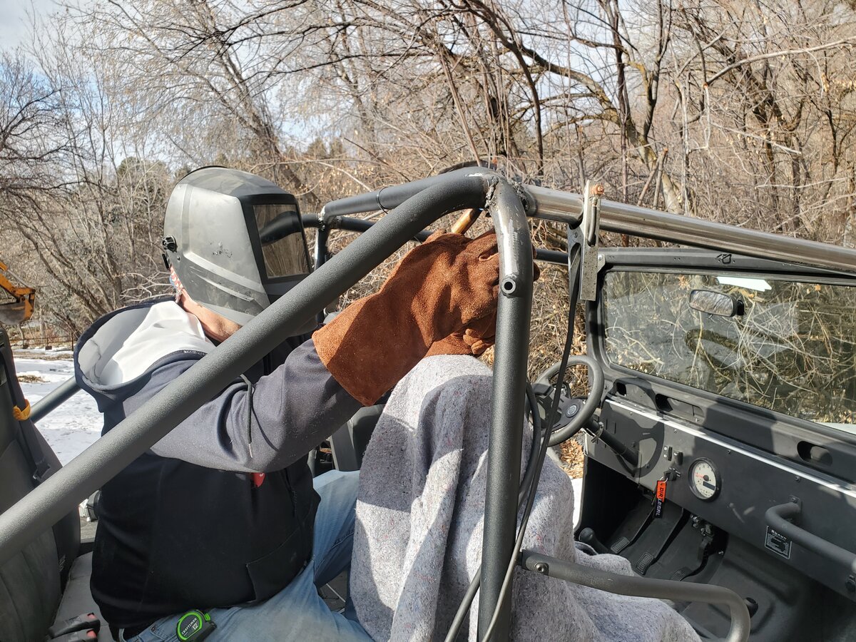

Most windshields have clamps that are relatively easy to remove.
809
I'll take more close up when I get home

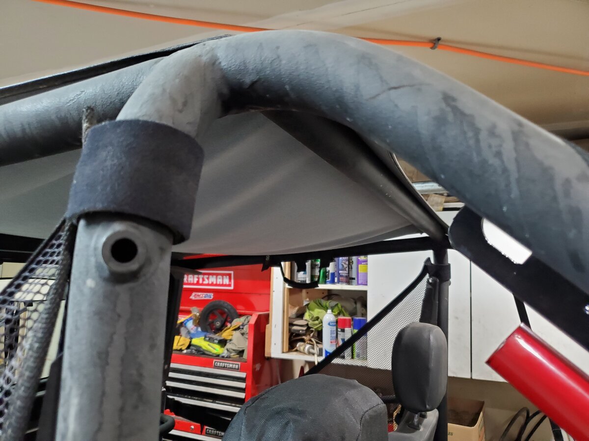

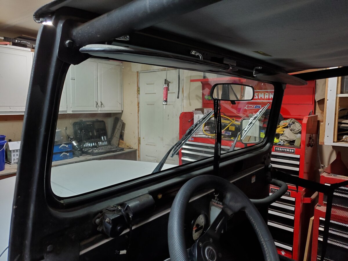

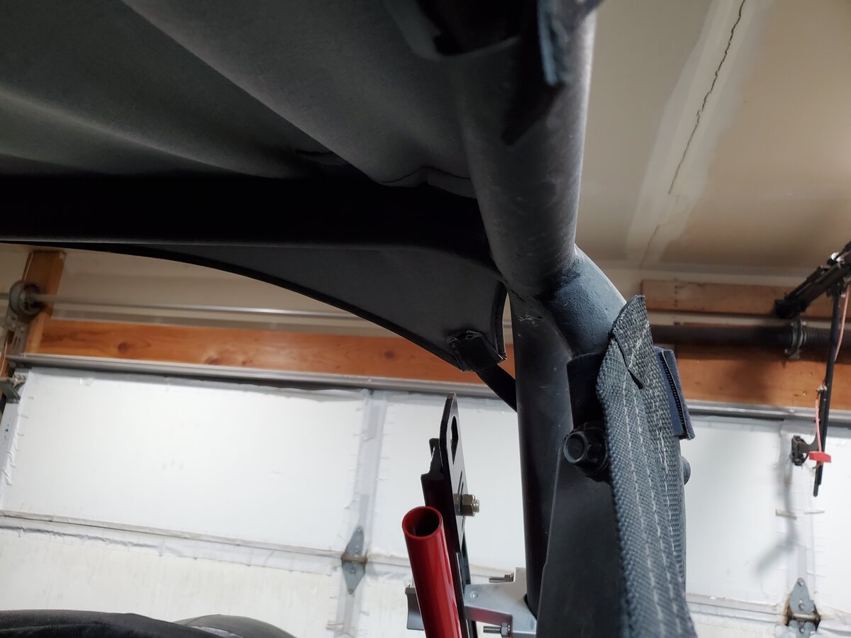

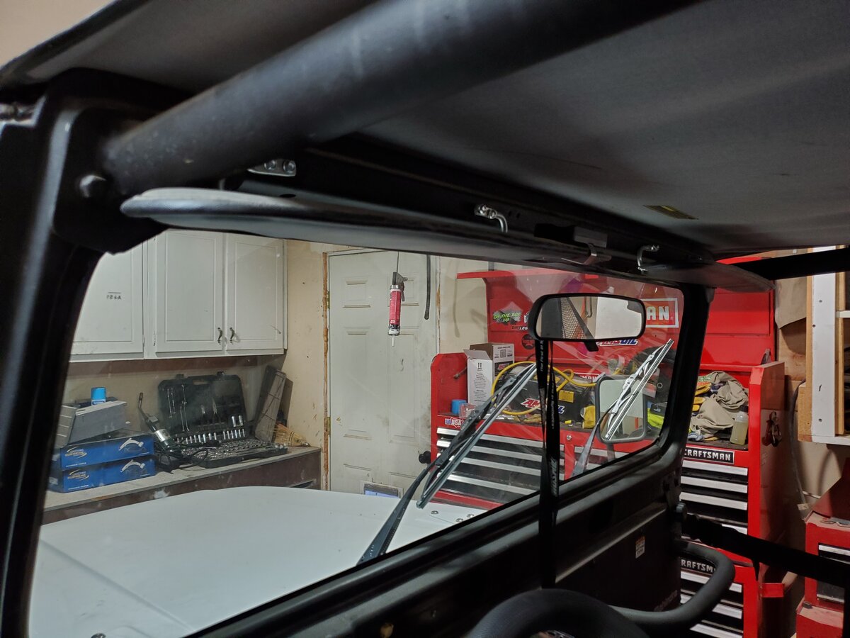

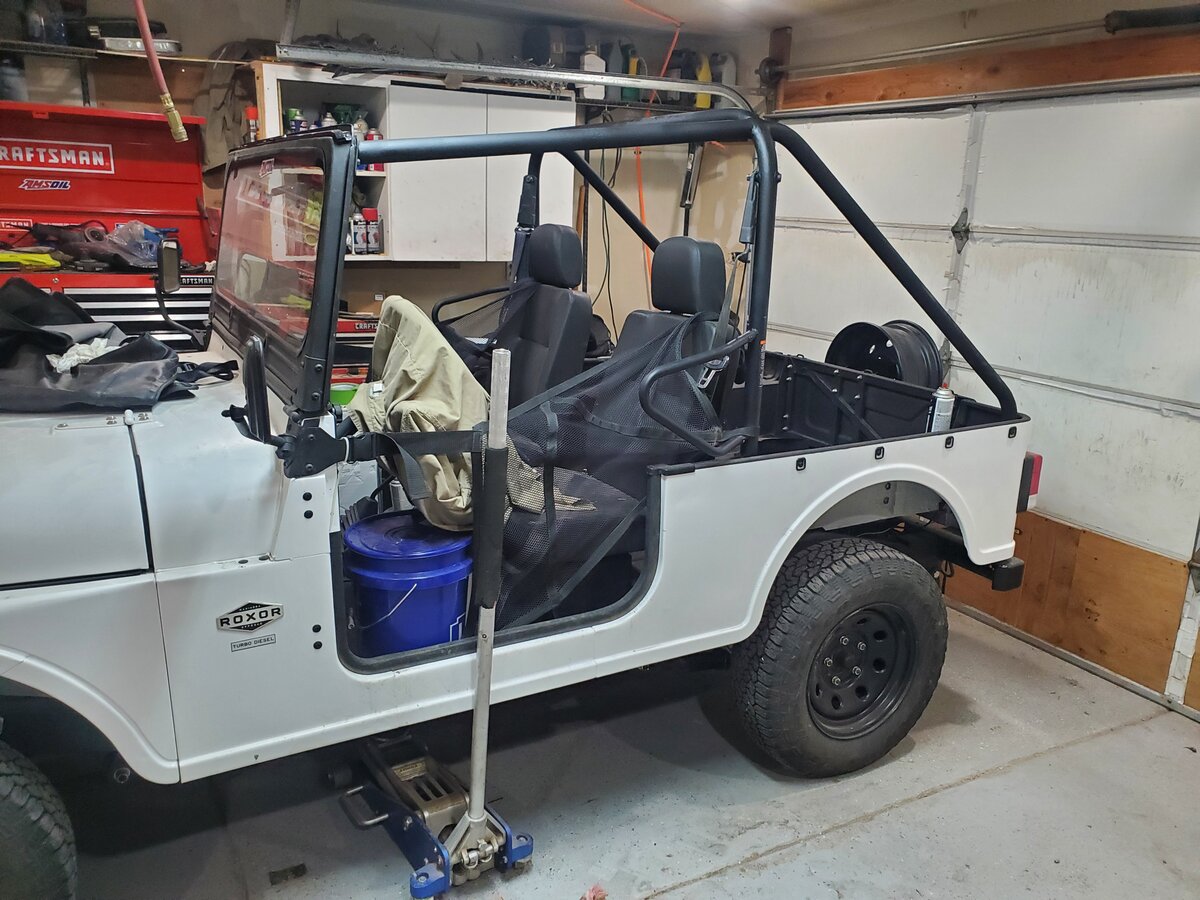

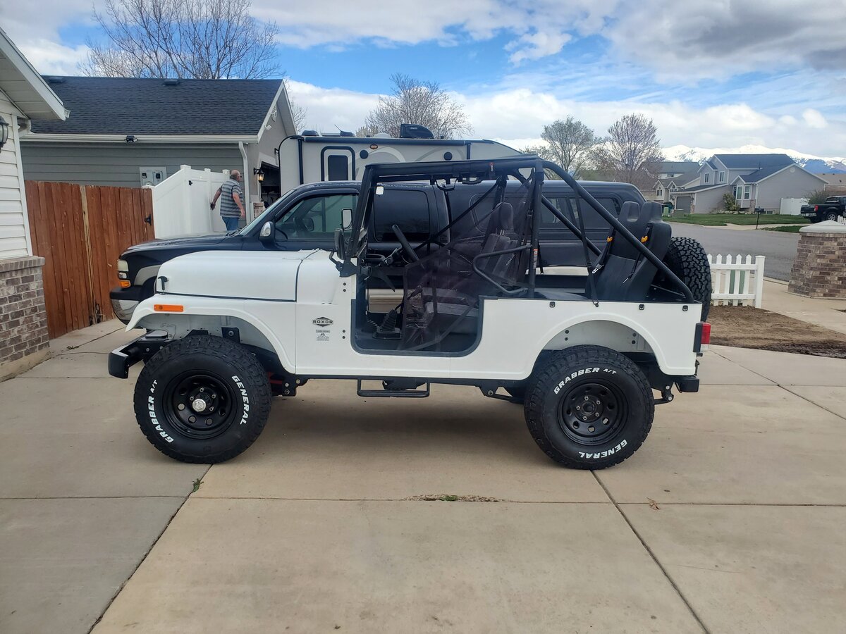

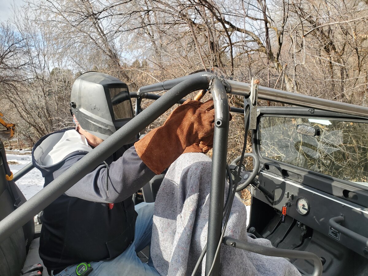

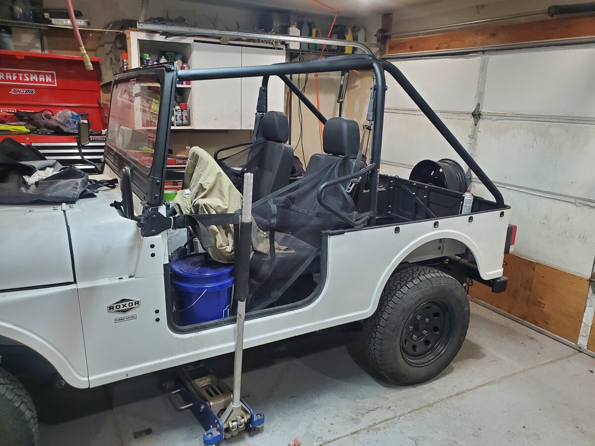

809
95 wrangler windshield. Made it nice I made brackets to bolt to the windshield. Had already threaded holes in windshield. Remove those bolts and it will fold. Top would have to be removed since it's a CJ7 bikini top. Used the windshield channel to mount top
