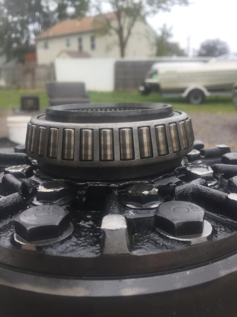

I’ve had 2 major failures so far. One of which was my fault, the other I can place blame elsewhere.

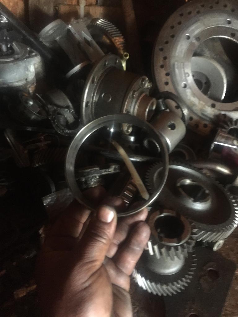

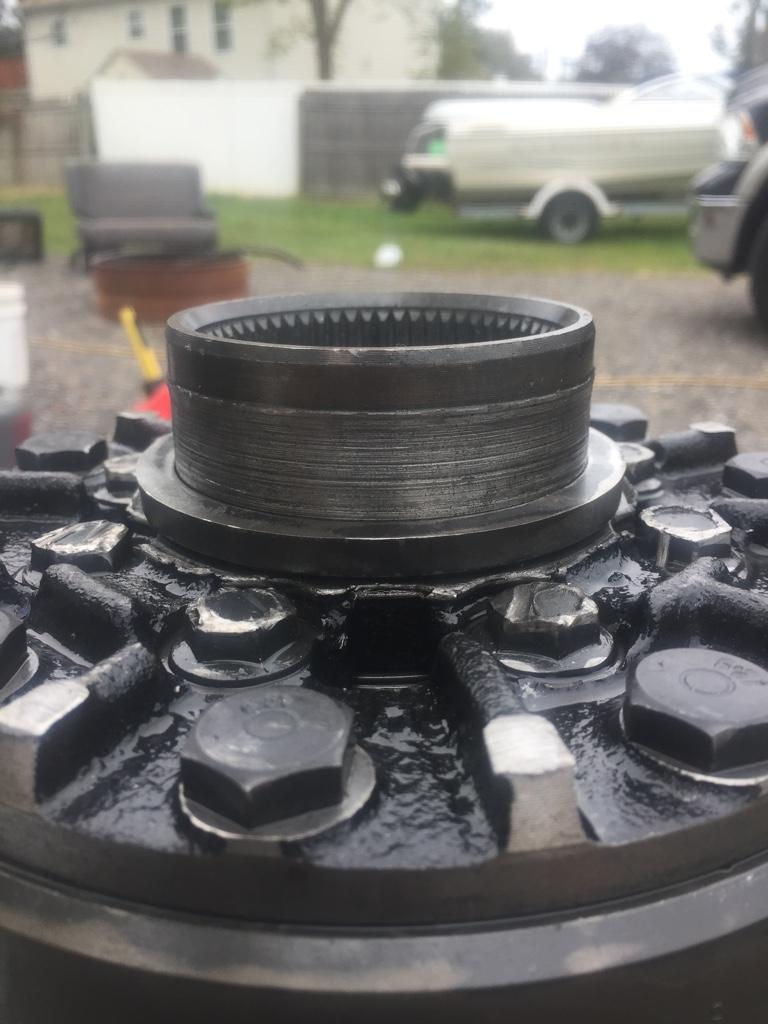

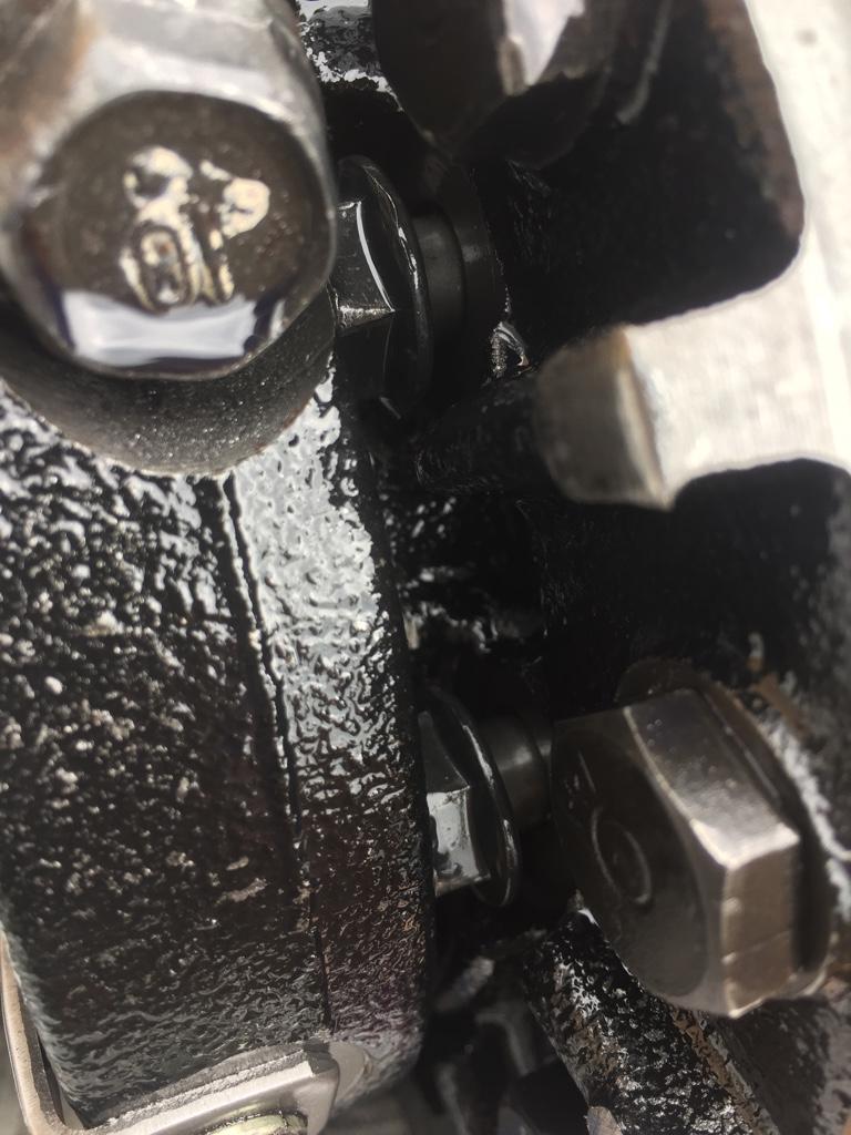

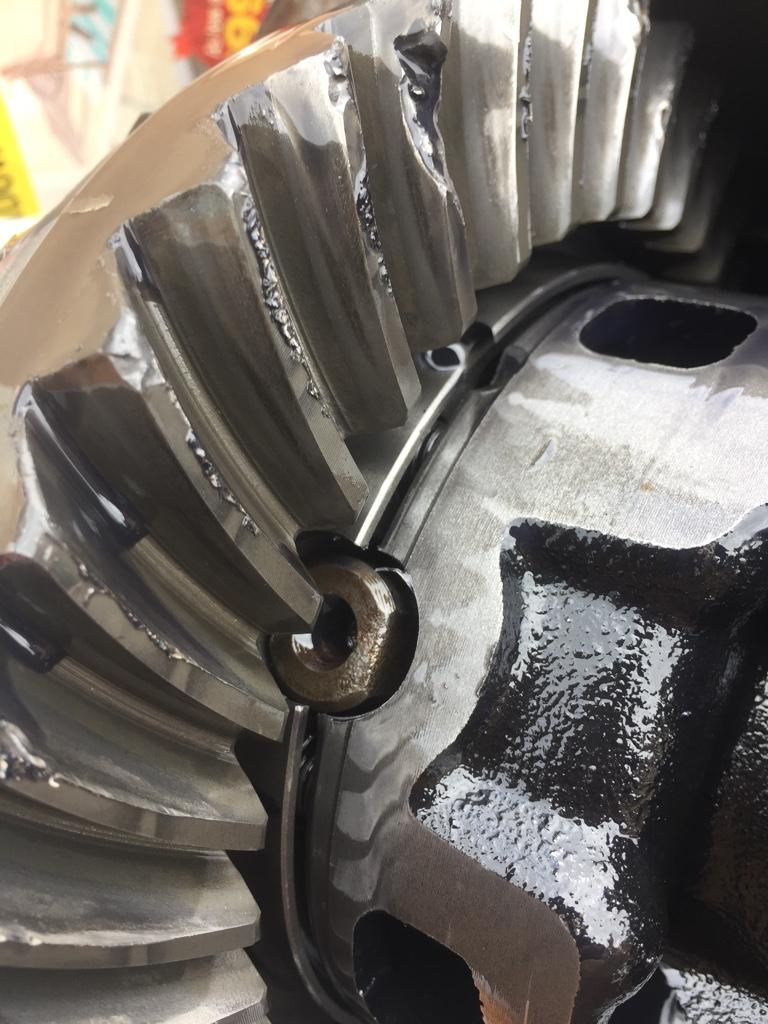

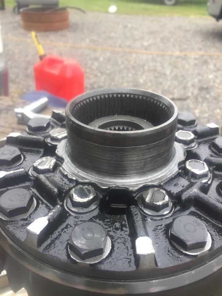

I blew up my rear differential. This was a used differential that came out of another rig. The carrier bolts came loose and began the chain reaction leading to the self destruction. I was able to re assemble it with random parts from my parts piles temporarily until the new diff is built.

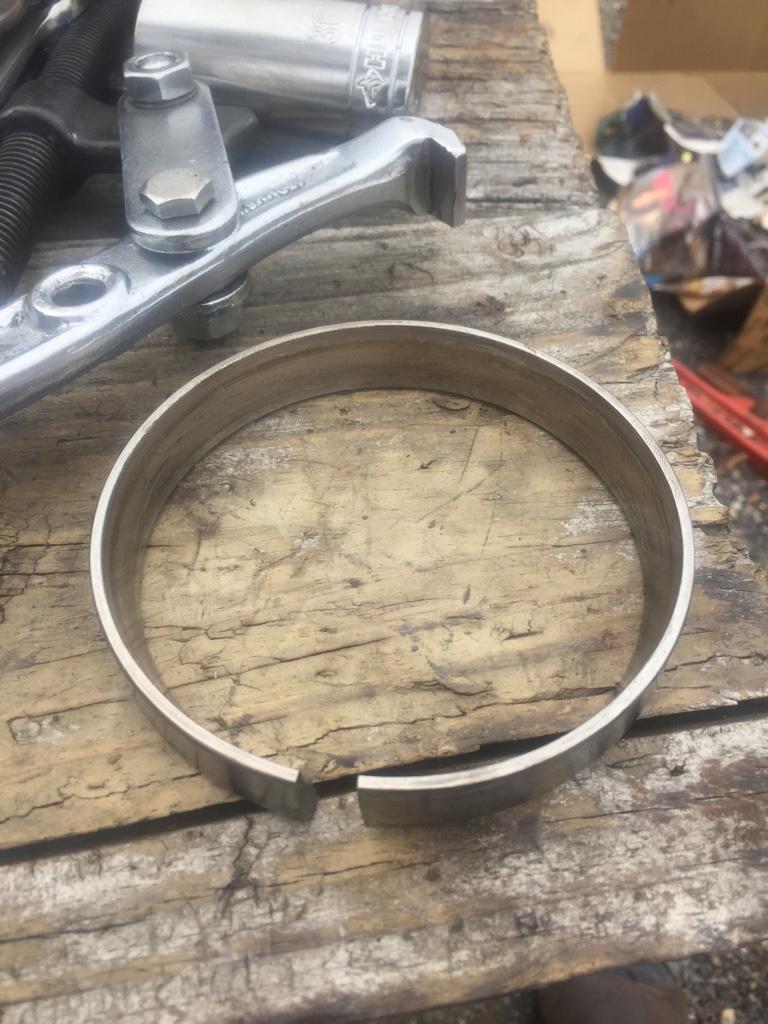

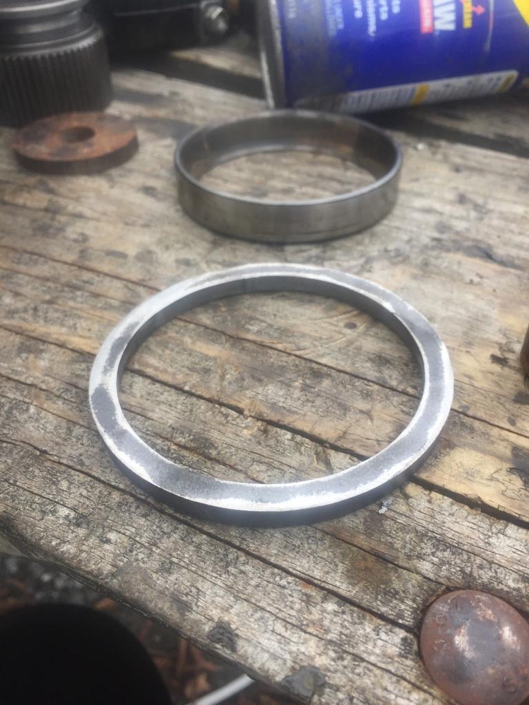

I cut a shim on the plasma table to space the bearing back out from where it had spun down on the carrier and found new bearings in my pile of parts.
I re patterned the gears and installed it back in the roxor and it’s held up for now but it’s just temporary until the new diff build is finished.

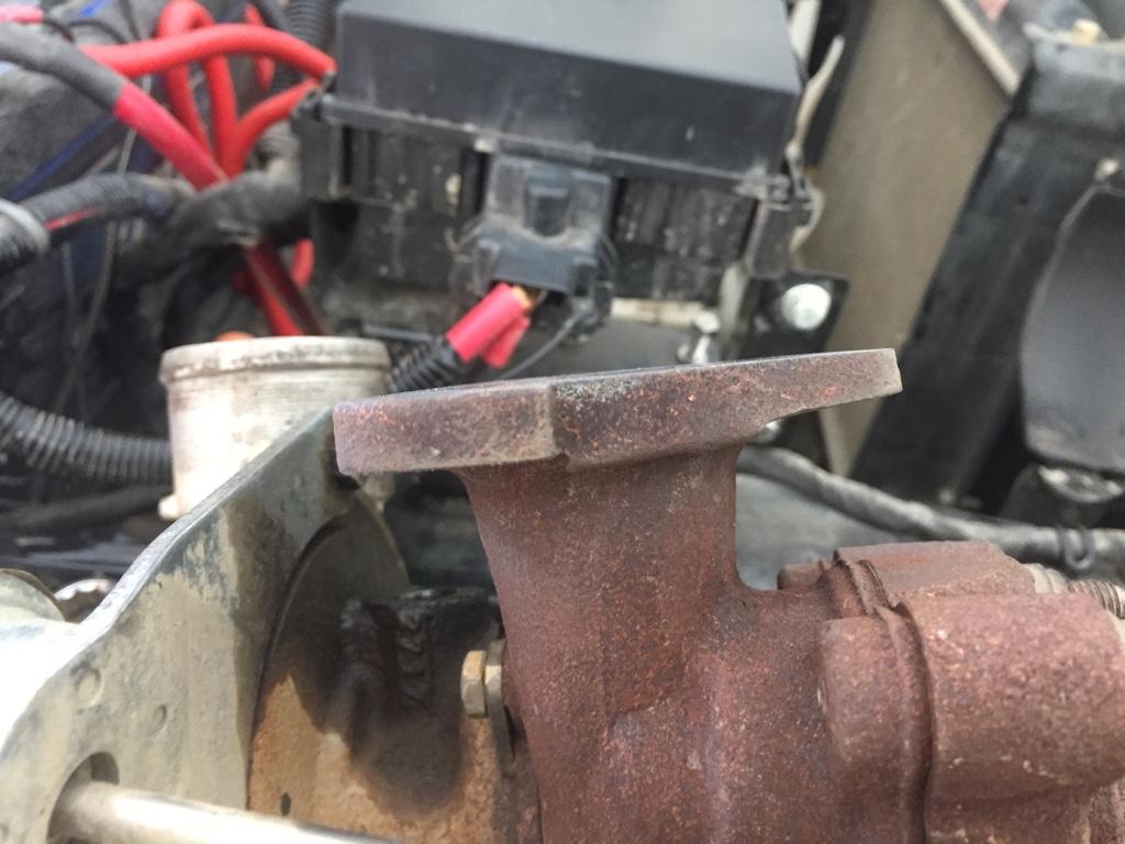

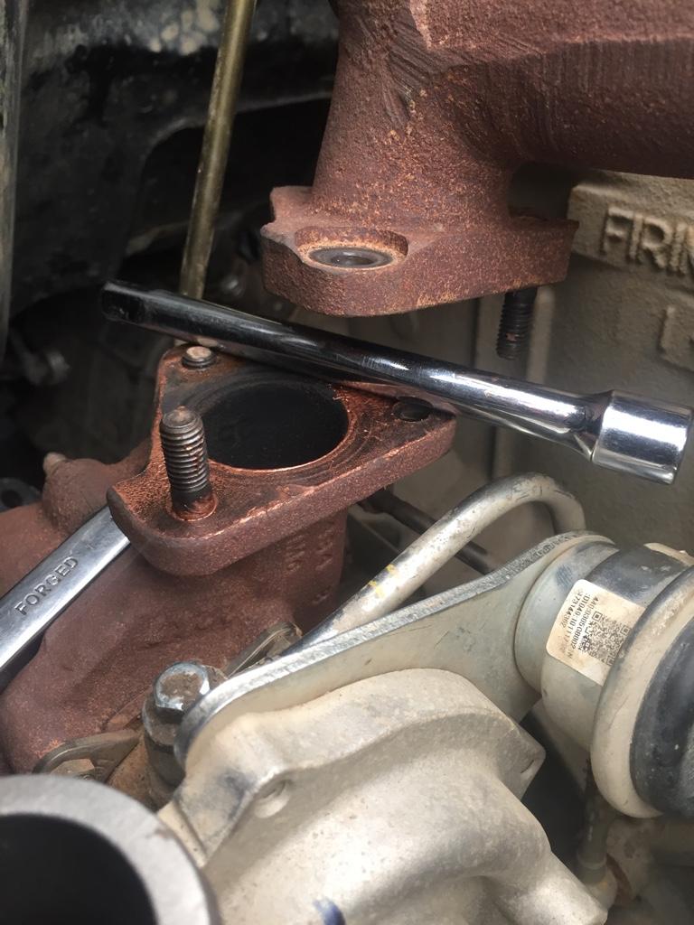

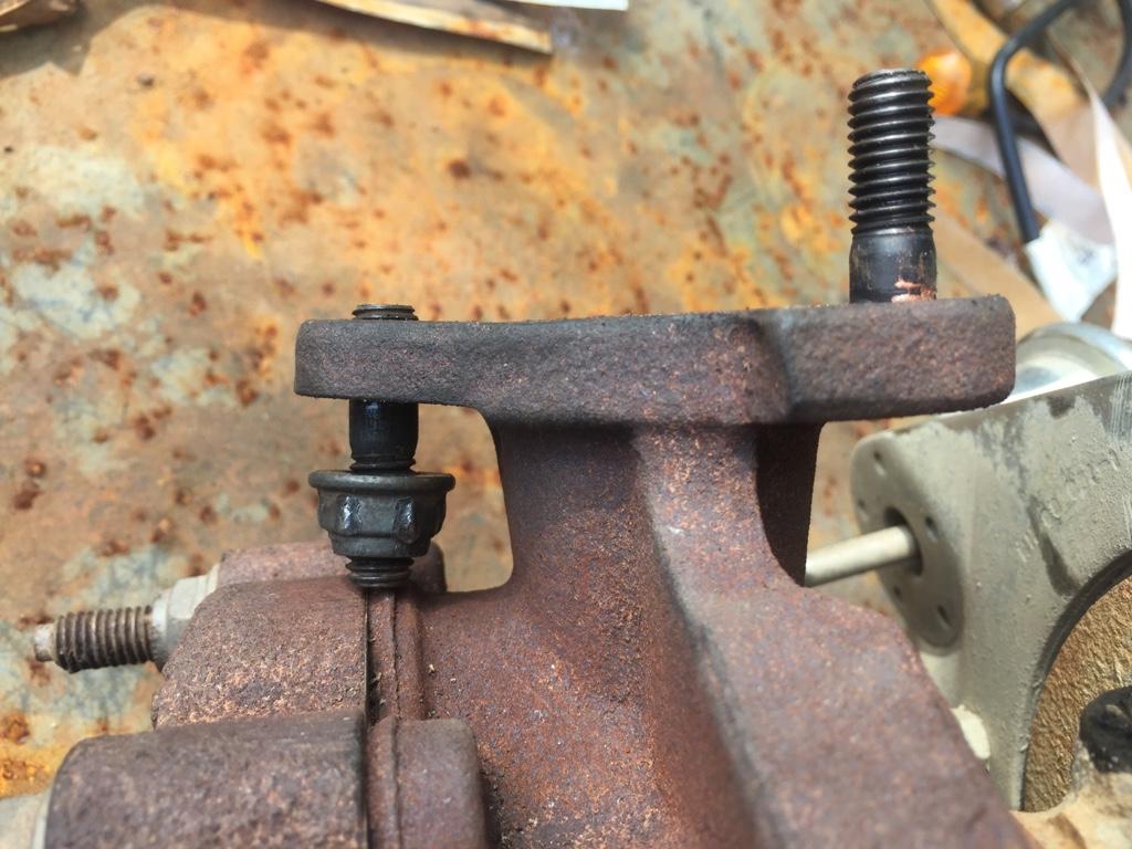

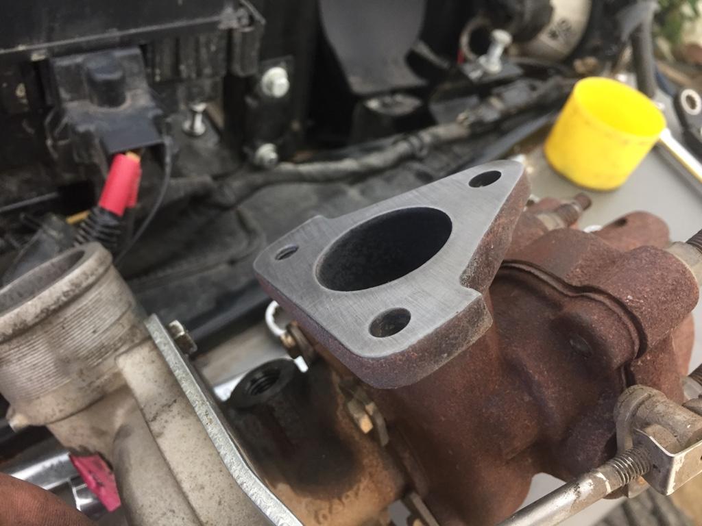

I smashed my exhaust pretty good backing up into a rock. It grabbed it and pushed everything forward.... and at the end of the line was the poor little turbo exhaust housing. It warped the flange and created a leak causing the turbo to spool slowly and make terrible noises.
My next exhaust will include a section of flex pipe to take any and all strain off the new turbo.
I cut a shim on the plasma table to space the bearing back out from where it had spun down on the carrier and found new bearings in my pile of parts. View attachment 7736

I smashed my exhaust pretty good backing up into a rock. It grabbed it and pushed everything forward.... and at the end of the line was the poor little turbo exhaust housing. It warped the flange and created a leak causing the turbo to spool slowly and making terrible noises.

Solid duct tape job on the diff! I bet that will actually last longer than you'd think lol

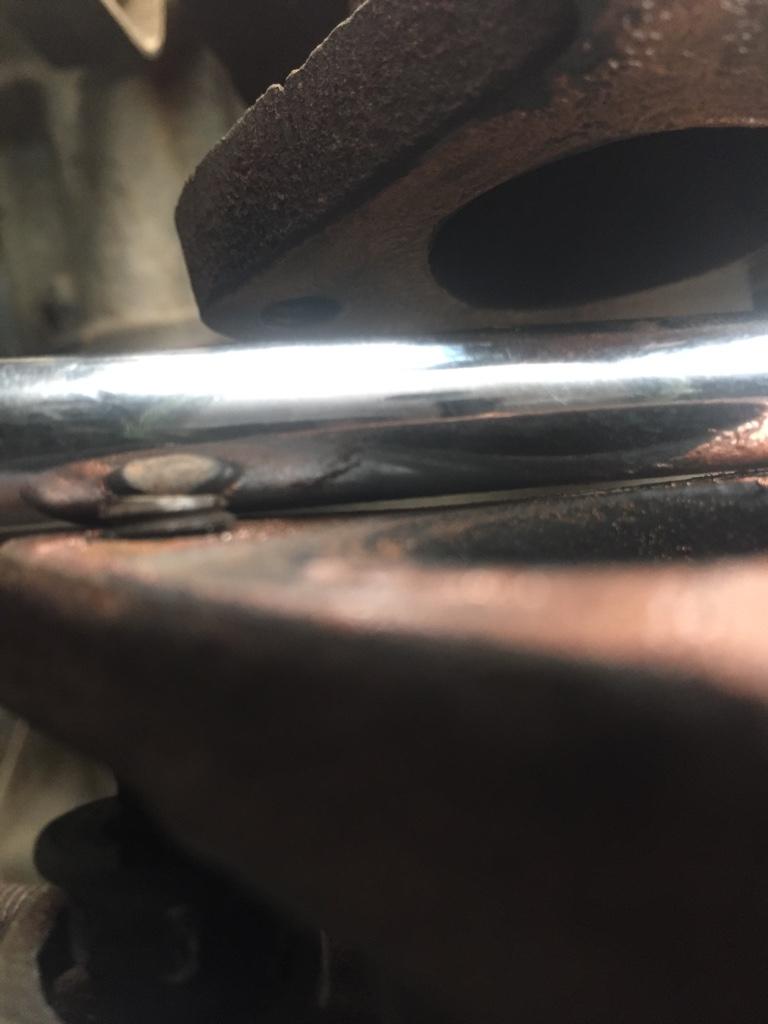

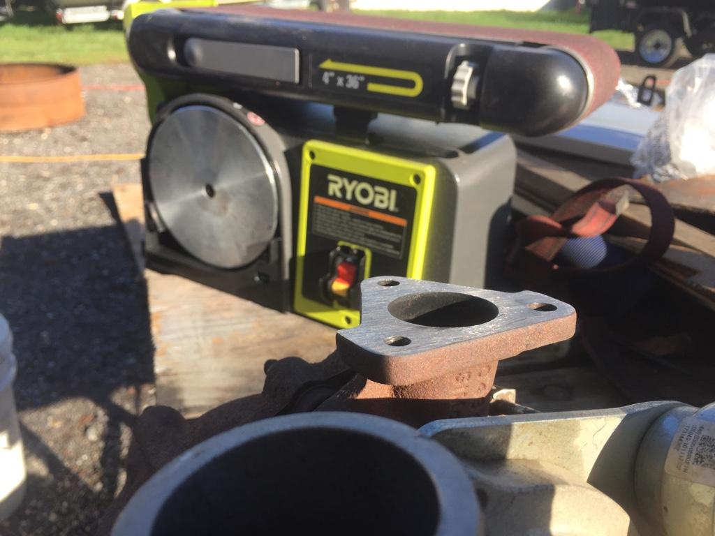

In the mean time i have to have this thing ready to go by tomorrow night so I took a trip to homedepot and bought a cheap bench top bent sander and very very carefully “machined” the flange back flat. It will work for a weekend but now it’s even thinner and even more prone to warping. Just needs to last me 2 days.... I guess I’ll have to take it easy.... nahh .
1,304
My thoughts was to put a corresponding bolt pattern in some solid iron or welding table set up and then then bolting it down and heating the flange with a torch and slowly tightening the bolts and slowly work it back to straight. But machining works too.
