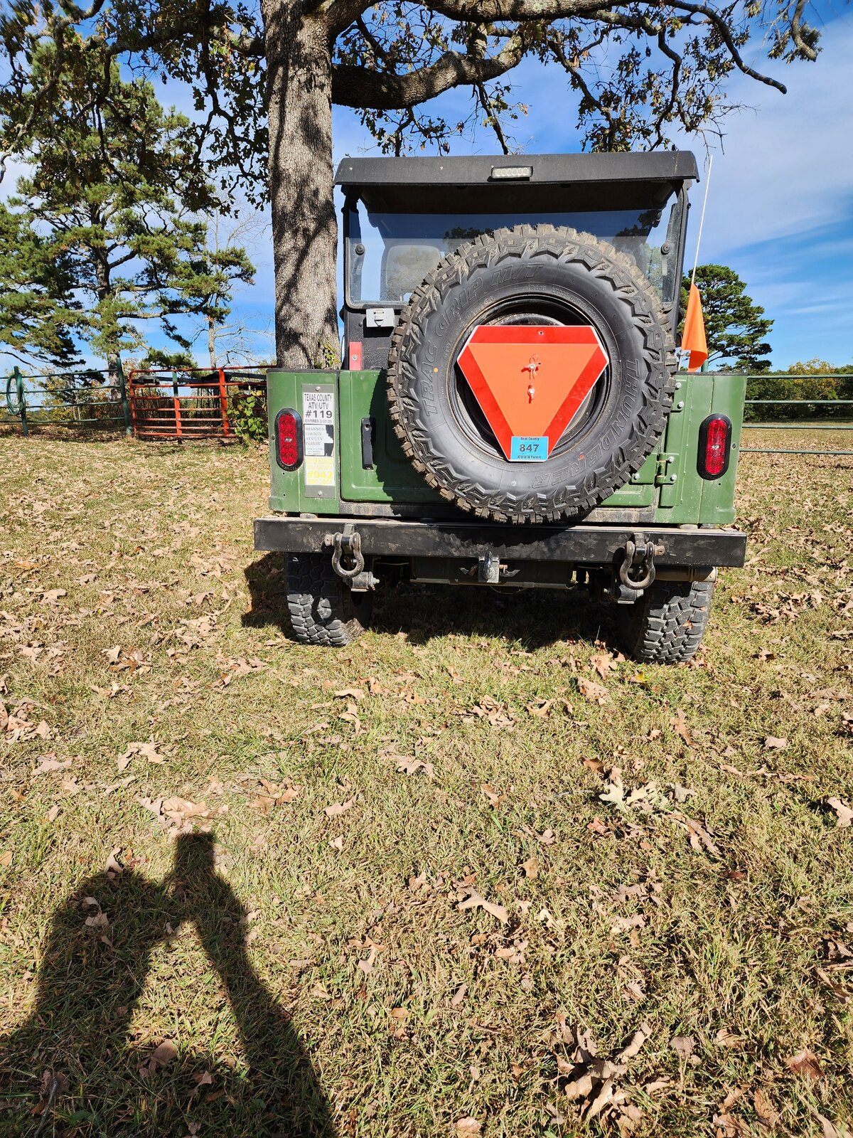

I got the Frame Tie in bars installed on the Cecco Farm Bumper today.

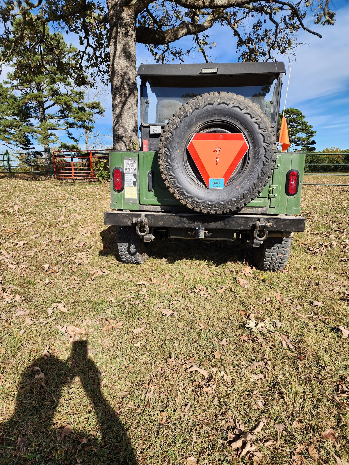

I installed the D-Shackles on the back bumper using small rings of 1" Heater Hose for spacers. I have had the Heater Hose Spacers on my Jeep MOAB D-Shackles for years.
I installed a Hook in the Reese Hitch for pulling things from the rear.

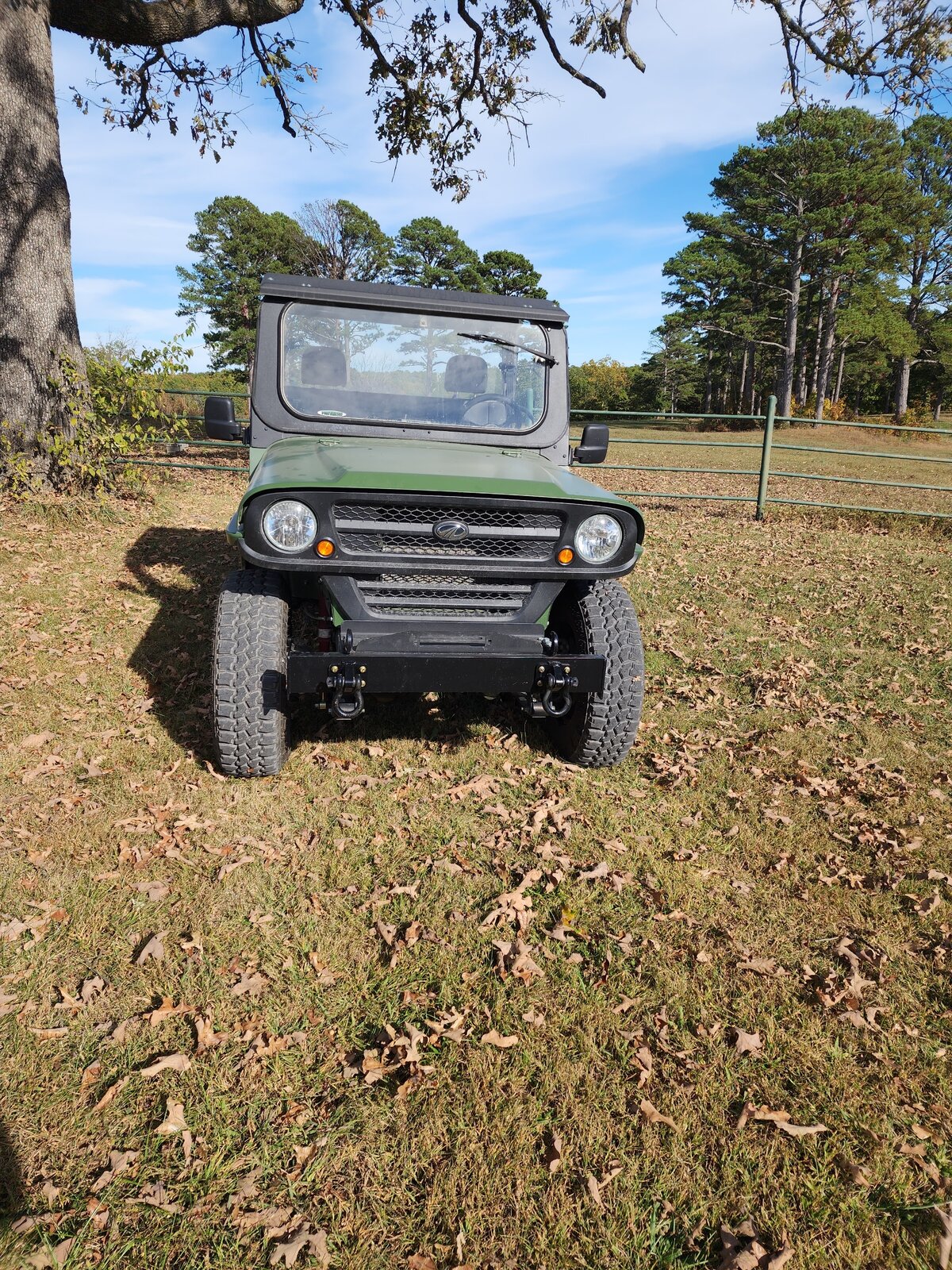

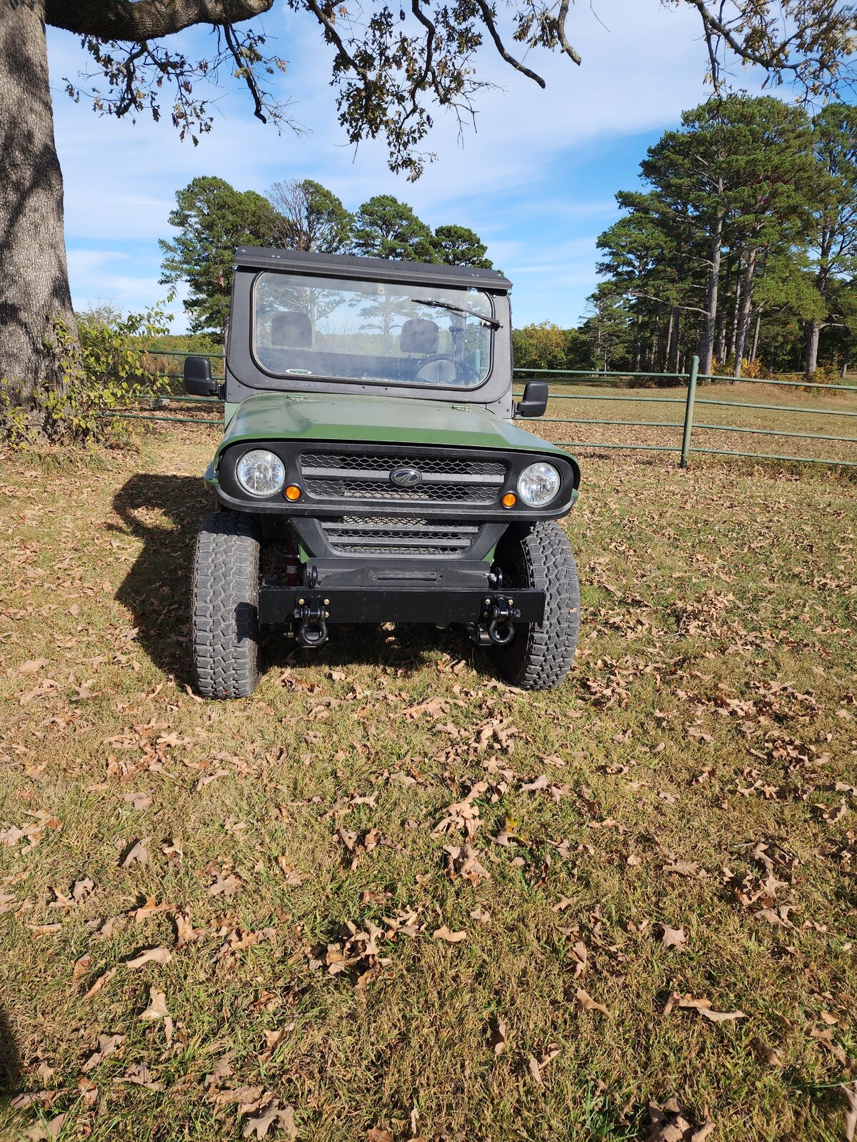

On the Front End I installed the Cecco Front Bumper Clevis Mounts, as well as the 7/8" D-Shackles. I also installed the 1" Heater Hose Spacers on the front shackles.
NOTE: The front Bumper Bolt Holes need the threads cleaned with a 10mm 1.50 Tap.

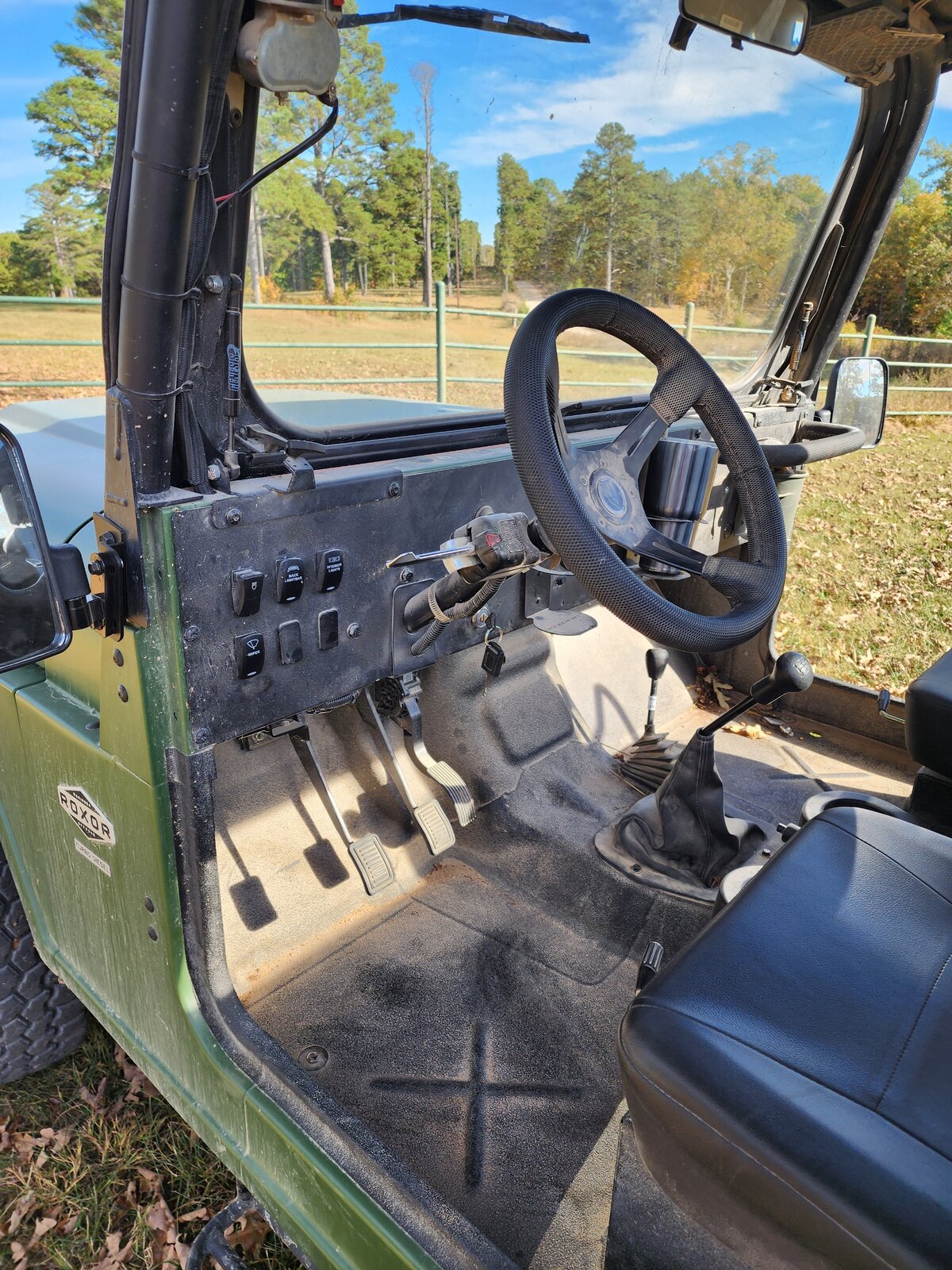

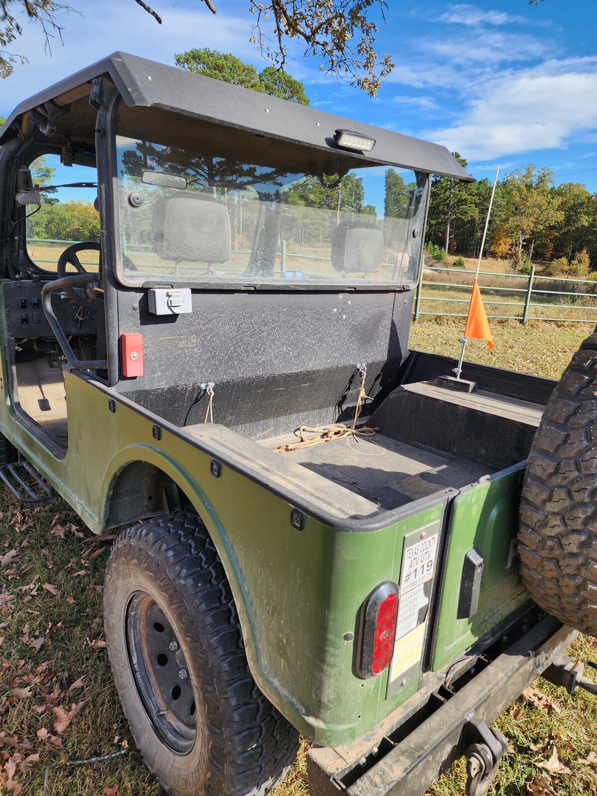

Heeeere's Rocky!
IMG_20241014_134501.jpg IMG_20241014_134302.jpg IMG_20241014_134032.jpg IMG_20241014_133957.jpg
